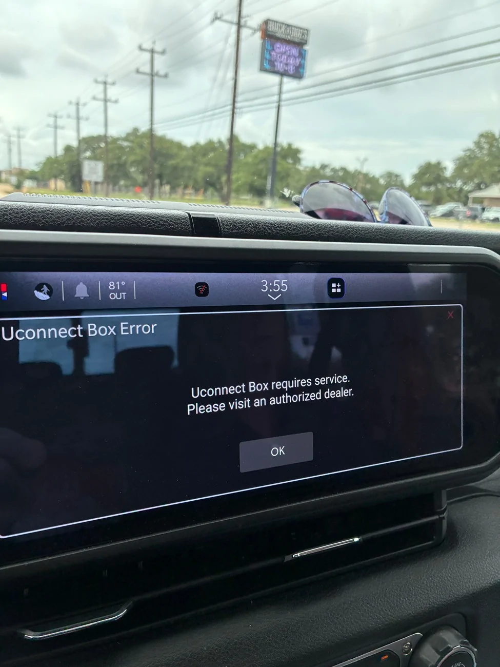

I have been getting the error in the picture below. I hit ok and everything seems to work fine. I live very rural and driving into a dealer is a rather big hassle. Any way I can diagnose and repair this myself?

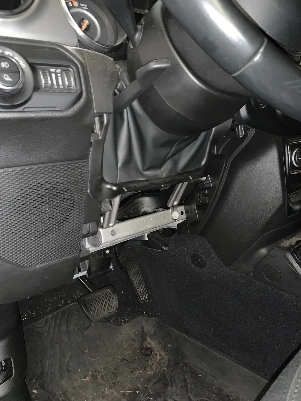

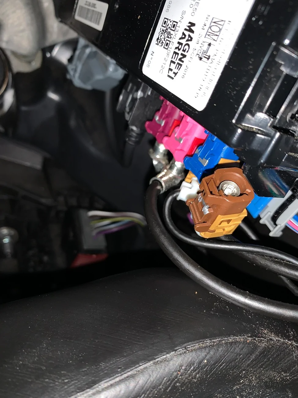

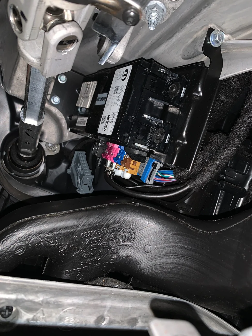

I was getting the same error about a year ago and this worked for me. I found the TBM box thanks to a JL forum. It’s located behind a panel under the steering wheel. I simply push all of the colored antenna connectors back into the TBM. This cleared the message for about a year. Then last week the error message returned. This time, I carefully removed all the colored antenna connections and gave a good spray of common automotive electrical connector cleaner to both female and male parts. So far for 4 days it has worked. I really think the problem is that the weight of the antenna wiring bundle pulls on these colored connections and causes issues. I plan to zip tie the bundle to something to take the weight off the connections.
