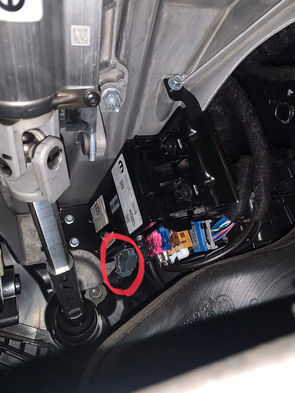

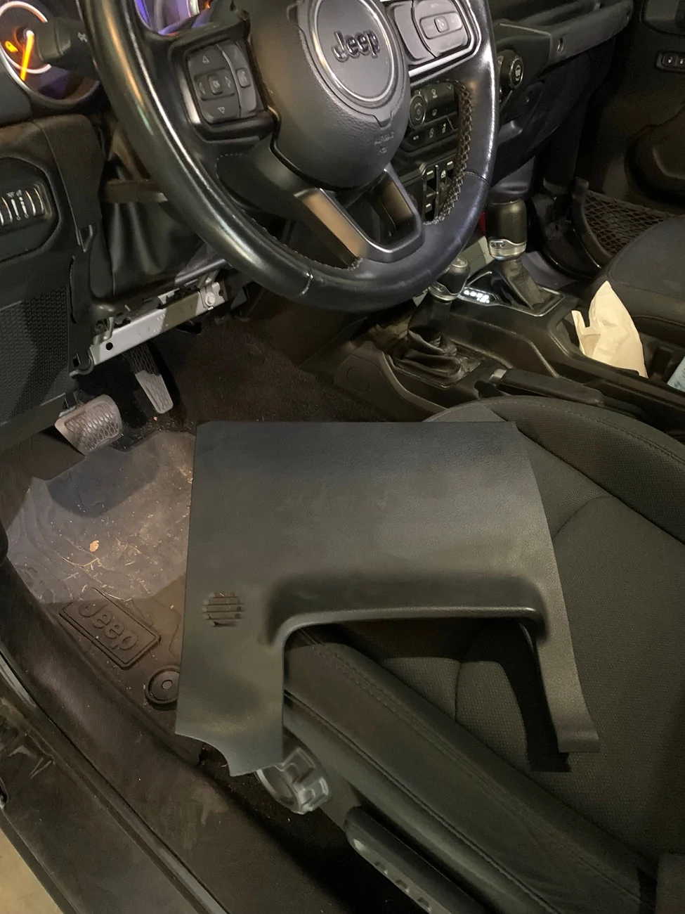

This might worth a shot. I keep getting UConnect service alerts. This solved it. The brains on the UConnect lives under the dash near steering wheel and is easy to get to. I unlatched the power cord to the unit (circled in red) and then I gently pushed all the connections going to the unit, they are mostly antennae connections. I would have disconnected them too and reinstalled but I was not sure how to disconnect them. This solved my issues. And I believe it has to do with the connection of the antennas and possible resistance at this connection.

Thanks Fish. I pulled off the panel, but couldn’t find the unit pictured. Is it on the inside (transmission tunnel) side or the outside?
You have to get low and look up just to the right of the steering column near and above transmission hump.
