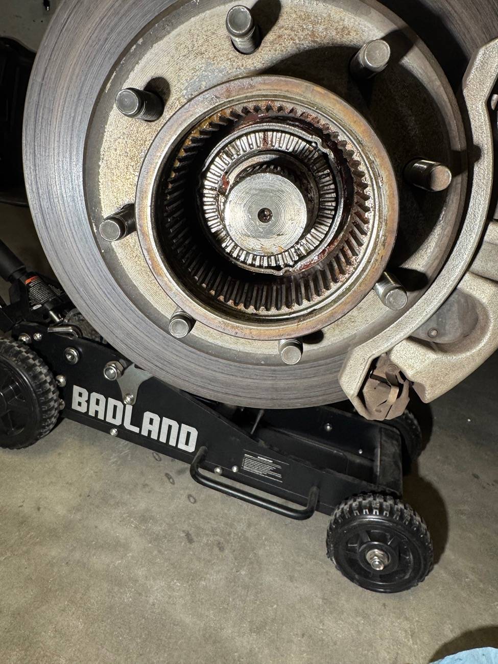

Does anyone know what socket I need to remove this inner nut from a UD 60 hub. I’ve seen another post on the JL forums that gives a step-by-step for a wheel bearing replacement/maintenance but that axle had a regular hex nut. Mine is obviously different. It looks like something four prong fits in there.

The socket does have 4 prongs that match the nut Not sure what it is called even to have one never saw a name mine is made by OtC
Can you show a pic of yours please?

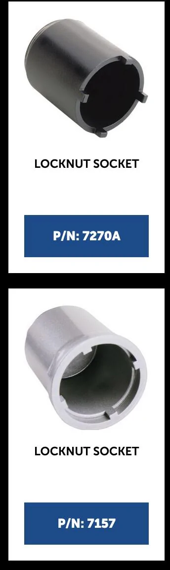

Well, searching for "dana spicer ultimate dana 60 locknut socket" finds this:
https://www.danaaftermarket.com/spi...partType=PART&utm_campaign=real-time-commerce
Searching for "spicer 10035080" shows that it is allegedly available online, although rather pricey:
Summit Racing
Going to the OTC tools page and searching for "hub socket":
https://otctools.com/search?search_api_views_fulltext=hub+socket
My guess is that it is one of these two:
@Commodus do either of these look familiar?
I have the 7270A socket and it worked on the Dana's i worked on in the day, but not 100% about fitting your setup. It almost looks like the Kingpin Dana 60 is a closer match? If you have any shops around you most techs are more than willing to show you what they use what will fit yousetup for sure
