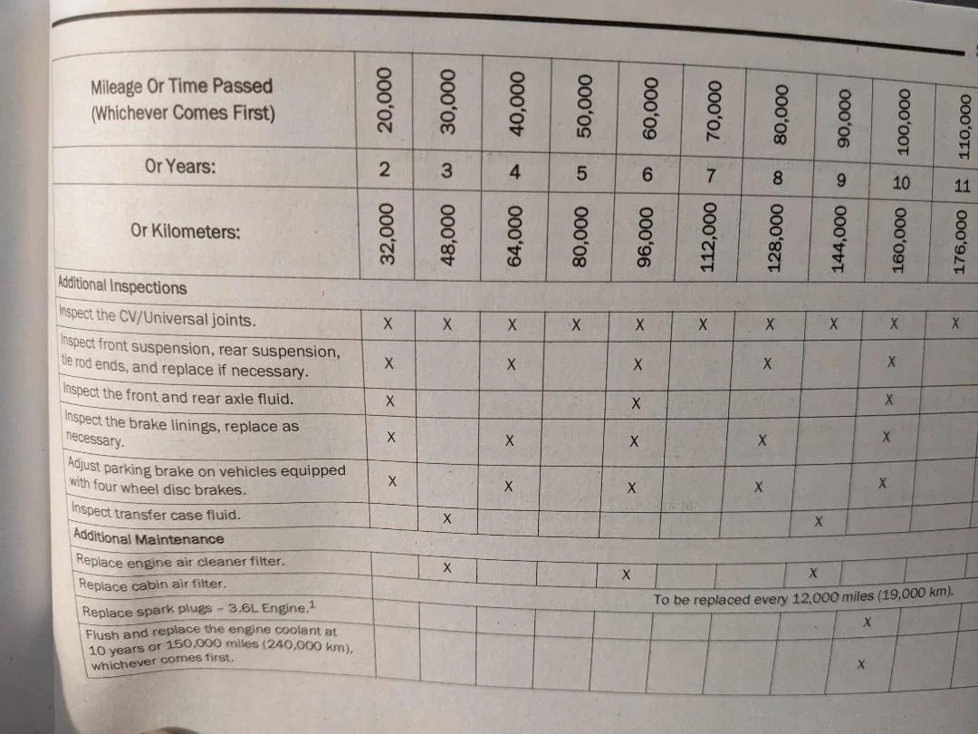

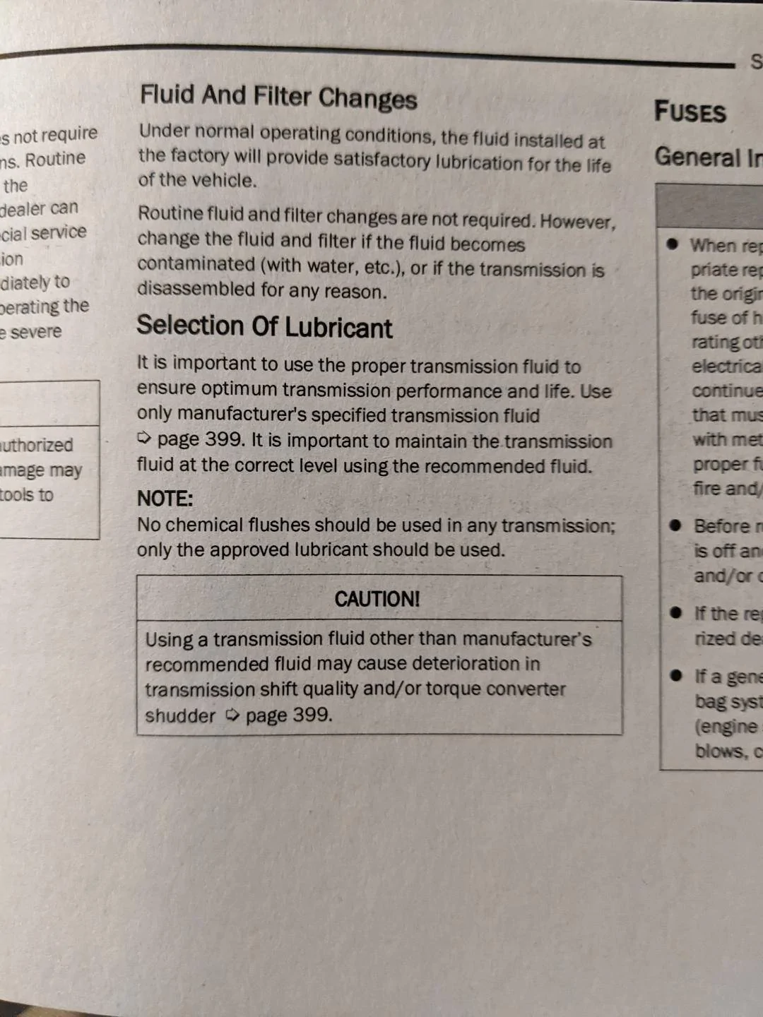

Is this a joke? Come on, I know you are from Florida and we have a internet reputation of always pulling jokes.
What JT manual are you looking at? Seriously, I would like to know.
Spark plugs, 100K
Jeep Gladiator Maintenance & service 30K miles 1700750305210
Auto transmission - who knows
Jeep Gladiator Maintenance & service 30K miles 1700750670044
Manual transmission - you are sort of correct - severe duty - 30K

You have 100,000 mile plugs in normal service and Lifetime transmission fluid for the automatic.

What is this paper reference you show? I thought the truth was only on the Internet.
KevinC
Feb 6, 2021
846
1,620
Central Florida
2023 JT Mojave Sarge
Hard Labor
I found it inside a green bag stuck in my glove box. Not sure how much its worth, may put it on Ebay.
