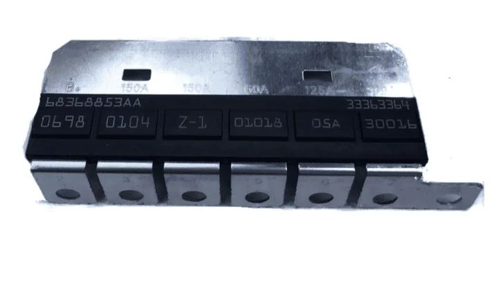

cranbiz
Bob
Jun 28, 2023
844
1,245
Wentworth, NC
It's the high amp fuse array that things like the fan wires on to..
