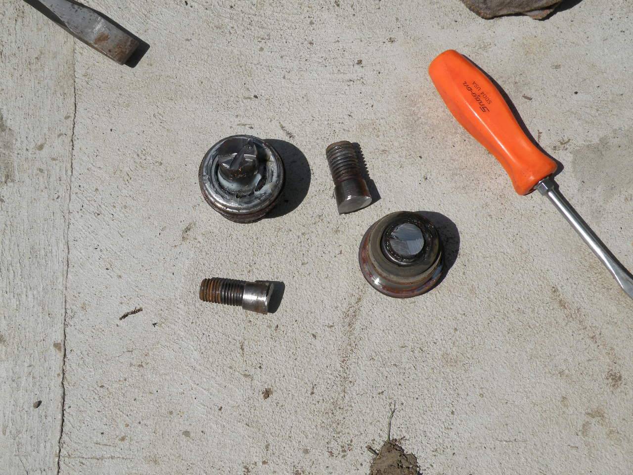

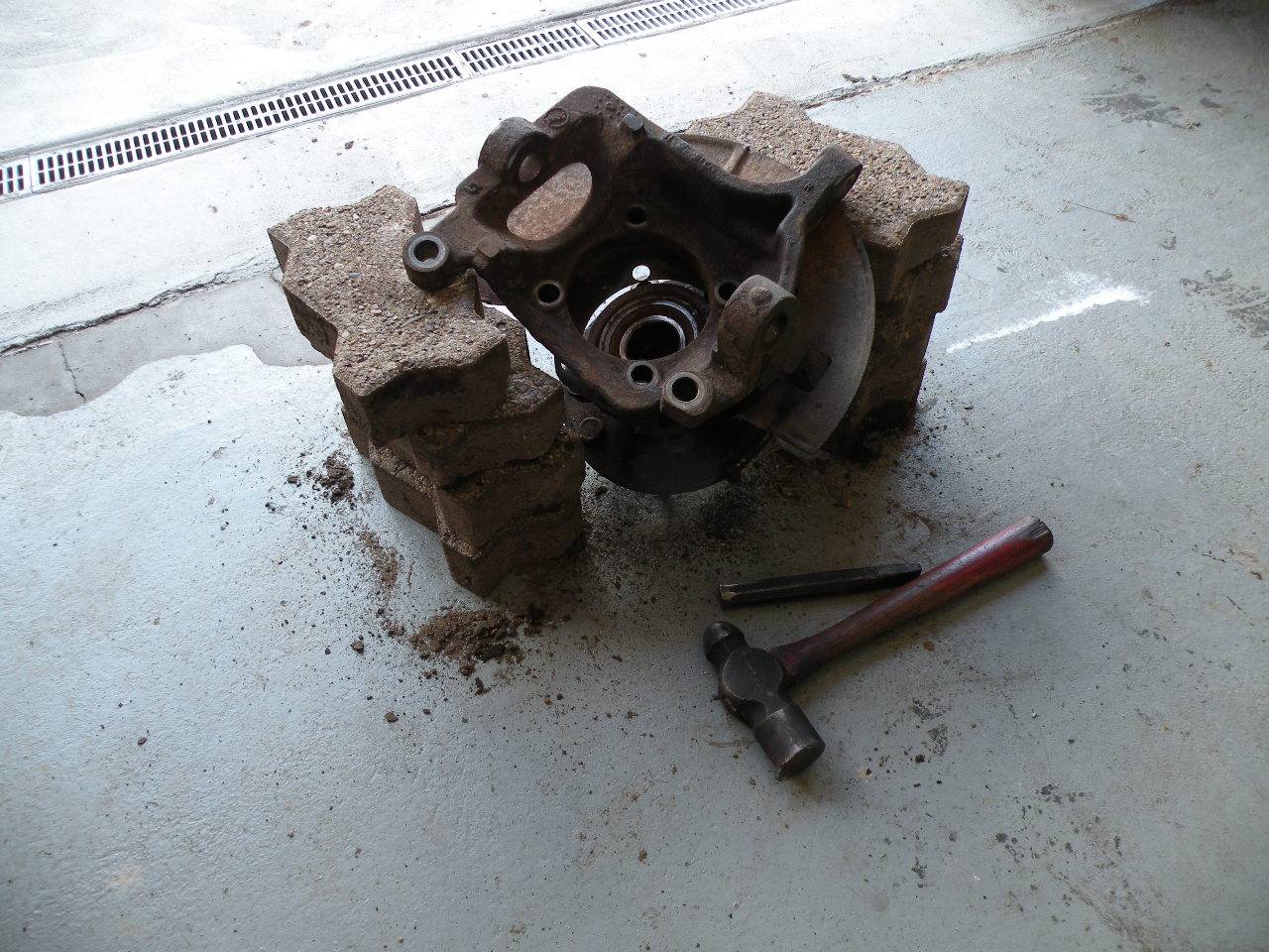

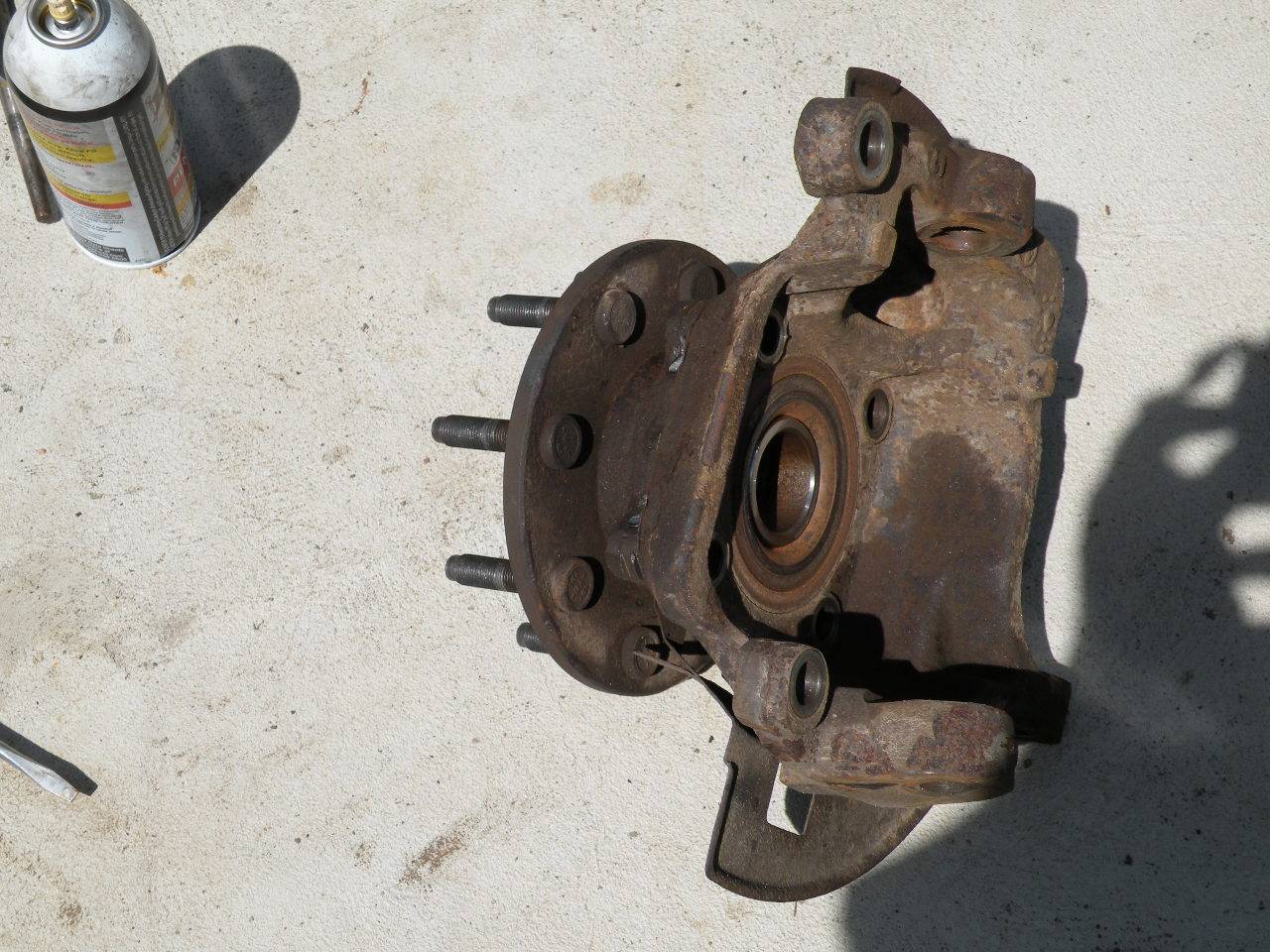

It's better than cutting the stud on the ball joints to remove the knuckle so that you can beat on the back side of the unit bearing with a Thor hammer to remove it.
