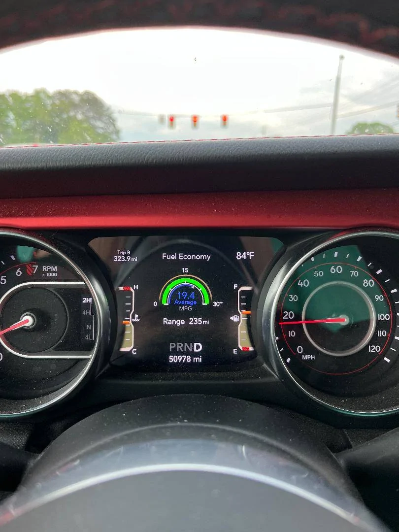

My stealer advised me I'm due for the 50k emissions treatment for $325 next oil change. But I think my mileage is pretty good with stock 33's and always question "emissions" service.
I would never see that gas mileage unless I lived on the freeway (LOL).

I never got into the 19's until 50k, just tire wear and is my daily driver I guess.
