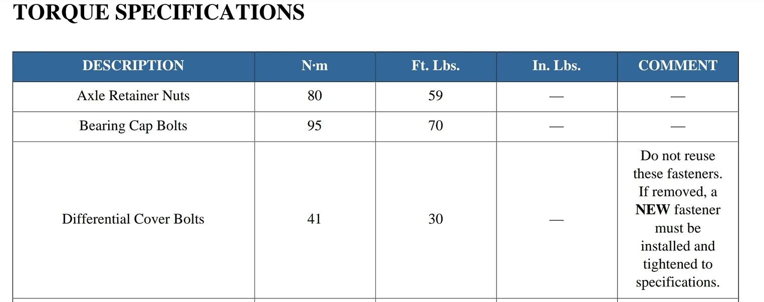

Lastly, service data says the diff cover bolt torque is 30 ft-lbs. That is for new fasteners since they recommend not reusing the old bolt fasteners. If reusing the old fasteners, I would recommend knocking that torque down to like 25-27 ft-lbs or you run the risk of snapping the old fasteners off if going to the full 30 ft-lbs. New fasteners come with a low torque loctite already applied. If you reapply a loctite material, let it dry before installing or you will run the risk of over torque the fastener.
Jeep Gladiator Axle Cover Gaskets Screenshot_20230213_101725_Driv
