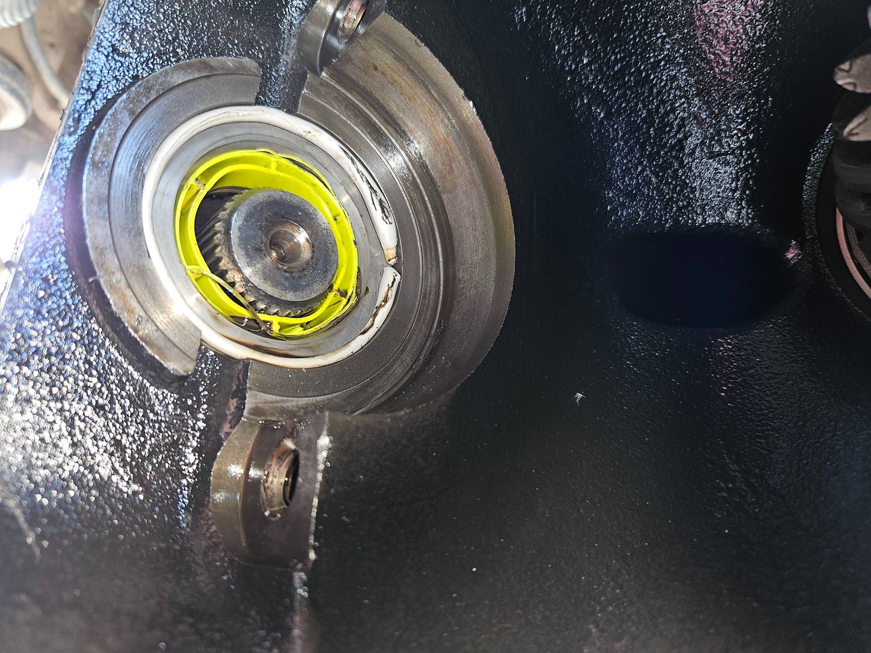

adamjedgar
adamjedgar
Adam
Oct 19, 2022
157
148
Melbourne
2022 Gladiator Rubicon
Self employed
There’s a bearing, but not a seal on the diff side of the fad. It should lubricate from the diff. The seal is on the outside of the fad.
there's a seal visible inside the diff pumpkin...does oil travel through that seal? (image has RHS intermediate axle partially removed)
Jeep Gladiator What is the Oil capacity of Front Diff in Gladiator Rubicon (Dana 44 with locker and front axle disconnect) 20241117_152727
Also, if oil does flow between the diff pumpkin and the FAD, wouldn't the initial oil level when its first filled dropand require a topup?

LouisvEarlleJT
Mar 10, 2023
1,099
1,938
USA
2023 JT Willys Earl
Oil does travel down the tube. That said, it’s possible yours didn’t drain completely before you filled up. If your level is good at the cover then you’re good in general.
Vtur
Le
Mar 6, 2021
1,961
2,316
Norcal
JTOD
Electrical Foreman
When you drain the diff as regular service, the oil in the fad stays there. It'll require a top off if you pulls the axle and fad for like regearing. Same with the rear diff. Dana's aftermarket diff covers has 2 fill holes, lower one is same level as stock cover, upper hole is initial fill for dry diff or after regeared. The fluid capacity difference between the upper and lower is about 3/4 qt.
Vtur
Le
Mar 6, 2021
1,961
2,316
Norcal
JTOD
Electrical Foreman
Ive just checked mine after the car has sat for 7 days and been driven 10km once a couple of days ago...the level doesnt appear to have changed in relation to the diff filler hole.
That not a seal but a guide ring. It serves 2 purposes. It helps with aligning the axle with spider gear and centering the axle to prevent damaging the seal at the fad while installing axle.
