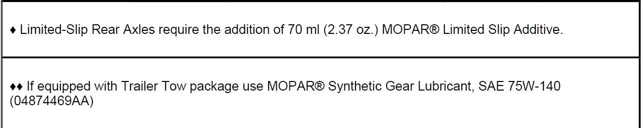

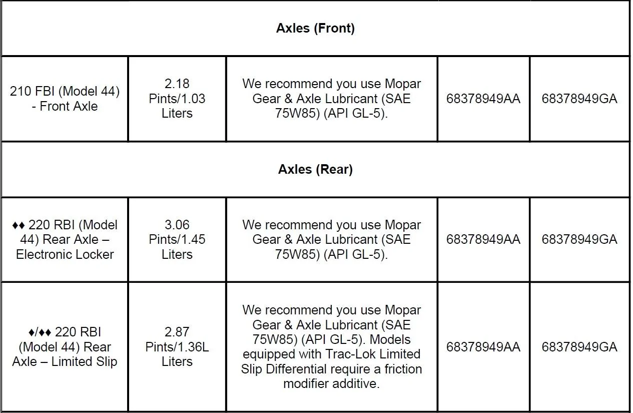

Mopar Tech Authority data states you can use 75W-140 if you have the Trailer Tow Package.
But that is not taking affect Diesel Engines w/ Tow
This is simpler than it's being made out here. If you don't tow, use 75W85 for possibly slightly better fuel economy. If you tow a lot (putting more stress and heat into the differential) use 75W140, which will hold up to high temperature better. If you use 75W140 without towing, no big deal. Your choice.
If you have LSD, add the friction modifier or use a fluid that already has it (many do). If you don't have LSD and use friction modifier, no big deal

Rubicons do not have LSDs regardless of engine.. the exception was the TJ/LJ Rubis that had both.
