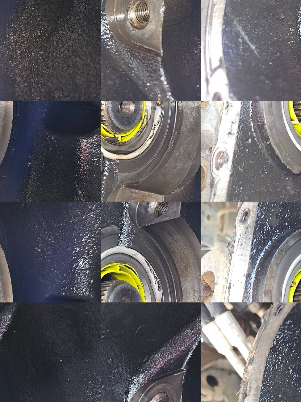

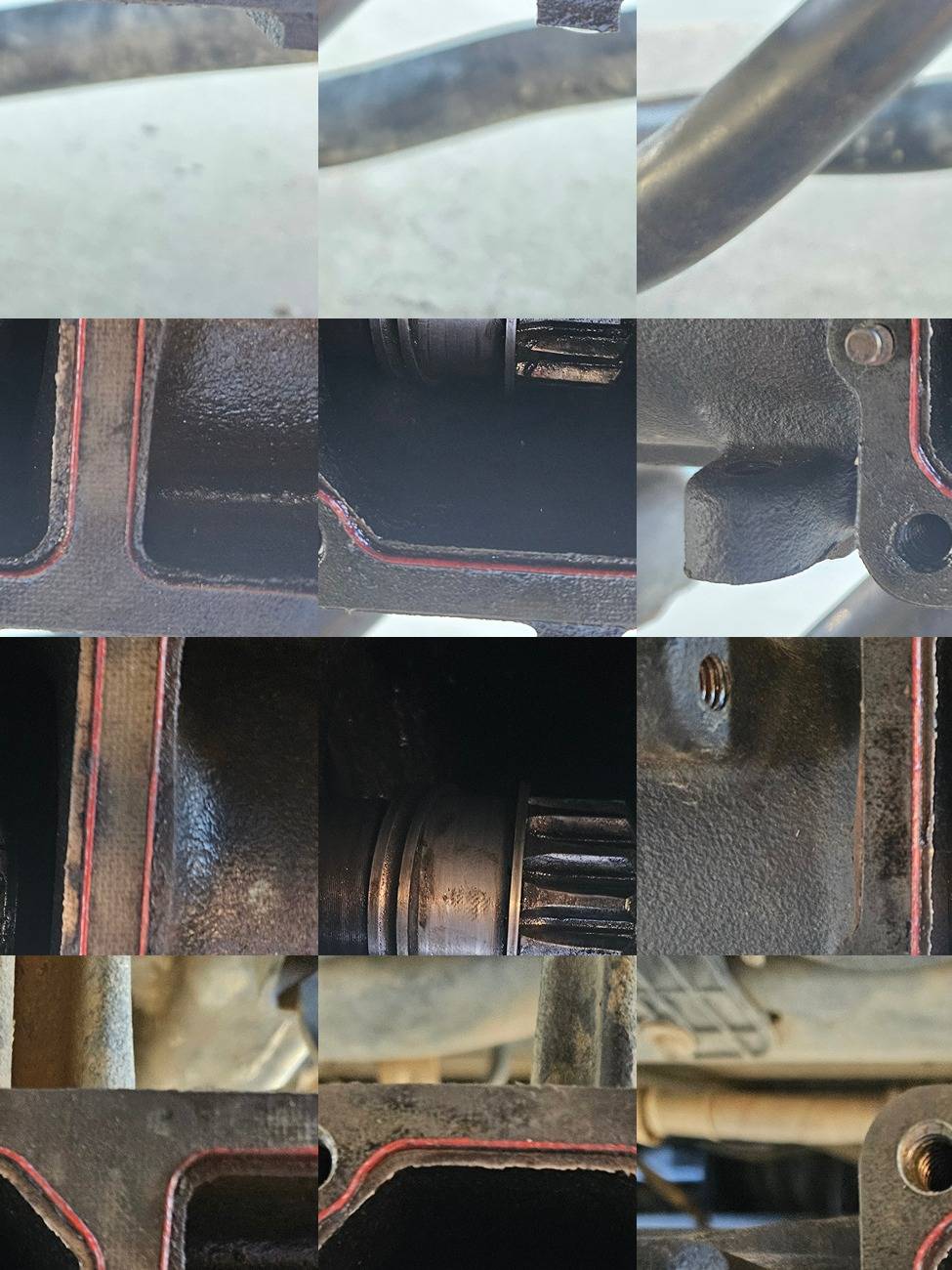

OK, so i have received and opened the repacement intermediate shaft kit.
It's the bearing shadowpapa has described
Note the two images attached.
What I dont know is how I'm.going to get the inner bearing ring off the intermediate shaft whilst its inside the FAD housing? (Because i can't pull the shaft out through to axle tube...because it's to tight for the inner bearing ring to also fit through whilst still attached to tue shaft)
The fad housing pictures are thumbnails, so I’m having trouble seeing what you’re seeing. Do you mind reattaching the pictures?

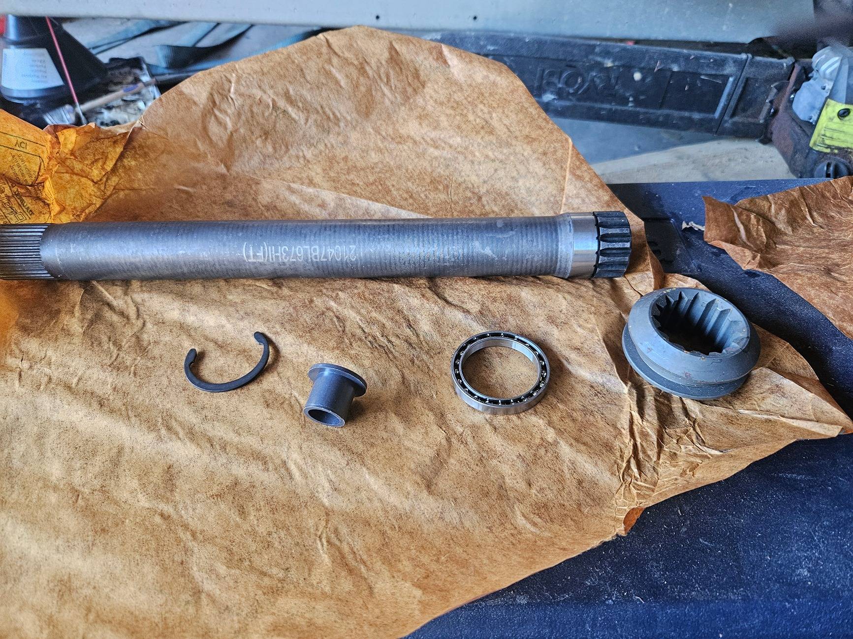

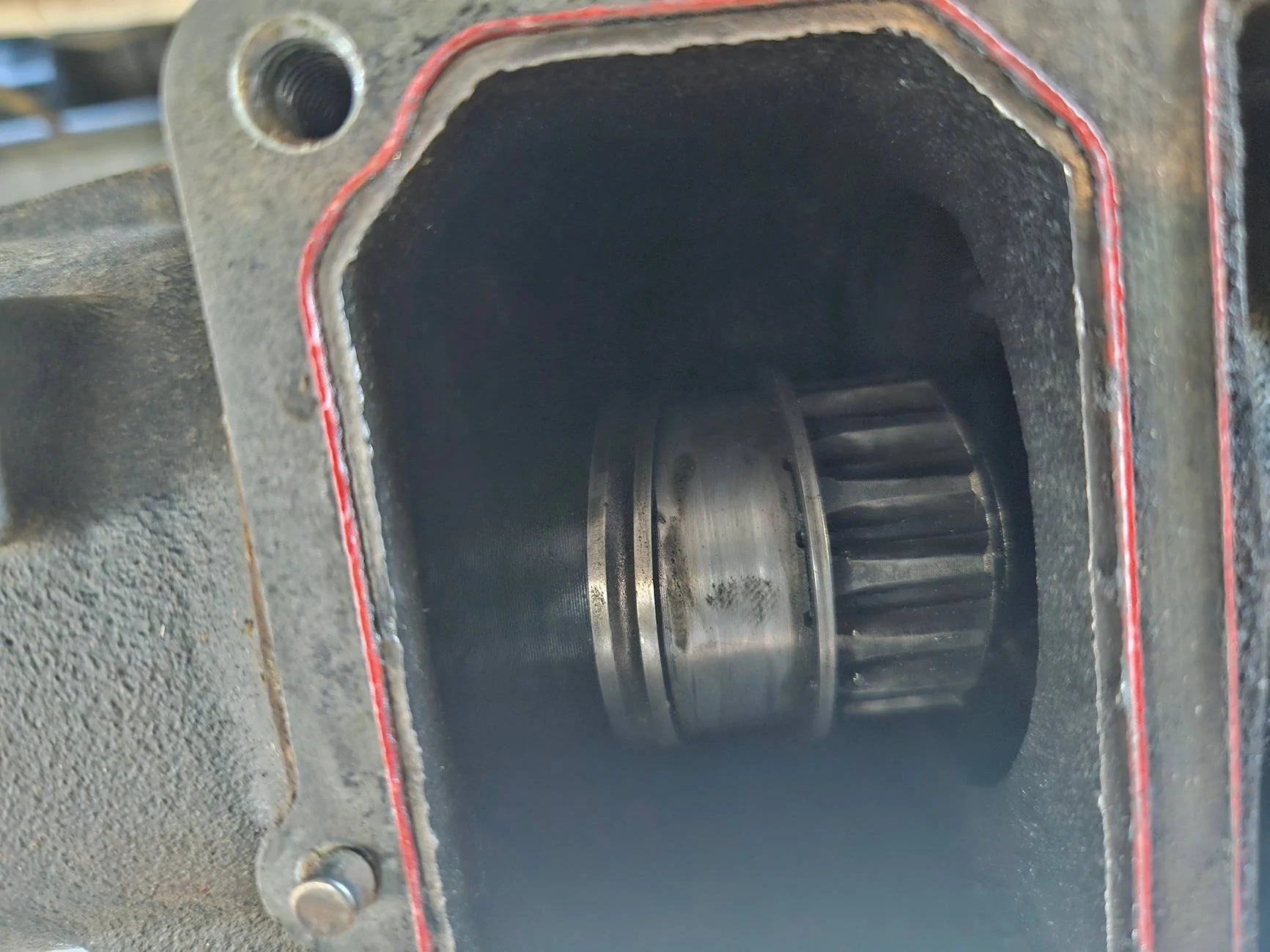

Yeah that second image has gone pearshaped...
I think i have to slide the ring to the left on the shaft...its tight though so somehow I have to hold the ring whilst tapping the intermediate shaft. This is going to be fun...i think I'll have to tap it with a long bar through rhs wheel hub whilst holding the ring through the FAD housing opening.
I don’t think it’s that bad. It looks like the snap ring just needs to be removed. It looks like it’s to the right of the bearing race.
Edit: If you pull the snap ring straight towards you to remove it, can you then not slide the shaft out the tube to the right?
I don't suppose you have a torch, or an induction heater?
Don't buy lottery tickets - you'll not only lose, but they'll come and take the rest of your money, too - with your luck.
Stay away from dart games.
These are times I wish I was a lot closer to some forum members - I'd say bring it in, and we'll throw all of the tools I have at it.
It’s just a snap ring though. He has replacements, so I’d either pull it straight off, or cut it with a 2” cut off wheel. I’d tape both future halves to the shaft to avoid them flying somewhere. Since he’s got a new shaft, I’d do the same with the trashed bearing race.
The snap ring will be easy - smack the backside with a chisel and it will spread, or knock it off with a small flat punch.
The bearing - is it pressed on, or just the snap ring?
