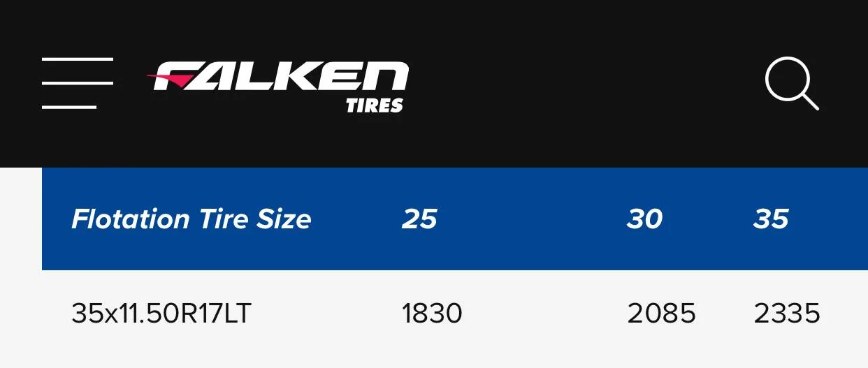

I found this chart on their website but it’s showing the max load at that pressure. Fully loaded down for camping my truck was 6300 lbs so at 25 psi the tires can more than handle that, but IDK if I want to run 25 all the time.
I sent them an email last night telling them about the issue so I’ll see if they respond.
Mickey did tell me that when I’m towing that I should inflate the rears up to 35ish, just while the trailer is hooked up. I do do that and it works great. The extra weight ensures that I still get good tread contact. I lower them when I arrive wherever, and detach.
