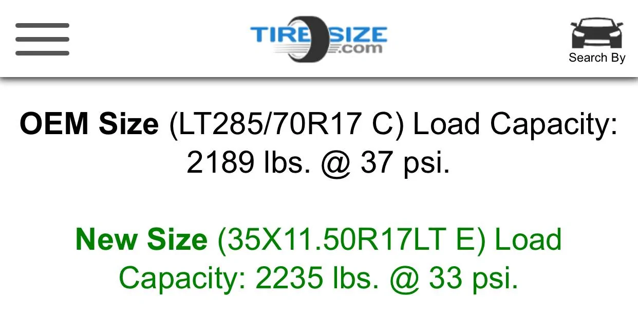

Tiresize has a recommendation calculator but only offers E rating for 35/11.50
Falken sent me an email and suggested I get an alignment so that’s what I’ll do first. Maybe it’s off since I wheel a lot. Funny thing is, I never aligned my Samurai once in 18 years. Maybe since it was so light it didn’t matter.
Falkens are I’m sure different, but that sounds pretty close. My friends Mickey 35x10.5x17’s are I think e rated and they wanted 40. If yours are d and 11.5 maybe 33 is correct.
