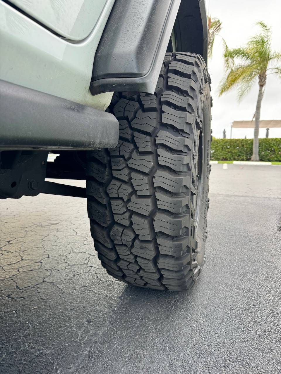

Huh so MT advised I should run my ATs at 36psi until the sidewall breaks in. Running them now 32psi cold and the outer 1/2in tread blocks like many don’t even touch the ground. So he said run them at 36psi for a couple thousand and then do the chalk test. Seems a bit off to me. Just gonna leave them at 32psi for now.

Size? If 37x12.5x17lt, that’s too high. You’ll wear your middle blocks out quickly.

35x12.50r17 on a 17x8.5 wheel.
I’d run those between 27 and 28psi cold all day. I’m on the second set of the identical tires and they’re perfect at that pressure.
