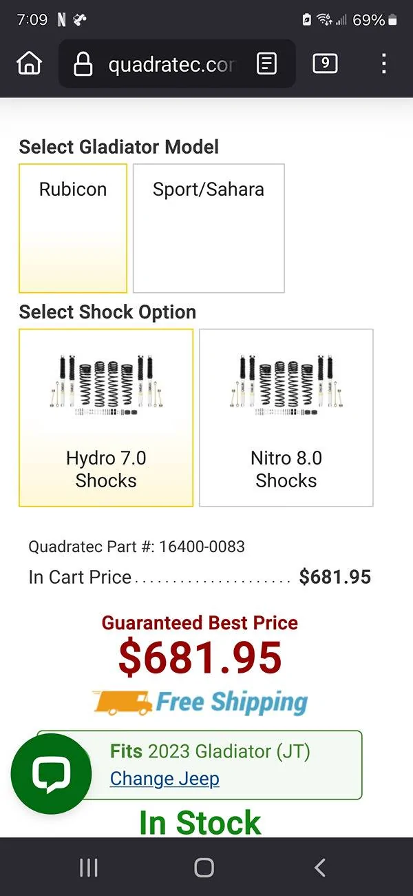

Upgrades for a 2.5" spring lift.

I'll go with both cause would rather do adjustable heavy duty nice looking control arms now
