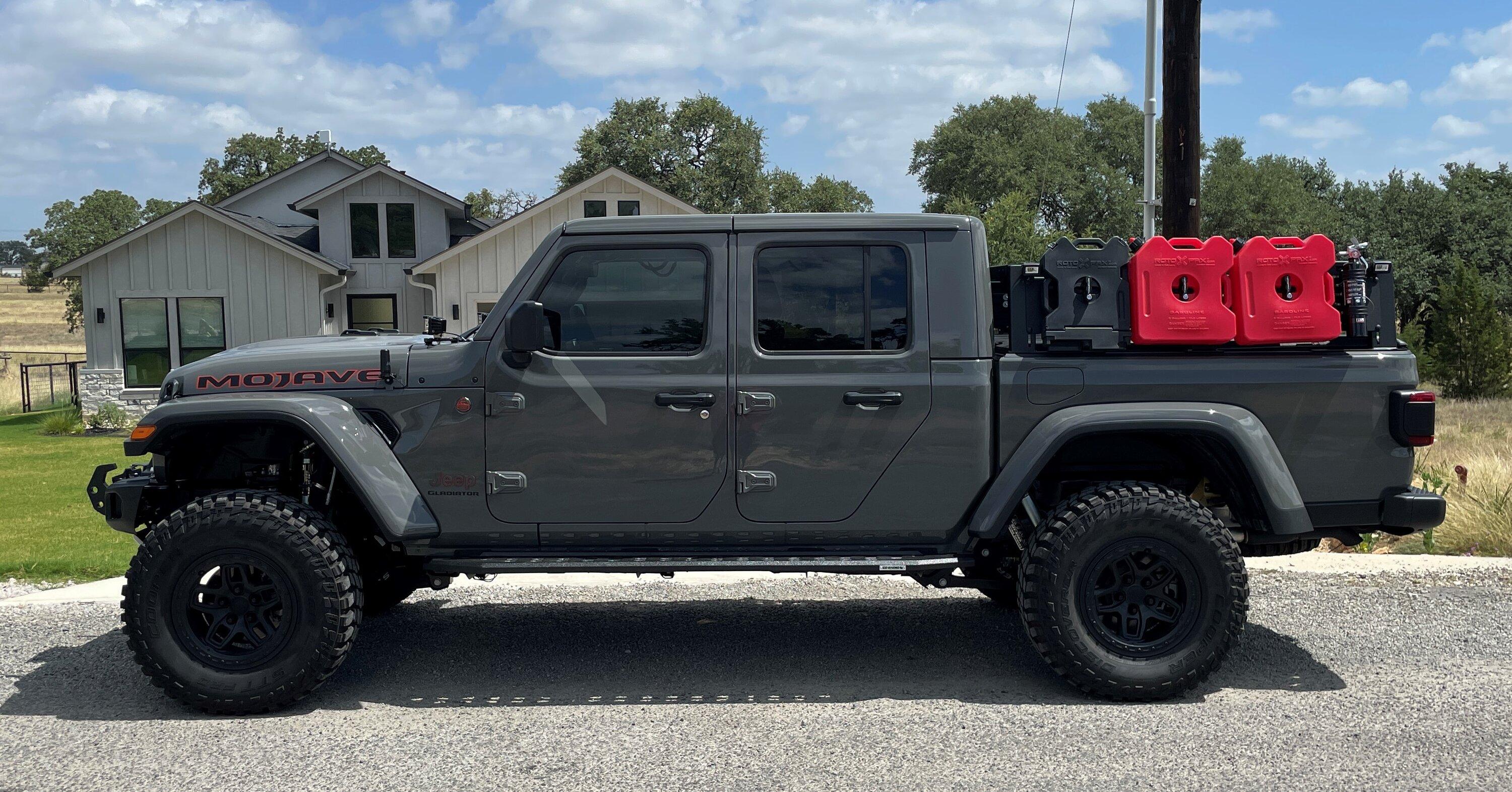

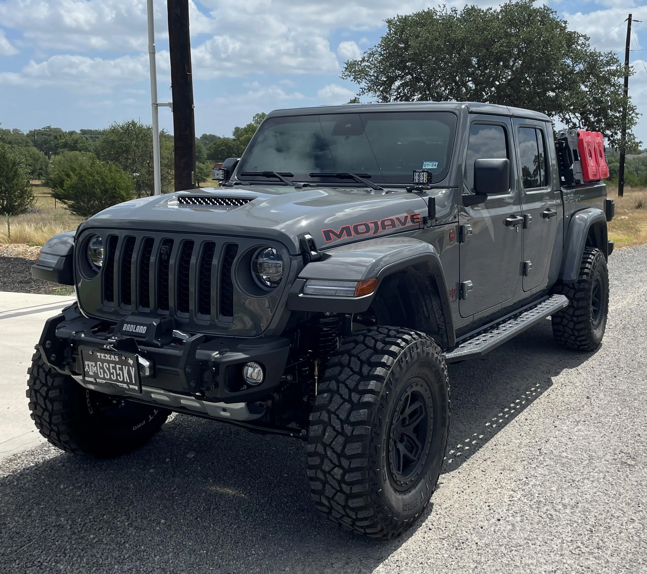

I actually just did a 2.5" EVO lift with the black King 2.5 EVO-spec shocks over the holiday weekend. Previously I had installed the AEV 2 inch spacer lift and just wasn't happy running on preloaded springs.
I gained 2" in the front and 1.5" in the rear over the AEV 2" spacer lift so 4" in the front and 3.5" in the rear over stock.
I knew there would be a significant increase in height so I added Metalcloak front and rear track bars to recenter the axles and Clayton Offroad swaybar links (those things are kind of dinky and may upgrade to a heavier duty set in the future).
I love it. The springs are a little softer than the stock Mojave and the King Shocks seem to be badass. The ride is great. I have Cooper STT Pro's 315/70/17's and, although I think 37's would look good but I'm super happy with how it turned out.
Oh and if you zoom in on the front shocks you'll notice the reservoirs are held to the main shock with hose clamps. The folks at King forgot to send the mounting hardware and are overnighting them to me today. Desperate times call for interesting solutions.

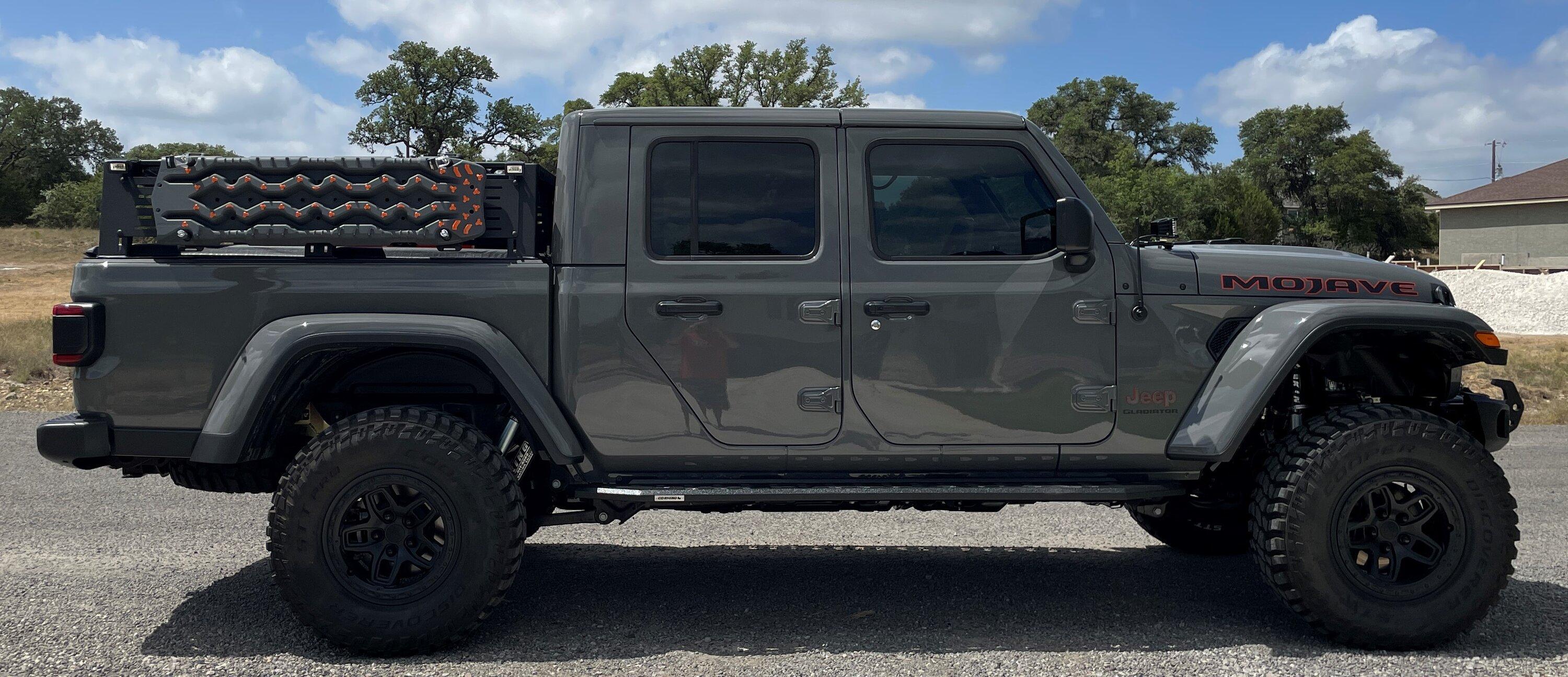

What half rack is that?
TreyK42
Trey
Jan 31, 2022
89
125
Blanco, TX
2021 JT Mojave Sting Gray
Software Nerd
It’s the Rebel OffRoad XPLOR half rack. Heavy duty and uses all of the bed. Other than banging the crap out of my head a few times getting stuff in and out I absolutely love it.
