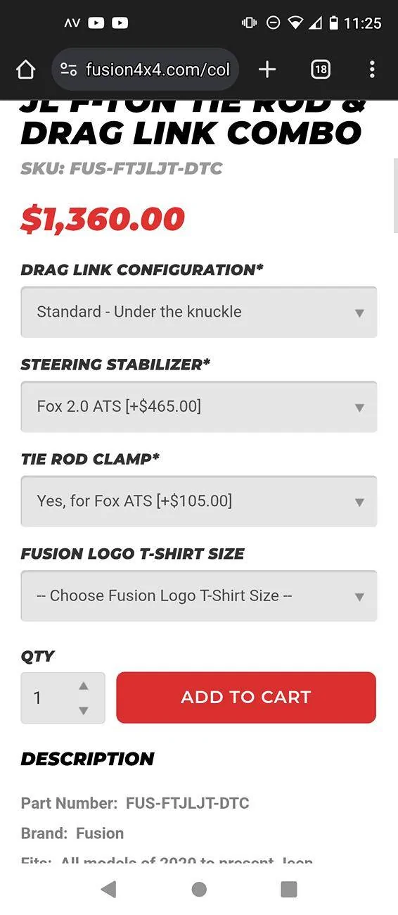

Now my tie rod bar does wiggle a slight bit just like the video you posted and the rest of the noise I have might be from that but its a ton less like I said….I am looking into that upgrade also as the other have mentioned but 800-1000$ will make me wait just a bit unless I find a deal

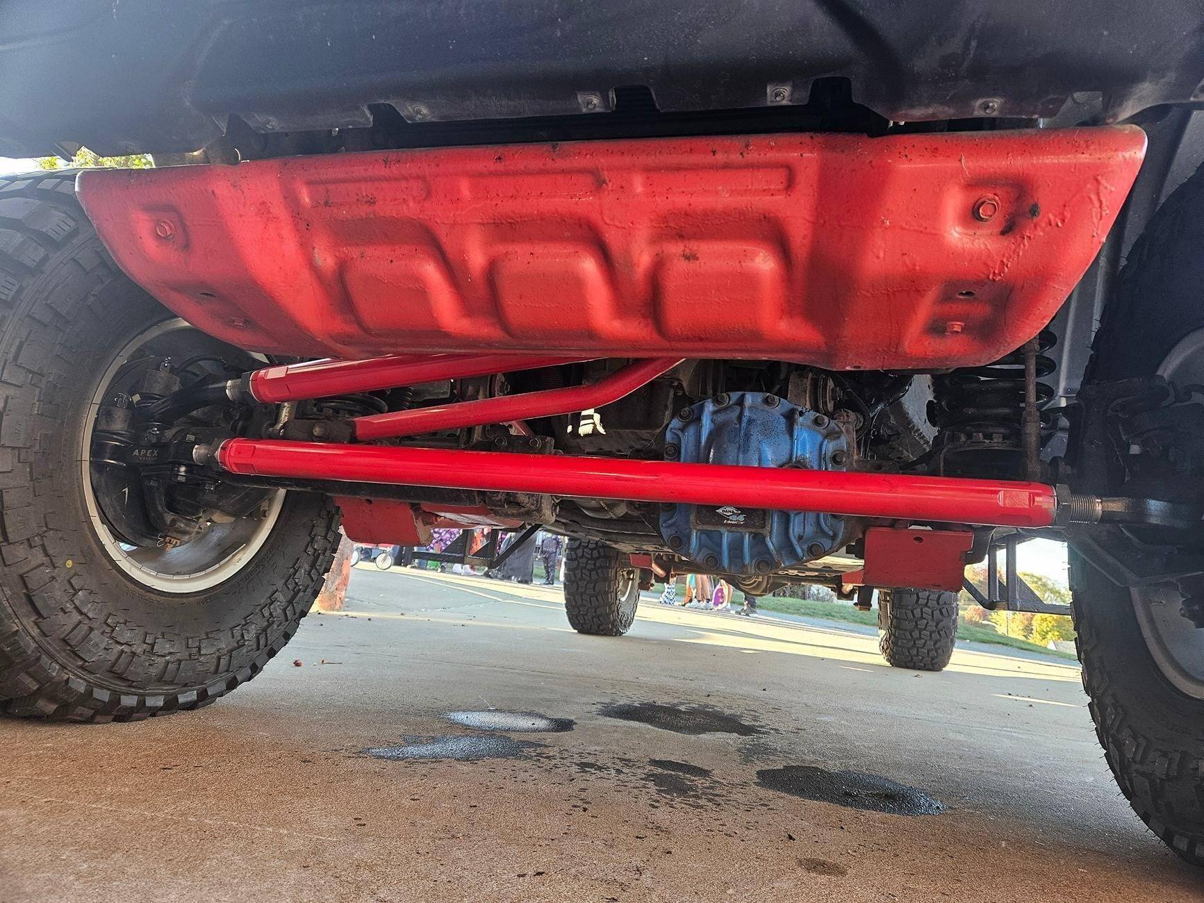

I am at 3" lift also . If you want to make a world of a difference this is what I did . I wanted to upgrade the steering linkage but went one step farther . I did Currie's RockJock High steer kit. It raises the axle end of the track bar and both ends of the tie rod by way of new iron knuckles . This is not a draglink flip and only requires 2.5" of lift. its ,tie rod and drag link , knuckles and brackets to raise steering stabilizer and track bar axle mount. It made an incredible difference , now my linkage is at an angle it would be if I only lifted the Jeep a half inch. I thought the jeep drove pretty good before now the steering wheel moves less distance than it did before for the same results. Going around curves are much more precise any steering correction that used to be made while driving on old uneven road surfaces are just about gone and if ya do it is just a slight nudge of the steering wheel .. Like they say you don't know how good, good really can be till ya try. I never thought this jeep drove bad but always thought it could be better. Its not cheap but well worth it . I kept my Core4x4 track bar and later added the Rock Jock drag link. As I could afford it I bought the knuckles then the rest of the parts . It was the best investments I have made to this Jeep and highly reccommend it to any one 2.5" of lift or more . If you are real high lift then I guess a DL flip system would do the trick but us who are not lifted high this is great . I have no affiliation with Currie but have used John's products when ever I could . jl-all-high-steer-knuckle-kits-complete
