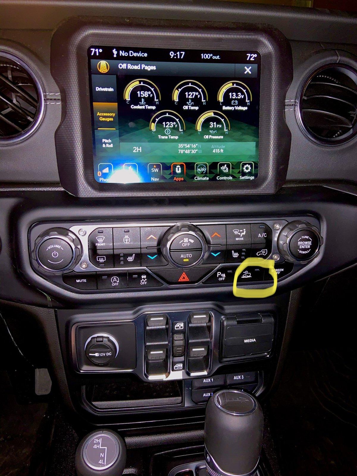

To be honest, I’m not even sure what that is or if my overland even has it. Is it something that comes with the max tow package I assume?

I have not used it much, only used it on beach sand to see that it worked. Good to k how that it could get me out of a sticky situation some day.
I believe all models come with it but I could be wrong. It's the cruise control button on the dash that has a jeep going over a bumpy road. you use the shifter to control the speed in increments of 0.6 mph.

I have it on my base sport. It is like a low speed cruise control going up hill or down.

If this is in the manual, I can't find it. Not listed in the index, and I didn't find it while reading through the "operating" section on 4WD. Kinda had an idea what that button was supposed to accomplish, but had no idea how it worked until reading it here in the forum!
Thanks for the info!
UPDATE: Ah-ha! Found it. P. 78 of the manual
