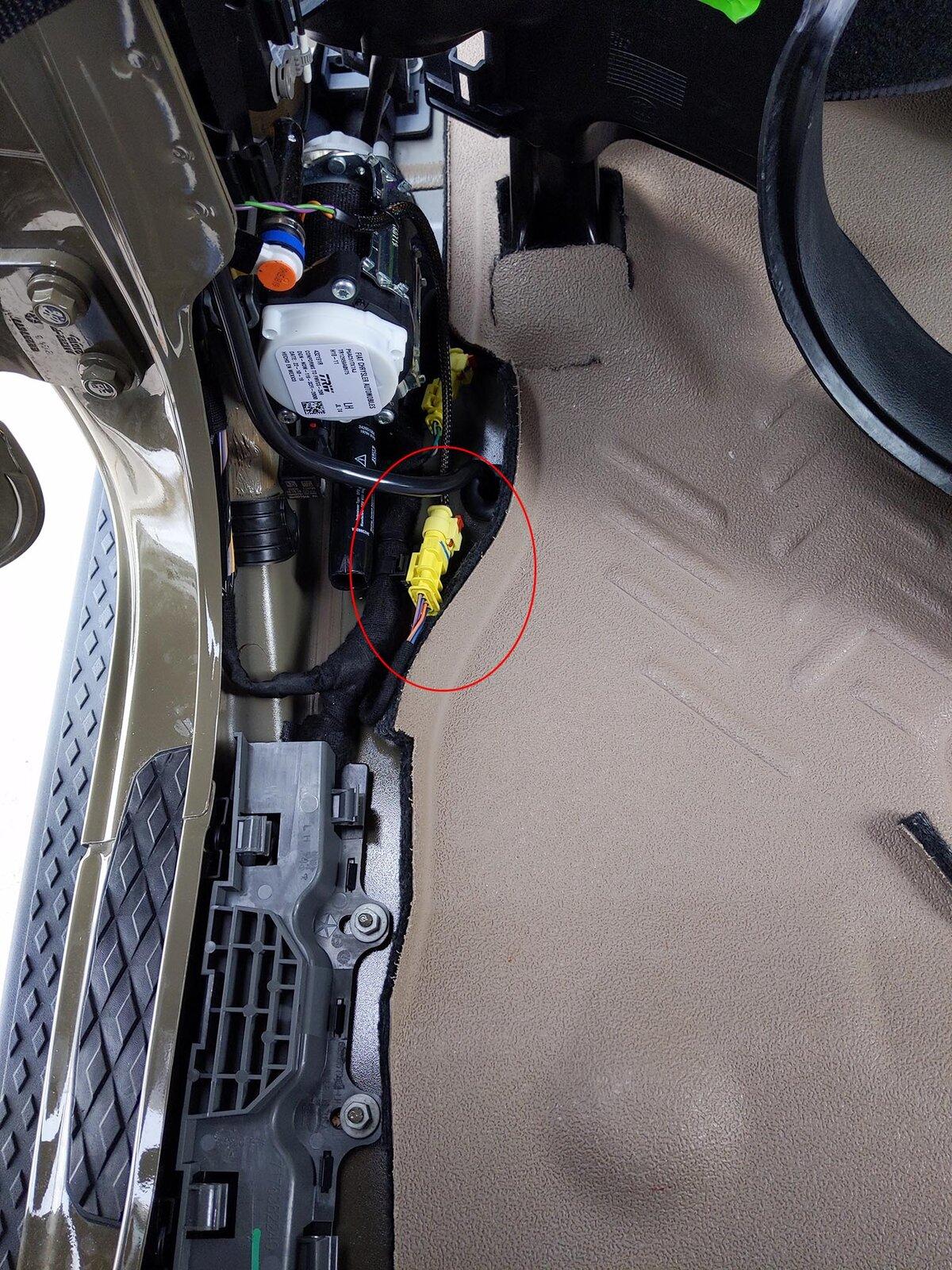

I was never sure what was interfering with mine, it seemed to go into place, but kept pushing back out. After I repositioned this plug it seemed to fit OK.
Jeep Gladiator Very excited about Armorlite full interior, maybe my favorite mod yet. armorlite plu
Surprisingly that is not my main issue. It is actually the driver door trim haha
On my door/kick panel trim, the clips separated from the trim and stayed on the studs. I had to remove them and snap them back into the trim before the trim would go back on. The other end was hard to snap because the B pillar trim it snaps into was no stiff enough.
