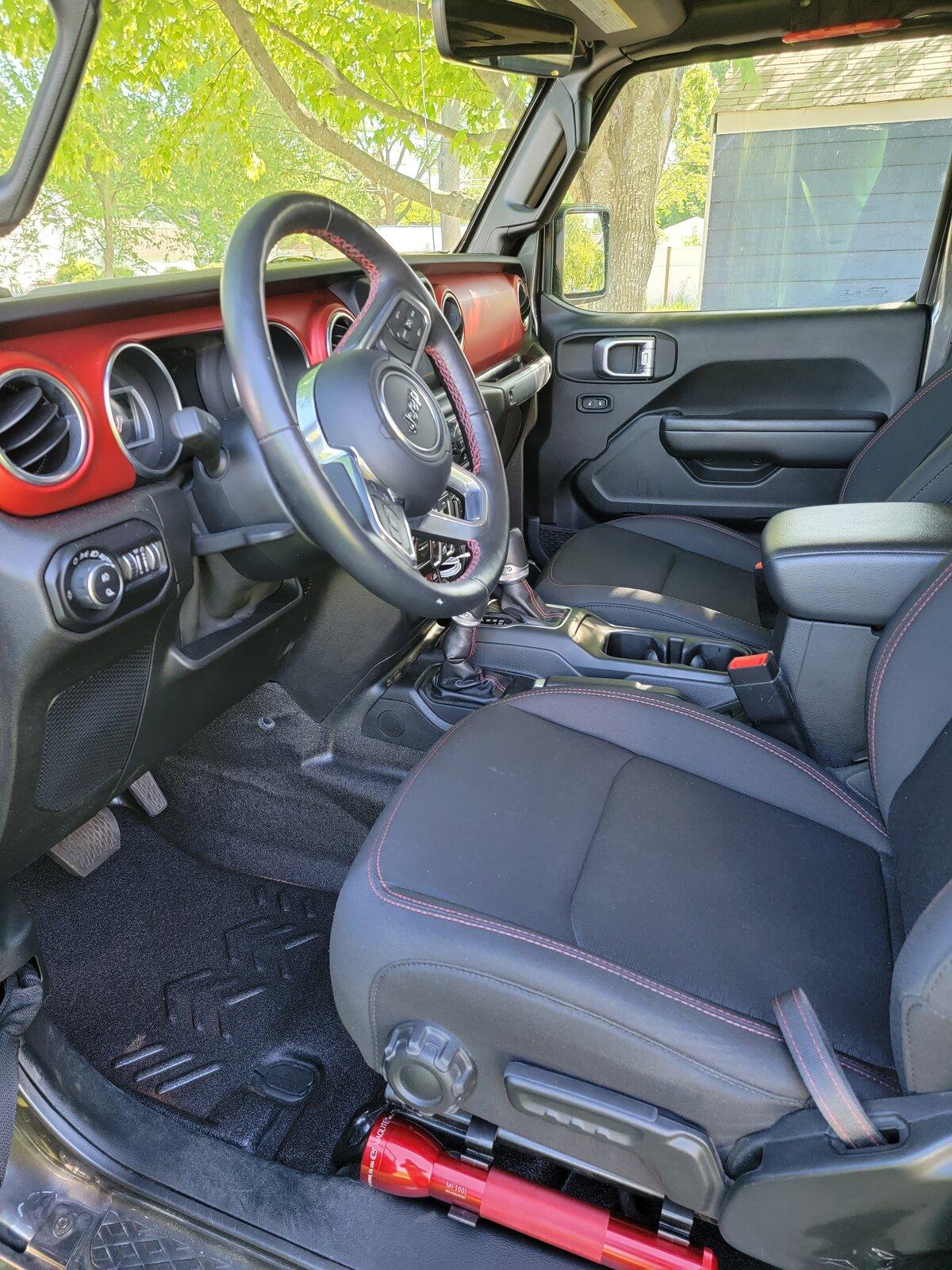

Very excited about Armorlite full interior, maybe my favorite mod yet.

black plugs are standard, colored sold separately.
Good news, we are releasing the red plugs at Daytona next week. Should hit the website soon after.
Need Sting Gray plugs to offset on the black floor. Or Sting Gray mats with black plugs.

The assassian strips didn't cause an issue, it was simply how I installed it. I placed the front passenger side in first, then the rear, then the driver front. I should have placed the driver front in prior to the rear lol.
Overall it works great and sometime this week I will be rinsing it out.
The instructions stating that you need to make sure the drain plugs line up is key. I did not at first (it was close enough or so I thought). Then while driving the plugs popped out due to wind. So had to readjust it and now it is fine.
Much appreciated, I just ordered the Sound Assassin floor package; I already received the Armorlite. Will pay close attention to the plugs once I start installing the Armorlite.

It is a bitch, im gonna say that up front. Pull the carpet in sections starting with the front seats. If you can do it, then pull the back. I pulled all the carpet at once and installed the sound assassin blocks all at once so I was kind of stuck doing the entire thing when I really didn't want to once it got dark lol.

Any chance of making the plugs in any other colors? As soon as my lift is paid off, this flooring is next on my list, and I'd love some blue plugs.
We are working on other colors. Besides the release of red, 2 other colors I know being discussed are blue and green

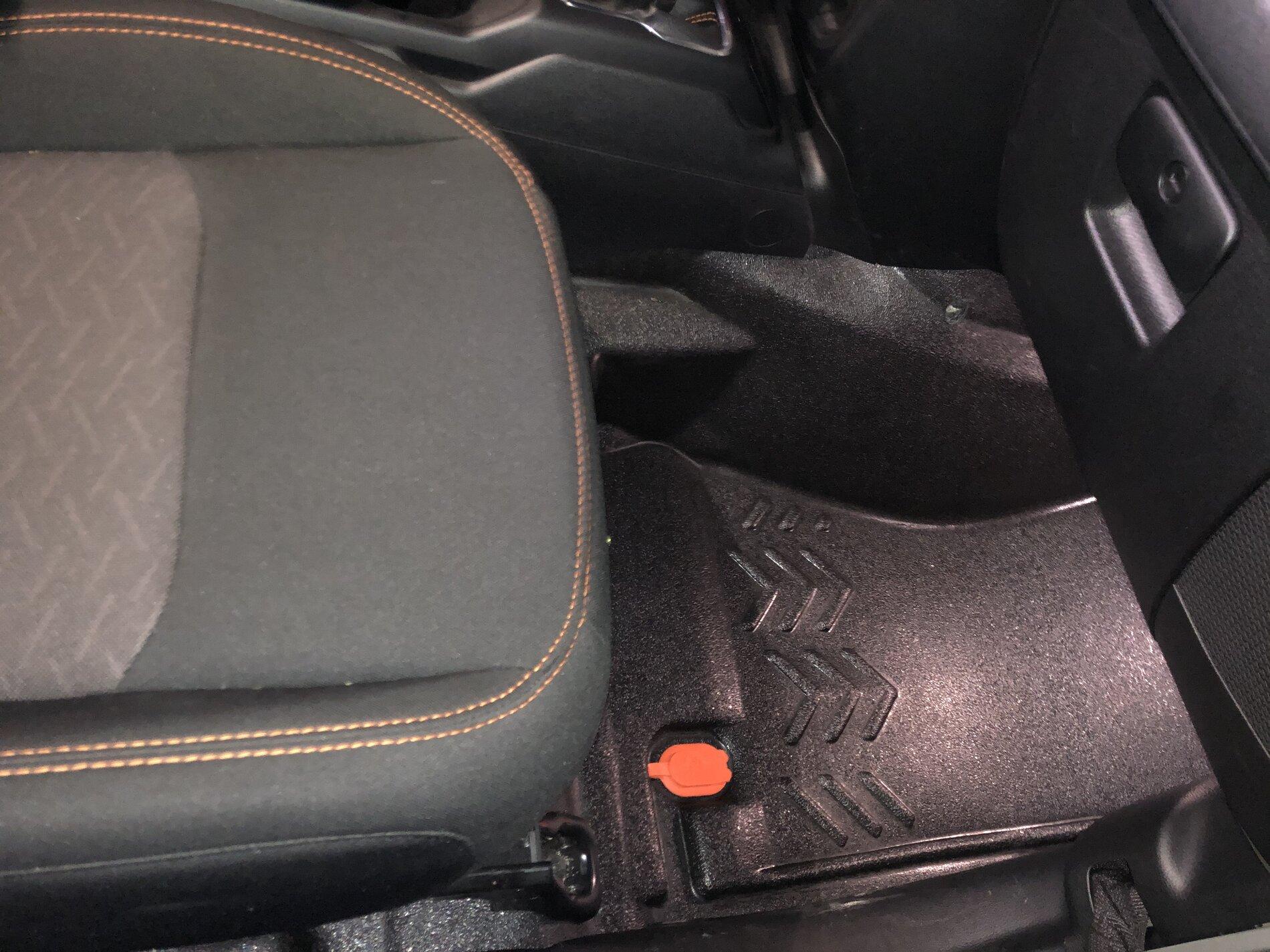

Pulled the trigger with some orange plugs. Was trying to decide on this or a mtb setup using the cross bars and track system. But I saw my dogs hair on my new Mojave carpet and said nope.. not having it haha

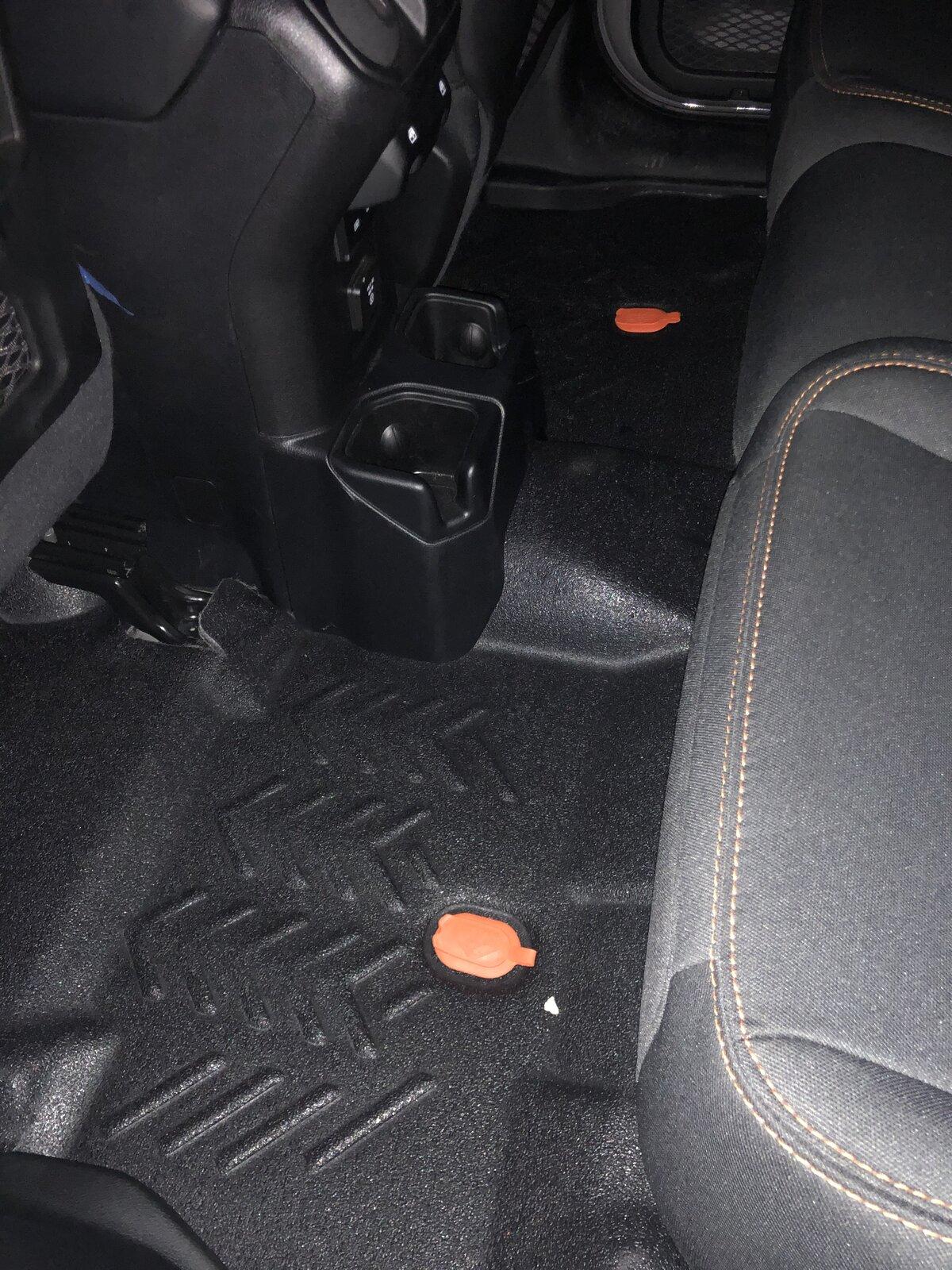

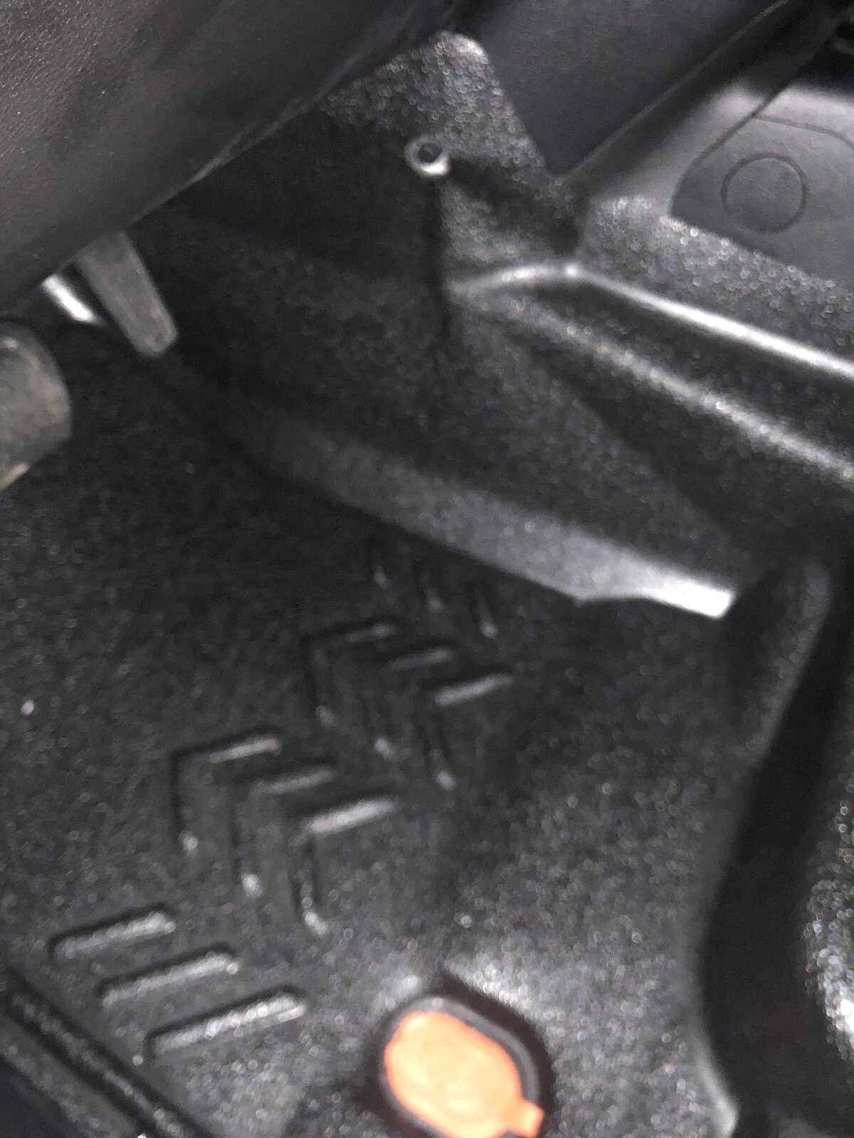

Installed mine last night. Wish I knew to have my seats all the way back so the holes line up corrrectly. Ended up scratching some paint from moving the seat so much. That ruined my night lol
But, so far I’m liking them. I may have to mess with it more to get everything to line up better.

When reinstalling a seat make sure the seat tracks are aligned, they can move independently after the seat is removed. I had a very difficult time restarting all four bolts until I realized the seat tracks were out of alignment.

This is what got me! Took me forever to figure out what was going on and made me hate life for a bit haha

Those plugs looks awesome with the stitching on your seats. I can't wait till they make the plugs in blue, and then I'll order and install mine.

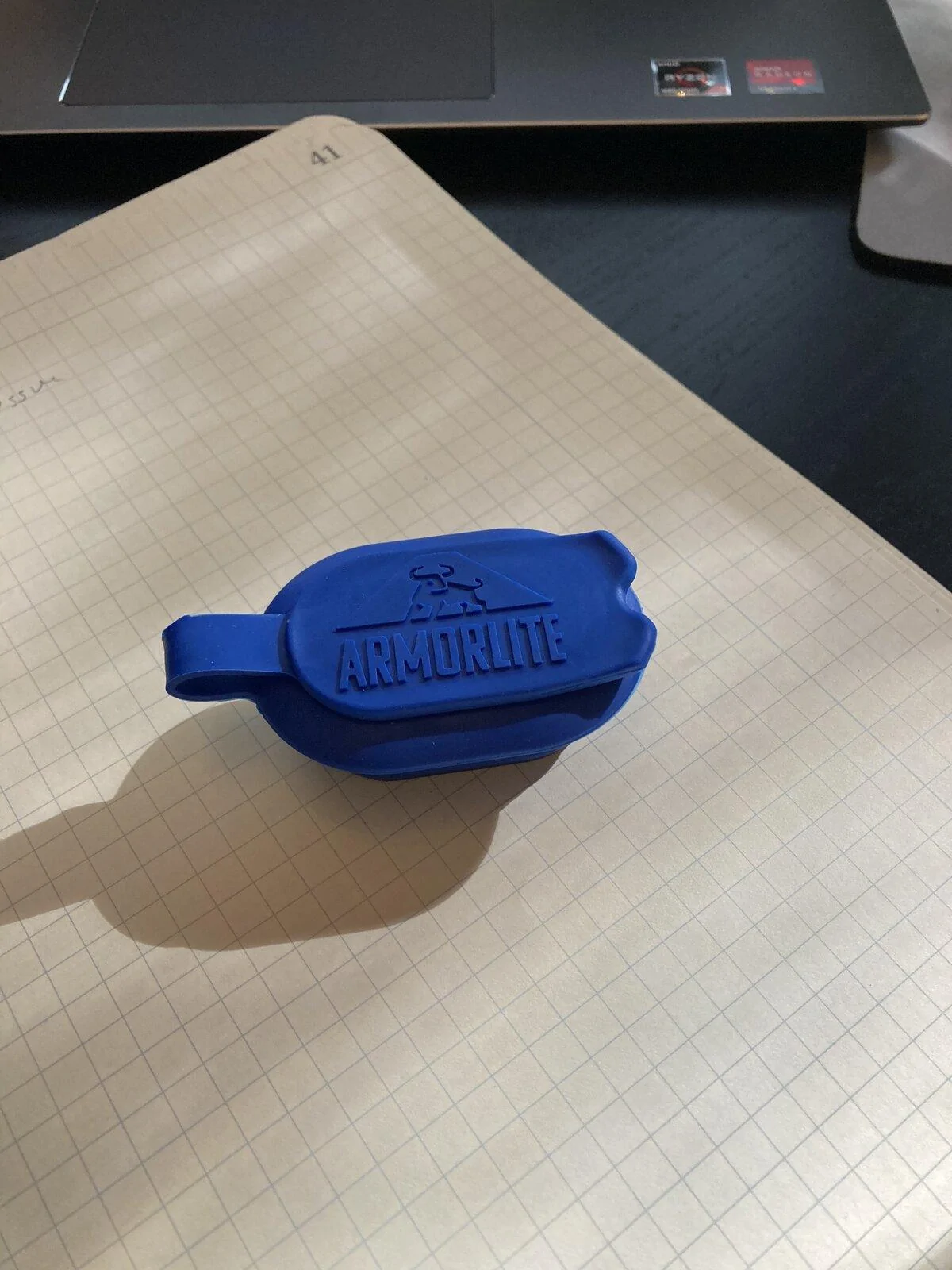

ask and you shall receive

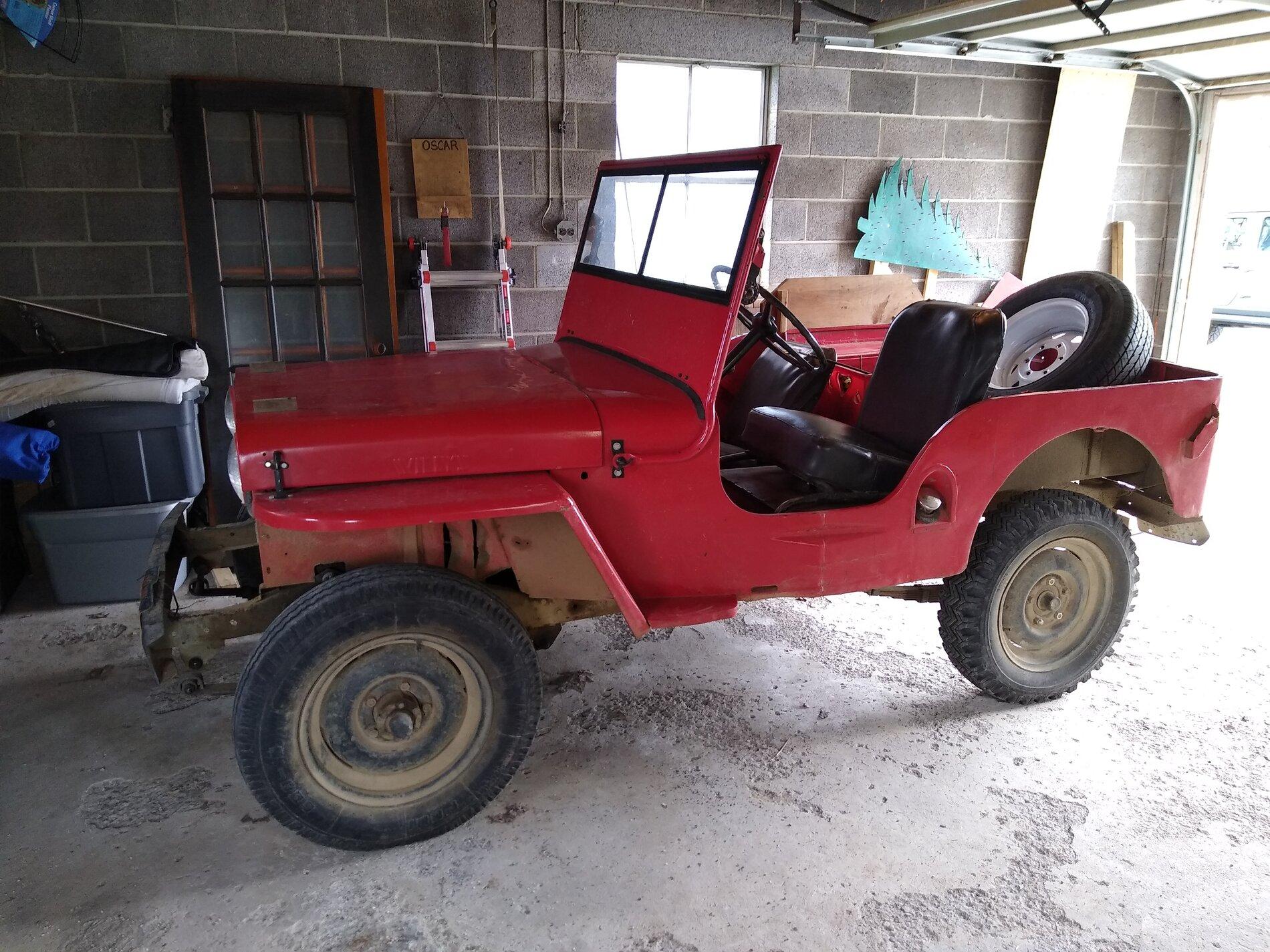

Those. Are. Perfect. I'm rebuilding a '46 Willy's for a friend of the family's right now, so that should cover what I need to place my order. Thank you so much for all that you've done for your customers, even the potential ones!
