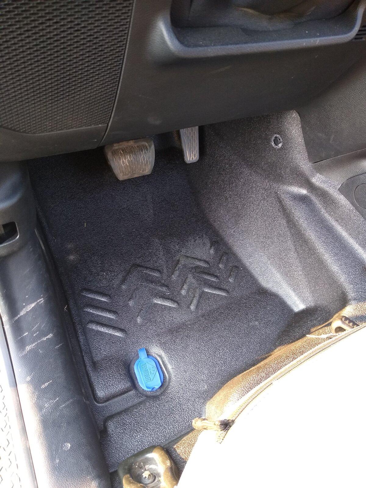

I have a dog and his hair gets into the carpet and is impossible to get out. And since he is a husky, there is a LOT of it too. And while I am not allergic to dogs at all, he gets pollen on his fur and any of it swirling around can irritate me. It evades the mud mats easily.
And my kid plays a lot of baseball and is always dusty and dirty, that too evades the mats. So does beach sand, biking dirt, crumbs, you name it.
So did the Armorlite full interior today. Not a bad install, 30-60 is generous, plan for 90. I had male torx heads on my seat, their instructions show female, but the normal sockets work fine. Did have female on the under seat storage.
It's a straight forward install, everything fit very well.
Cut so well fits snugly around the under seat vents.
warning, graphic nasty content. I could have vacuumed some of this up but it never gets actually clean. All of this evades the mud mats.
Never gonna get this out of the carpet without seat removal, now will be a quick wipe.
The main offender but my kid is a very close second.
Get one of these.... and you don't get that. lol

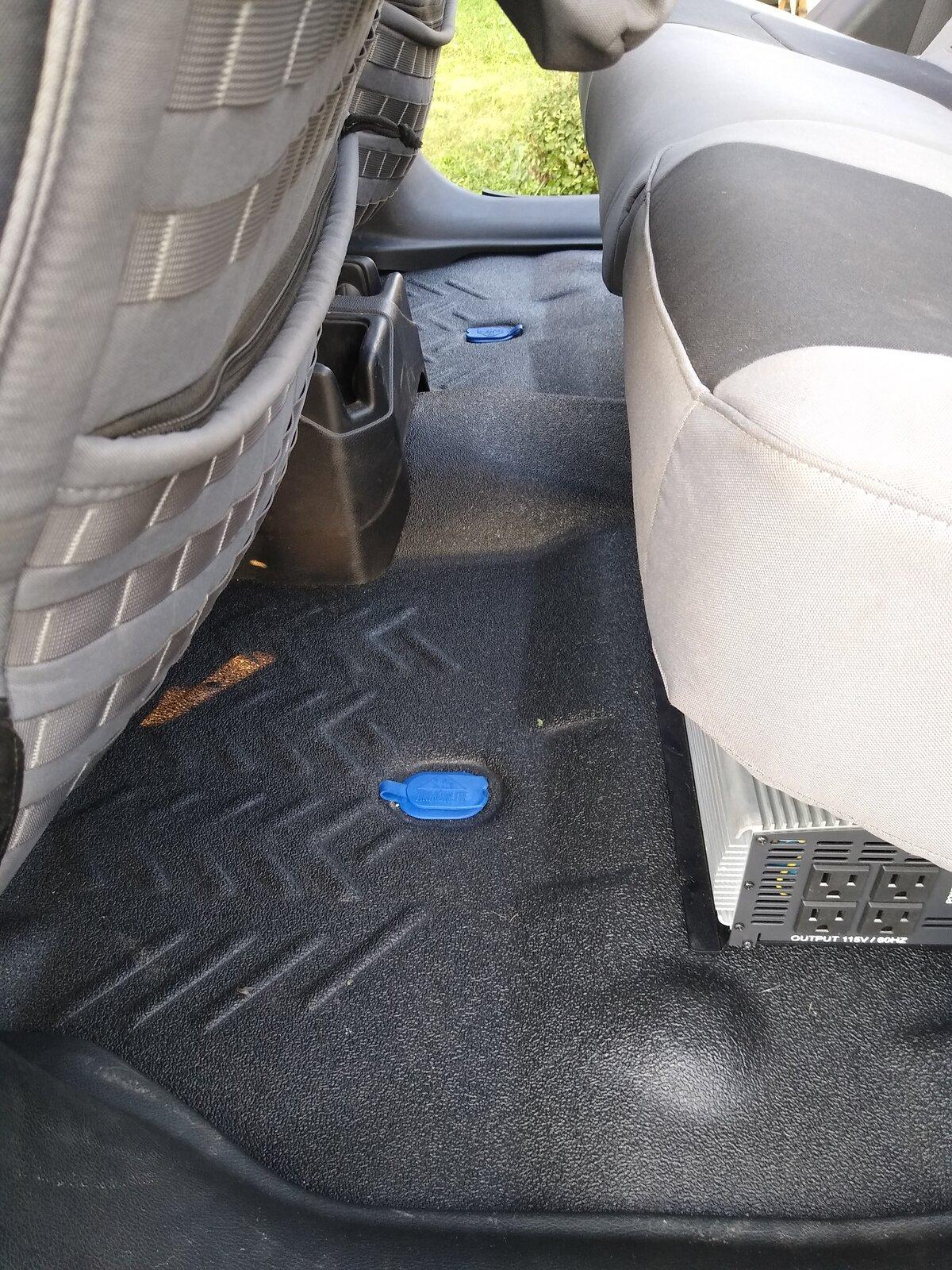

Quick question for those that have installed. Did you remove the two "plugs" that hold the factory liner in place in the rear similar to the front? I'm wondering if I made a mistake by not doing so.
Insert_Clever_Name_Here
May 4, 2019
220
295
SE PA
2018 Ford Raptor, 2016 Jeep JKU, 2020 JT Rubicon
This is what got me! Took me forever to figure out what was going on and made me hate life for a bit haha
I left the front one toward the center console in but loose. I was still able to install the flooring and the seats were very easy to get mounted back up.

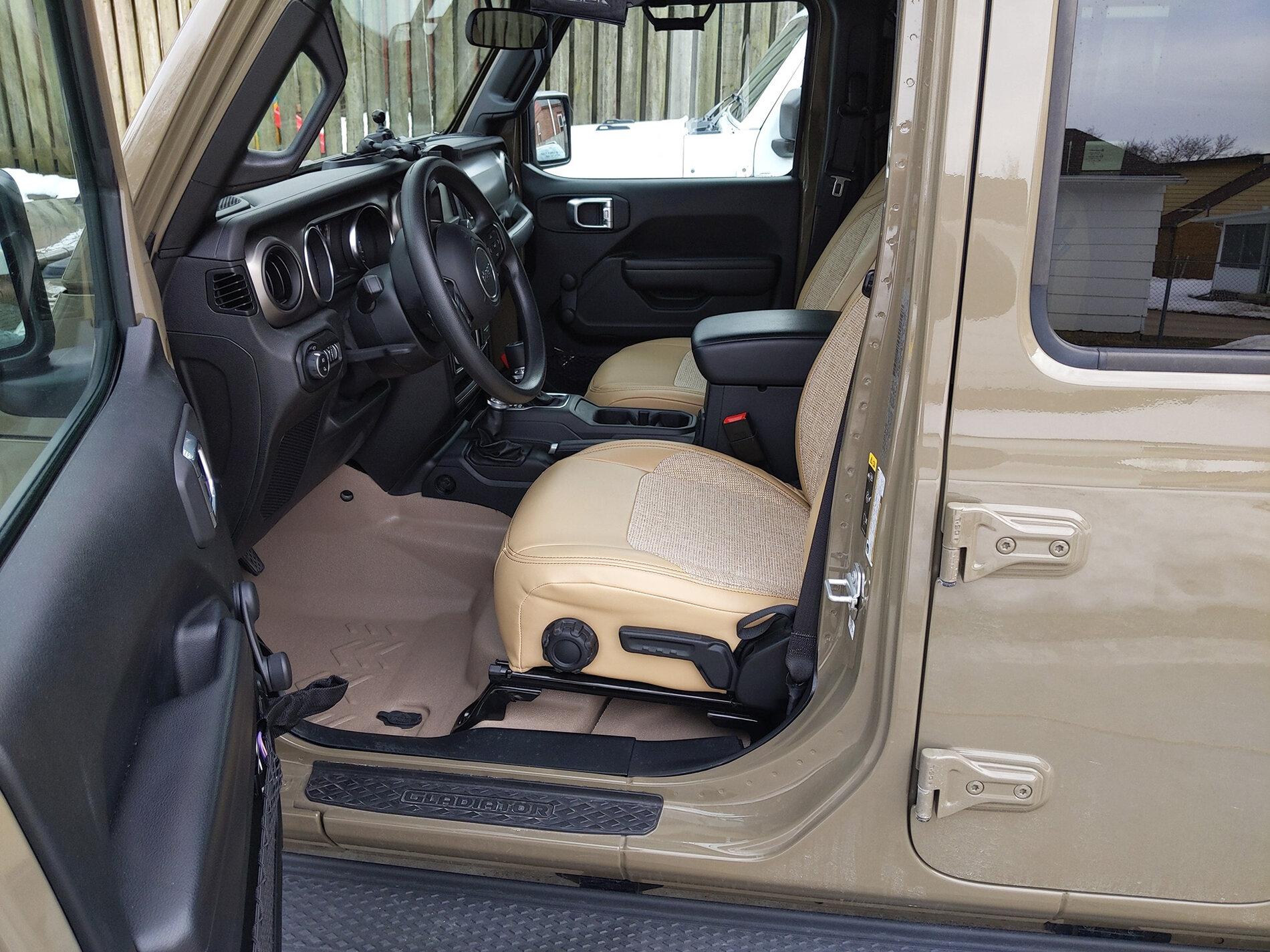

Anyone have pics of the tan? Debating order, and if so stuck between black/tan. I have a Gobi and color matched the dash, but black leather, so probably black.
jebiruph
Jerry
Dec 9, 2018
638
599
IA
2018 Wrangler JL 2019 Cherokee KL 2020 Gladiator JT
The tan will look awesome in a Gobi, here's what it looks like in a Gator with PRP seat covers.
