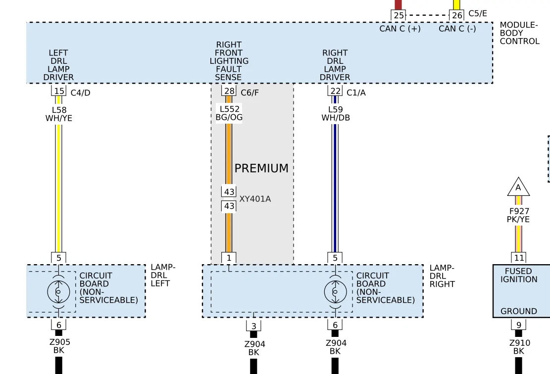

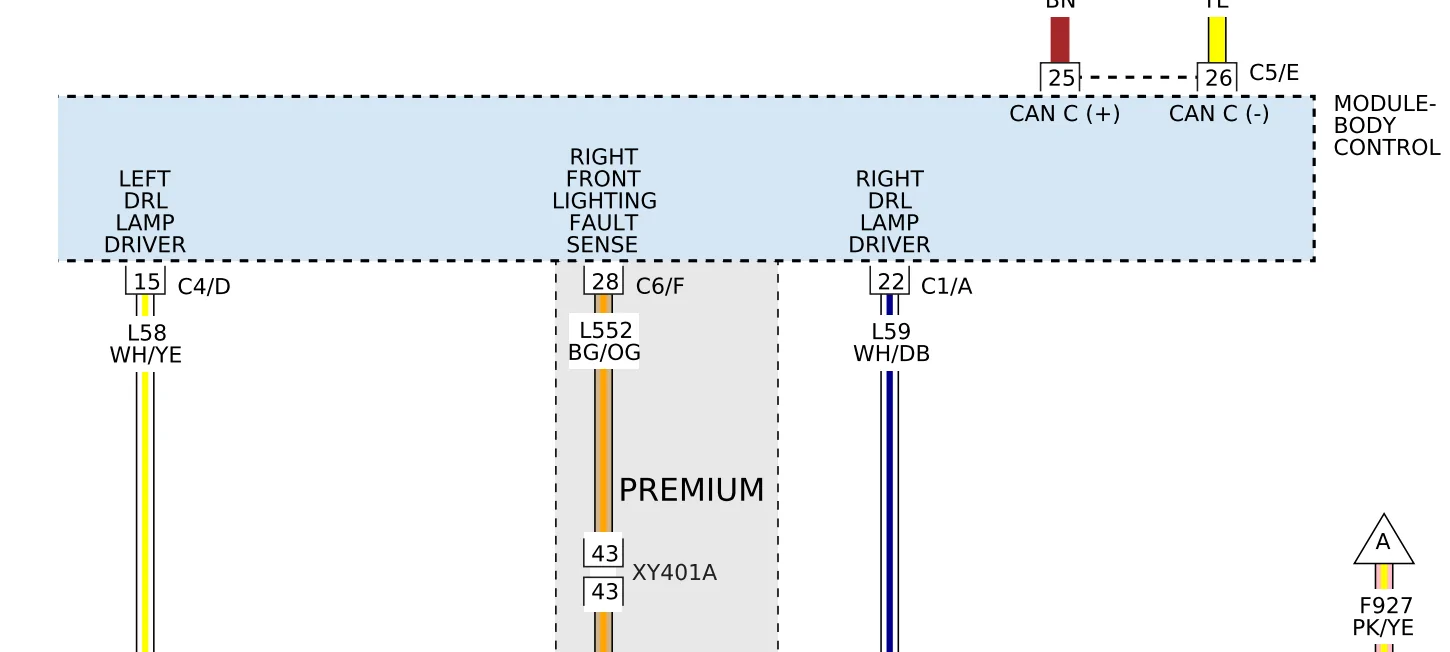

The BCM is what controls and ultimately powers the lights. Here are the wire colors and where they go - to the BCM............

I showed the BCM and wiring above - it's driven directly from the BCM.
See the image I posted showing the WIRE COLORS and the BCM directly driving the lights.
Here is a more complete view. This is how most of the lighting is handled.
