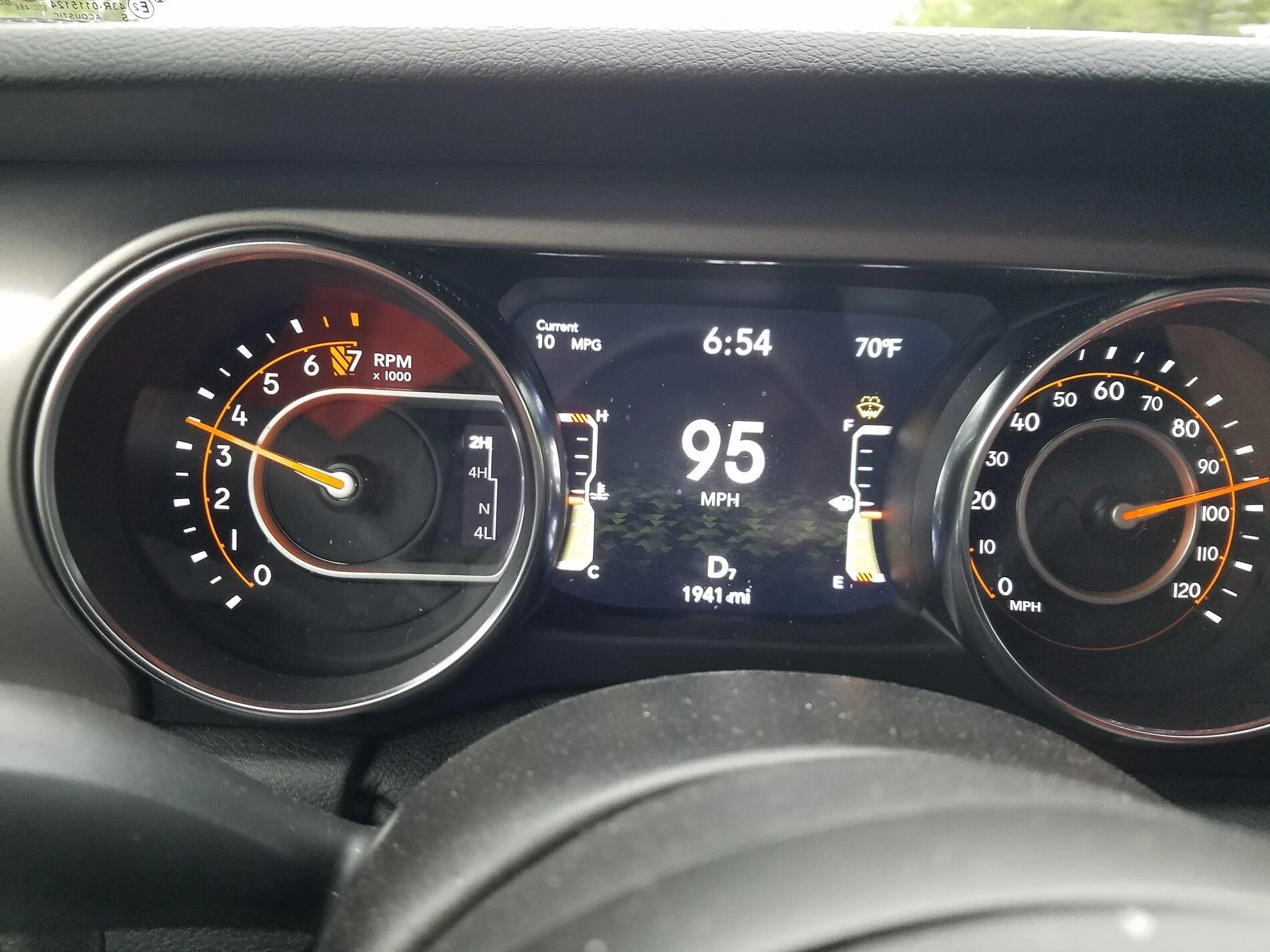

ok, gotta say it, 90MPH and you're worried about a wobble? Hell, you're lucky the entire thing didn't fall apart. Jeeps are governed at 96MPH so you're pushing it's limit every day.
No, THIS is pushing the limit, heh:

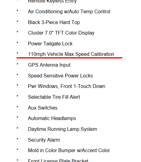

Although, if there is a 96mph limiter, why does my build sheet say this?

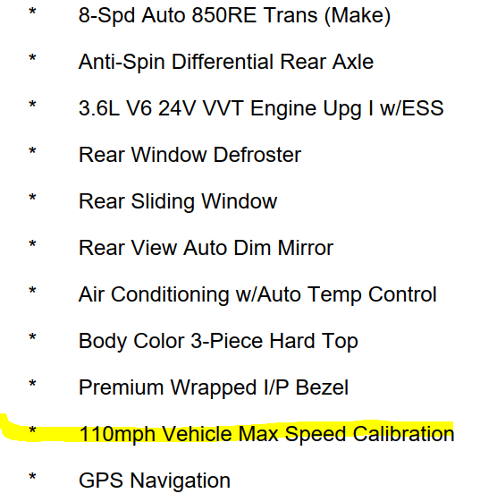

Must be the trim level.....this is mine -

Only the ones that come with mud tires are limited at 97MPH. It's to keep it within the speed rating of the tires. So Rubicons and Mojaves, if factory equipped with mud tires, and maybe Willys's too. Your Max tow came with highway tires, so you get a higher speed governor. That being said, I think I'd soil myself if I hit 97 in the gladiator, and I've owned plenty of fast cars before. But on the Gladiator, I hit 85 in it once. That was more than fast enough for the Gladiator on mud tires and Rubicon suspension. I bet your Max tow is more stable at that speed though.
