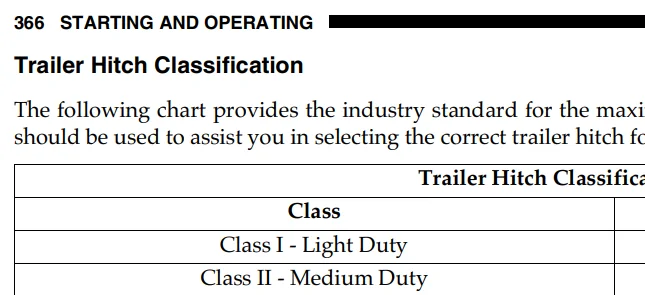

366? Trailer towing......

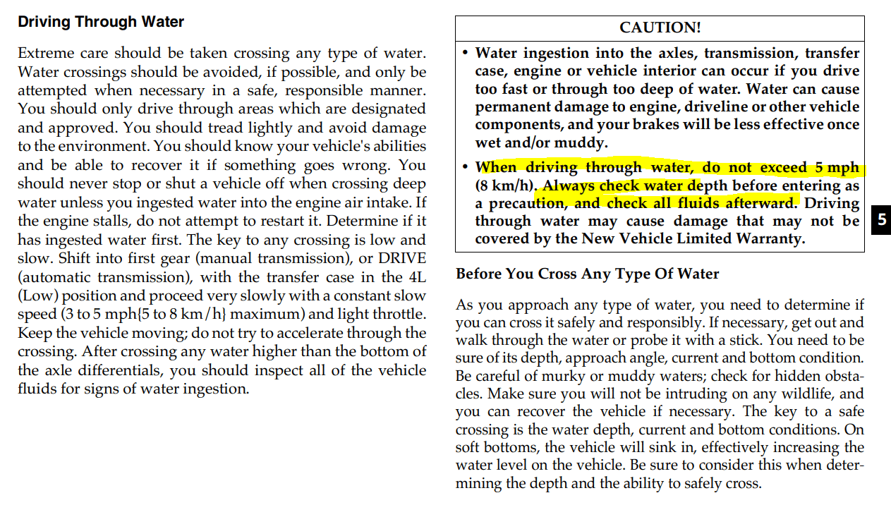

379 for mine............
Jeep recommends 3-5 mph for water.
If you think about it, what's mud but dirt and water, so driving over 5 mph through the sort of mud that splashes onto the roof and runs down the windows like dirty rain it asking for trouble when they specify 3-5 mph.
The sort of mud in the pics is what I consider dirty water. It's not big chunks of wet dirt, it's water with dirt in it.

The sort the OP went through should also be treated as going through water. MUD is thrown up by the wheels, water splashes, like the video.
That's splashing exactly like water. 3-5 mph is what the book says, they also warn of the potential for damage. (as per snip from manual)
That's WATER and IMO a tiny bit more than 3 mph, it's hitting a pool of water pretty hard.
I'd also just suggest that from the looks of the truck before it enters that water - it perhaps wasn't the first time through?
You can call it what you want, and there's mud all around that puddle, but the picture shows driving through WATER, splashing water up over the roof several feet into the air - water that's loaded with sand, silt and grit.
You highlighted the wrong sentence...
