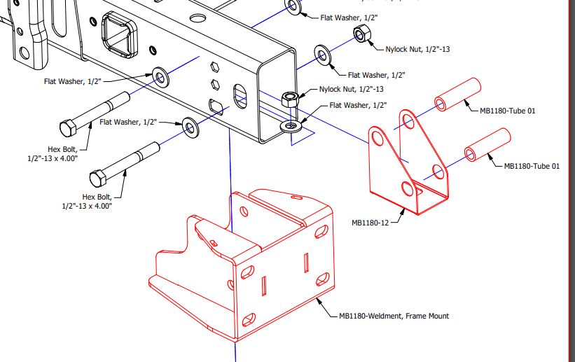

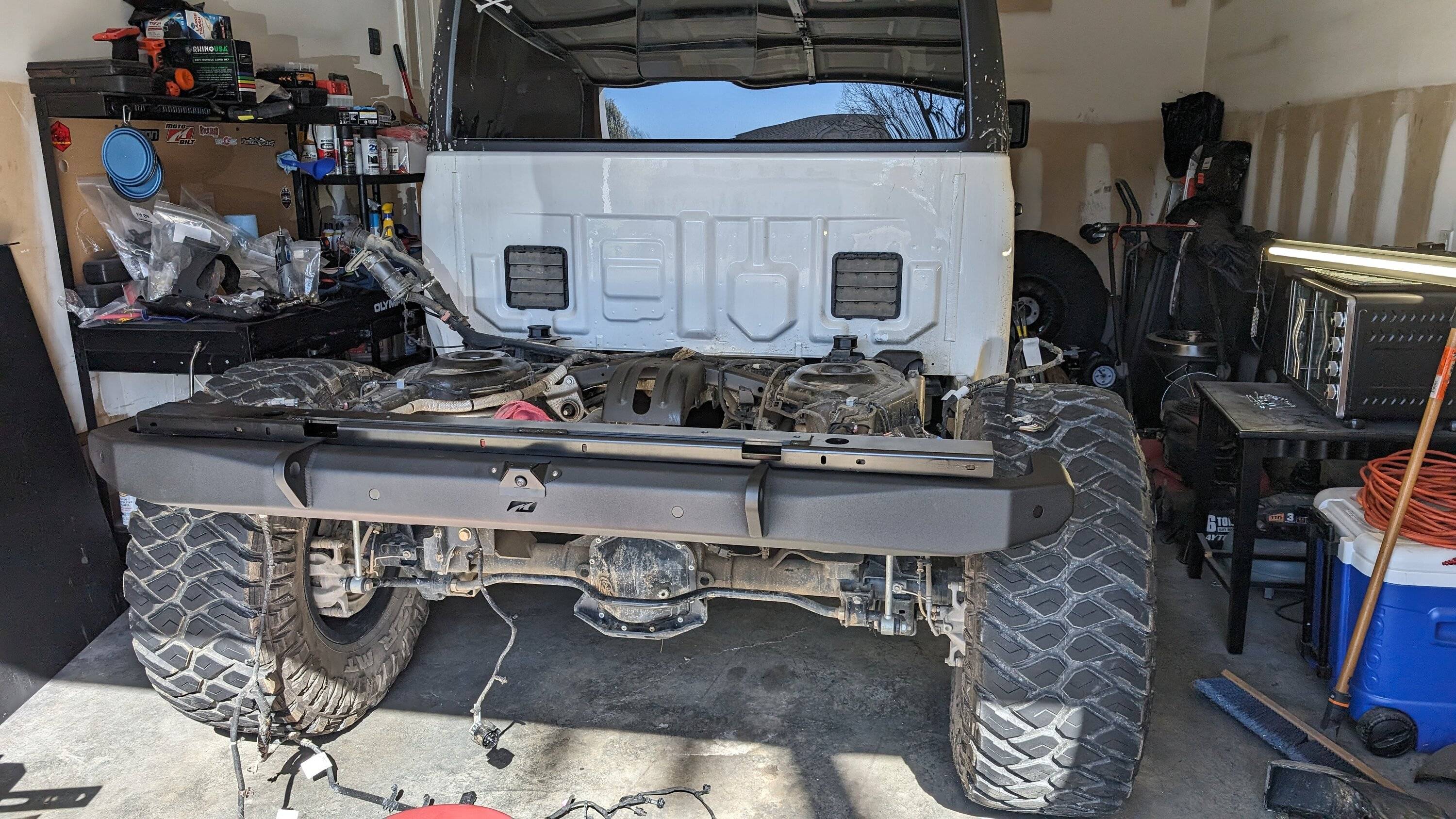

Finished the bumper mounts and bumper last night, added the crossmember to the rear and the spacers to the front bed mounts.

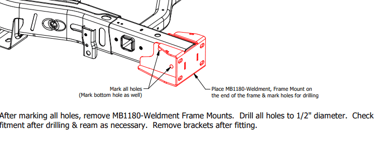

A little bit about the bumper mounts - this was the second hardest part of the build so far.
Now the directions are like put the mount on, mark the holes, drill them out to 1/2".
Jeep Gladiator W.T.F.D.I.G.M.I - Turning my daily drive into a trail rig. BumperMountScreenshotONe
No biggie, but the very next step, you are also inserting part of the mount inside the frame, which also has to line up with those holes, but doesn't have any movement.
Jeep Gladiator W.T.F.D.I.G.M.I - Turning my daily drive into a trail rig. BumperMountScreenshotTwo
So if I was to do it again, I'd only drill the pilot holes, insert the interior mounts and readjust the holes accordingly.
I didn't do that this time, so I have slightly elongated bolt holes, but not to the extent where it should cause any failures.
Overall very tight fit but feels secure and snug once mounted and tightened down.
There was a 250+ lb guy bouncing up and down on the bumper this morning and it held him, don't know who that weirdo was... ??

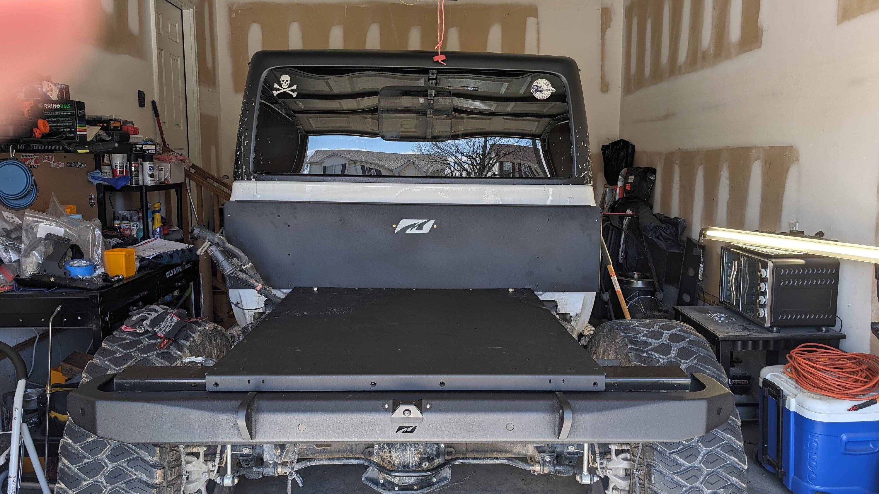

Jeep Gladiator W.T.F.D.I.G.M.I - Turning my daily drive into a trail rig. PXL_20240311_173518552
Big time progress, but time for the first batch of Tylenol as well. Those two pieces the bed floor and back cab wall are the heaviest individual pieces of steel and mounting that back wall calls for you to be double-jointed or a contortionist monkey....
The lip of the cab wall piece, sits below the lip of the floor and is attached by 3 countersunk screws, that you are supposed to reach behind the wall and attach from the bottom.
Pro-tip - I grabbed my unpaid, forced laborers (aka kids) and we moved it all back (towards the rear with the bed floor overhanging the bumper by about 2 ft. This allowed for easier access to start the nuts on those countersunk bolts, then we moved it back in place.

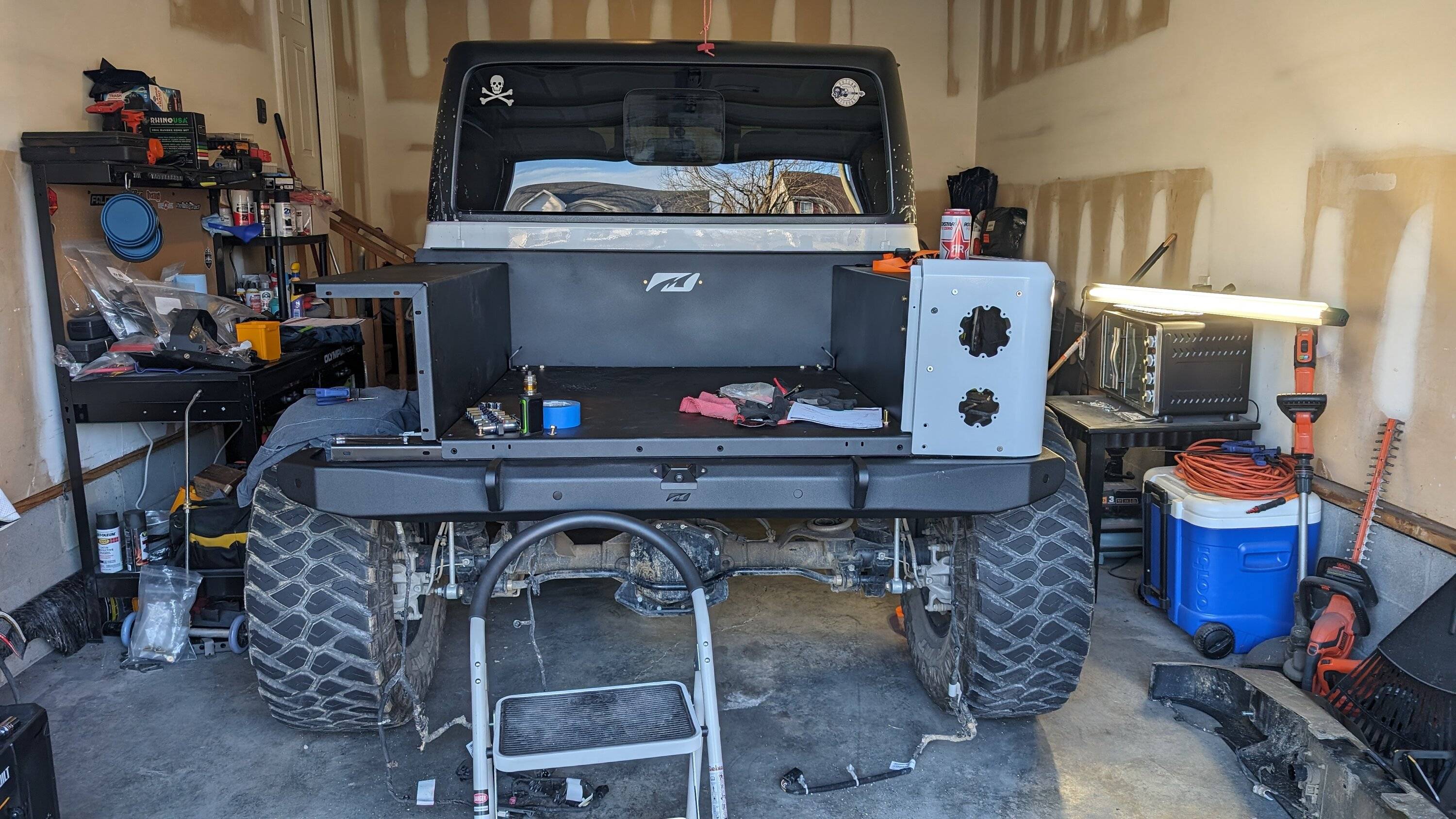

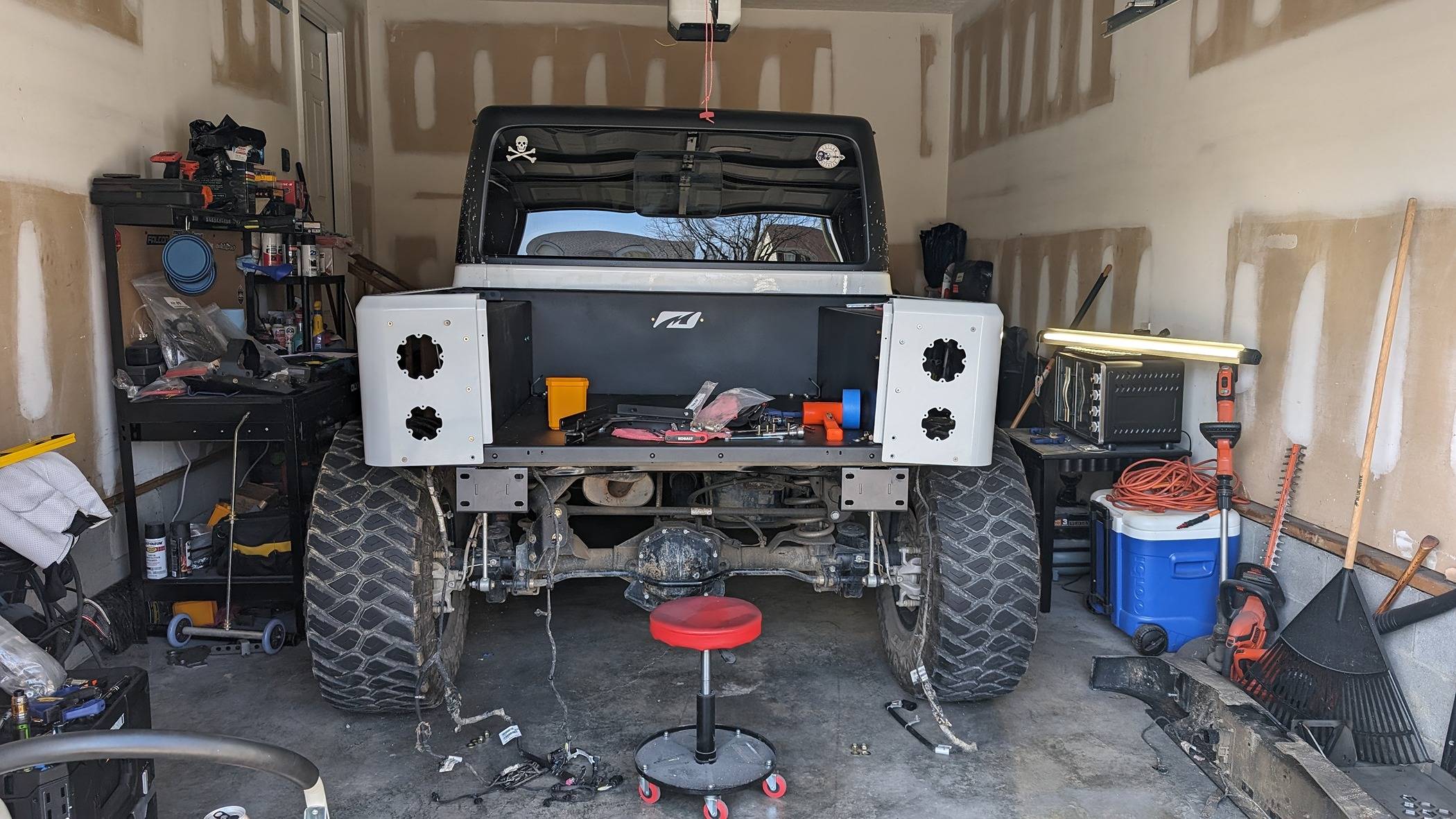

Current status - cleaning up for dinner but here's where it's at now. I'll write up notes on the side panels later.

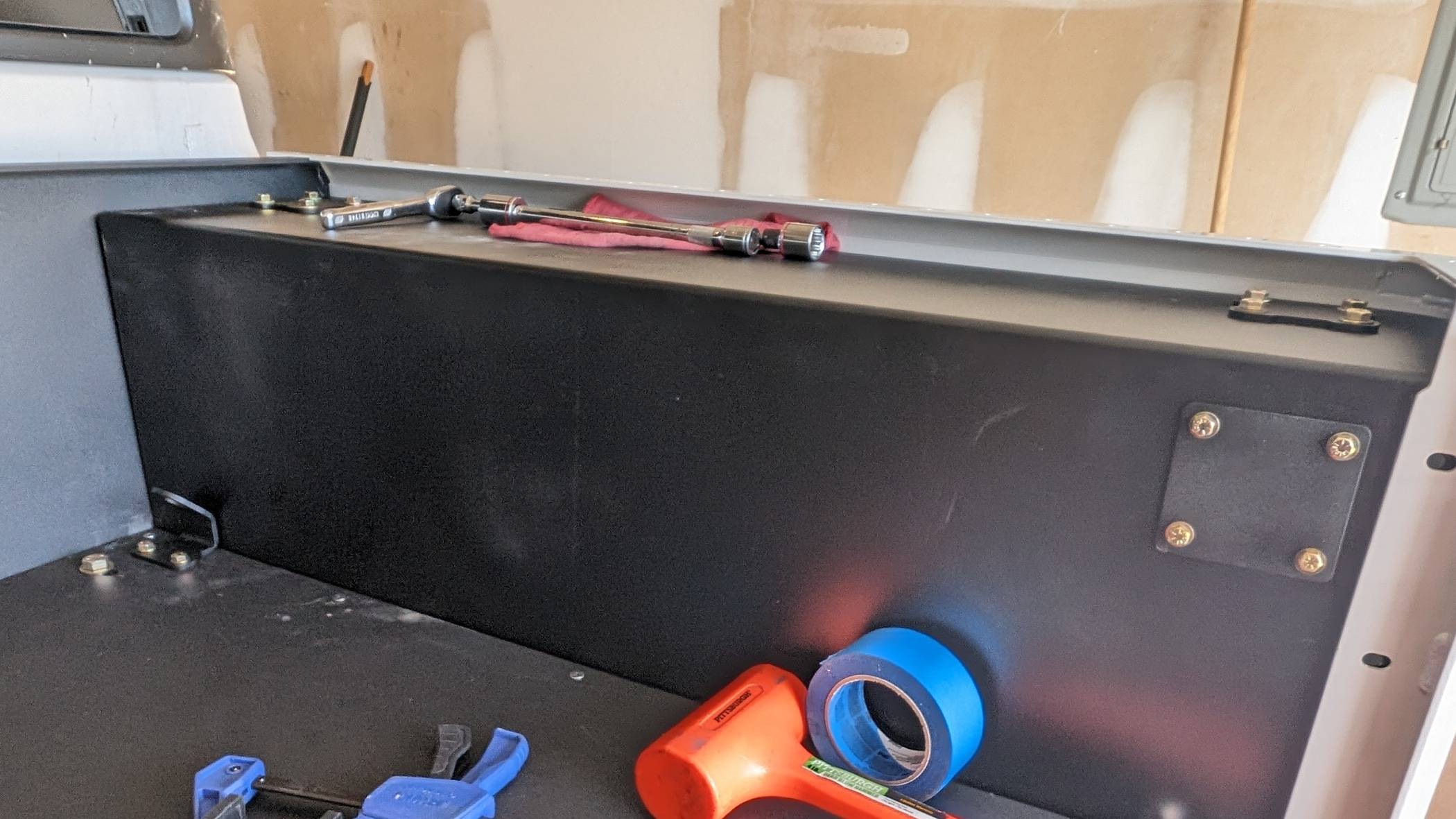

Thoughts on the walls -
Some of those bolt holes require some ingenuity to get to if you got thick/big hands...
I used some more forced labor from the kids to help push, pull, hold, and shove things the right direction for some of the bolts.
I used needle nose pliers to hold washers and then bolts in a couple spots my hands wouldn't reach.
I used a combination wrench and a small piece of painters tape to hold a nut and washer in other spaces, I couldn't reach...
On the passenger side, I've still got like 5 bolts to get in holes. I'll get them squared away in the morning and get the rest of the driver's side on after fooling with the fuel filler nozzle hacks and location.

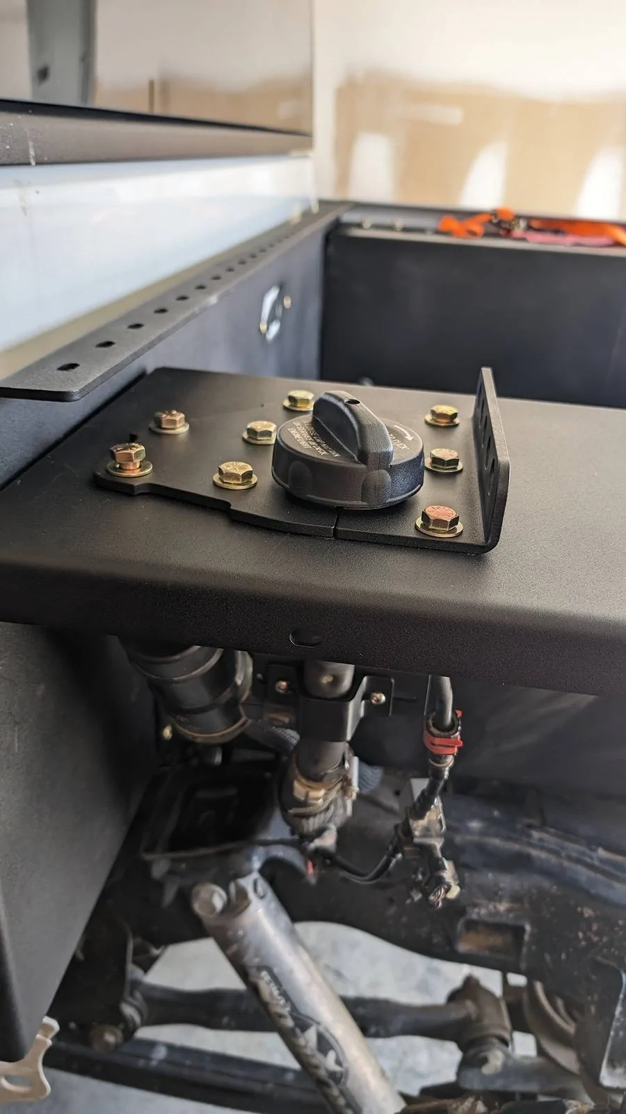

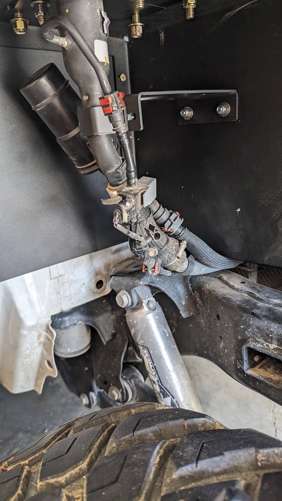

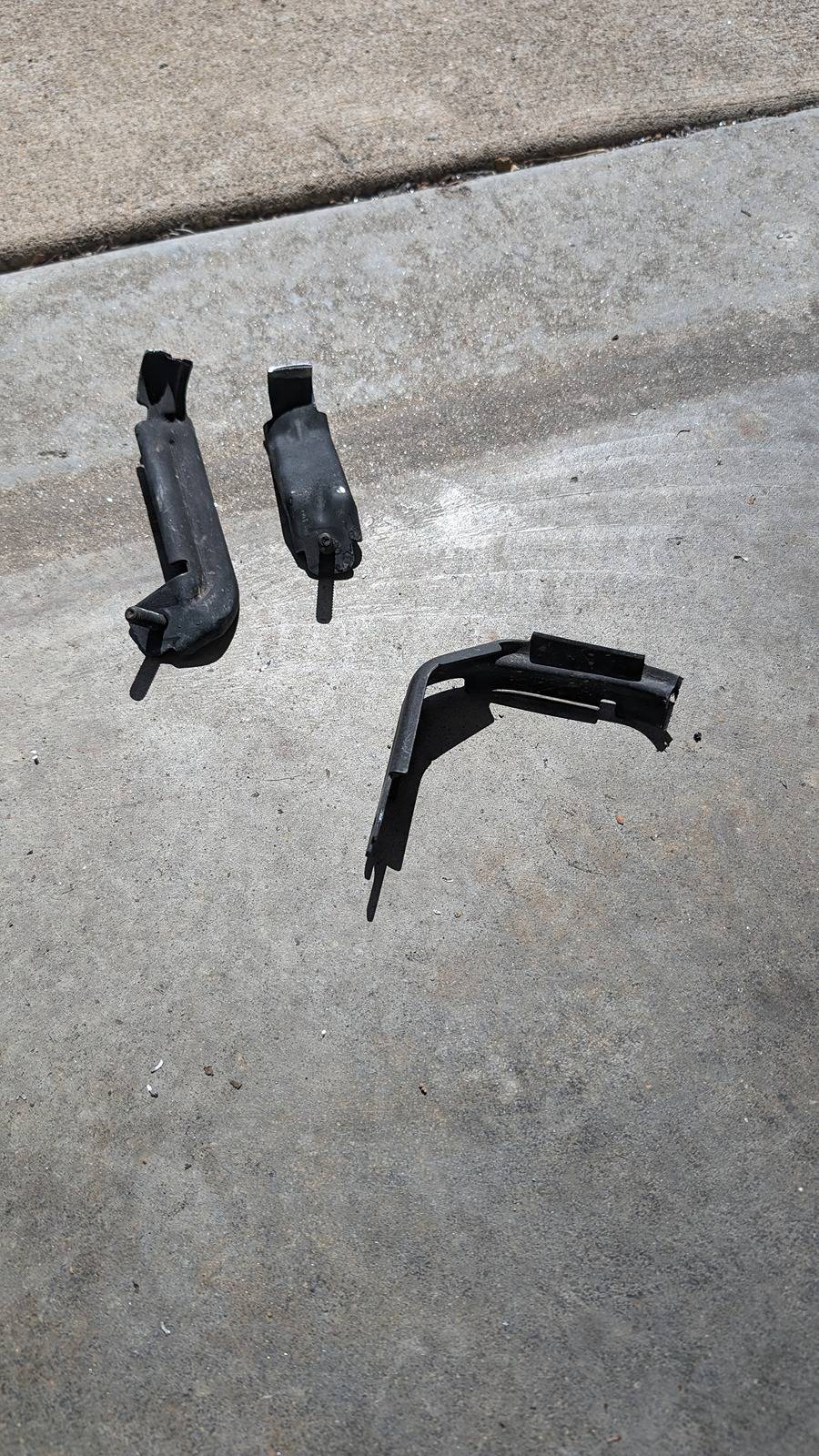

Started off the day with tackling the fuel filler, it ended up being more mentally intimidating than the actual work to take care of it, these are the small brackets that I cut off -
Jeep Gladiator W.T.F.D.I.G.M.I - Turning my daily drive into a trail rig. PXL_20240312_174239538
New set up mounted -
Jeep Gladiator W.T.F.D.I.G.M.I - Turning my daily drive into a trail rig. PXL_20240312_174249043
Jeep Gladiator W.T.F.D.I.G.M.I - Turning my daily drive into a trail rig. PXL_20240312_174252550

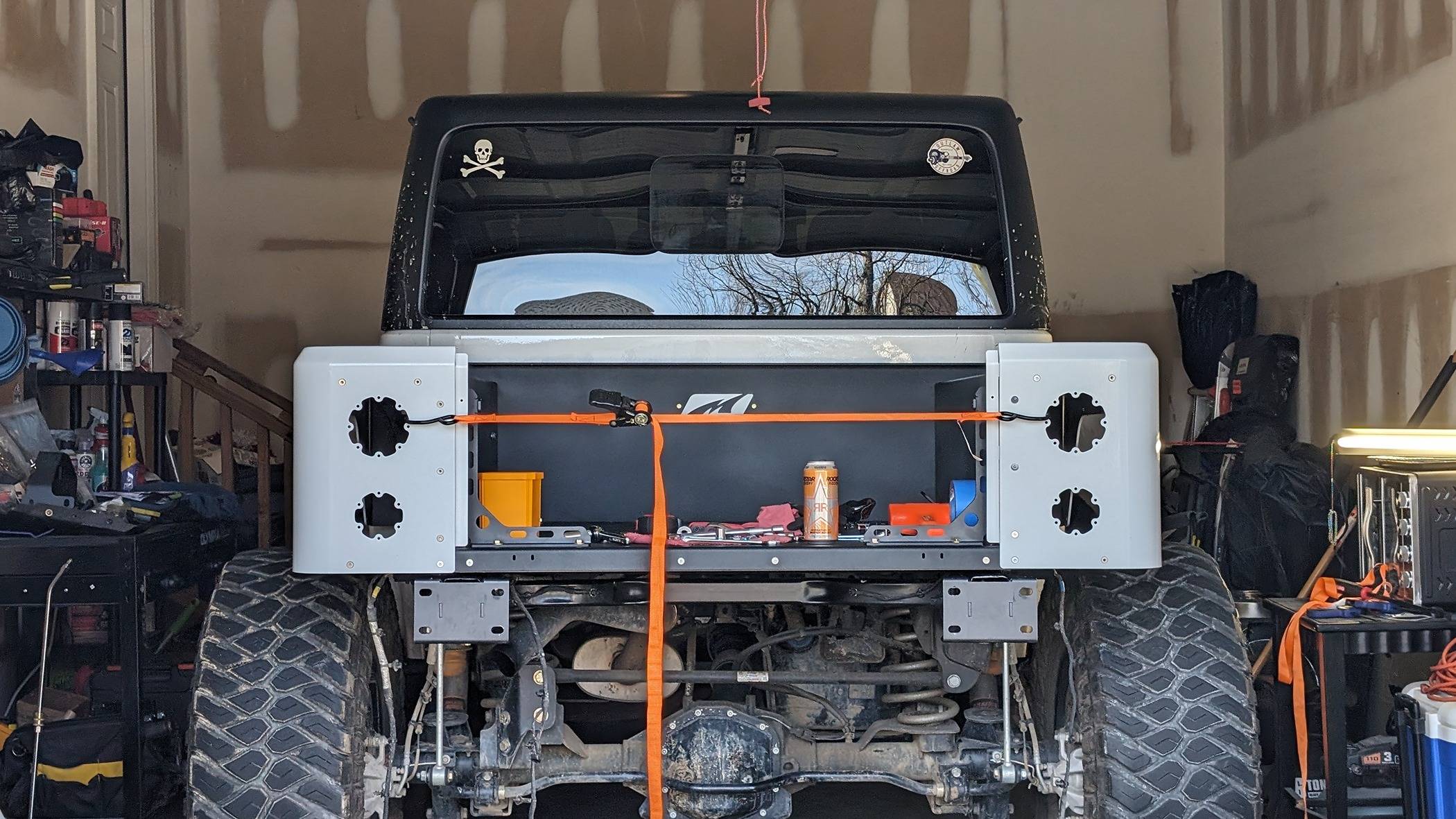

Got the other side on next -
Jeep Gladiator W.T.F.D.I.G.M.I - Turning my daily drive into a trail rig. PXL_20240312_194454895
Got it squared now -
Jeep Gladiator W.T.F.D.I.G.M.I - Turning my daily drive into a trail rig. PXL_20240312_211736927
I'm at the stage of the instructions where I have to go back and tighten the 60+ fasteners they've told me to leave loose until now....................

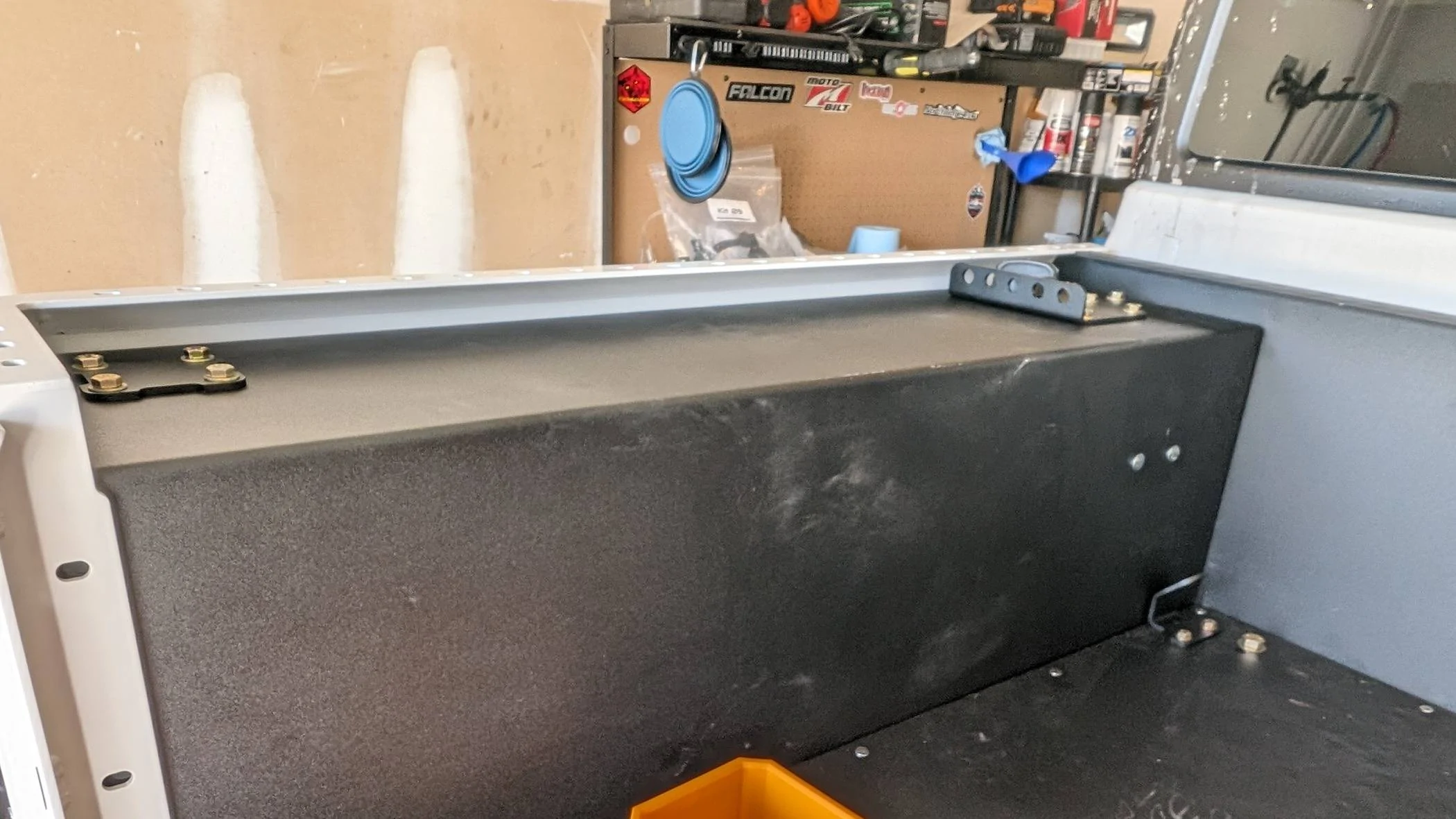

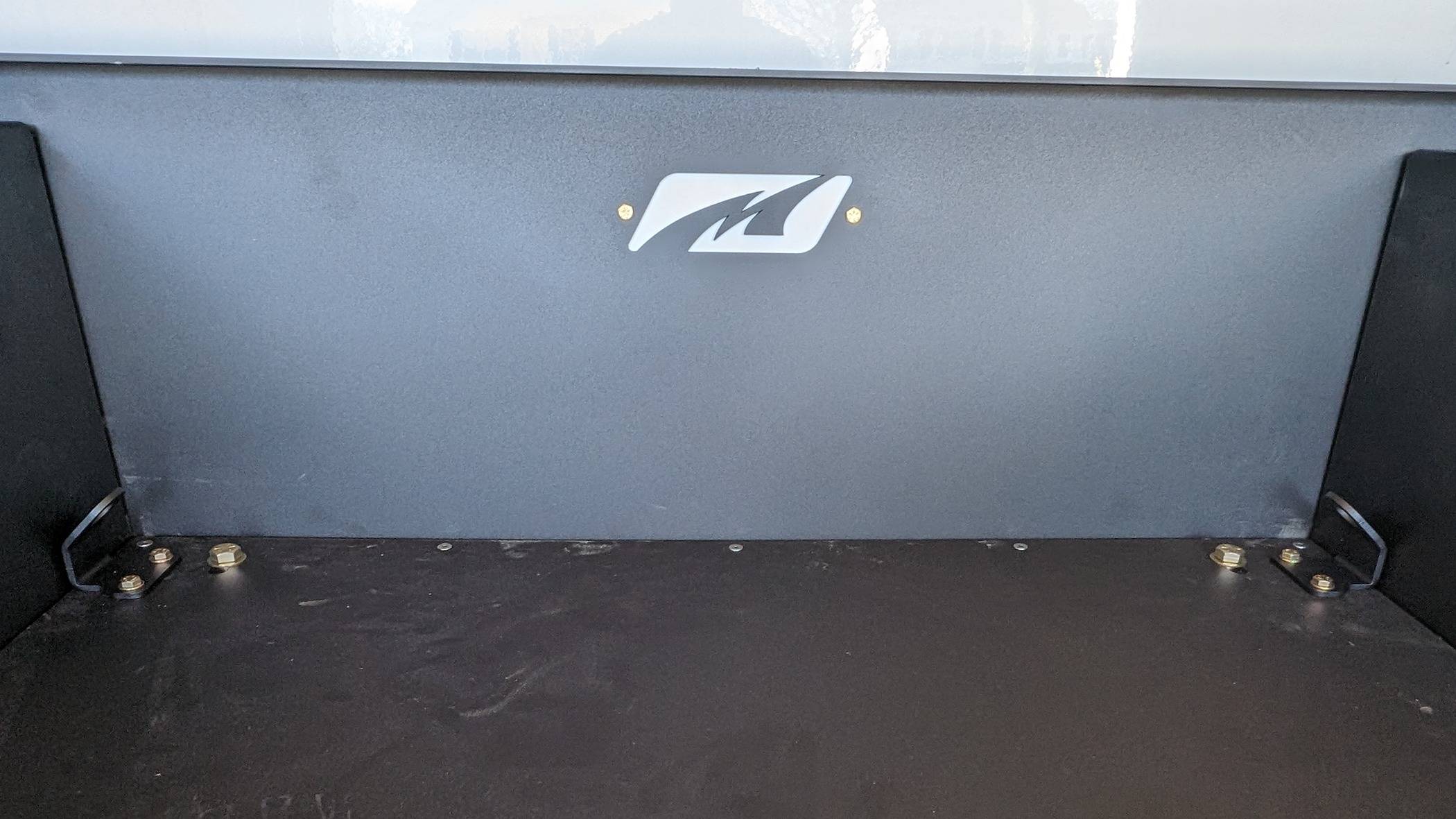

Random bed pics -
Jeep Gladiator W.T.F.D.I.G.M.I - Turning my daily drive into a trail rig. PXL_20240312_194509199
Jeep Gladiator W.T.F.D.I.G.M.I - Turning my daily drive into a trail rig. PXL_20240312_194514724
Jeep Gladiator W.T.F.D.I.G.M.I - Turning my daily drive into a trail rig. PXL_20240312_194522823.MP
