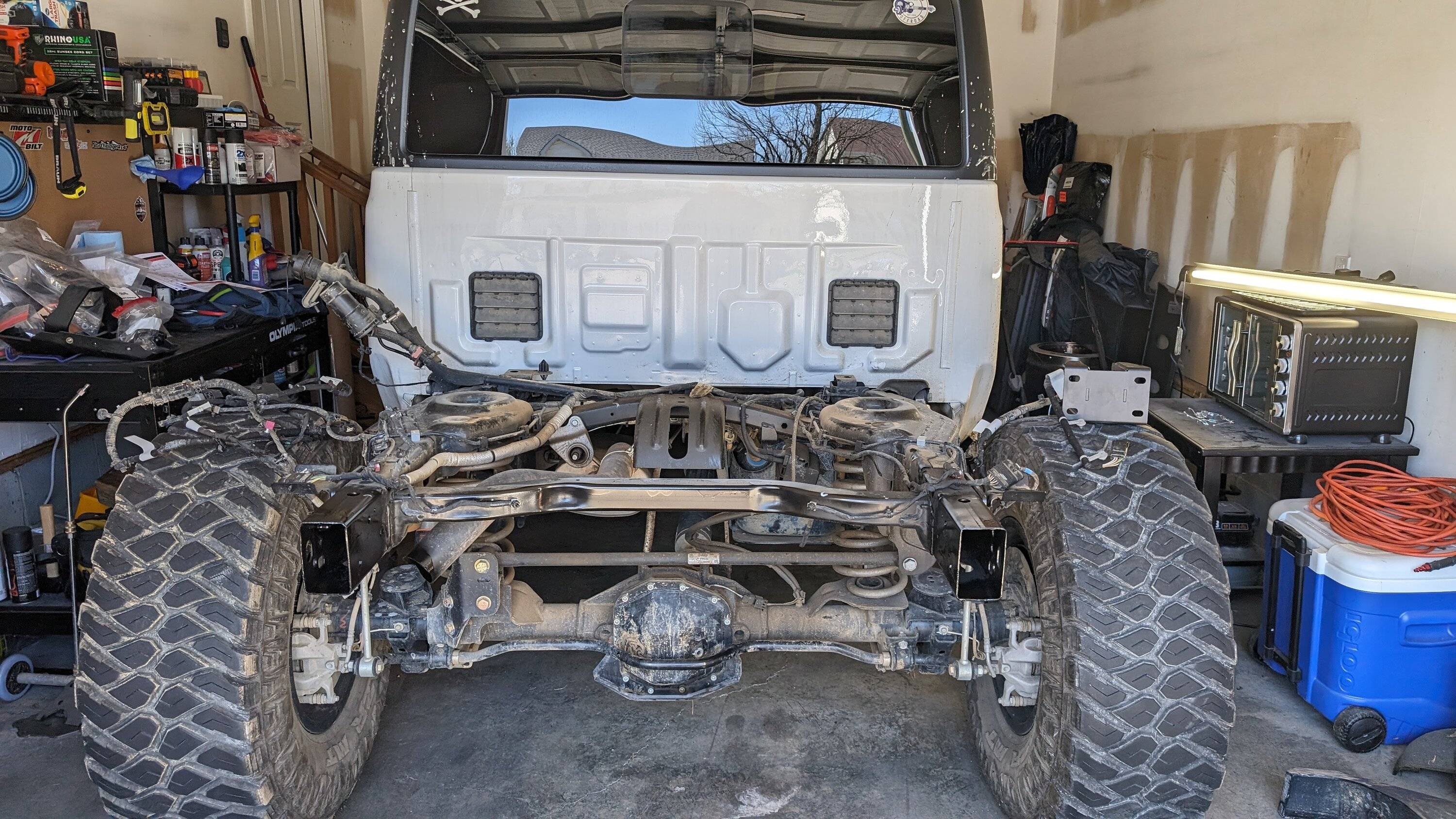

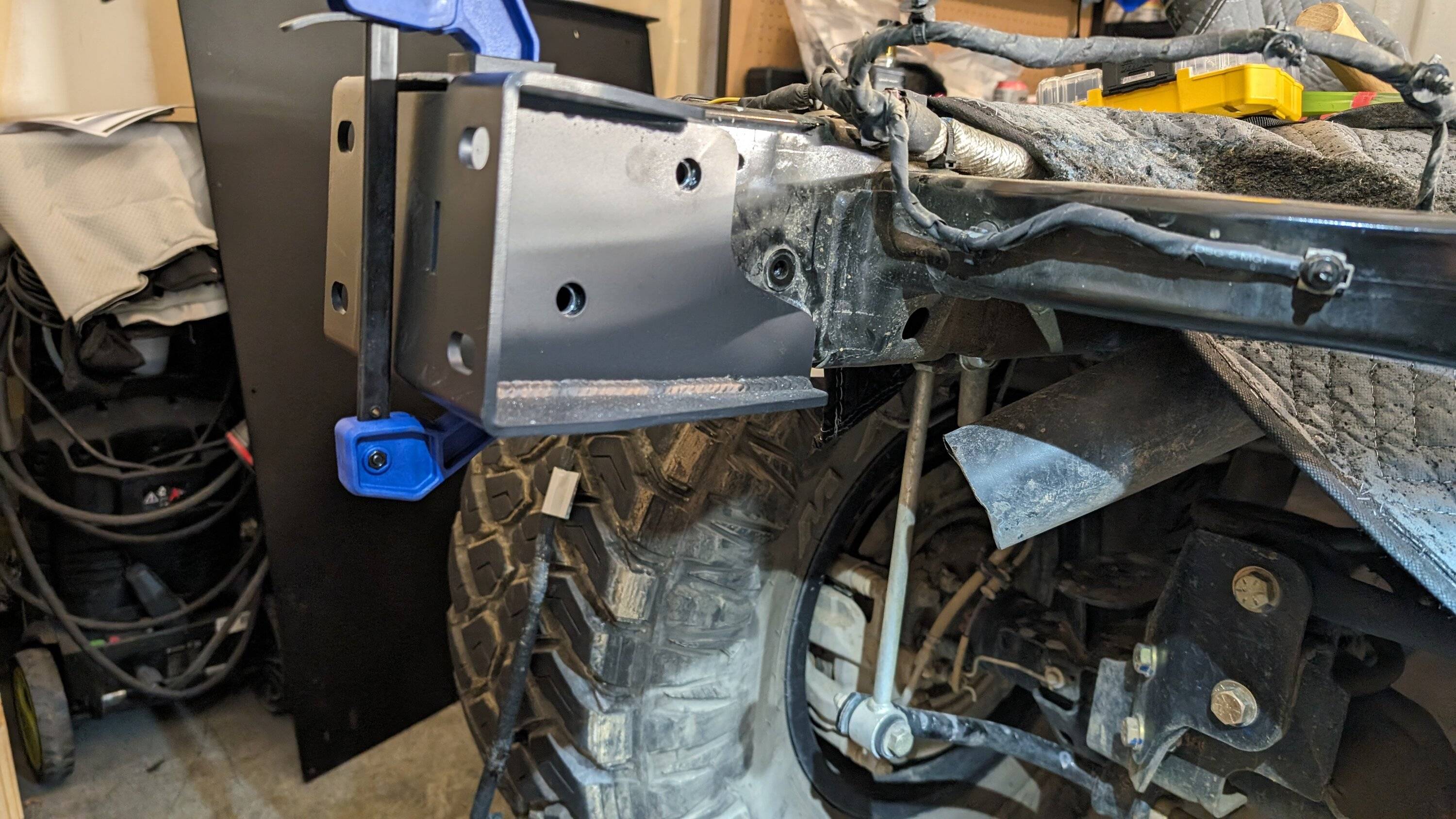

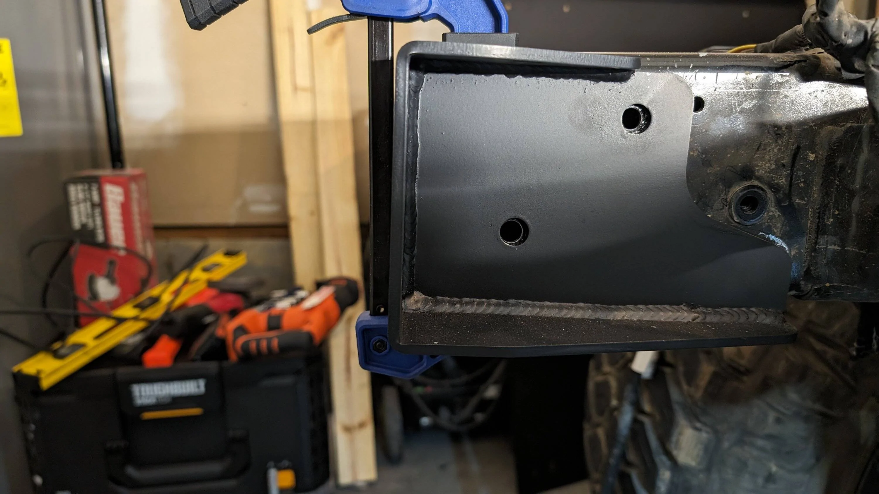

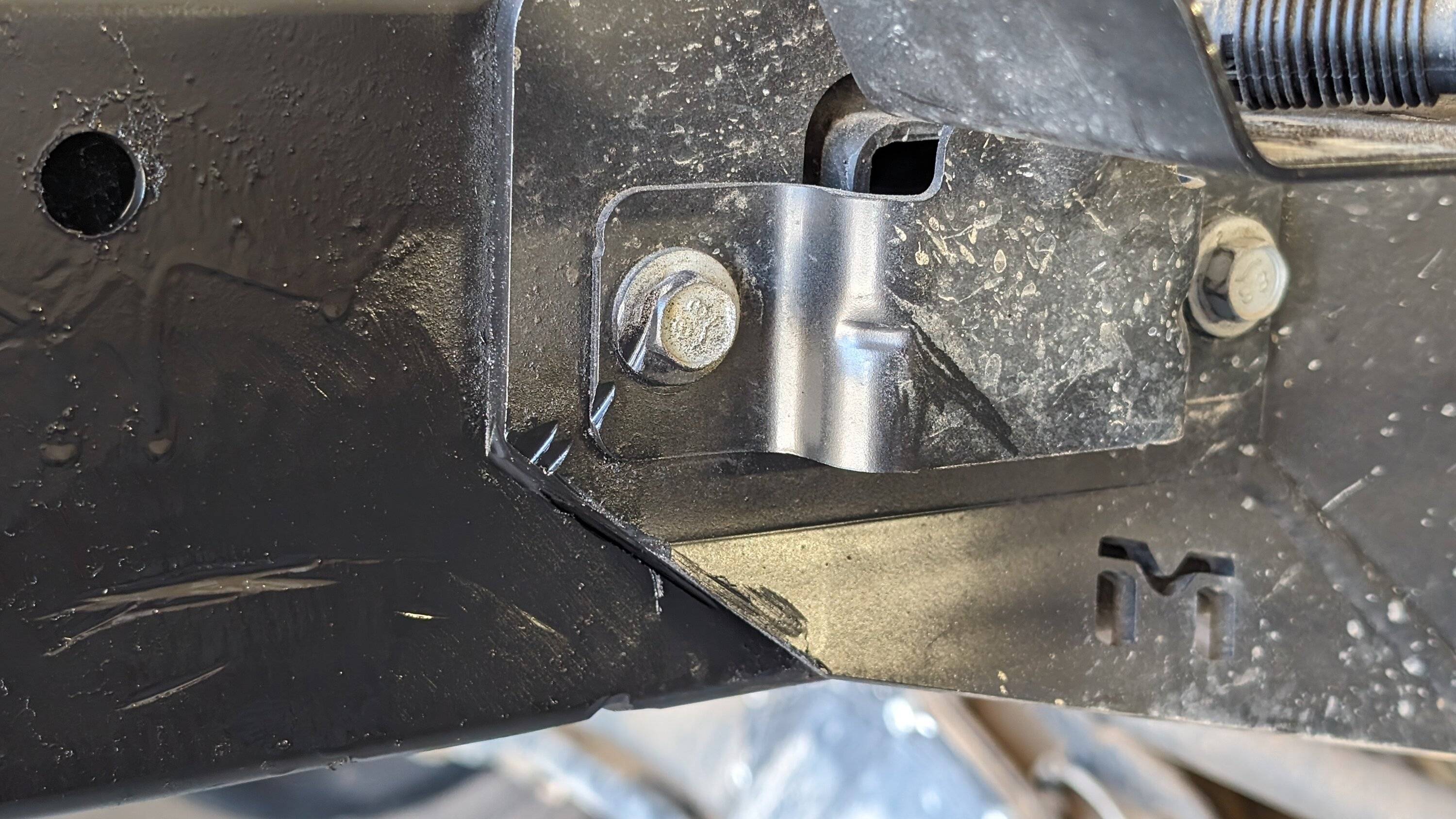

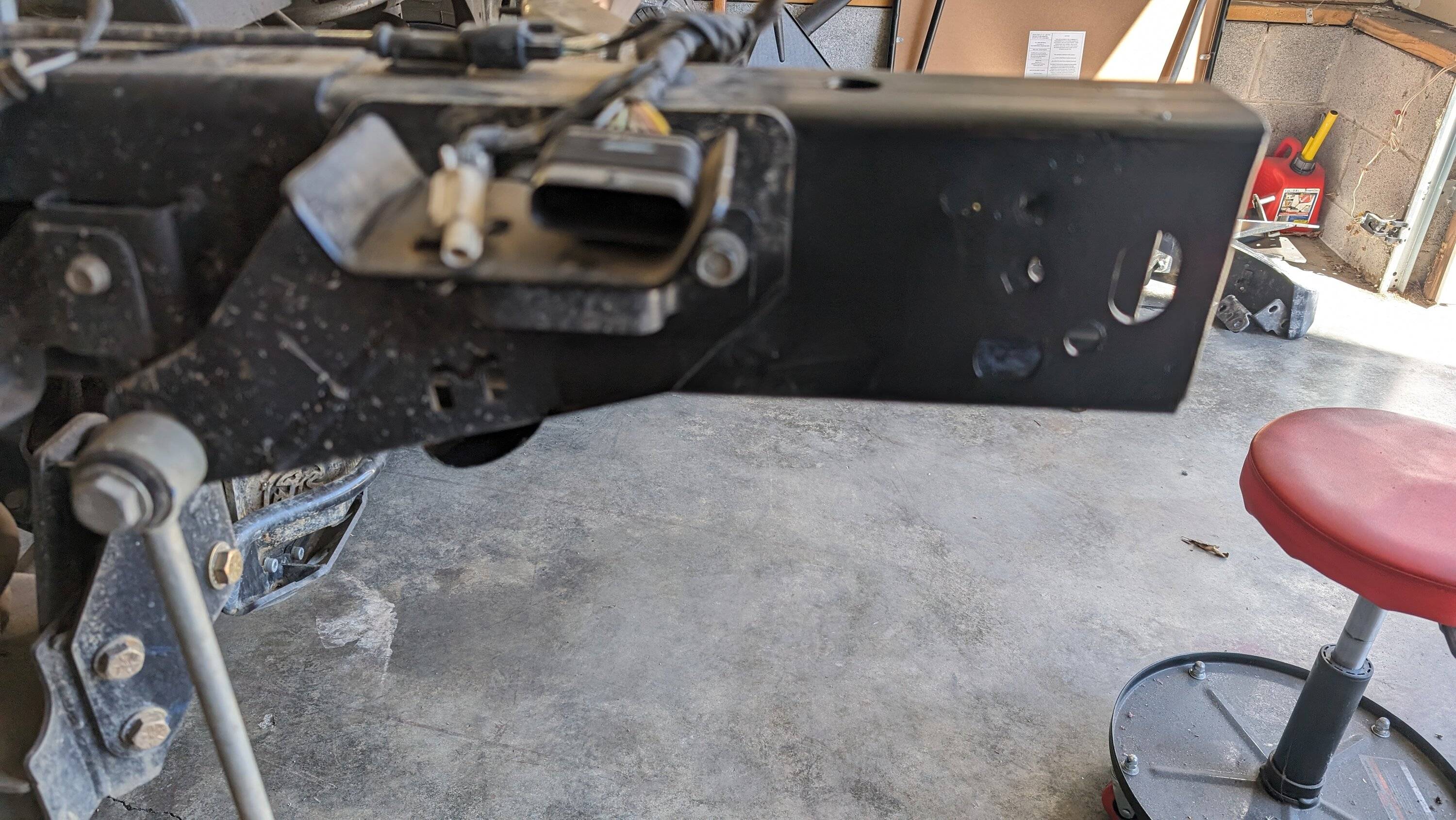

Couple this morning pictures although mostly all I did was clean up, cut the exhaust, drill some holes for the new bumper mounts, and hit all the cuts and holes with some roll bar and chassis paint.
Exhaust cut wasn't clean but it doesn't really need to be..
Step bit worked wonders on the holes, just used a 1/2" bit to wallow and ream them a bit after the step bit.
Some cheap/quick paint and this is how she sits as the paint is drying -
One thing I didn't mention earlier that we had to trim for the bumper mounts were the MetalCloak Rear Sway Bar Reinforcements, they just happen to like the same piece of frame real estate by about an inch or so, so we just trimmed the corners.
Now it's wait on paint to dry ?
Then I'll be ready to start assembly...
