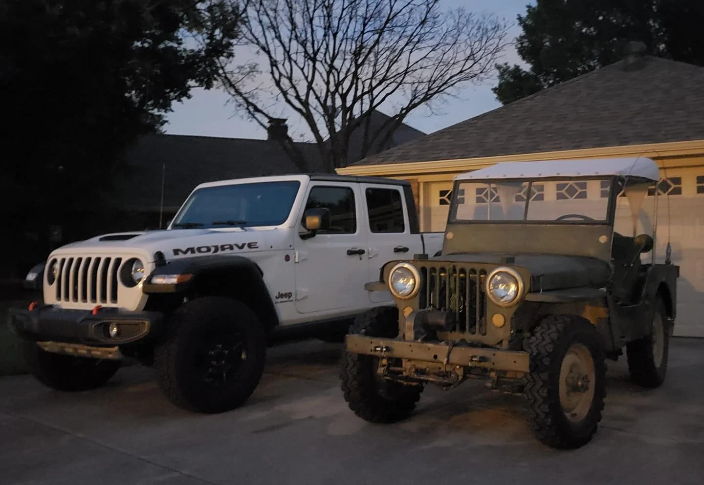

First, I want to thank you for all the info you have on your Farm Jeep page. Currently in the process of making my '47 a little more "farm capable", and your site has been invaluable to me! I went through (more or less) the same thing you are going through. I started out planning on getting a Sport S with Max Tow, since it was rated at 7500 towing capacity and, fully loaded with everything I wanted, was well within my price range. After seeing a Mojave, I sorta fell in love. However it only has a 6000lb capacity. I re-crunched my numbers and figured my 10ft dual axle trailer is ~1000 pounds and my 2a is about 2500, and passengers and gear will realistically never be more than another 500 -750bls, I figured I'd be plenty good. The Rubicon was not on my radar, but I believe it is rated for 7000. Depending on passengers and gear you should be well within limits. As for dealers, this site has at least 3 that should be able to hook you up for up to 8% below invoice with no hassle. Tennessee was the closest to me, so I flew up to Gupton this past Friday morning and drove it back to Dallas Friday night. I worried about the whole "Chip Shortage" thing while I waited on my build, but I had no problems....got everything I ordered, well within the time frame the dealer estimated.
Great picture! And thanks for the kind words. If you want some inspiration for building your farm Jeep, just watch this movie -

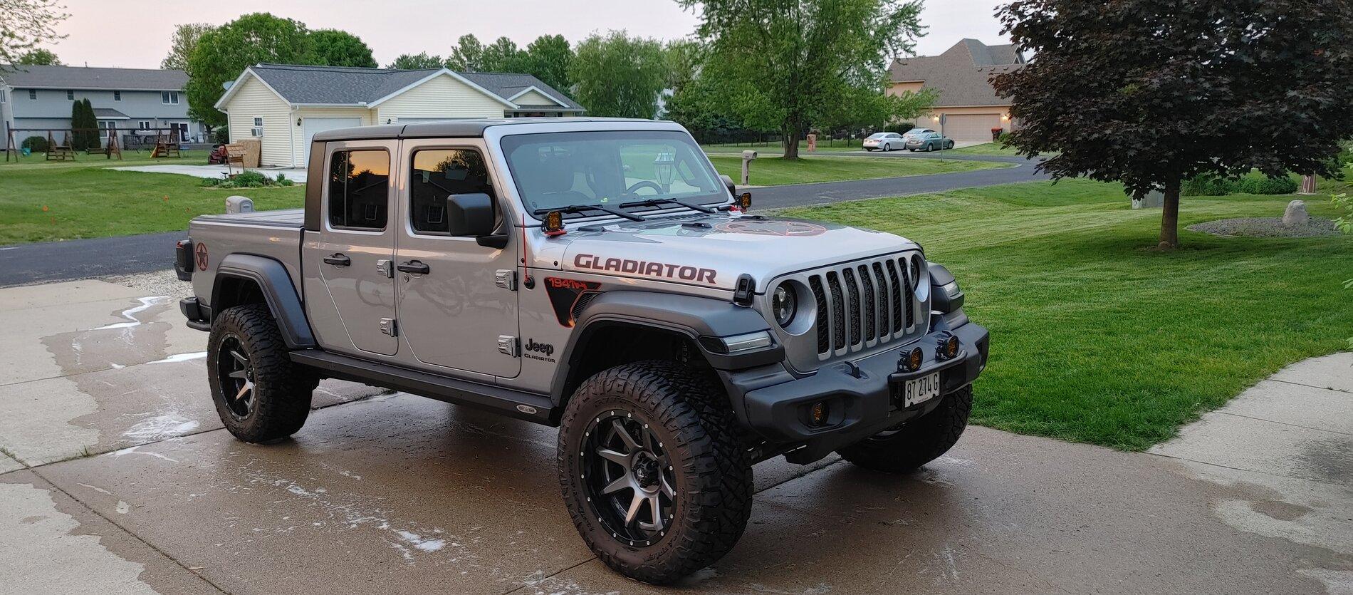

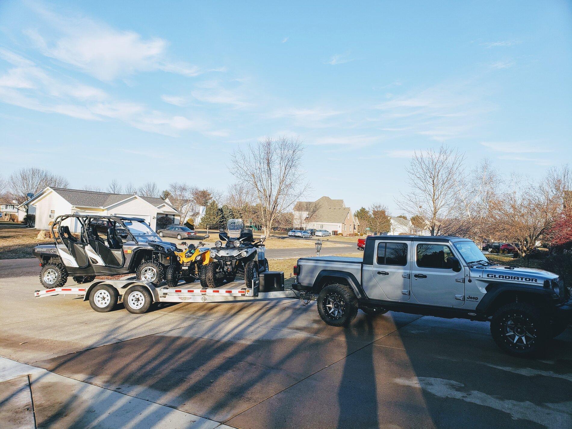

I have not regretted my max tow once. With the limited slip, electronics, wheels and lift, it can go just about anywhere I wanna go. Already used ot for a quad recovery. Towing has been drama free, even my wife commented it does not seem much different from my Ram, that is until we hit bumps lol. Dang solid axle. Small price to pay.
