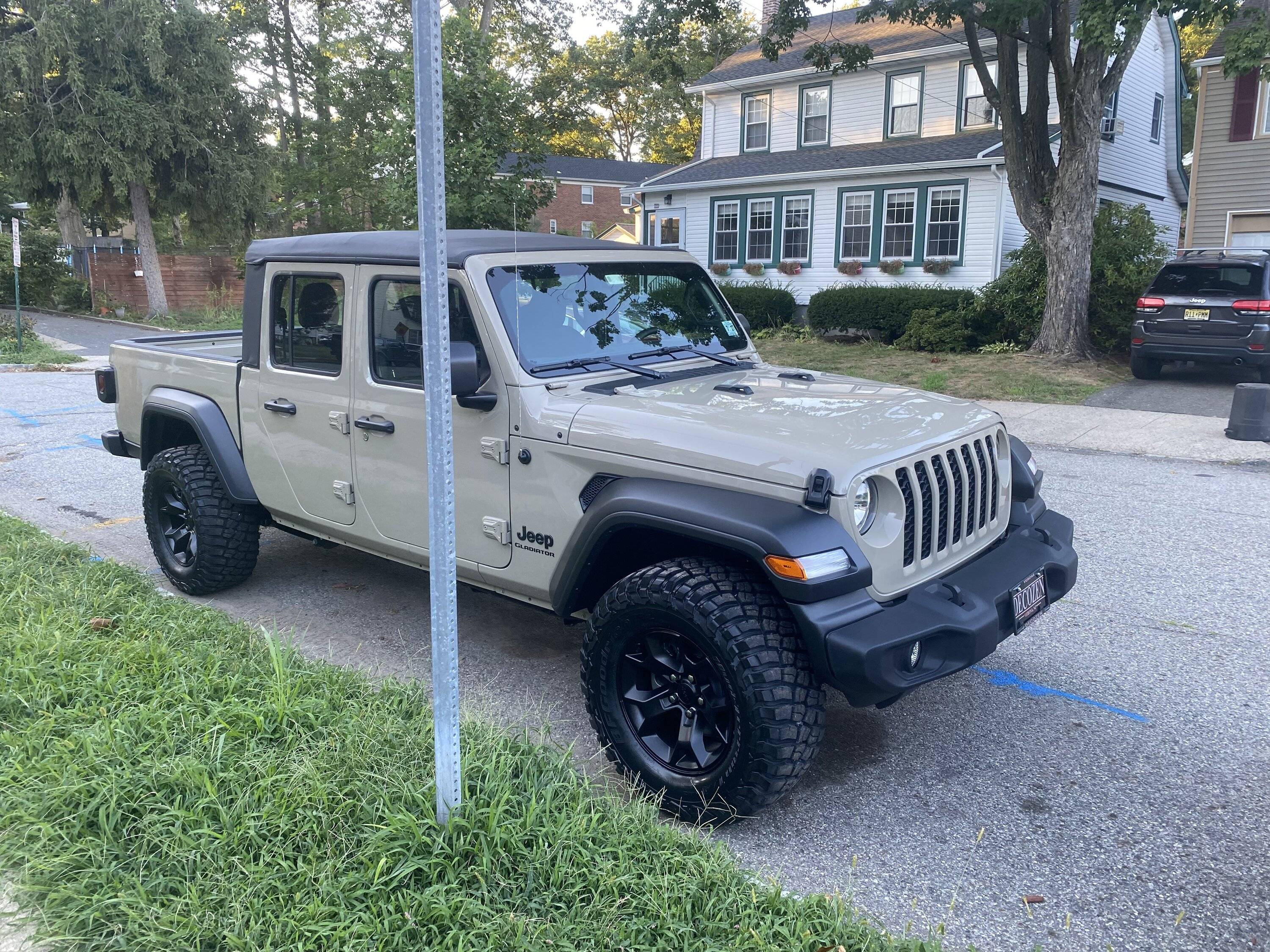

Sorry new at this whole thing. This is the vehicle. Got it in September and trying to figure out what my best move is fora lift that will help appearance and road riding without breaking the bank
Those are 17” wheels. No question. And the tires are not 12.5 wide. They look to be around 10.something wide. The wheels are from quadratec.

what tires are those and do you like them? looking for highway tires?
