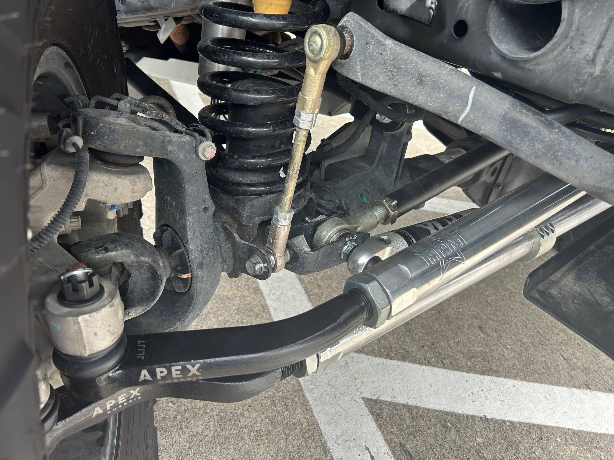

I appreciate everyone’s feed back thus far, I guess I should add a couple notes.
I am the original owner of the truck.
The 37’s went on the truck a week after purchase, and while I try to be nice to the gladiator it does get used off-road.
Up until about a month ago the steering has been “enough”, having 37’s on factory steering obviously isn’t the best and ya I can see it being hard on the pump.
It just seems kind of odd that it’s been good and I haven’t really had much issue until this point.
Being from what I understand an electric motor on a hydraulic pump I would think the motor would just die if anything and like I’ve said for the most part I’ve only really seen total failures online.
Im 90% sure I haven’t brought the fluid level low enough or been on enough of an angle to cause an air bubble in the system, but to be honest I kinda feels that way now that some people have said that.
Some times it feels fine, other times it just feels like there is no pressure.
I’ve also seen a couple posts about the aux battery / grounds causing issues?
As for it getting cold and it possibly having an affect with the larger tires, this is coming up on the 4th winter and it’s never acted like this before.
For now I’ll keep an eye on it, if I’m going to replace / change anything I think I might go down the route of bolting on a 3.6 jk pump..
If anyone else has had similar issues I’d love to hear about it.
Or if anyone has done the conversion to the jk pump I’d love to hear about that as well.
