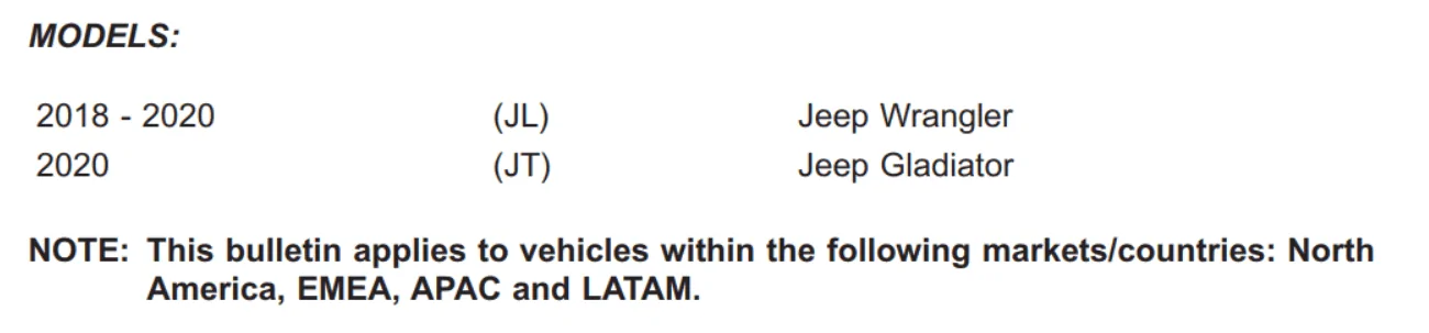

WRONG about USA only.
They need some reading comprehension -
Jeep Gladiator Weak power steering pump - 3.6 Rubicon 1698877225783
Is the TSB to to fix the USA or vehicles made in the USA? Ask your service advisor where your truck was made and see what happens.
I had that same answer given me by a service manager with my last truck and when I asked where my truck was made, he paused and understood that cross border really didn’t matter and I got my truck fixed.
Didn't know the JT was made in Canada............ thought the NA market vehicles all came from Ohio.
Doesn't matter, the TSB covers pretty much any market.
