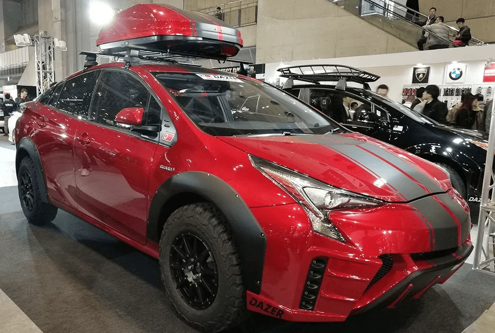

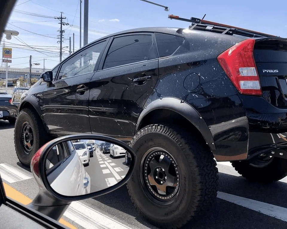

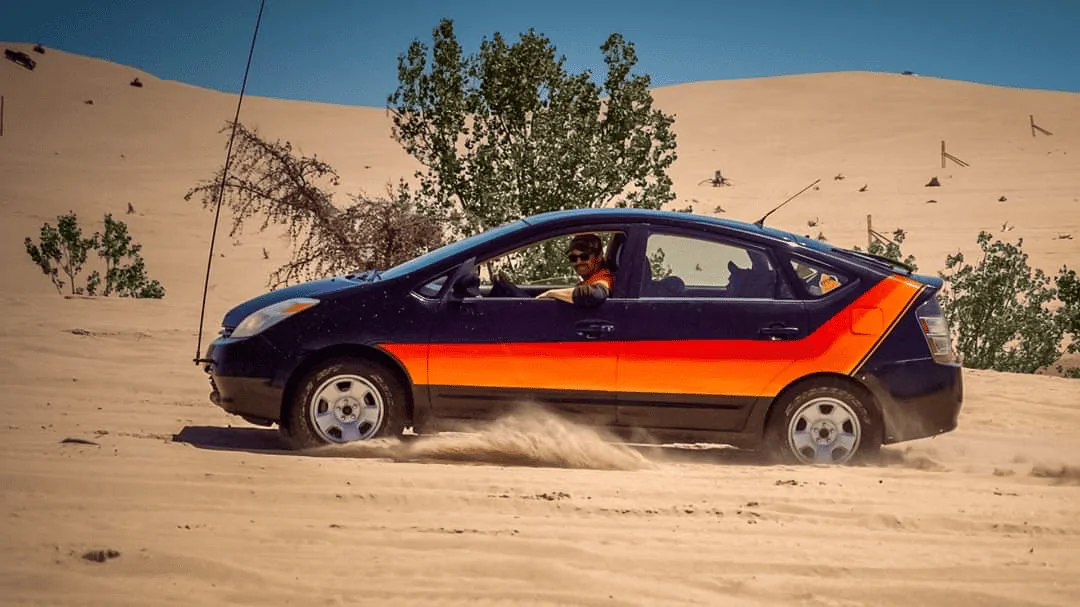

I have been stuck at about 16MPG since I bought the truck with the stock M/T tires and manual transmission. Planning on going with 37's once money is saved up. Last thing that crossed my mind when buying the Gladiator was MPG. Was doing some research though and I have found a few options to get better MPG:
Jeep Gladiator Weight or Diameter? Biggest MPG killer 1628677356457
Jeep Gladiator Weight or Diameter? Biggest MPG killer 1628677390218
Jeep Gladiator Weight or Diameter? Biggest MPG killer 1628677440735
