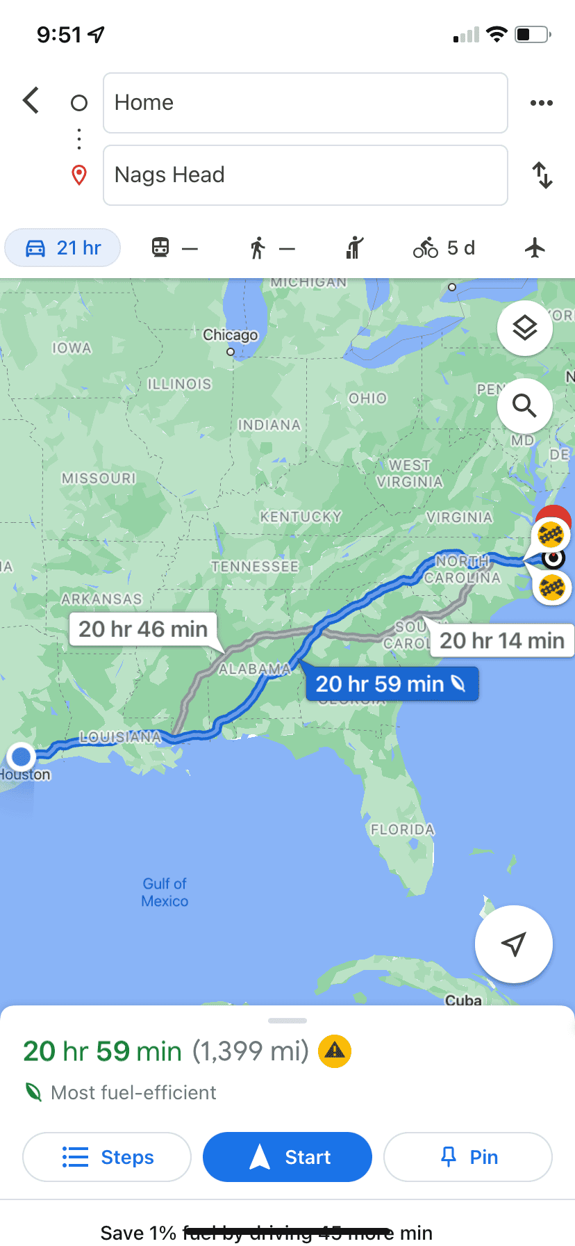

I ended up with 18.5 mpg from Houston to Nags Head, NC and 17.8 mpg on the way back. The trip up had almost no traffic whatsoever. We hit a spot of traffic for about 1 mile that set us back 20 minutes tops, that was it. The trip back, we had traffic and snow related accidents…we lost about 1.5 hours in traffic so it definitely affected mpg.
We kept it at 70 mph for the vast majority of the trip, some passing at 80+ mph, and a lot of cruising at 75 mph. About half of the drive included moderate inclines/declines through the Appalachian foothills in Alabama, Georgia, and South Carolina.
Overall I’m pleased with 18+ mpg while loaded up with about 700 lbs of payload and heavy ass 33” Falkens. Plus I haven’t programmed the tire size in (not sure if it really matters for mpg though).

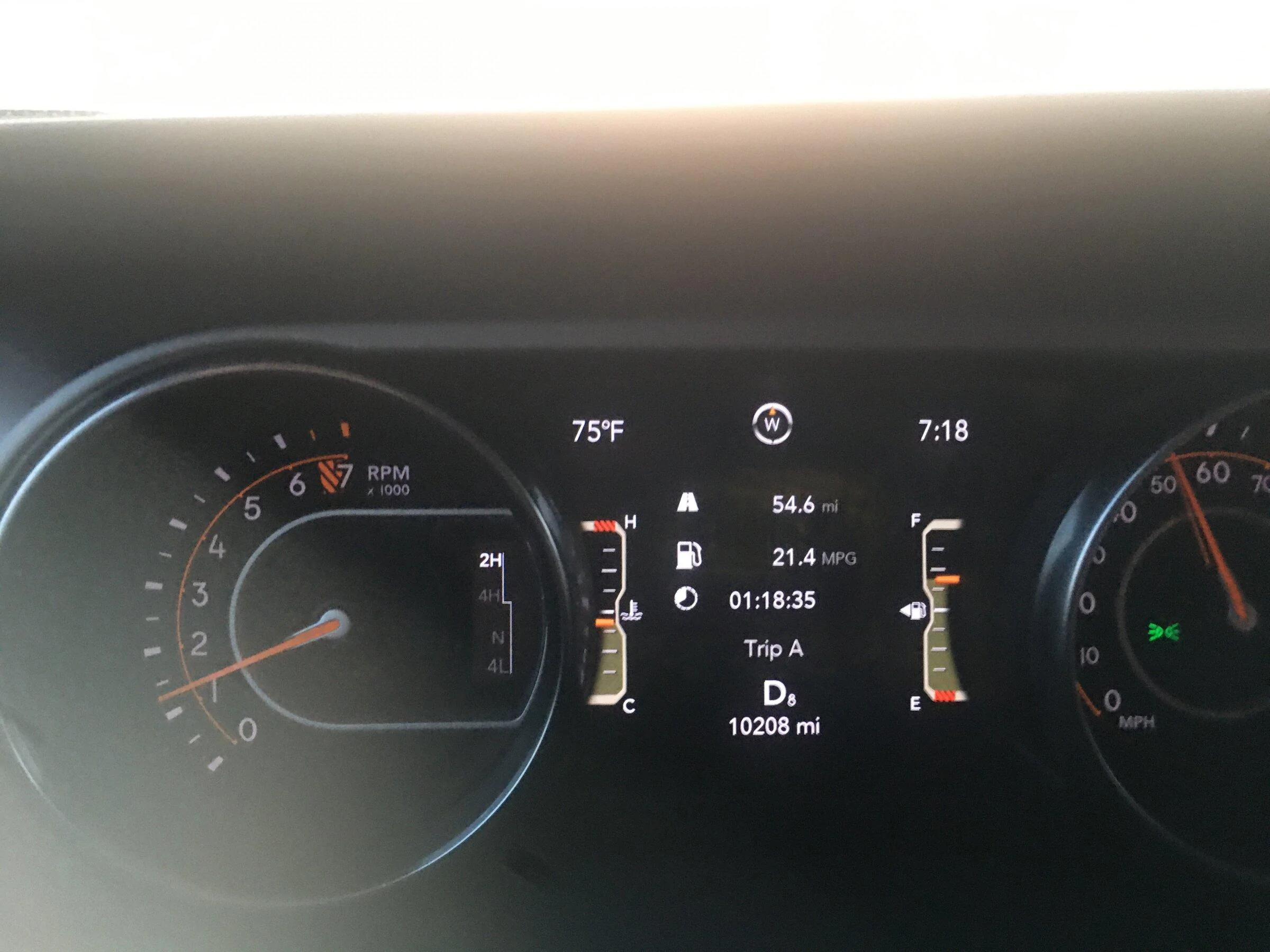

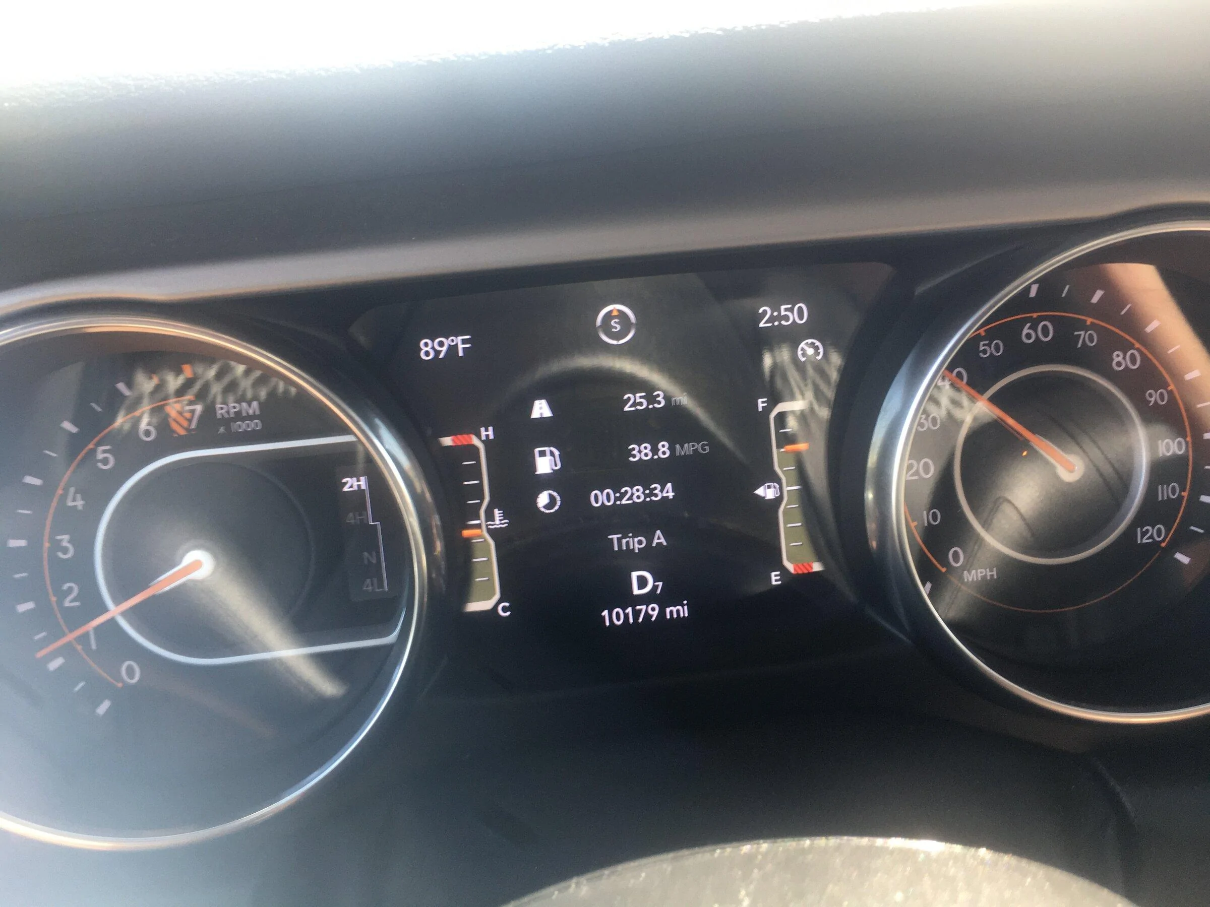

Took a drive yesterday and got 38.8 mpg to my destination 25 miles away with a elevation drop of 2000'. Things changed when I returned to 2580' elevation. For the trip I averaged 21.4 mpg. I am pleased to see, with mostly freeway driveing, an average mpg above 20.
