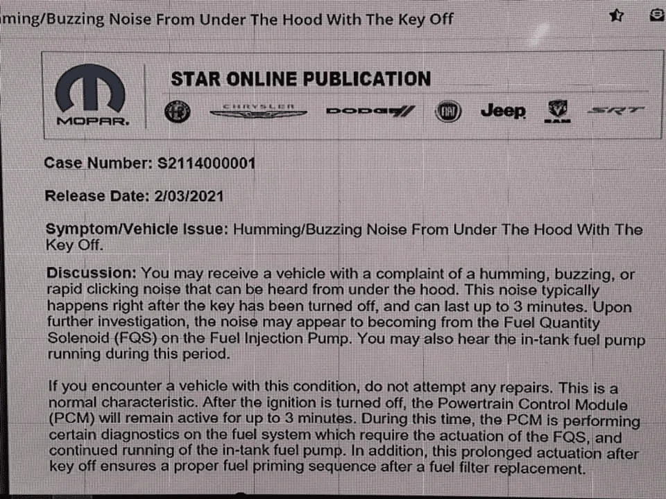

That is 100% normal. It’s actually the fuel quantity solenoid actuating. On the high lift fuel pump.
Are you able to elaborate on why it doesn’t happen on the other diesel I have? Aside from how loud it is that’s why I became so concerned.

Thank you so much. I certainly appreciate that! That was a good thread to read. I tried using the search engine and apparently didn’t get the right key words. Thank you, again. I had actually direct messaged the guy so posted the picture of the bulletin. I haven’t heard back from him yet. I sure would like to get his take on why this one does it and the other doesn’t. Doesn’t matter as much now that this is deemed normal but seems as though it should be one way out the other ; either it buzzes or it doesn’t

This is normal. Mopar came out with a service bulletin to address this as many were complaining, why this isn't in the service manual I do not know... They should of just included it..
Your diesel should be making this noise on shutdown.
