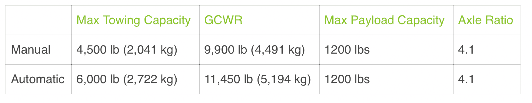

All you need to tow is a hitch. How much you can tow is mostly determined by what model you have.
I have a Mojave. this is the listed tow capacity.
Jeep Gladiator What are the upgraded tow options? 1659633258747
Notice that there is no adjustment for the tow package. Its this way for all models. The only exception being the MAX TOW package.
