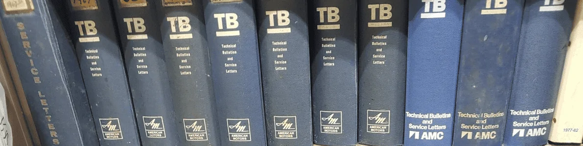

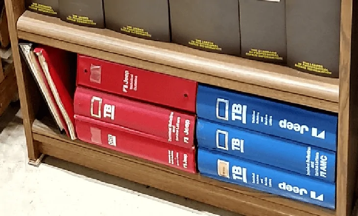

TSBs aren't like the old days (TB, TSB, DRB - technical bulletin, technical service bulletin, or the Jeep diagnose and repair bulletin) -
