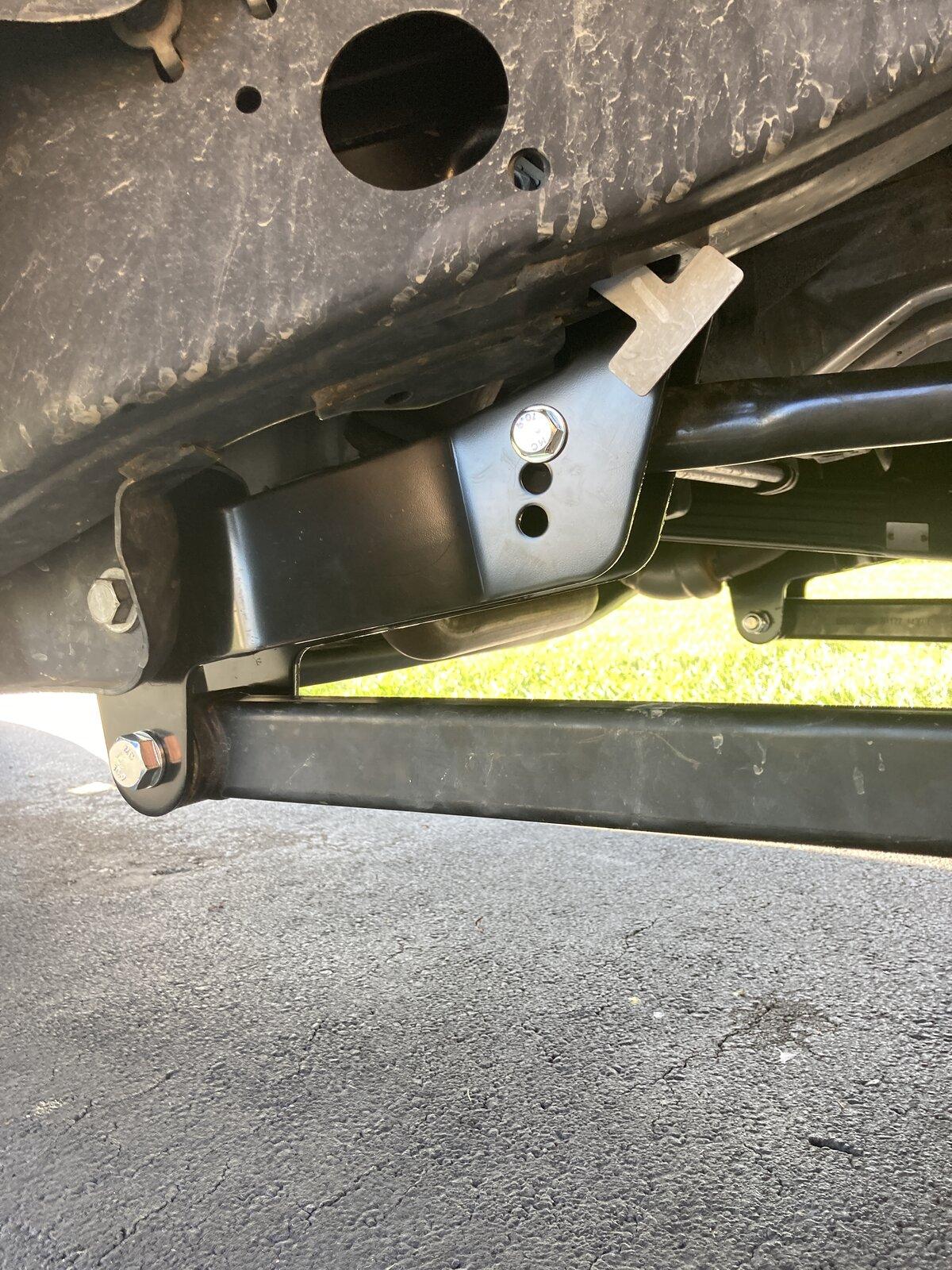

Probably the first person I have seen to properly use a toque angle gauge.
It was 111ftlbs and 90°. I only did 110 and a very loose 90. Still counts though.
I installed Teraflex arms on mine and their instructions list the factor torque spec plus degree angle but also listed an approximate ft-lb spec with the degree torque angle factored.
Still was a pain doing it on the ground .
Nothing is worse than the front lowers. On your back with no leverage trying to hit ~190
