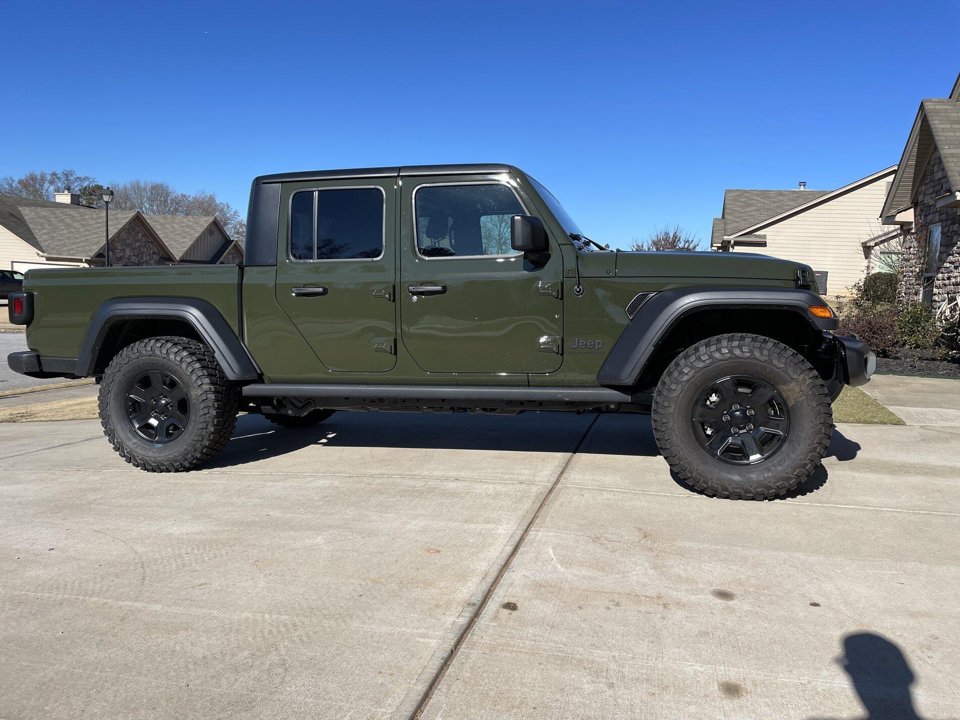

Mopar lift and 35s on stock rims
Did you add anything to the kit? Track bar, etc. What was your total if you dont mind me asking.

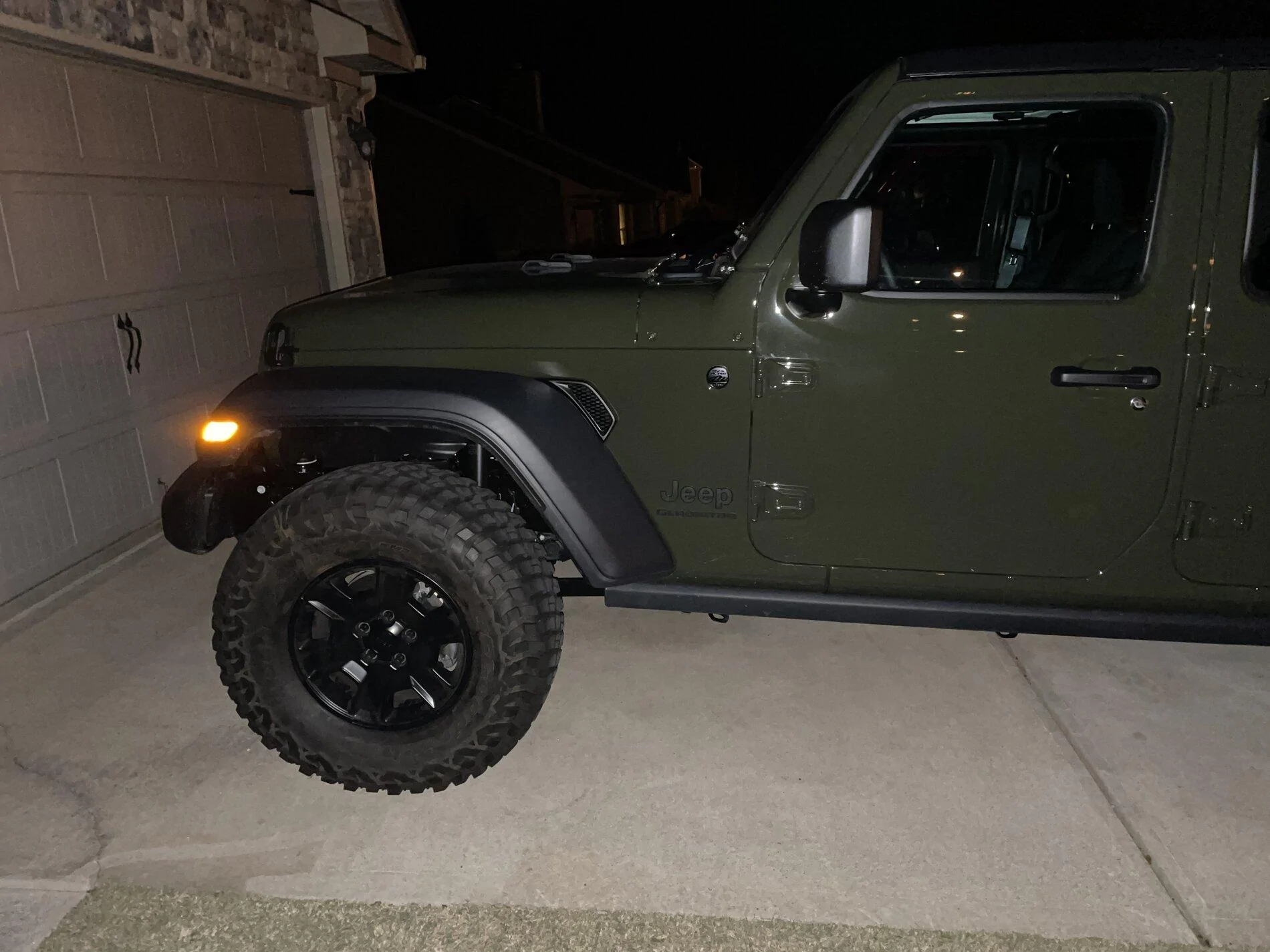

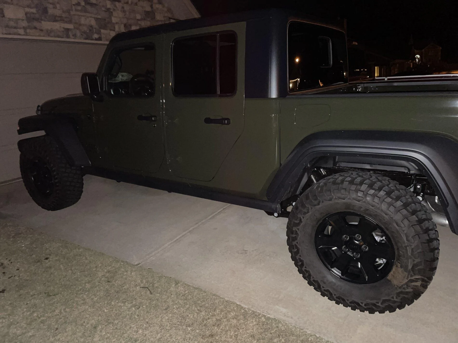

Sgt got issued some new service boots thanks to a great local Jeeper. BFG KM3 35x12.5x17
Sorry for the bad night time photos, took a while to commute and get mounted/balanced.
Those KM3's look great! Can't wait for some daytime pics. What lift or leveling kit do you have?
Didn’t add anything. Kit was $1345 online, 5x duratracs were like $1700 at discount tire, installation was about $900 at the dealer including reprogramming for 35s

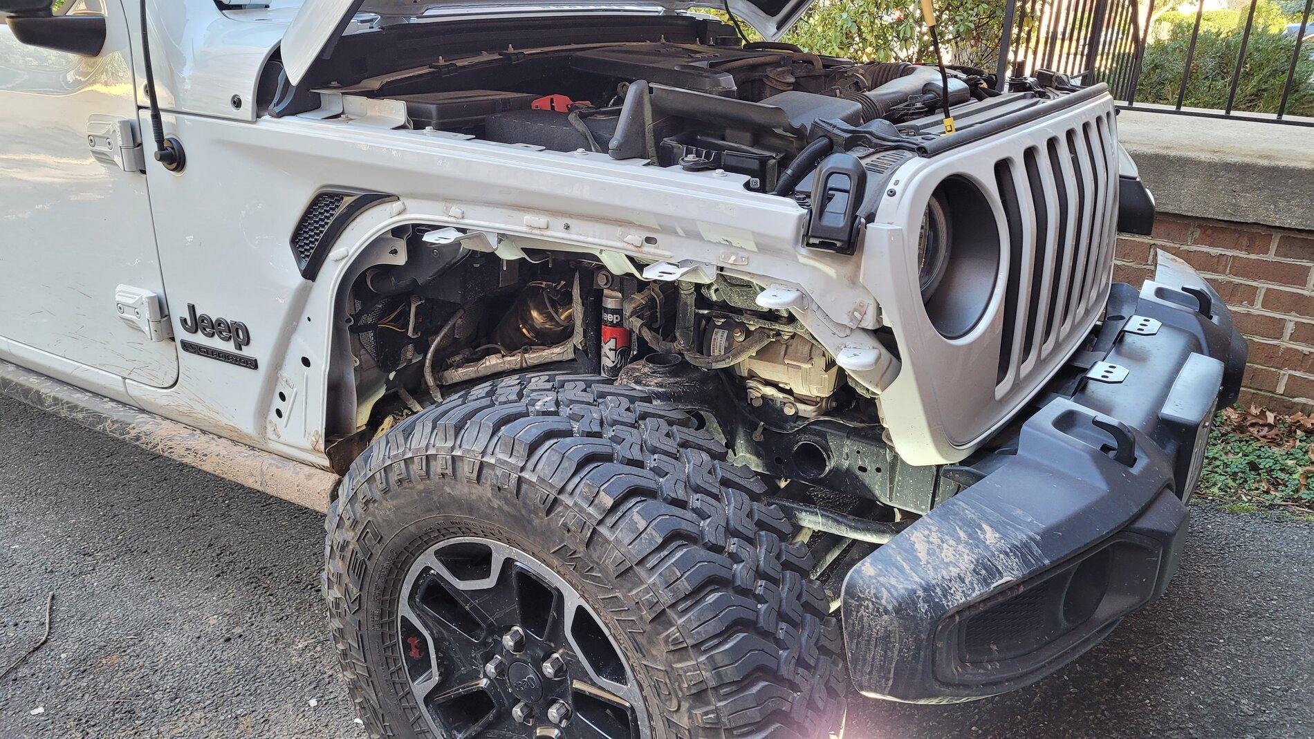

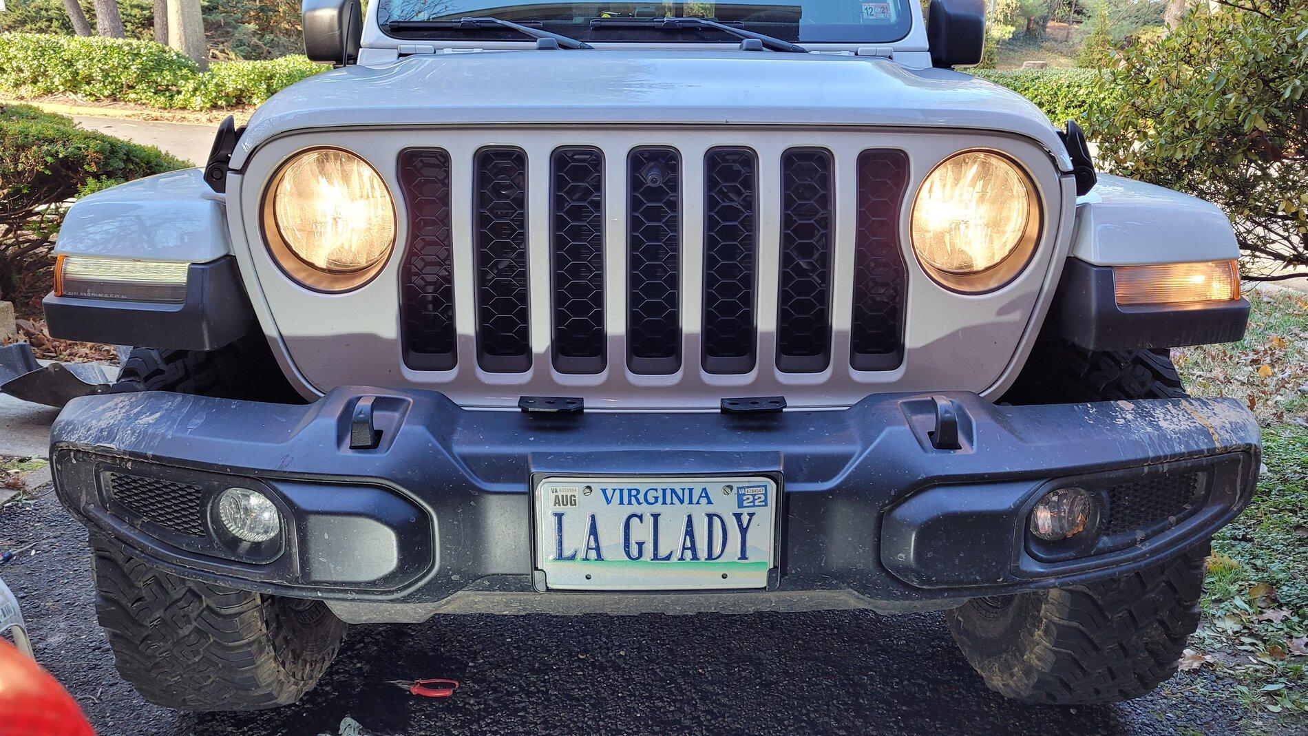

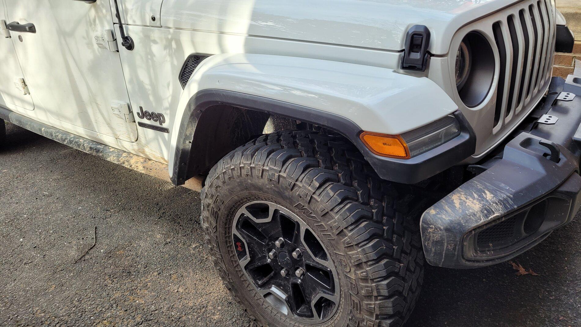

Replaced the damaged fender with the one I got on Facebook Marketplace. Had to twist the fender mounts a little bit to get them back into line but once I did that it fit fine.
Big thanks to a local NovaJeeper for letting me have his leftover plastic clip kit (w-clips, rivets and tree pins). Saved me having to go to the dealer. I salvaged some from the fender I removed so I only used a few of them.
The black W clips that hold the fender to the body in the kit that you buy on Amazon/Ebay are a little larger than the whites ones it had, looks like they are meant for JK's, but I got it to work.
The fender I bought had LED'S. Fortunately I have a Tazer so I switched to LED and it worked. So I have LED on the left and bulbs on the right. For now......
