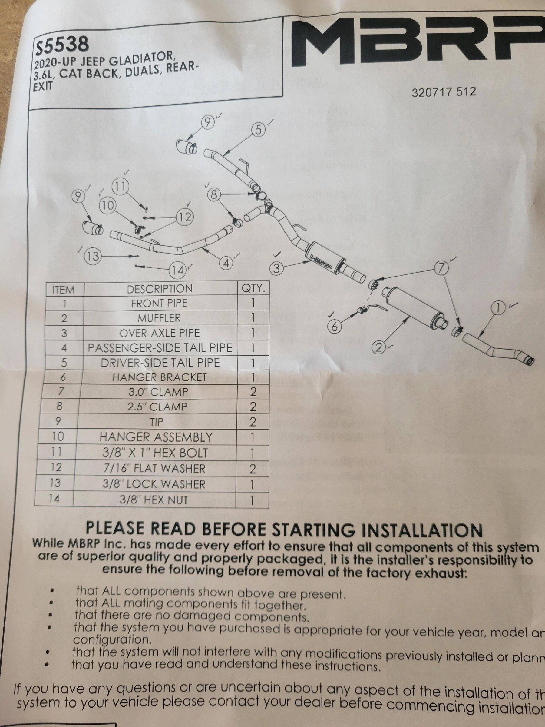

Got my new exhaust system and installing tomorrow..
Nice, I ended up going with the B2 Fabrication exhaust, love the sound! Can’t wait to hear your setup.

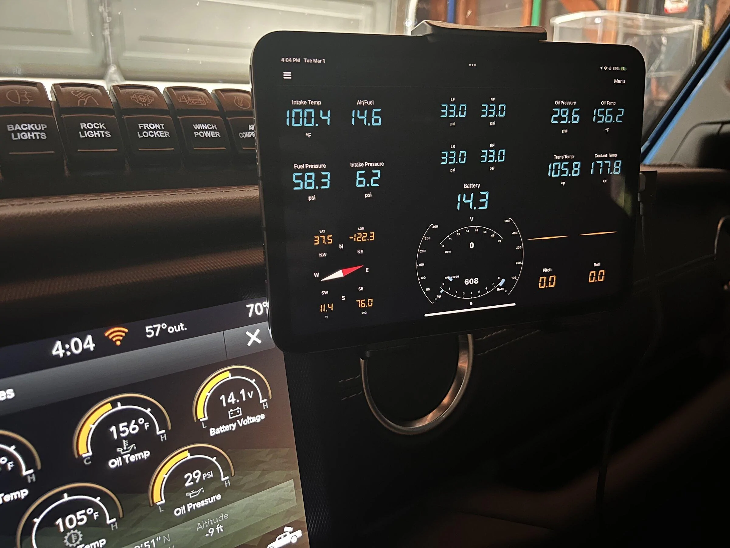

Not exactly the Gladiator, but I finished building a custom dashboard for OBD Fusion. Monitors all the basic/relevant temps, pressures (including tire pressures), speed, rpm, gps info, and I also built a custom pitch and roll gauge (it’s actually 4 gauges) to mimic the Off-Road pages app. Yes, a lot of it is redundant, but the idea is I can use my dash for CarPlay/nav/off-roading maps and this is my info center. Happy to share the export if anyone is interested.
Amazing! I would love to know more! iPad? How did you get the information to display on the app? How do I get the app? Something you created?

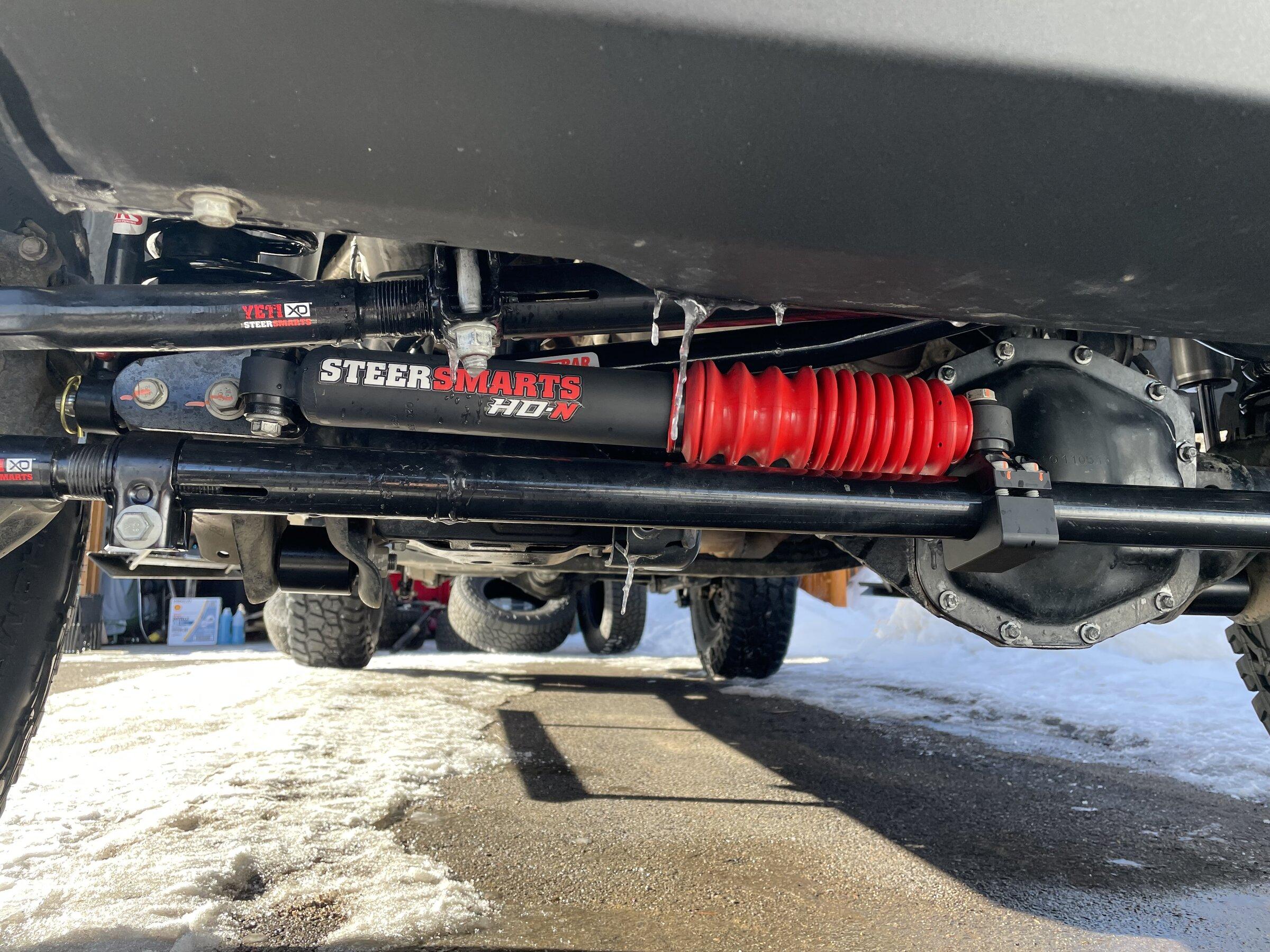

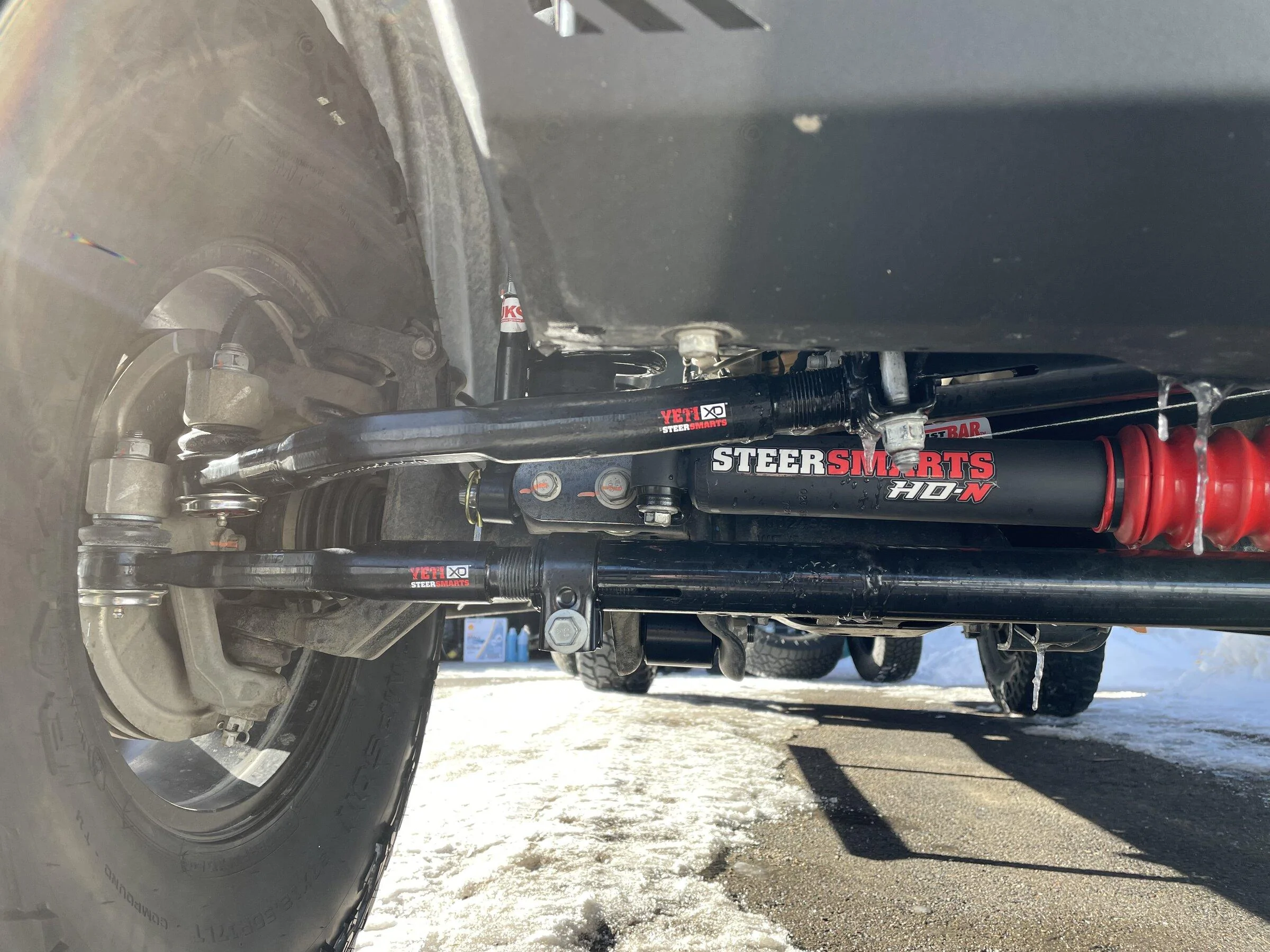

3” JKS lift with fox 2.0’s, some steer smart bits, 37”Mickey Thompson Baja Boss AT, and method 703 wheels
Have the same lift just be aware that if you add a RSI Smart cap or heavy rack you’ll need to replace the rear springs & bump stops to stop sag.
It's an iOS app called OBD Fusion. I have no affiliation with the app/developer. The app is $9.99, and unfortunately you will have to pay $14.99 for the FCA Enhanced Diagnostics add-on for your MY to display most of the items you see in my screenshot. Without the add-on, a lot of the temps and pressure info is not available via standard PIDs. You will also need a compatible BT OBD scanner such as the Veepeak. This one has worked perfectly for me to read/clear codes on both the 992 and the Gladiator. FWIW, it's advised to unplug these if your vehicle sits for extended periods as the power to this port is technically always on.
If that still interests you, you can download my dashboard here. I actually have a second copy of the dashboard now, I'm playing around with some small UI tweaks to see which one I prefer. After downloading this file on your device, you can import from the Menu link in the upper right corner when you are on the Settings screen. There is an Android app, but I have no way of verifying if the export file is compatible.
