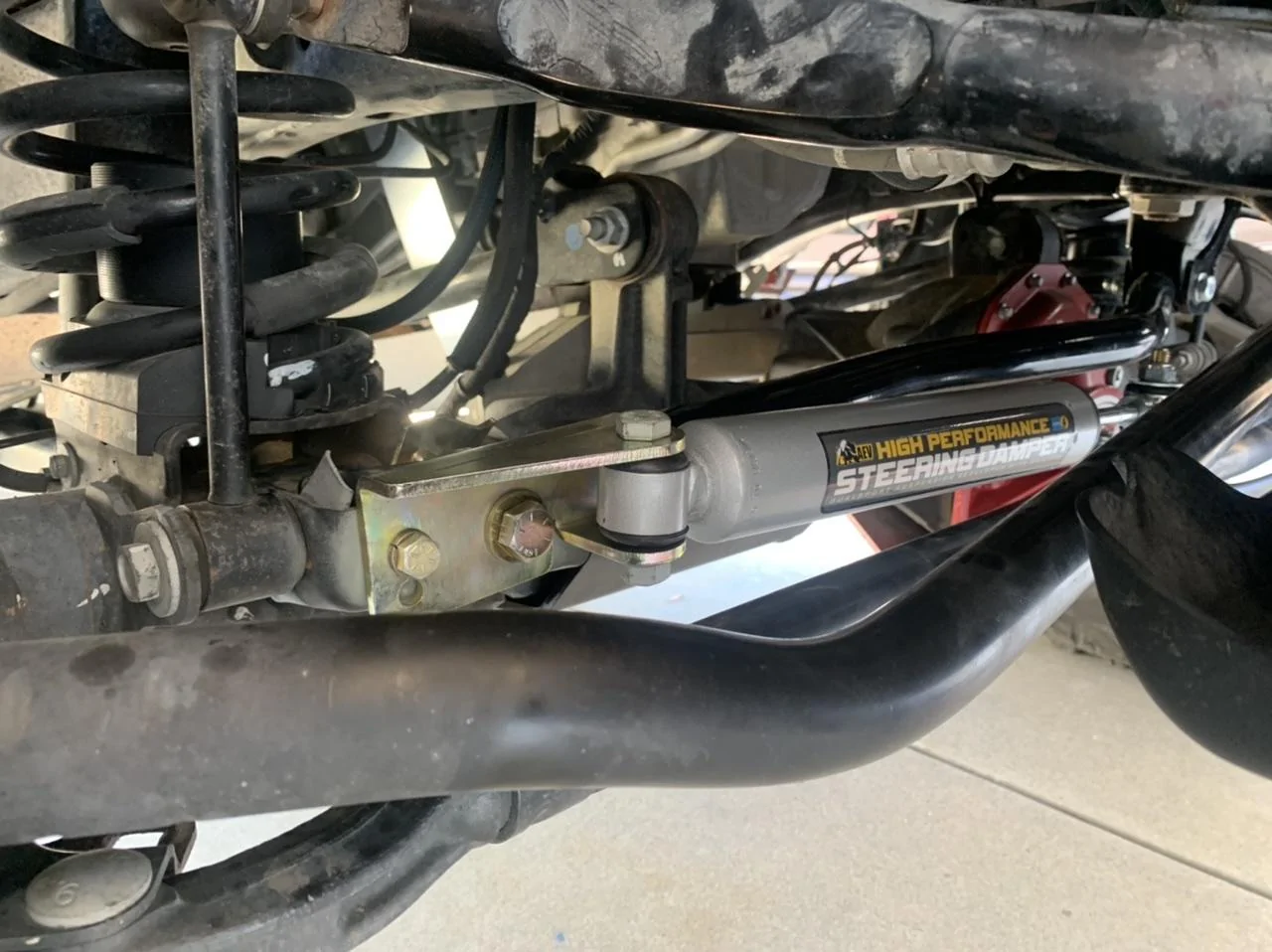

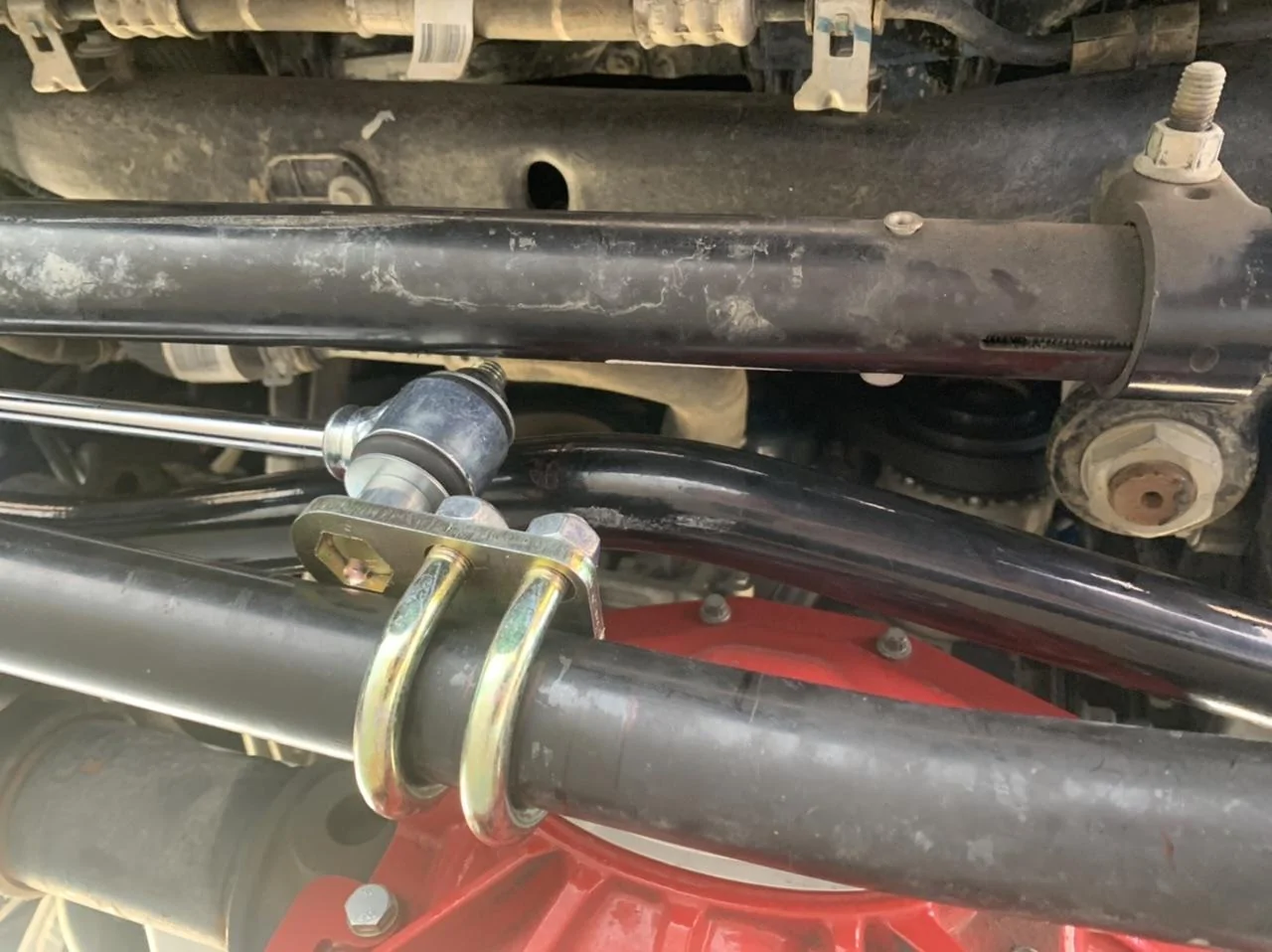

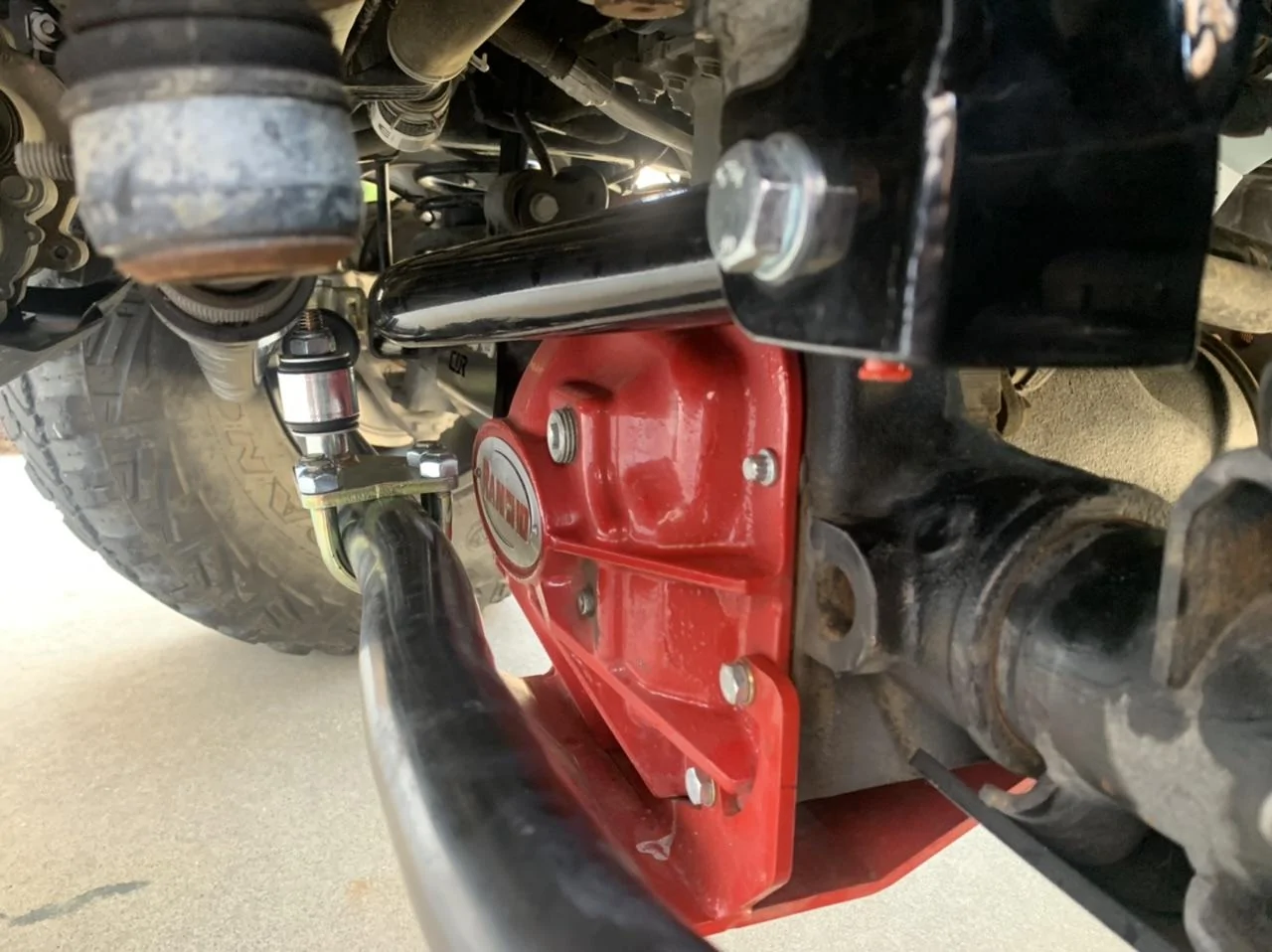

Yesterday I put in the Rusty’s track bar brace, Rock Krawler track bar, and Clayton steering Stabilizer relocation with an AEV stabilizer.
I know most SS relocation kits say at least 2ā€ of lift required, and I have 2ā€ spacer lift.
There’s definitely interference with the SS and the drag link/track bar at full lock turning left.
Jeep Gladiator What did you do TO your Gladiator today? [ADMIN WARNING: NO POLITICS, NO GUN TALK] F238205E-9F76-4030-BF58-B3B6B753779C
Jeep Gladiator What did you do TO your Gladiator today? [ADMIN WARNING: NO POLITICS, NO GUN TALK] 6E1ECCD8-AF1A-4648-8F8A-141480BB6D24
I have the shock adjusted all the way to compression basically turning right, so I can’t adjust it any further left. And I actually have the bracket flipped 180’ because the way it’s supposed to go, with the SS mount on the rear side of the bracket, it was even more buried into the track bar.
So I guess now I need a bigger lift??ā€ā™‚
I really should’ve taken the time to drop the drag link so I could drill the hole for the Clayton relocation bracket correctly; I was at a little downward angle and I think I walked the bit a hair.
It looks ok but I think if the hole was higher and the bracket was a couple degrees more clockwise, the SS would be straighter.. it’s just barely torqueing the bushing?
Jeep Gladiator What did you do TO your Gladiator today? [ADMIN WARNING: NO POLITICS, NO GUN TALK] 3E6D3E78-4AF0-407C-B193-4D94AEF8E3F4
Edit: oh yea added the Clayton FAD skid. Had to take off the Rock Hard LCA skid, will find some time to grind that puppy down so they both fit.

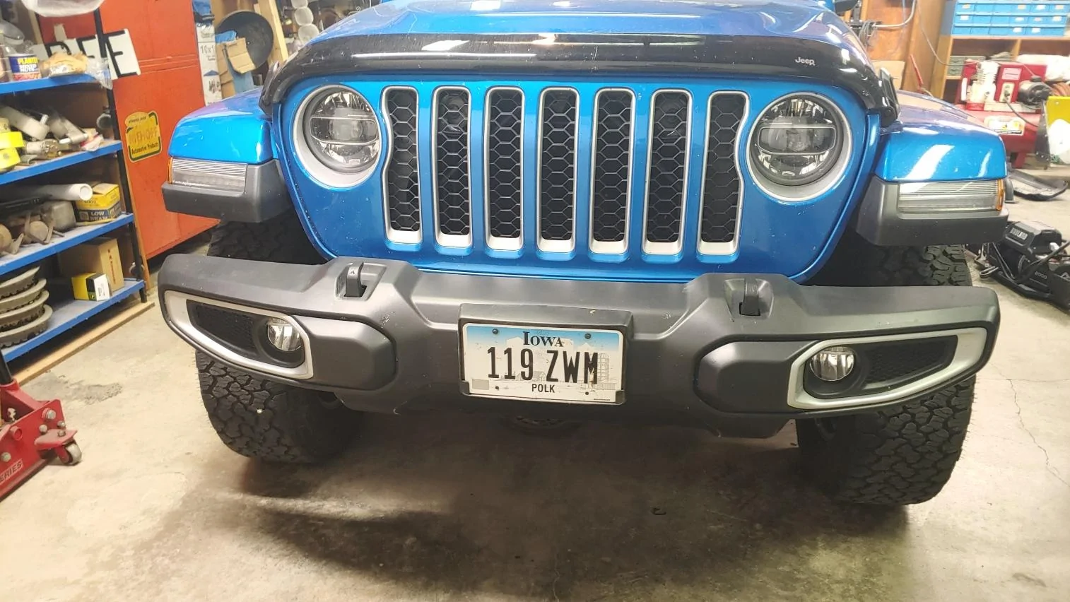

With the help of forum member jebiruph, started to un-mod my JT for eventual trade-in on a 2022 if it ever gets built.
Started by taking the weight off the front - I didn't want to go back to the stock front springs and remove the Daystar spacers with the weight of the steel bumper, winch and skid plate on it.
Removed front receiver, winch, wiring, skid plate, and put it all back to original.
I see several areas I will do differently next time. Wasn't happy seeing some of it while taking it apart. I know I can do a much better, neater, job next time.
Now I have rows of parts laying on the garage floor until I organize things and put them away for when the new one arrives.

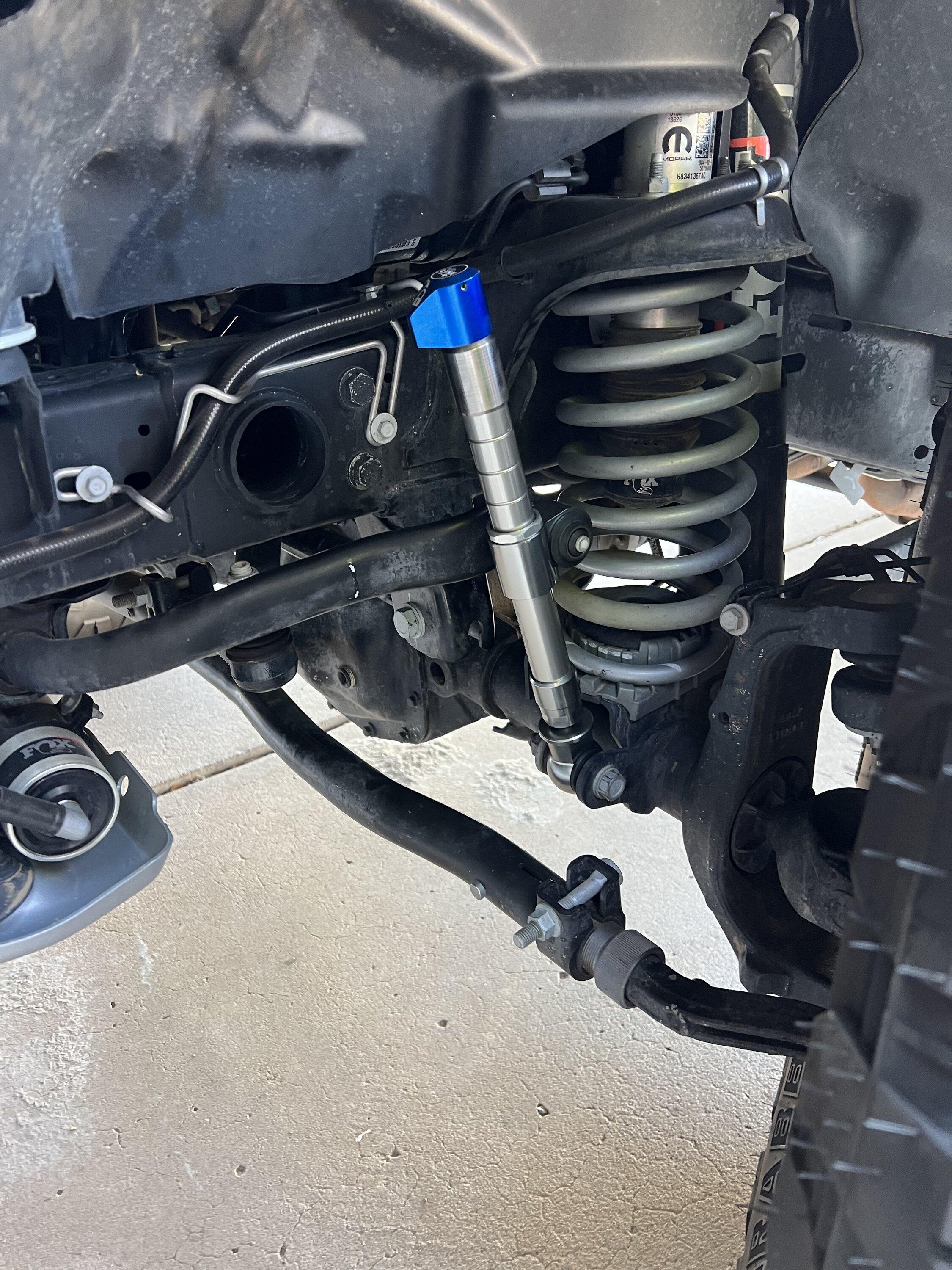

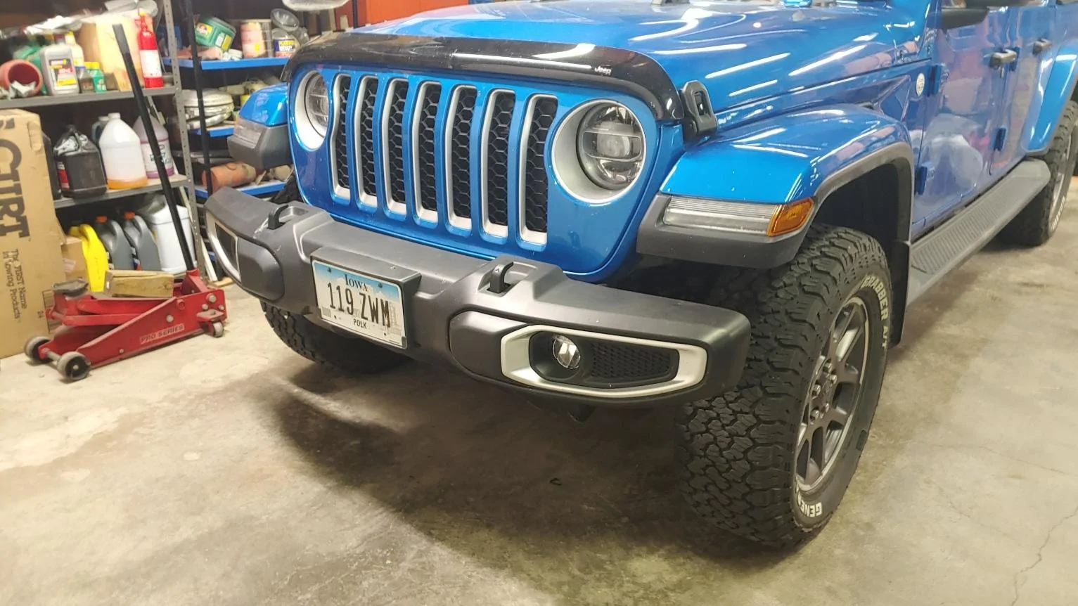

Added the Teraflex 1.5ā€ leveling kit. Kicked my old ass so bad I Just finished about an hour ago. Never should have tackled it on my own. Fingers quit working halfway through. Got her done with some additional help from a neighbor who came over and jumped in. Good people everywhere! I’ll post picture tomorrow. ✌
Edit: Don’t look like that much but the difference is clear to me.
