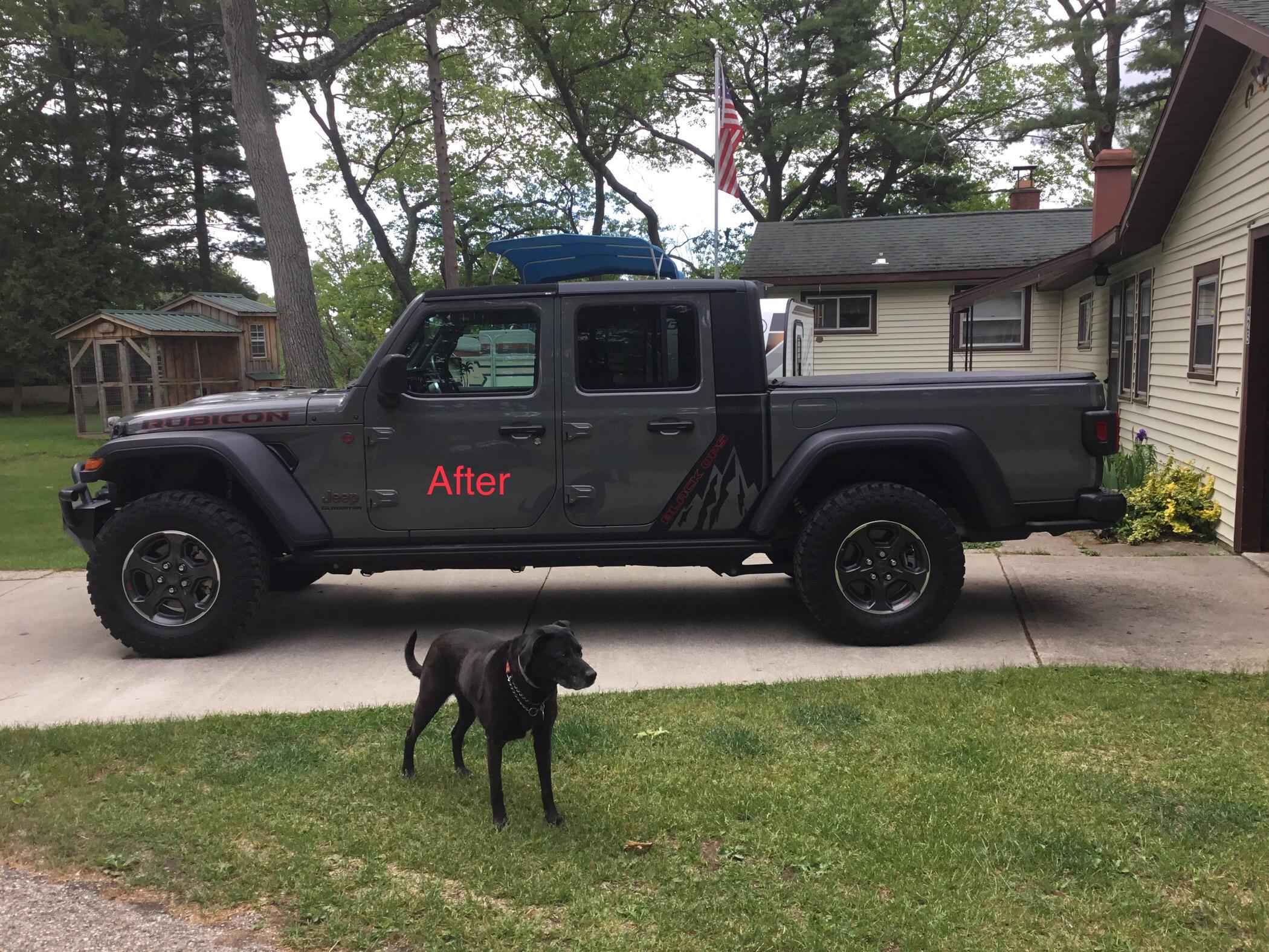

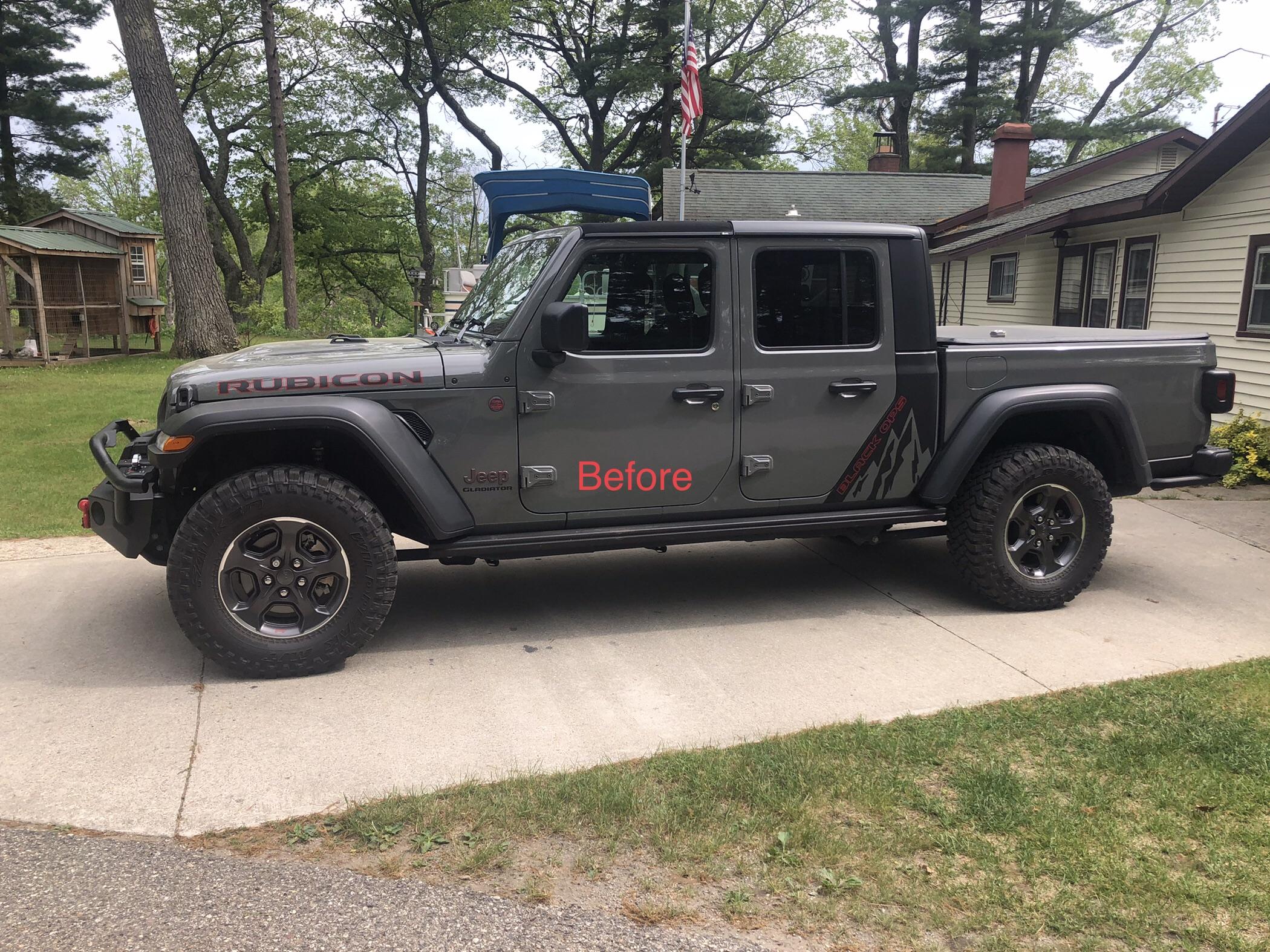

Added the Teraflex 1.5” leveling kit. Kicked my old ass so bad I Just finished about an hour ago. Never should have tackled it on my own. Fingers quit working halfway through. Got her done with some additional help from a neighbor who came over and jumped in. Good people everywhere! I’ll post picture tomorrow. ✌
Well props because adding my spacers on jacks in the garage whipped my ass. I’m able bodied just out of shape haha.
Just a whole bunch of crawling at awkward angles and trying to loosen/torque huge bolts down.
I think if I had to start over with a new Jeep the first mod I’d get is a 2-post lift?

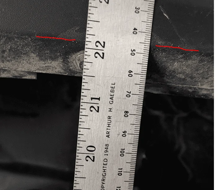

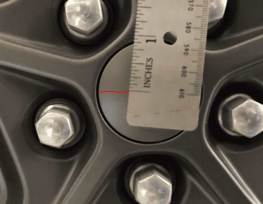

OK, I measured my truck from the center of the wheel caps to the fender trim center line before we started -
(it has the lighter pair of Rubicon springs (numbers 339 and 340) up front with .75" Daystar spacers)
Front - left - 22"
Front - right - 22"
After a short drive, and parking it back in the same place after things were removed, the height now is - ( still with the lighter pair of Rubicon springs (339 and 340) and Daystar .75" spacers)
Front - left - STRONG 22.5"
Front - right - STRONG 22.5"
That is measured this way - center of wheel to this point - (this is an old pic, ignore the measurement, I measure to where I made the red line to be consistent.)

That reminds me of a couple of years ago when I put the stuff on and I said the bumper, winch and skid plate dropped it 1/2"
So with Rubicon springs and Daystar spacers, the weight of the steel bumper, skid plate and winch dropped the front 1/2".
That's why I wanted the weight off first, instead of putting the stock springs back and removing the spacers - that weight would have really dropped the front of the truck with the Overland springs.
And in other news...........
We took the truck to church last night. (it was supposed to storm so didn't want the little car out in with a change of nasty weather, hail, whatever)
It's a route I've driven many dozens of times with this truck. Most of the time taking the truck on this route, it had the weight up front (bumper, skid plate, winch)
I am not kidding a bit - the truck actually tracked better, on the level there was ZERO lead at all, not even a tiny bit, and the ride was smooth as silk. It was a very very different truck. Any bumps were smoother, steering was better, it's hard to explain but it wasn't like a truck, it was more like my wife's GC, only some of the bumps were even softer than that. The ride change was crazy good. But what made me think I was dreaming or imagining things was how it was the best it had ever driven handing and ride-wise. It was as if that extra weight made it lead a times to the right. It's never been bad, just that to be honest, on most roads that had a crown or slant, you had to keep it to the left just a little bit to compensate. Not last night. I was able to eat an ice cream treat while driving and never even think it was wanting to take me to the right if I didn't watch.
No way on a solid axle could weight make any difference at all on steering or any lead (can't call it a pull, it wasn't quite that way, but it did act like a dog that had seen a bird to the right - let go of the leash and it would eventually go there)
I can't see how it's possible. It's not logical. There's no change to camber, that 1/2" difference in height can't have changed caster any appreciable amount at all, and other Gladiators come with steel bumpers and skid plates - the only difference is 85 pounds of winch on a Rubicon.
So why in the world taking off 160-170 pounds and putting back the <20 pounds of stock bumper could make a difference in handling or steering has me baffled.
Bumps and ride - absolutely. The springs are compressed 1/2" less so the softer initial compression of the spring is there to absorb and little bump on the road. Otherwise with the weight, the springs were already compressed and it took a lot more to compress them even more for a bump in the road. That makes sense - so I may rethink what I do with the new one. I may well not put the stock soft rubicon springs under the front of the new one. I have to give that some thought. (or maybe buy an ALUMINUM bumper!)
Edit: Don’t look like that much but the difference is clear to me.
As long as the difference is clear to you and you are happy - that's all that counts. And frankly, pictures can't show everything, every perspective.
Too bad you aren't closer - this crippled up old fart could have gotten his battle damaged finger in there to maybe help shave 5 minutes off the job.
It's crazy - just 2 or 3 years ago I was still doing most of what I've always done - but the effects of damage to the hands, nerve issues, the tremors, back issues and lately, lack of any strength at all, I was soooo thankful for Jerry offering to help. He lifted that winch like it was a plastic toy. I might have gotten there, but.
No shame in asking for help - and yet with my social anxiety (fine on the web, but panic on the phone or in public), I'm the last one who would ever ask. Maybe some pride involved, too - I recall lifting differentials, heck, I lifted engine blocks, in one case, an entire 4 cylinder citation engine from engine stand to my work bench. But my spine is so badly curved from years of being stupid like that, it's a death wish if I try these days.
Anyway, you got 'er done and it looks fine.

Thanks! Glad it’s over to be honest. Today is a down day.

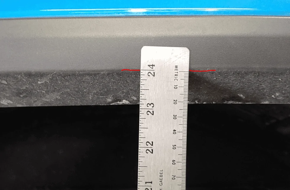

Front - left - 22"
Front - right - 22"
