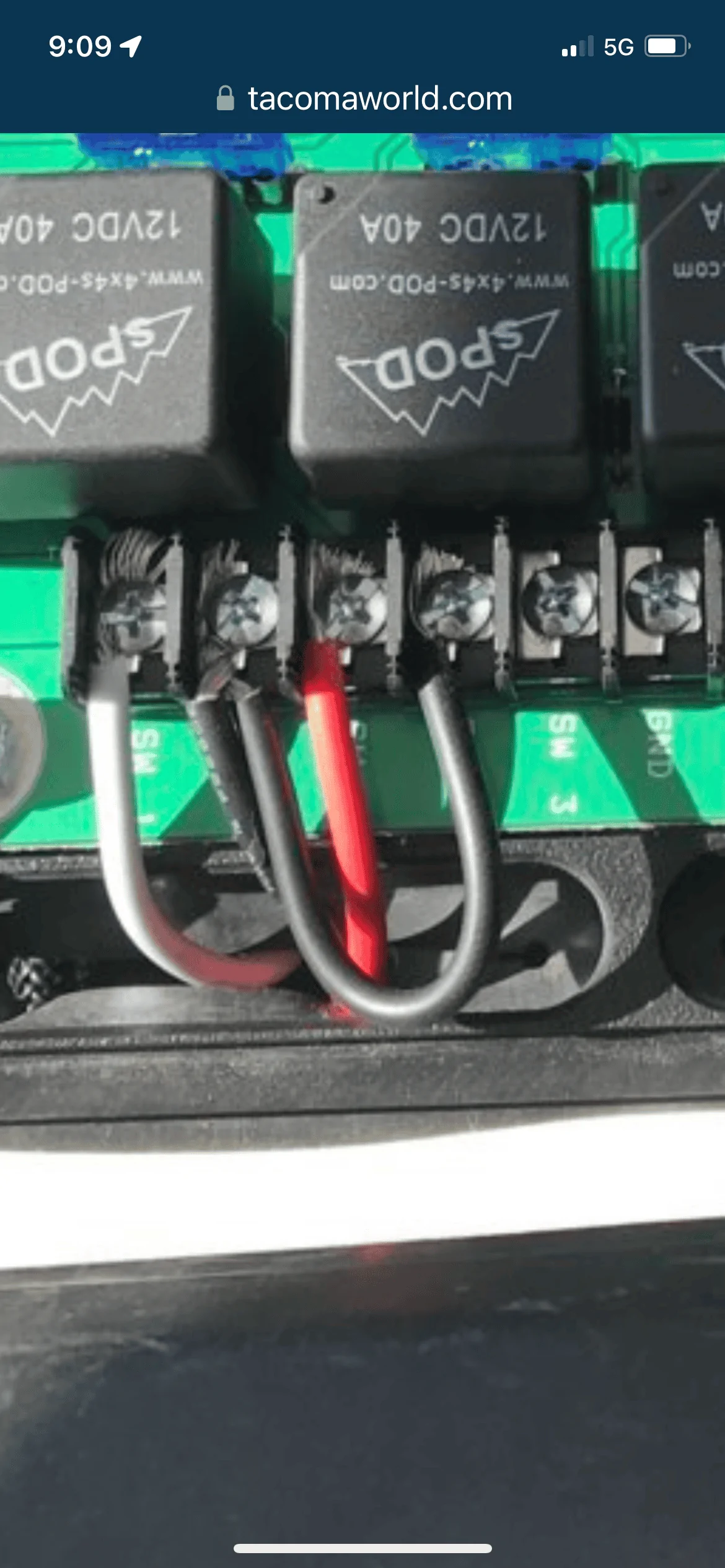

i found this in the one of the forums This is not my wiring I added y attachments to ends
But this is how it completed the installation need the daiseychain ground wire

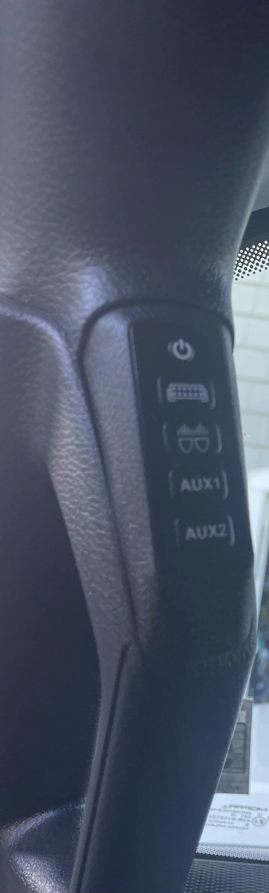

I installed the Voswitch and it is great. Used the 4 switch that goes on grab bar looks amazing

How was installing the Voswitch in the grab handle? I have that as a weekend project this week.
It was so easy took about 2 hrs just because I was taking my time to make the wiring neat and in order.
the scariest part was drilling a 22 millimeter hold in the inside of grab handle but it really wasn’t bad.
it works and looks amazing
Directions were perfect. Only think I did not do was touch the window. No need the wire slides right where it needs to be.

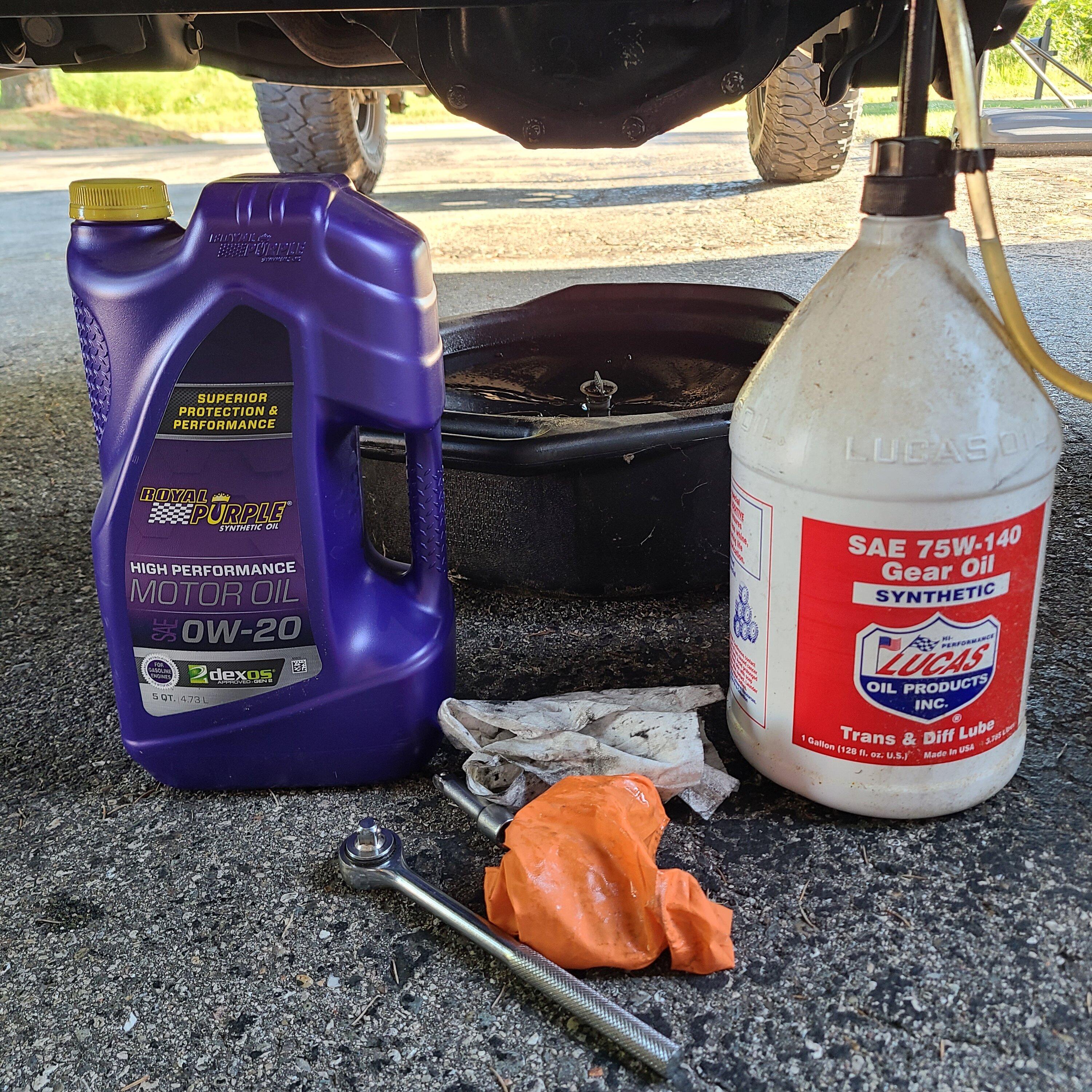

Maintenance. Oil change and diffs
Curious ... how did you measure the diff fluid? I have a pump which will fit the oil bottles but want to plan a good way to make sure I'm putting in the right amount.
@Hootbro said it. Fill until it comes out of the fill hole, while parked on level ground. If you are not comfortable with that, Amsoil site has the recommended amount for front and rear
Ignore the fact that his Jeep is lifted and on a rack which tilts the diff and will cause an under fill. But this is basically how you do a diff fluid change.

Perhaps I should be more specific. I am replacing my diff cover and the fill plug hole is at a different spot. Need to measure the actual volume being transferred so I stay in spec. :)
Ahhh!!! I replaced my covers too.
Most of the time, aftermarket covers will require more fluid. JT differential housings with OEM covers require just a shade under 2qts front and rear. My Yukon covers required about 2.5 in the rear and 2.3 in the front.
I simply filled till fluid dripped out of the fill hole.

Got it! Thanks!
