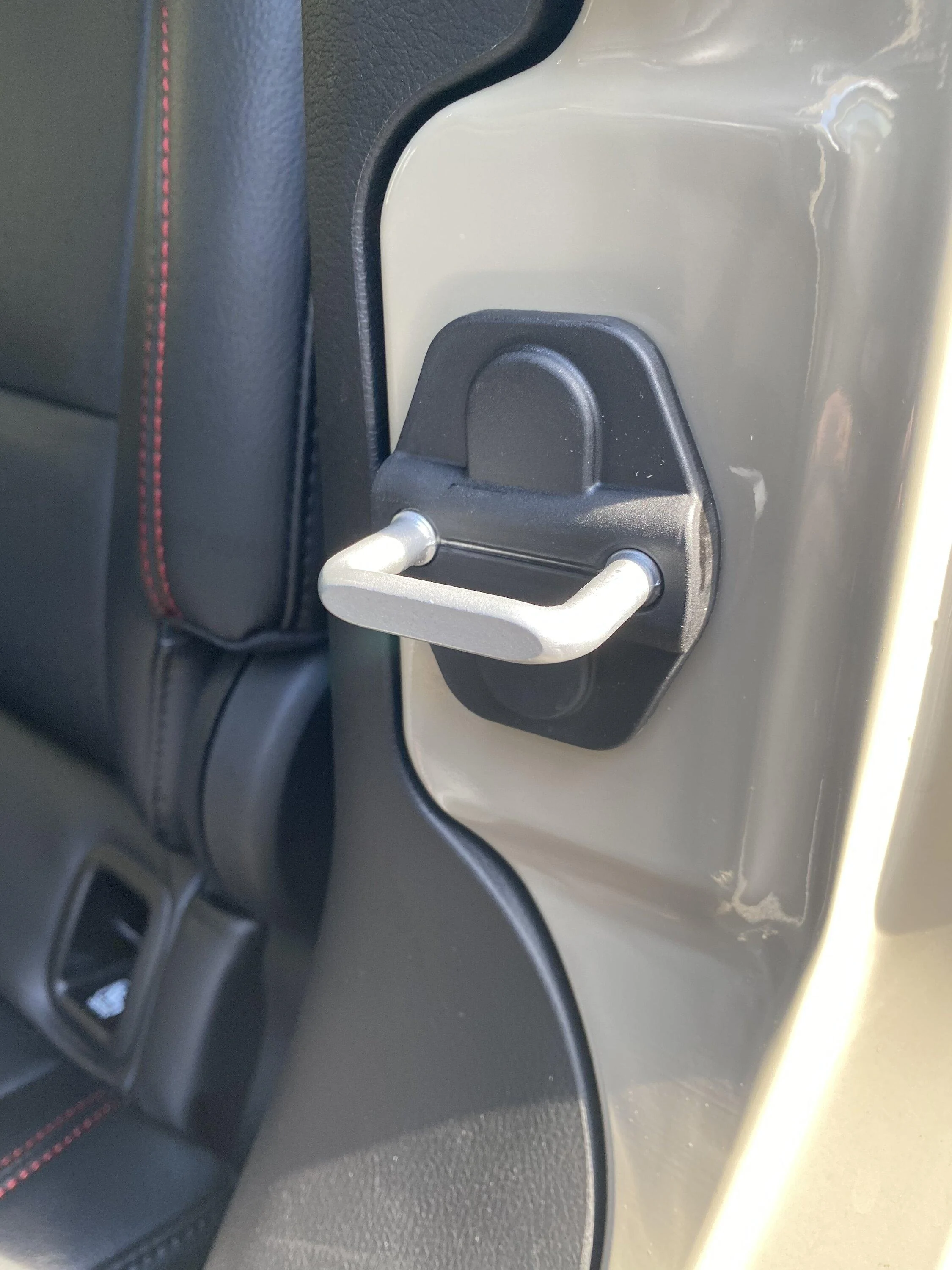

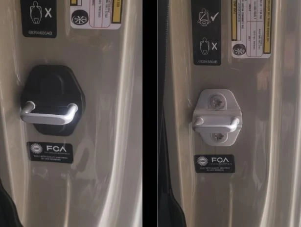

These are so stupid. I wasn’t going to buy them. But because I know they exist… the silver latches stick out to me so much every time I get into my truck. So I bought the stupid covers.
Hah! The silver metal latch got to me too. Bought a 6-pack of them for our JTR and son's 2-door JL. It does look cleaner with our Gobi and son's Sting gray. One thing I don't understand is why a 4-door pack comes with 6 covers? https://www.amazon.com/YOCTM-Decora...hvlocphy=&hvtargid=pla-4584345029511512&psc=1
I'd mask and paint with VHT epoxy satin black before spending money on plastic covers - that may hold moisture under them. Just my opinion.......... I've done that sort of thing before on my show cars if I wanted something black.
The black DOES look better, yup.
I agree with you and will switch to paint in a couple months after my wife doesnt freak. She freaks every time I start to mod anything on our 8 week-old jeep. I use the forum to show her that mods are normal and reason for a jeep. I'm sneaking in small undoable items to warm her up. Her Sahara went 14 yrs and 200k miles with mere wheels/tire mods. Even those were just upgrades to newer model year take-offs.
