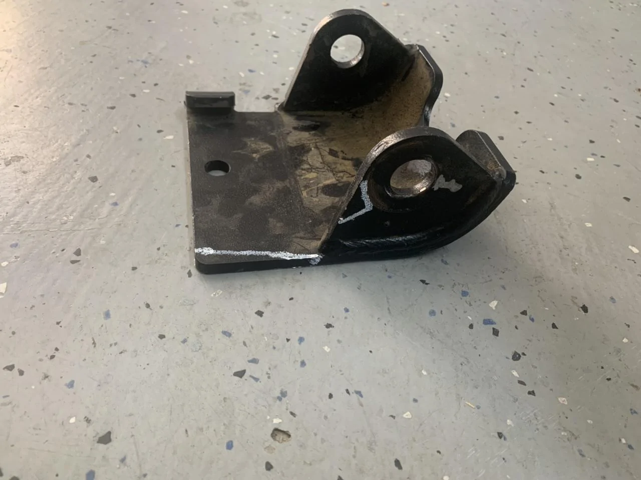

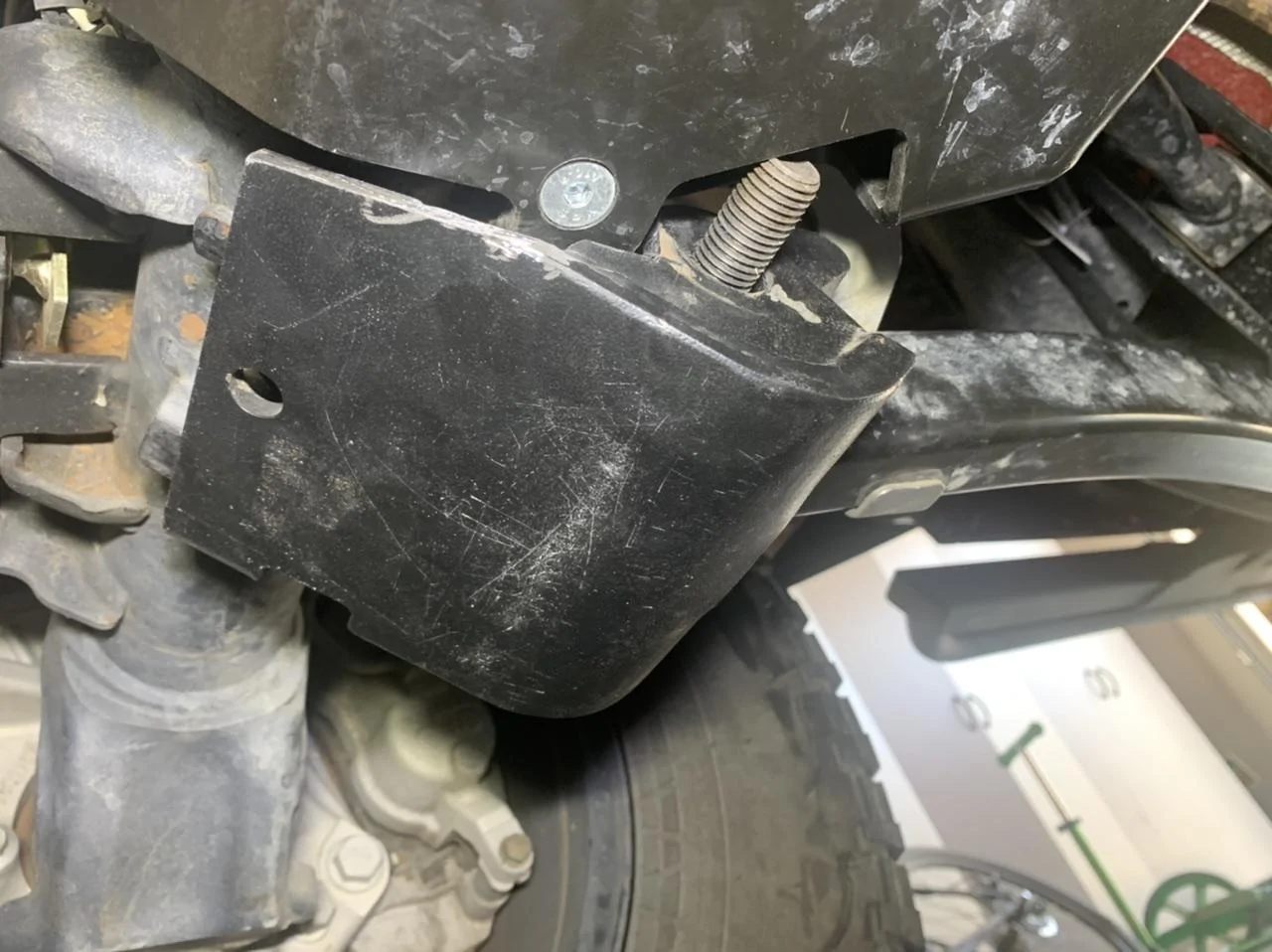

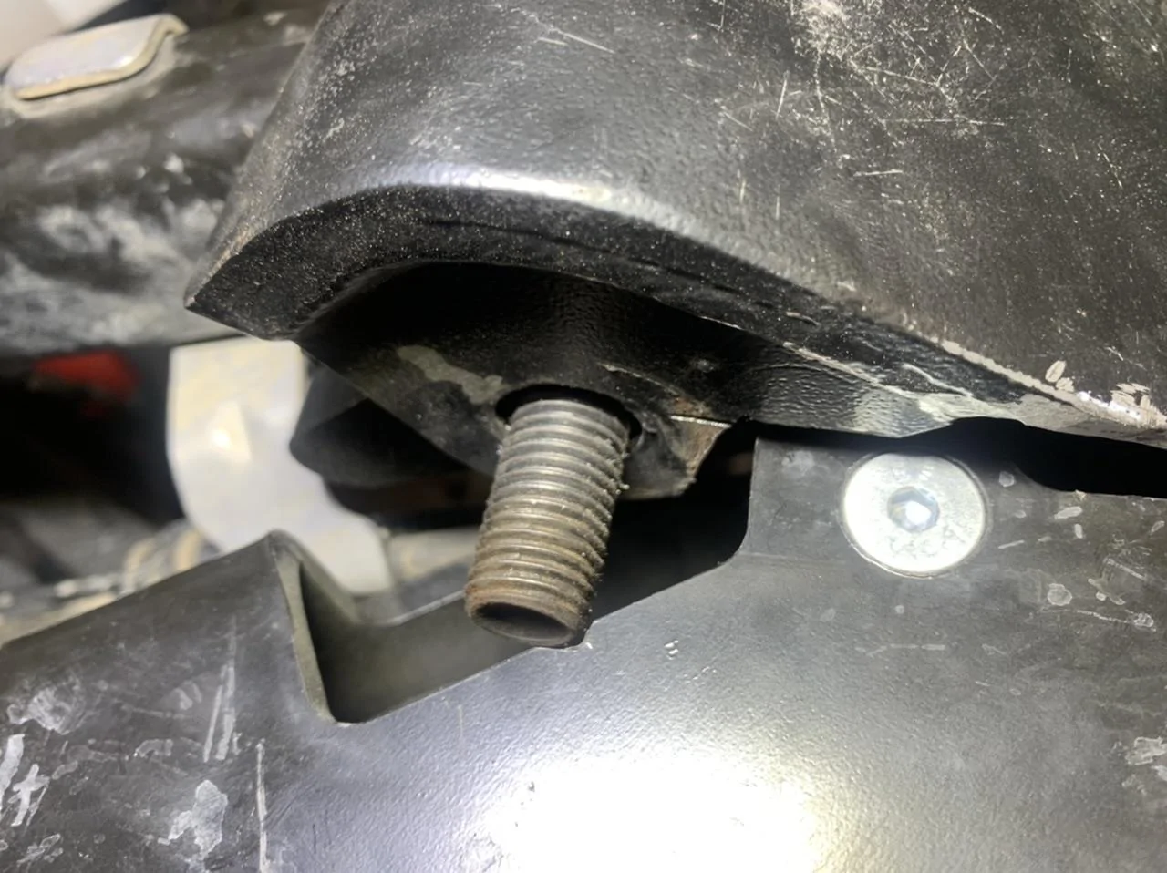

Got rid of a clunk, and got my LCA skid to fit with my Clayton FAD skid.
I’ve been having a clunk when switching forward/reverse, couldn’t figure it out but assumed from either loose LCA bolts from the Rock Hard skids, or other control arm bolts from putting the spacer lift and geometry brackets on. Also tightened the drag link and tie rod ends, which I could grab and rotate a degree or two and make them clunk.
That’s normal “play” for those, right?
The bolt on the LCA skid went like a whole turn or more before hitting 190. And the upper frame bolts on the geometry brackets tightened a little as well. All others still in spec.
for the skid plates, I’m sad I didn’t do this sooner. Only took me ten mins to cut with the angle grinder.
The Rock Hard bolts are pretty long, so I had to notch the Clayton skid to make room for the bolt. Did that in place with a dremel.
I had to do the same thing. I have a Rockhard FAD skid plate with the Rockhard LCA skid plates. I notched the FAD to fit and cut the bolt down.

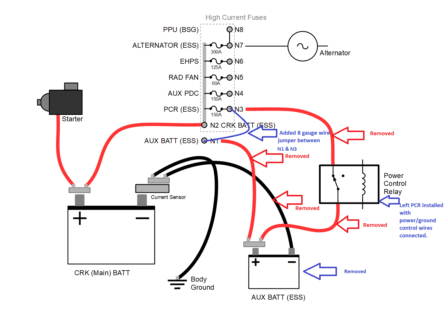

Finished up my aux battery delete this morning. Everything is running fine and am happy with it.
This is exactly what I want to do. I do have some questions tho. Do you jump n1, n2, & n3 together? Is there a thread just for this exact way of doing it? Ive been searching & reading threads for hrs, but keep finding the aux battery replacement threads. Ughhh
Jumper N1 and N3.
I have not seen a complete A to Z step thread on this. Just random threads touching on it. I have attached a block diagram that I found and added my notes with arrows of what to remove and add.

Jumper N1 and N3.
Thankyou very much. I want to eliminate all the extra wiring when I remove the aux batt like you did. I was assuming that N1 & N3 would need power from somewhere after doing so, but you jumped them together without adding a power lead to either one, is this correct? I’m also assuming you have no dummy light or codes.
sorry for the dumb questions. Just trying to understand it %100 before I go ripping everything out.
