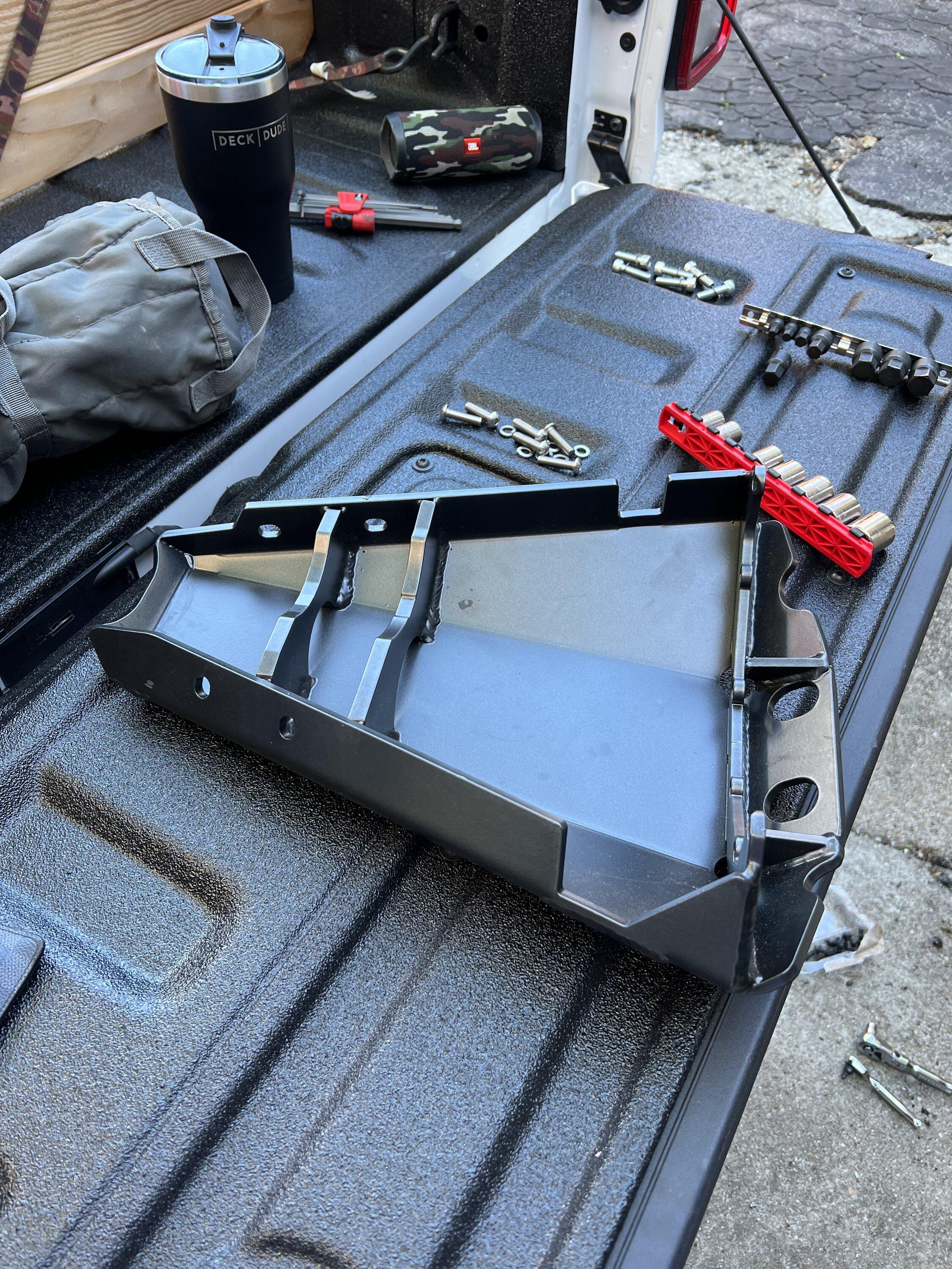

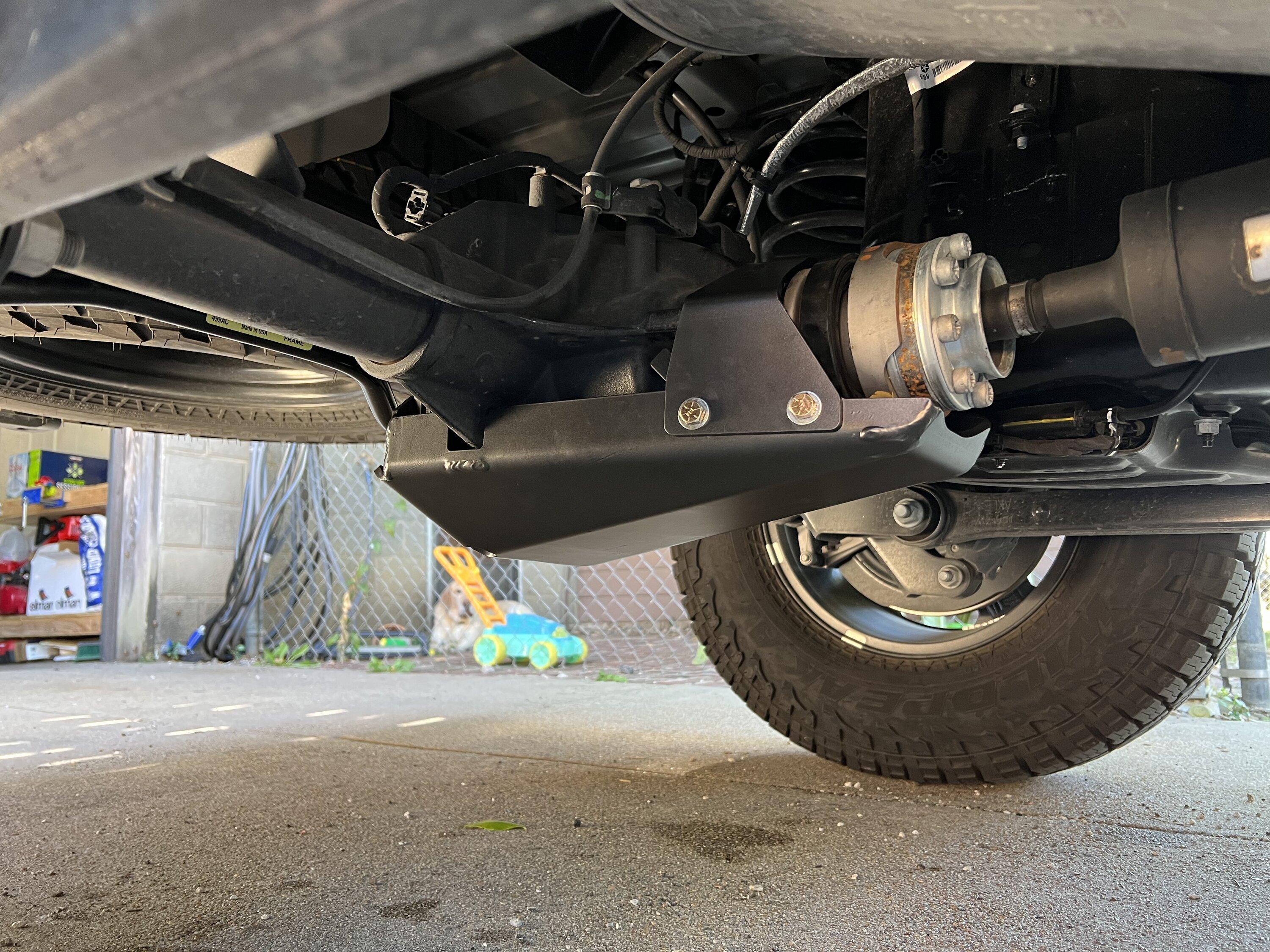

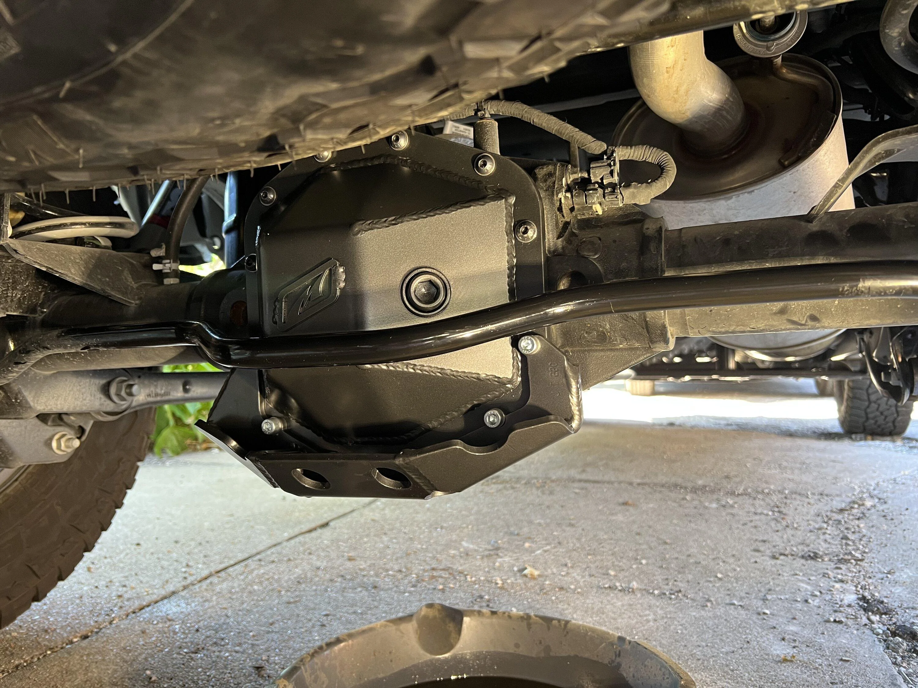

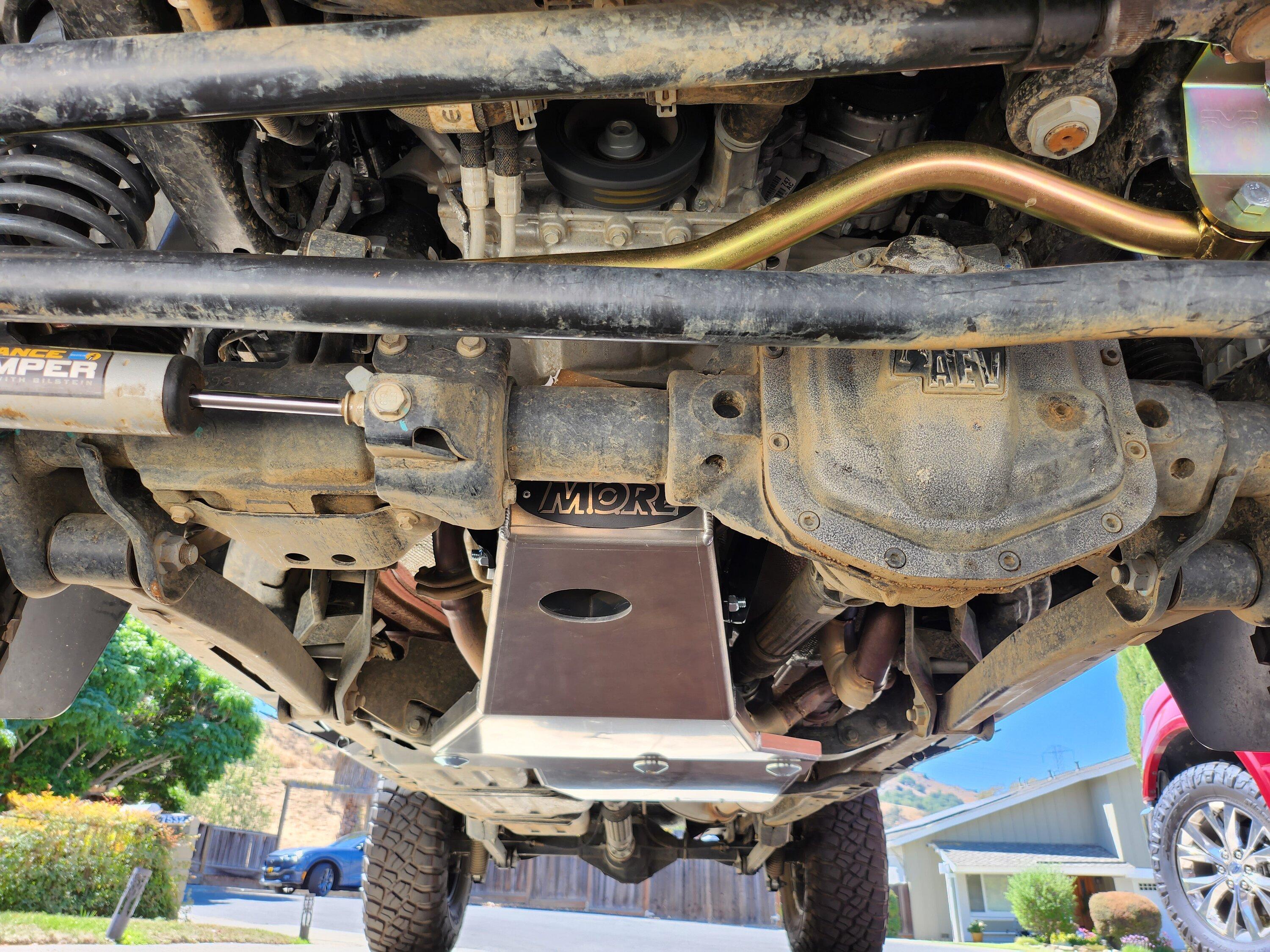

Threw on a Motobilt diff cover and Next Venture diff skid I picked up (brand new and powdercoated!) off a dude on the JL forums. Super beefy and I like that the skid covers the pinion seal and yoke.
You’ll love this skid. I’ve hit it dead on lots of times and there’s not a scratch on the diff cover or pinion. It’s bullet proof.

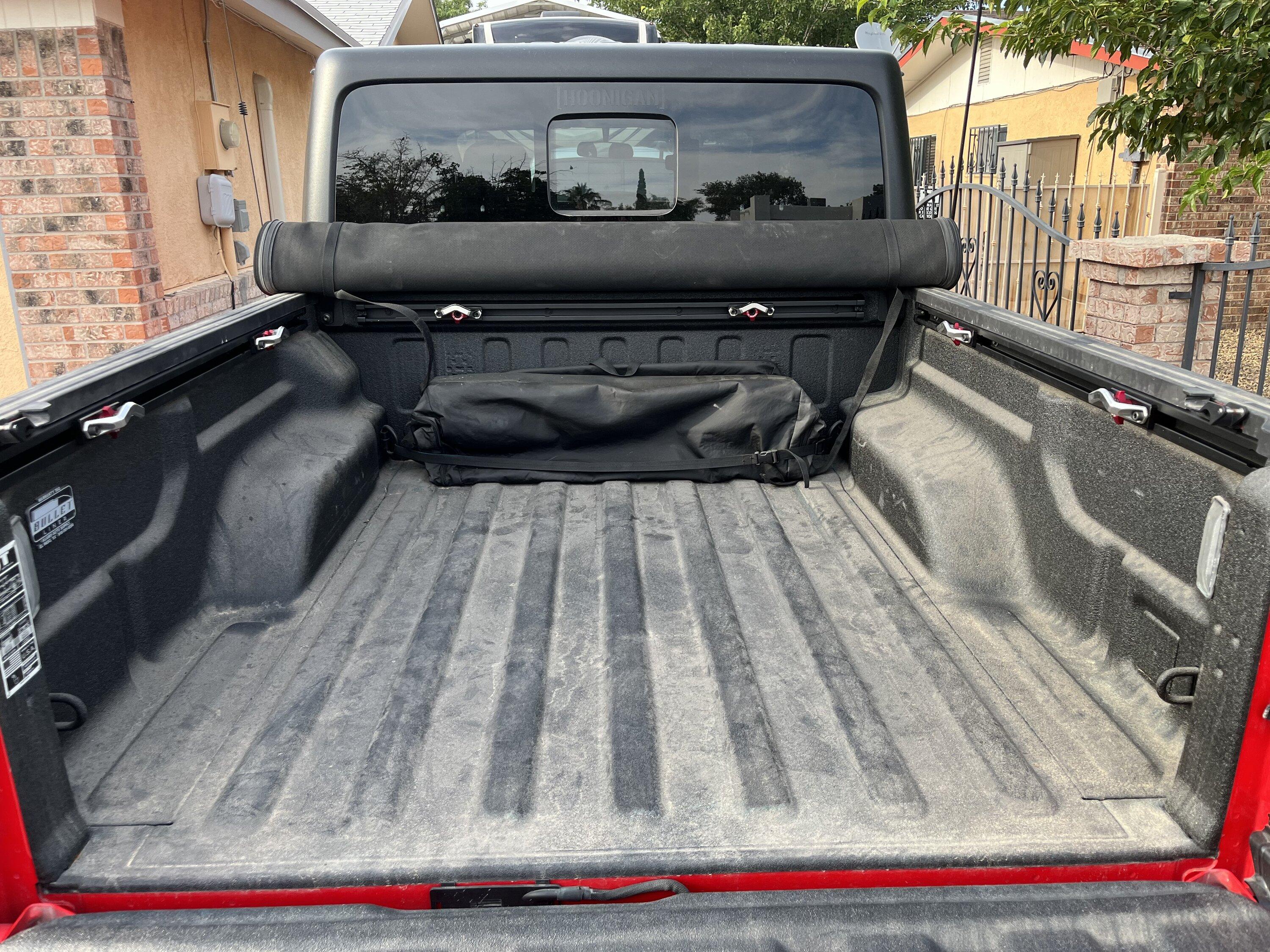

Installed the front falcon shocks. Still need to get around to the rears and wiring up the electronic Adapt system. Set the front rebound to performance. Set the compression to half way. Definitely a lot firmer jumping up and down on the front vs rear Mopar 2" shocks. Also took it for a drive and the rears fell like a bounce house in comparison to the falcons. Main reason I wanted to switch out to adjustable shocks was to stiffen things up when I have all my gear, rack and tent in the rear.

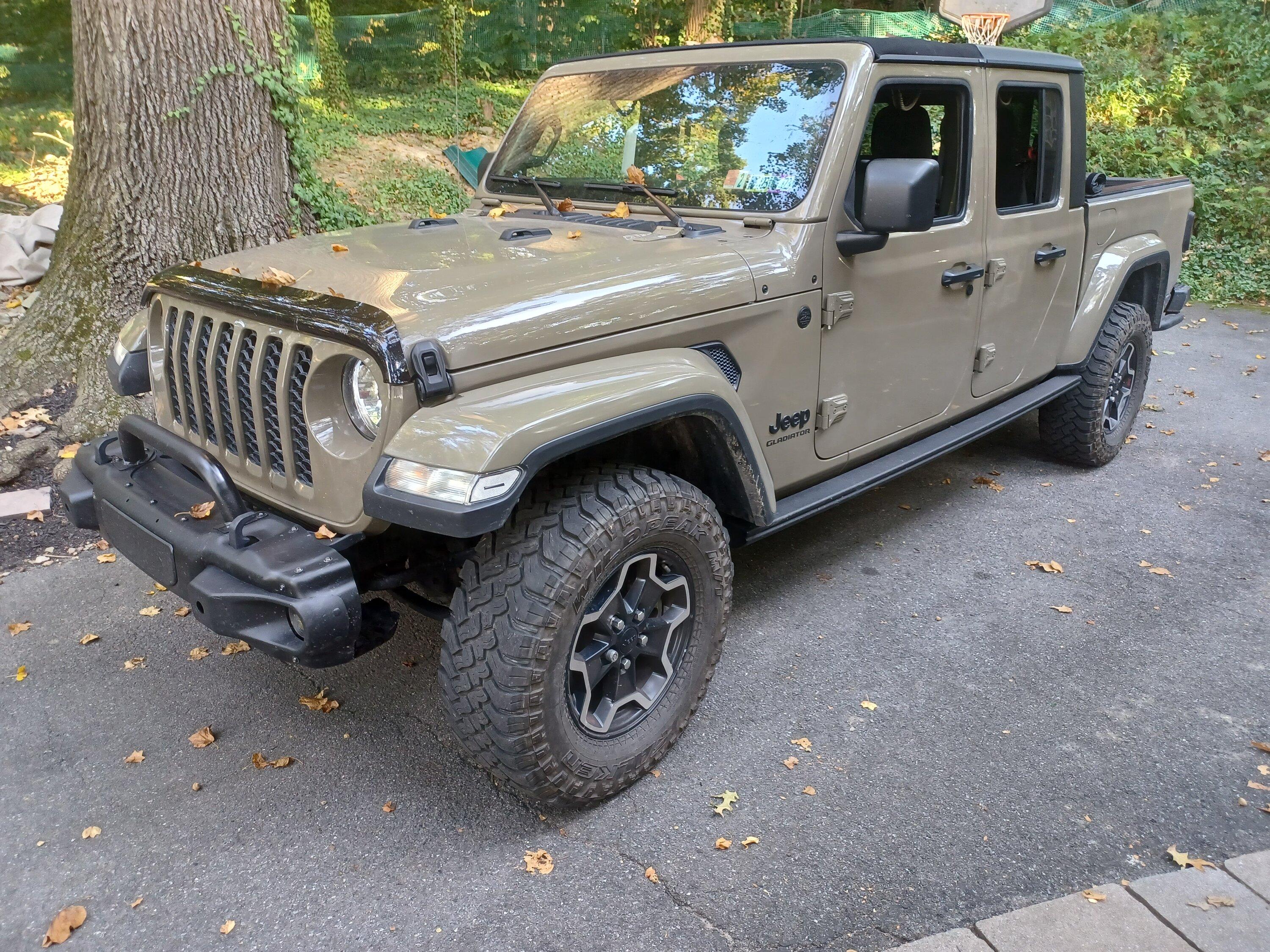

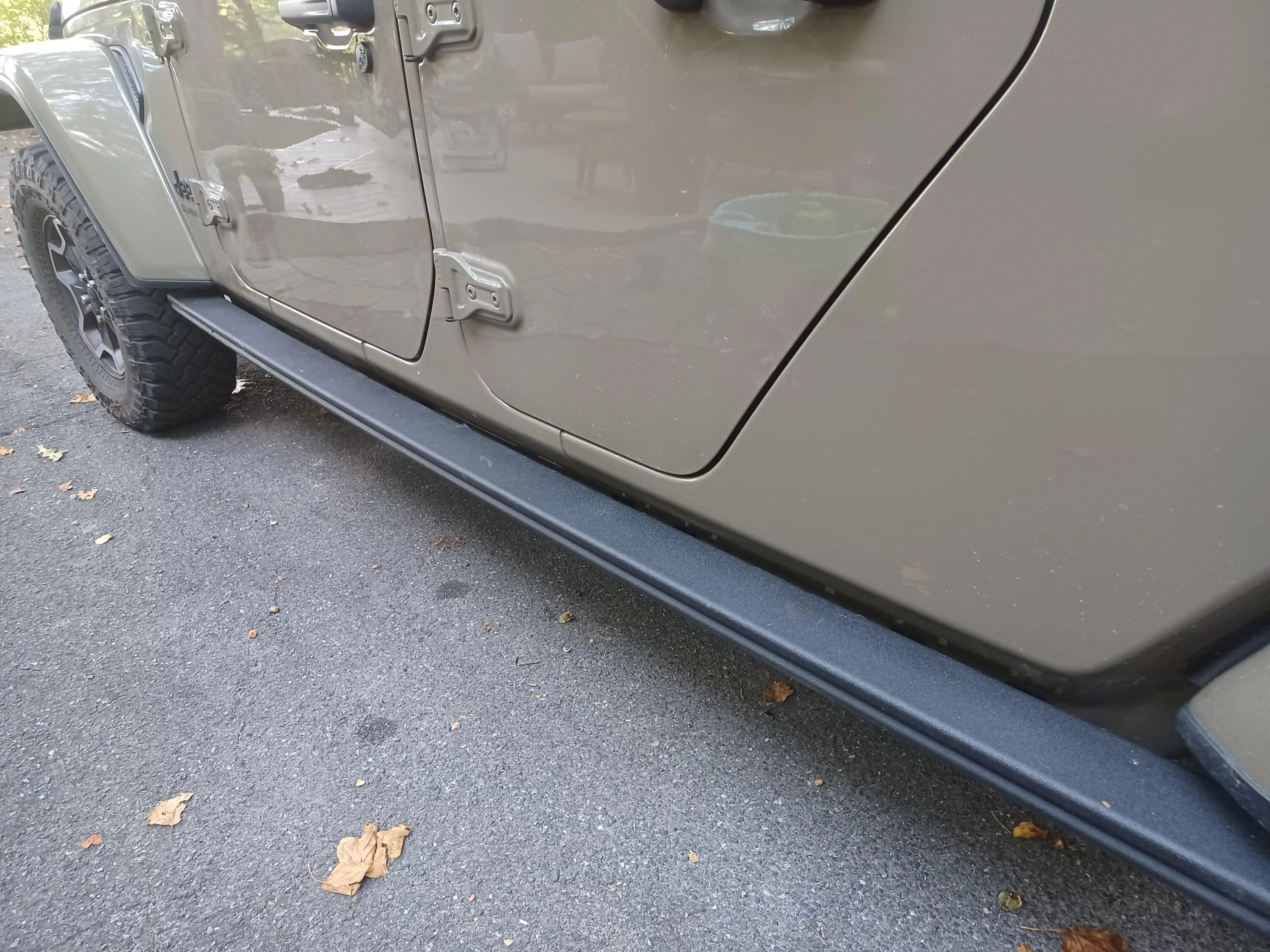

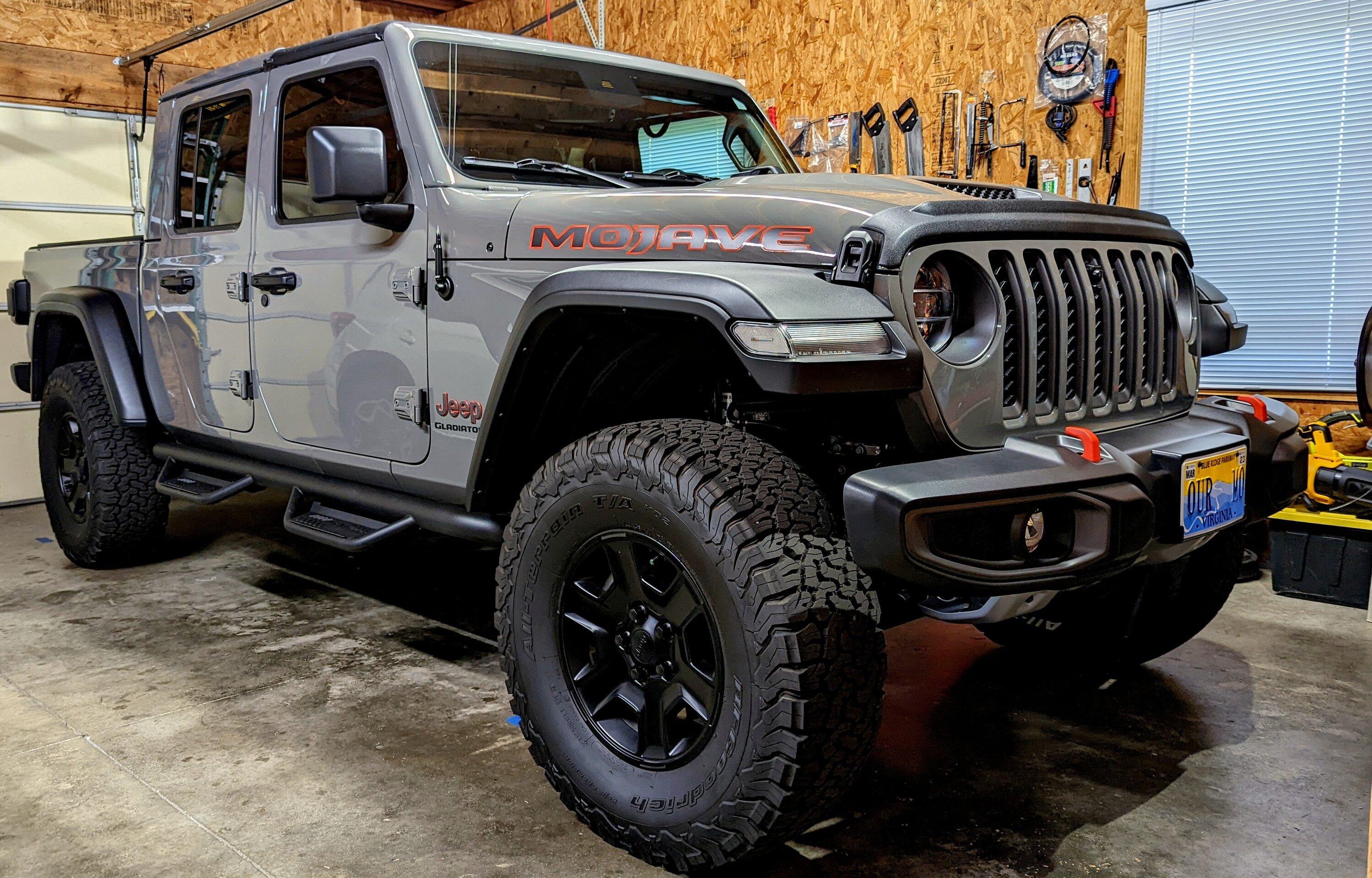

Finally got to replace my rough country side steps with enhanced Mopar sliders I picked up like new from the member marketplace a few weeks back for a bargain. Install was a breeze on these and I'm no longer stealing ground clearance from myself!

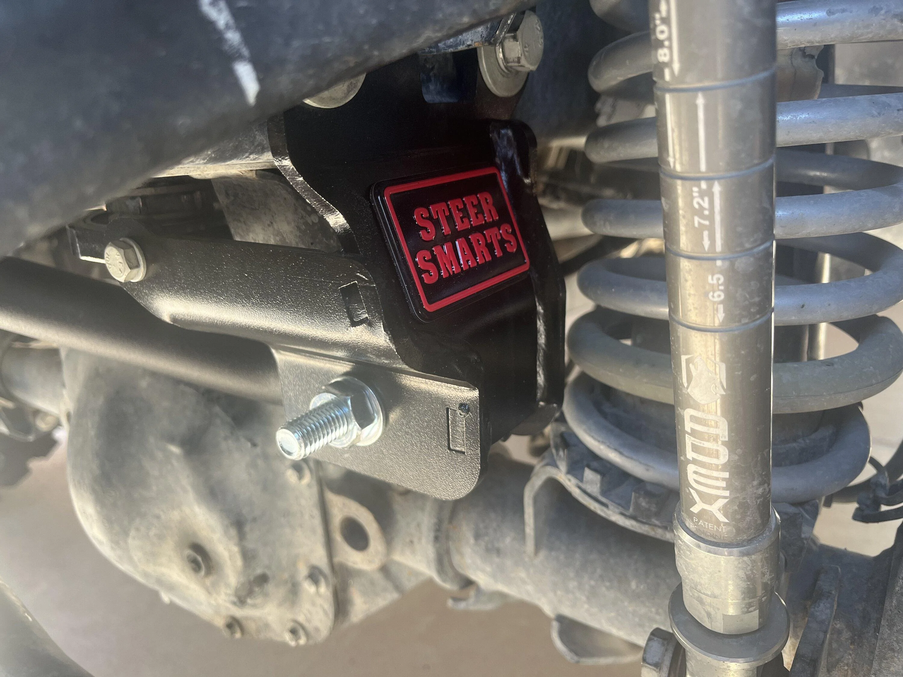

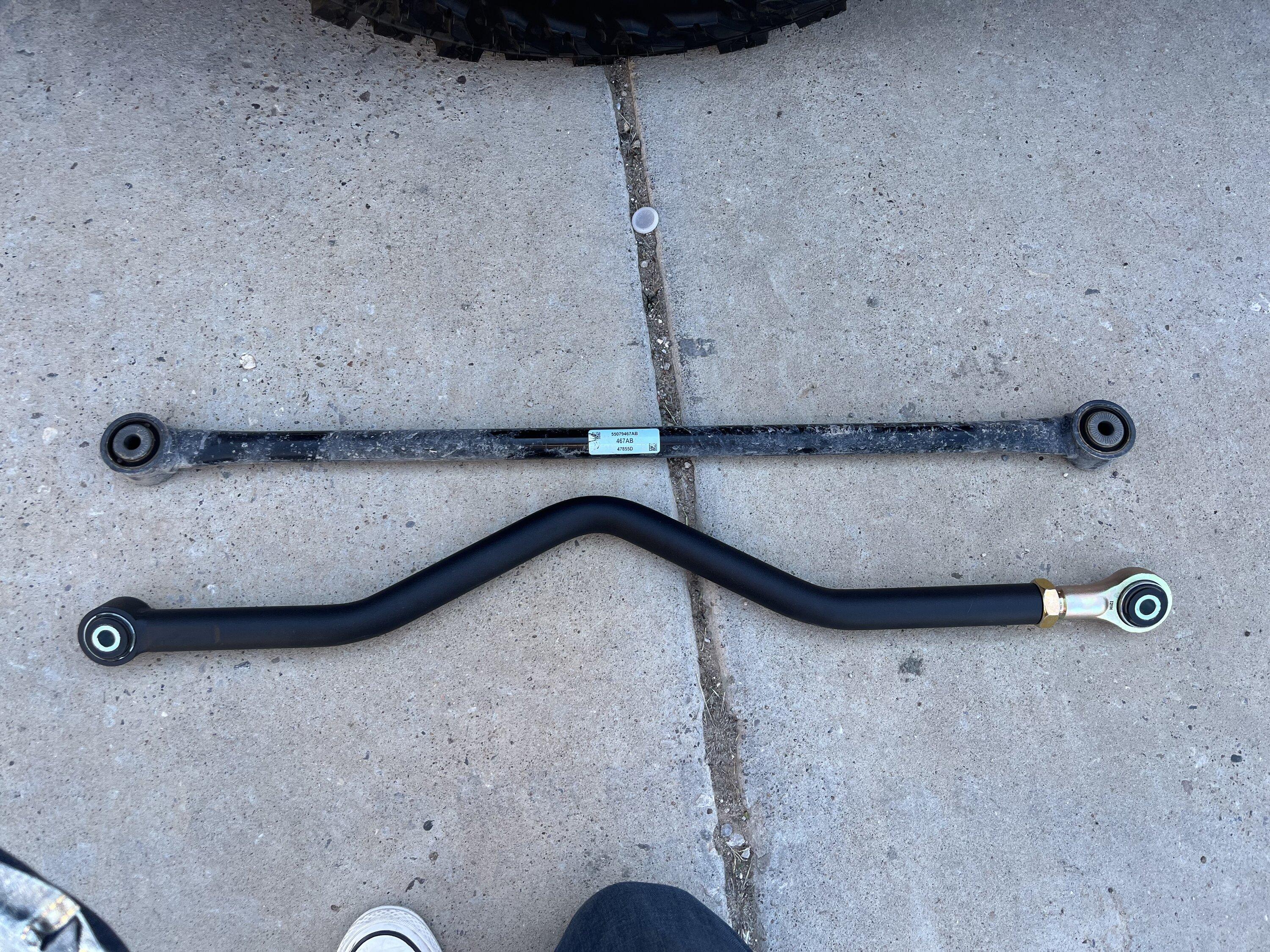

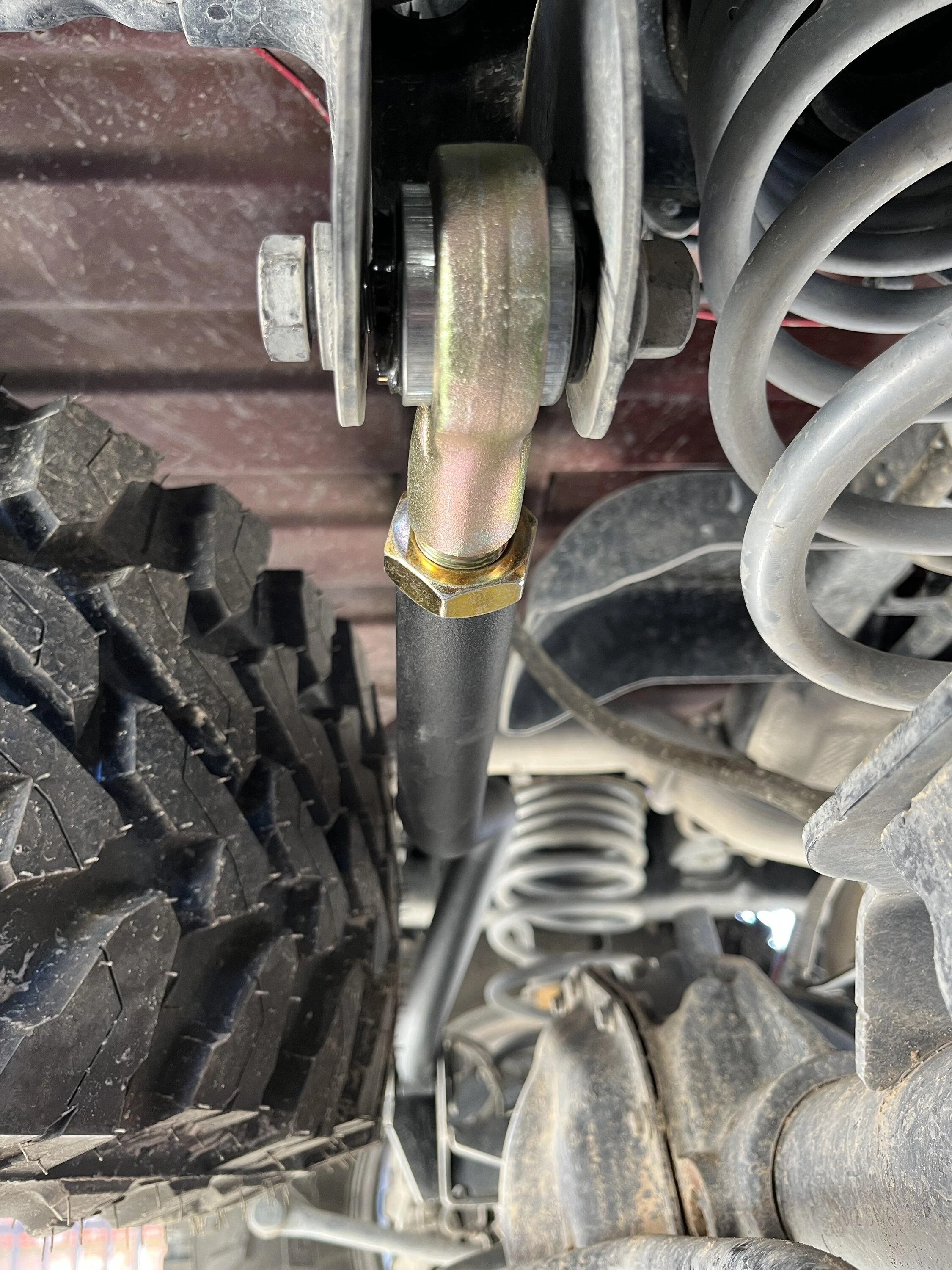

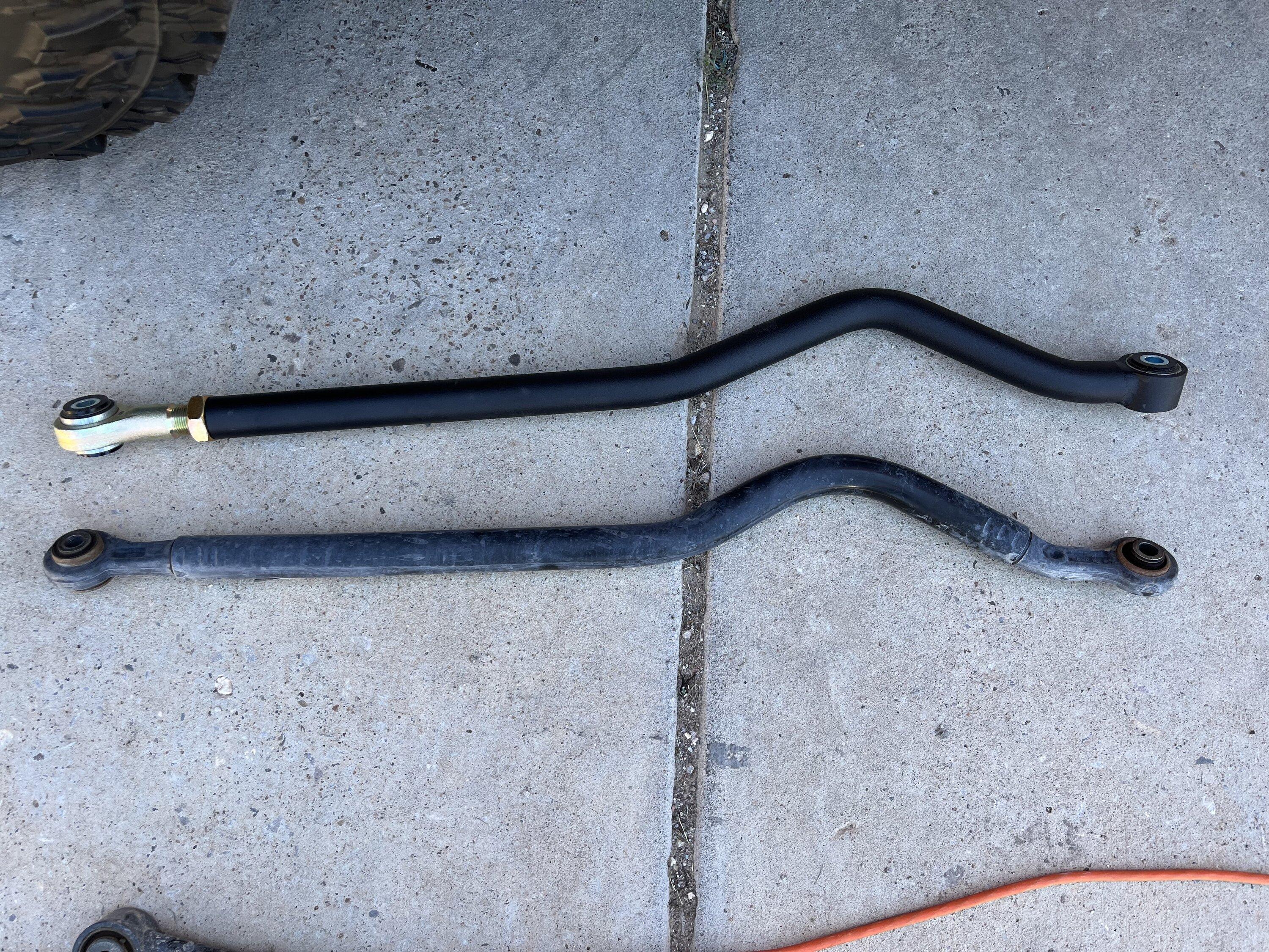

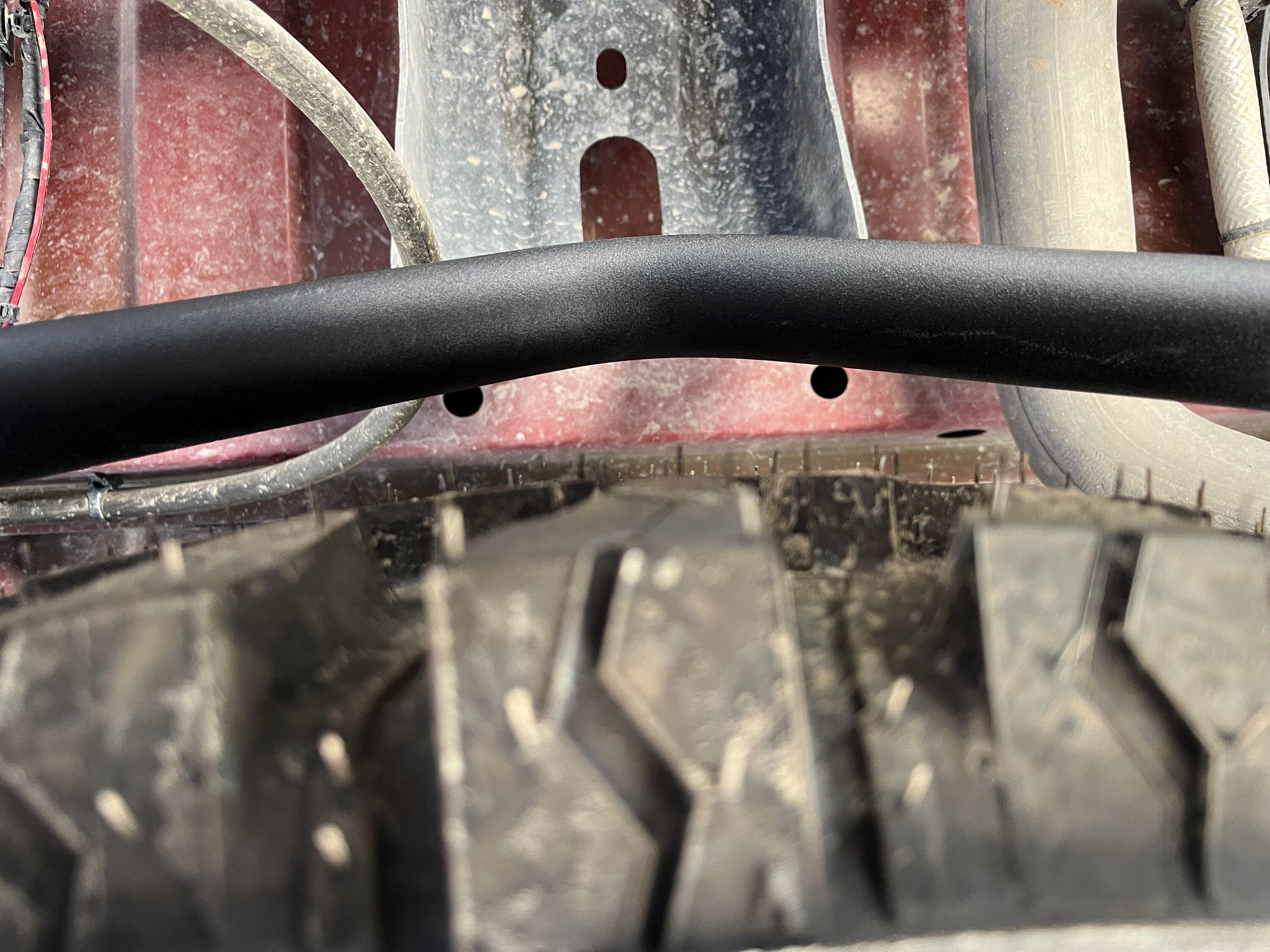

Fixed the rubbing issues I was having with the 37's on the rear track bar by replacing it with a Clayton rear track bar. Plenty of room now! Also added the front while I was at it, feels way stronger, and I was able to center both of my axles while I was at it. A nice win.
I also have a case of severe "While I'm in here syndrome" and added the Steer smarts reinforcement bracket when I ordered the track bars. Steering feels mint ? and I feel much more comfortable with the bigger tires (they forgot to give me my new track bar bolt, I'll put the proper hardware on later)
I also made a friend when I borrowed my old man's OTHER Mopar to buy the missing bolt, it's nice to see a survivor running around town, it was even right hand drive!
Did you have to jack your rear up to center the axle with the new track bar? Mine is off about a half inch, looking to adjust my track bar to get it centered better, but hoping I don’t have to loosen control arms, shocks, end links etc, nor jack it up to do so.
