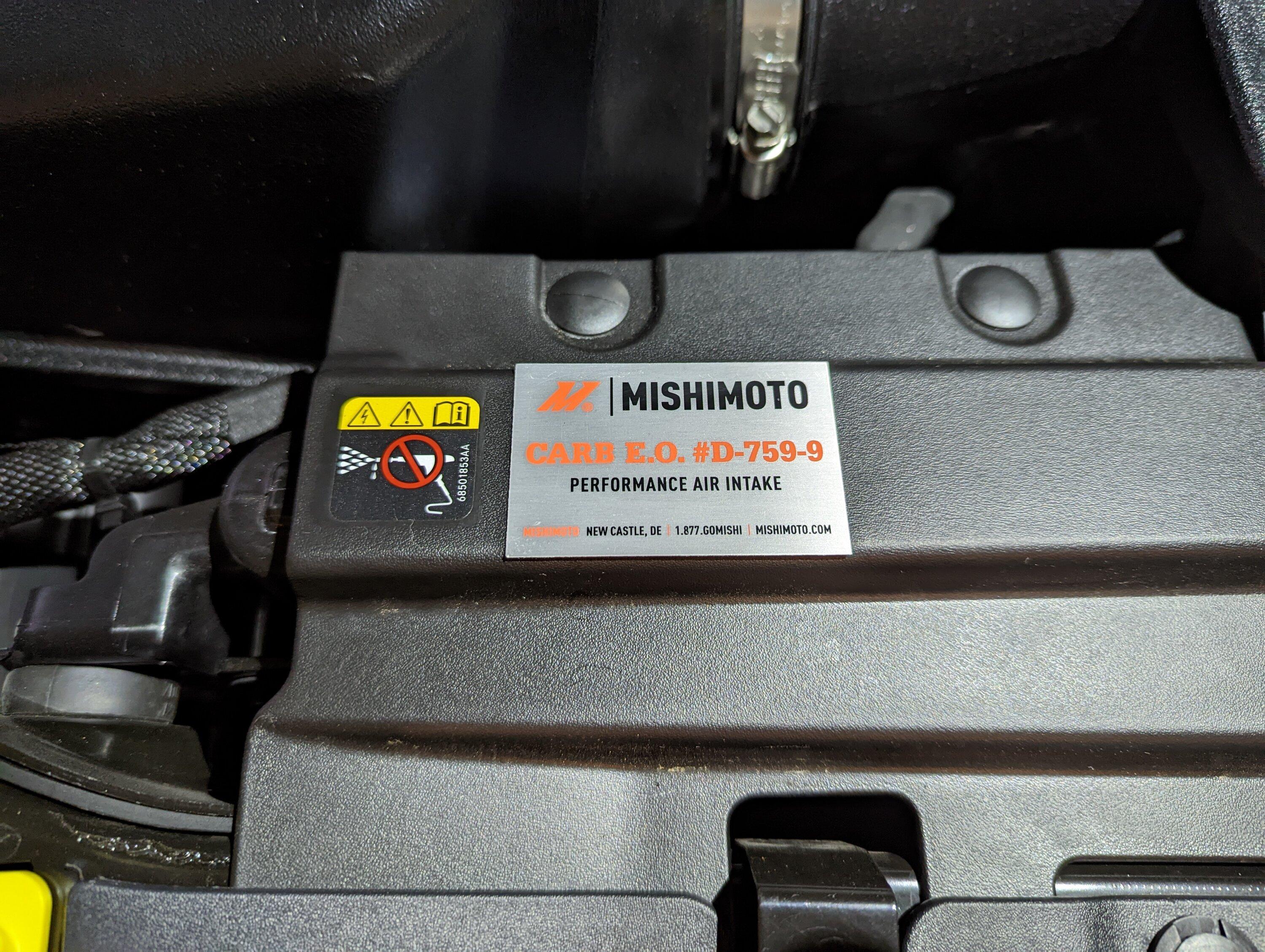

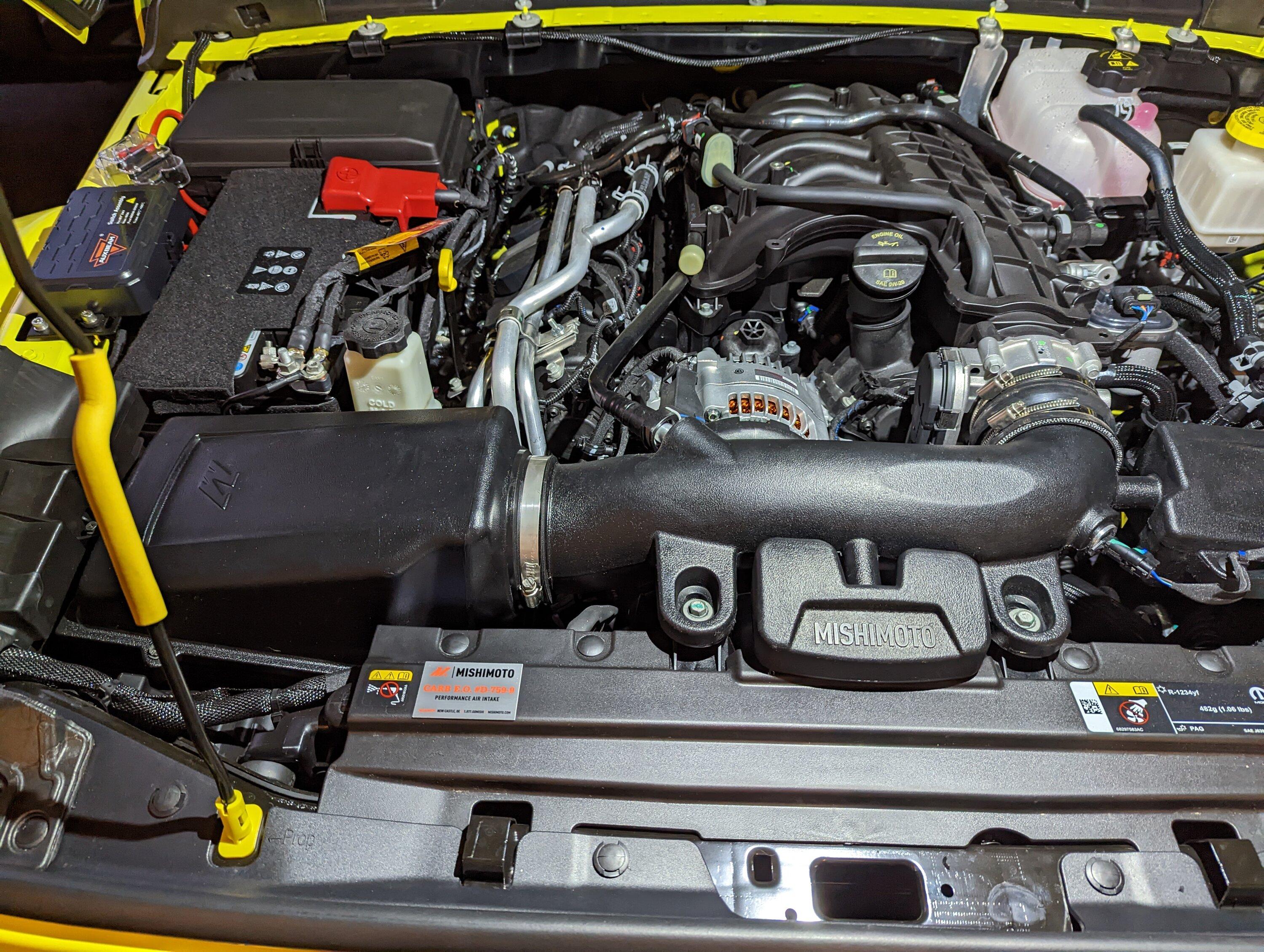

Added this today.....I've had a good relationship with Mishimoto over the years.
This intake and the iDrive EVC set at U.3.....its actually exceeding my expectations with this 3.6 on 37s. I should be ordering the AWE Trail exhaust next week. I think that will more than hold me over til I decide to do 4.88s

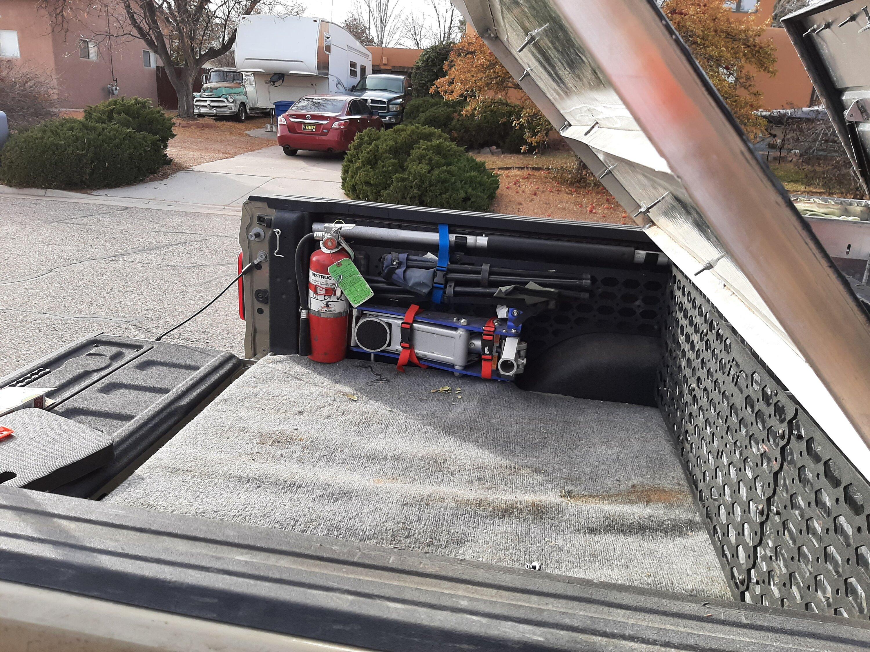

It isn't quite done and I didn't do it all today but I'm making glacial progress on my new bed cover set up. Stoll not sure I even like it but it was ~1/3 of diamond back. Please forgive the mess znd crap, I haven't vacumed it out
I've been thinking of trying to come up with something similar. Tell me more about your setup, please.

Sure thing rude, It started off as an aluminum cross bed tool box and some 1/8 al diamond plate. I didn't do this part but what he did was cut the tool box to extend it to the bed floor and to accommodate the gas filler and ten welded the pieces of plate together into the deck. He ran it bare as the deck lid and the tool box as separate units with the box clamping the deck lid down to the bed rails. When I got it I sprayed raptor liner on the toolbox lid and deck, then I added logistic tie down channels and mated the deck and box together with a long AL piano hinge. I plan to add some struts to make the deck go up easier and stay up. Oh and I added some very simple latches to keep it locked down when the tailgate is locked. I already had the molle panels so I moved to front of the bed panel to the rear of the tool box so I can still use it. I can remove the deck from the box with 5 or 6 ss screws into riv nuts
Let me know if you would like anything more.
