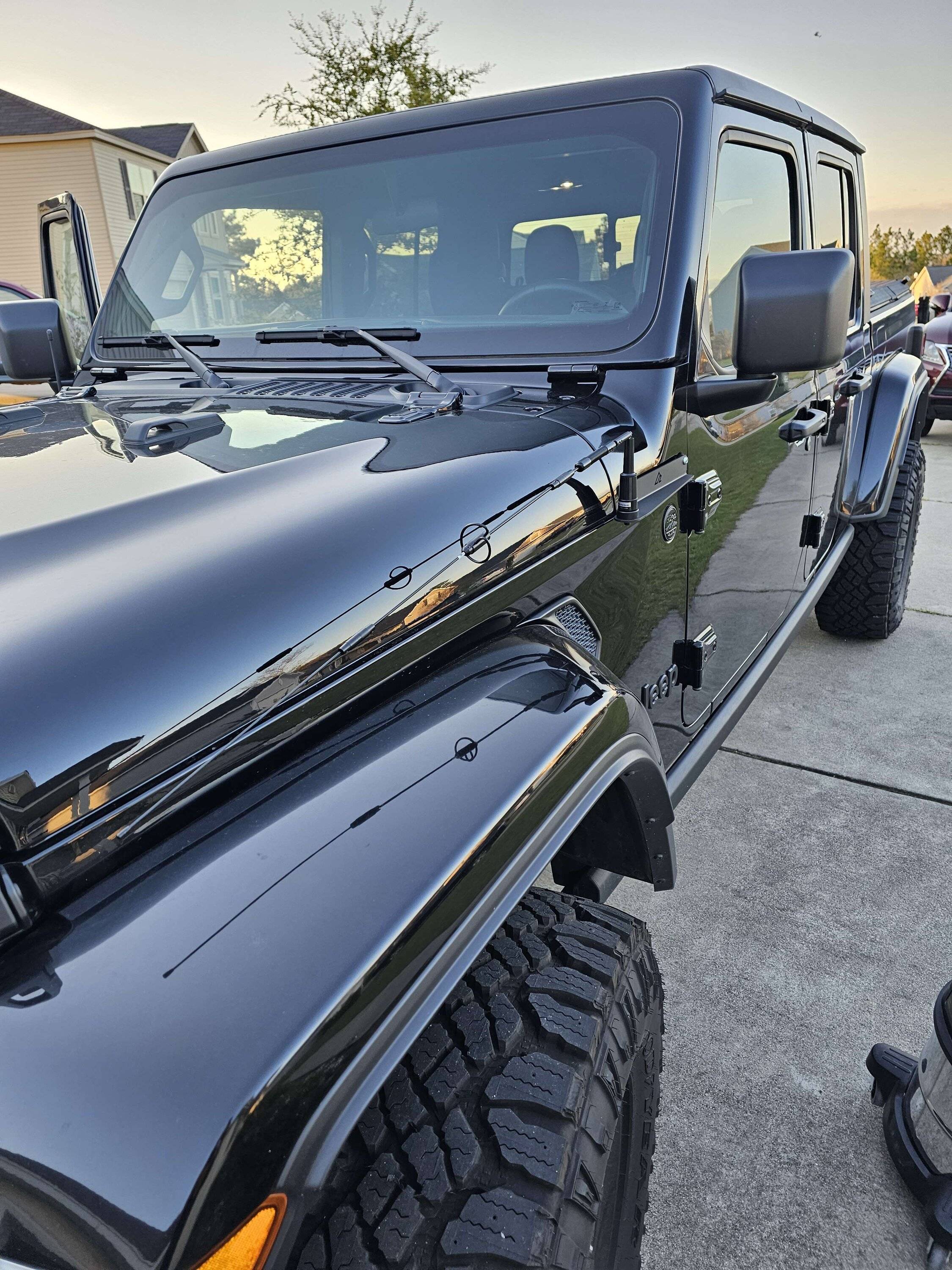

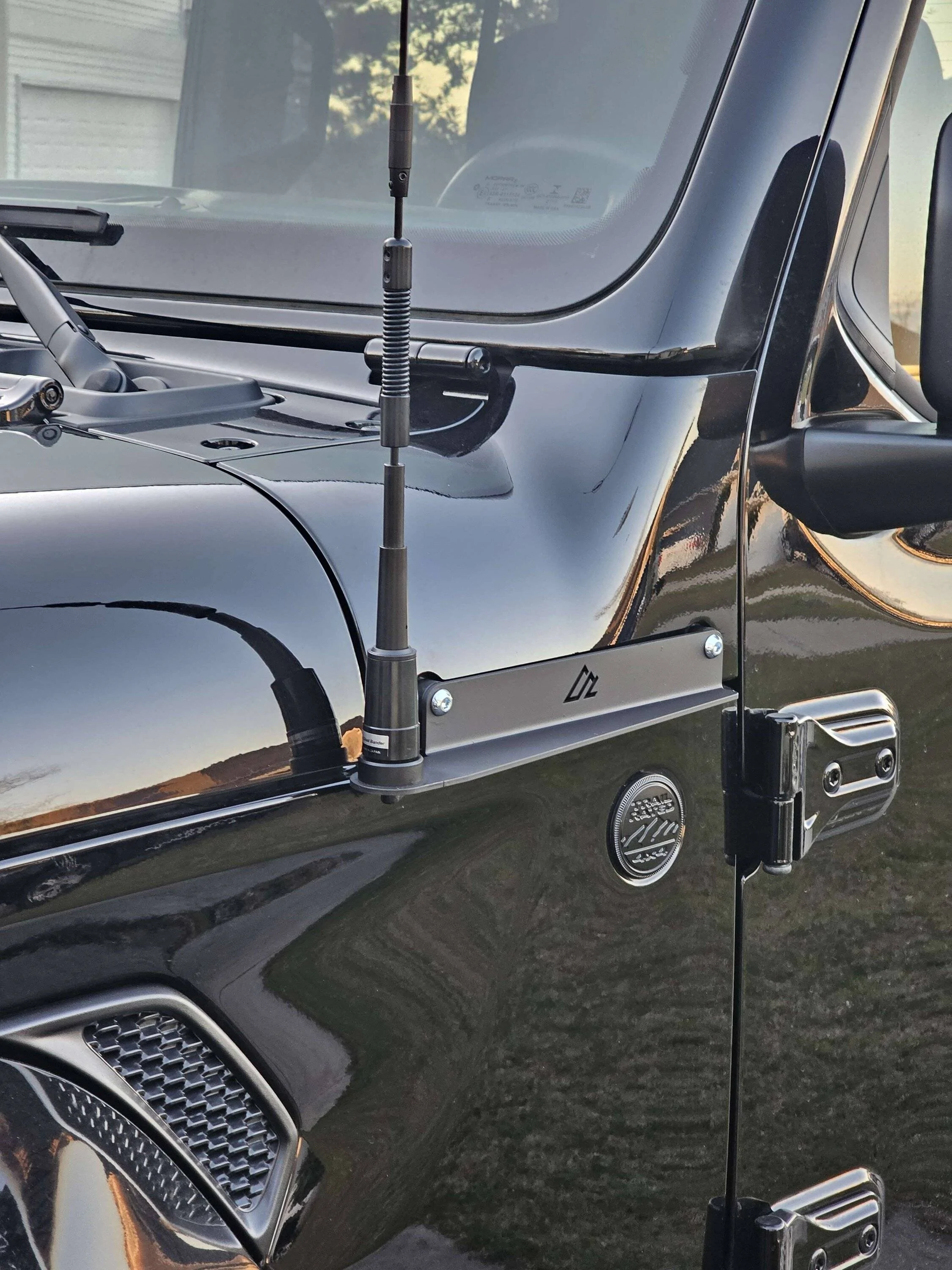

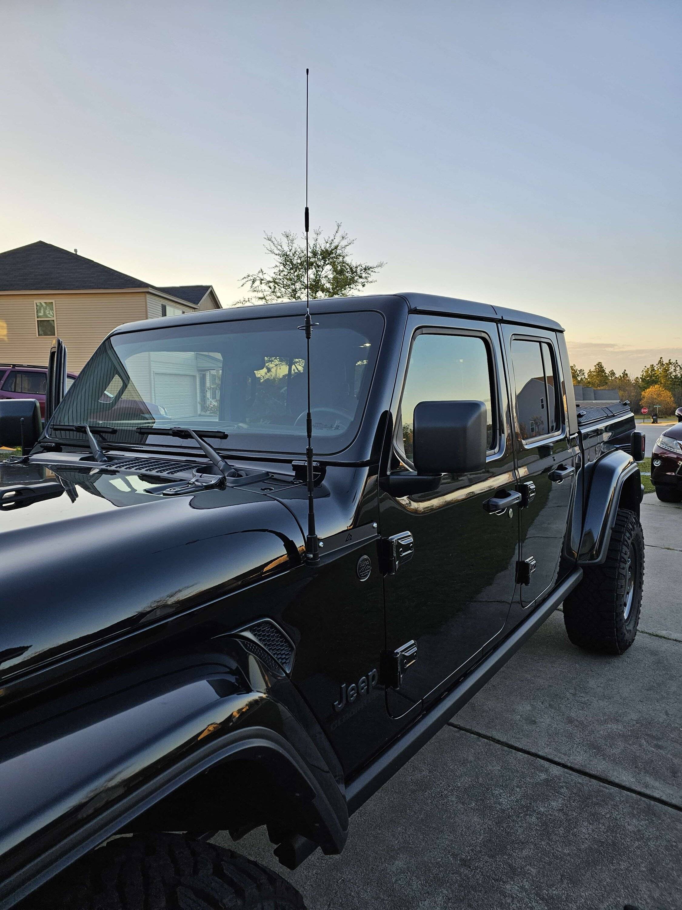

American Adventure Lab - Driver's Cowl Antenna Mount
Comet CS2x4SRNMO Dual Band Antenna
Yaesu FTM-200DR
Jeep Gladiator What did you do TO your Gladiator today? [ADMIN WARNING: NO POLITICS, NO GUN TALK] antennamount
Jeep Gladiator What did you do TO your Gladiator today? [ADMIN WARNING: NO POLITICS, NO GUN TALK] antennamount2
Jeep Gladiator What did you do TO your Gladiator today? [ADMIN WARNING: NO POLITICS, NO GUN TALK] antennamount3

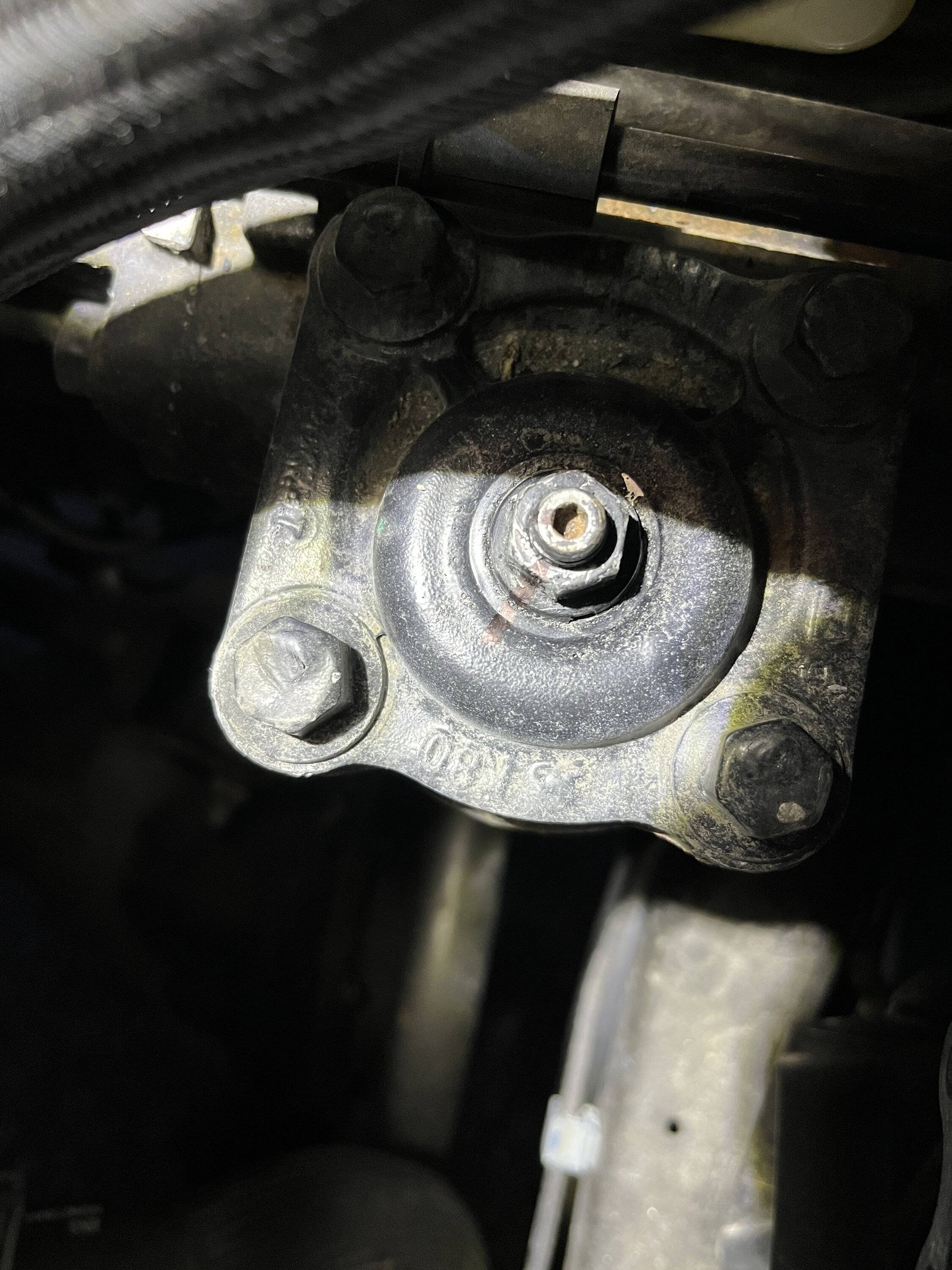

I did the steering box adjustment.
WHAT AN U BELIEVABLE IMPROVEMENT!
the jeep should have always drove like this.
i cleaned up the metal and wire brushed the threads to get the paint off of some of them before heating it and making my adjustment.
i did just shy of a 1/4 turn. The immediate improvement is wild. I may or may not adjust to the full 1/4 before re painting it. I want to drive it a bit more first.
i also ended up doing my wifes JLU. Found that she had the aluminum box still. So i did a 1/4 turn on heres. Absolutely amazing improvement.

How did you heat it? Not sure if a soldering iron would work or not.

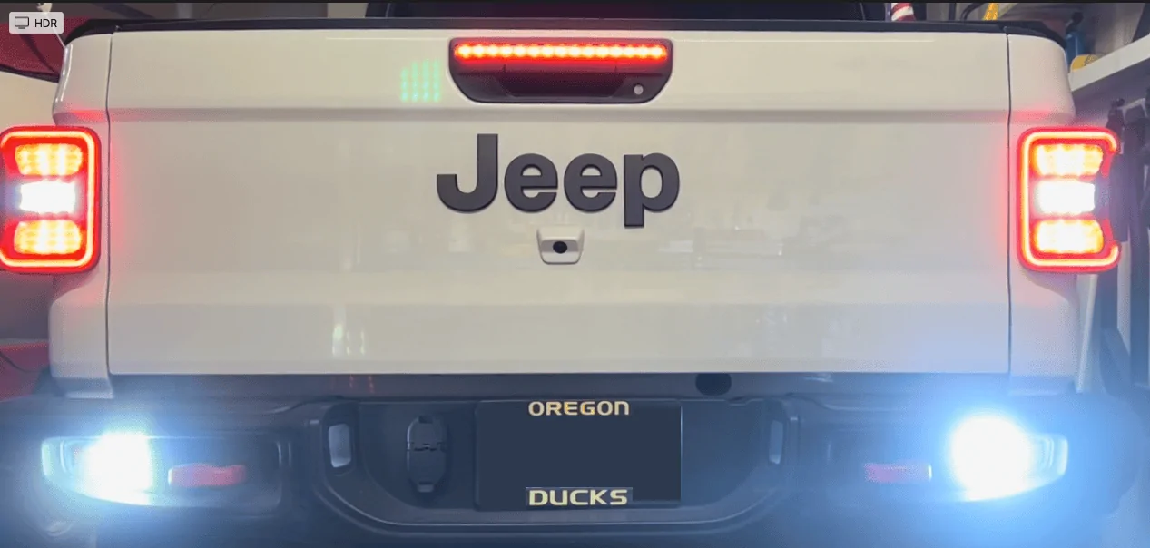

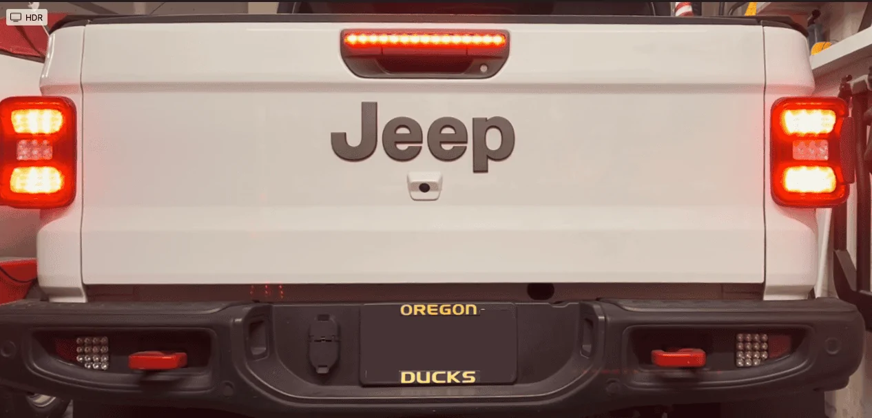

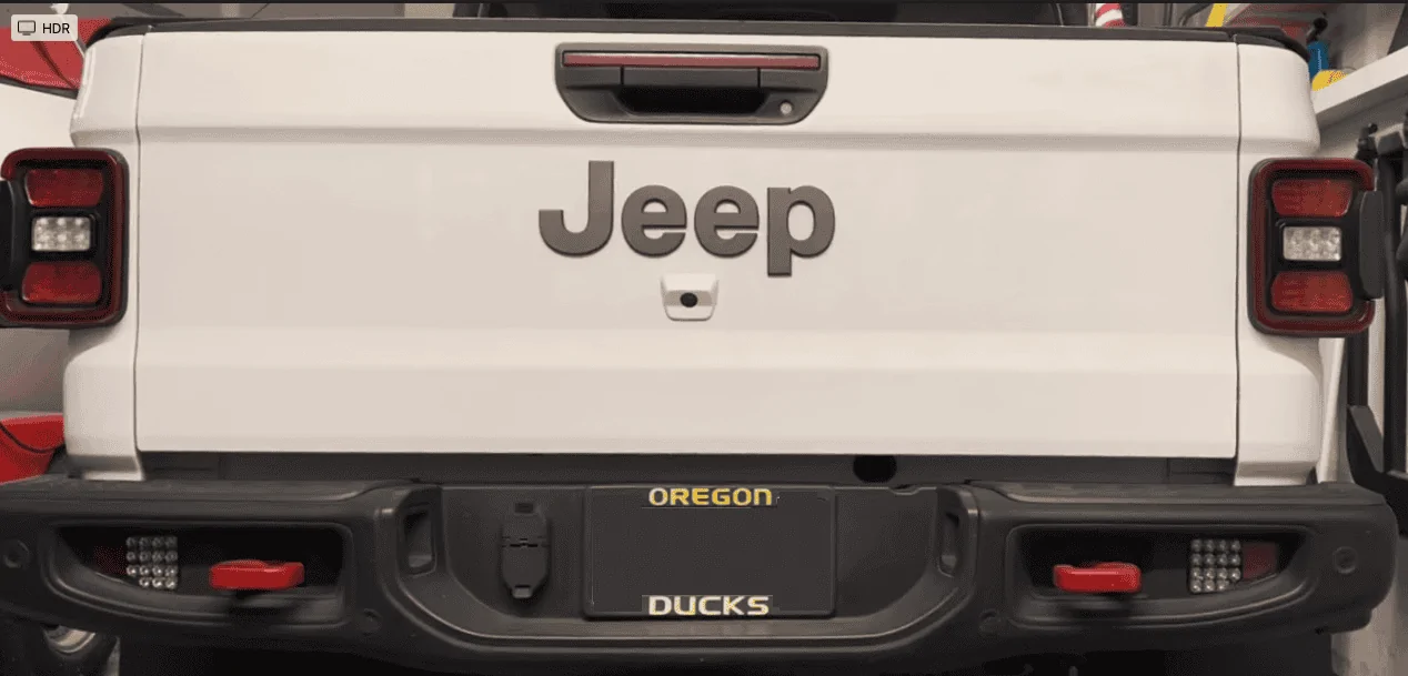

Nothing all that new or original, but since I back into my garage every day I wanted to have a really good view. The LED's on the Gladiator are pretty good, but these Oracle LED Reverse Lights should made a big difference. The wiring harness made it a breeze.
I don't care about the Backup lights... I just wanted to say Go Ducks!
