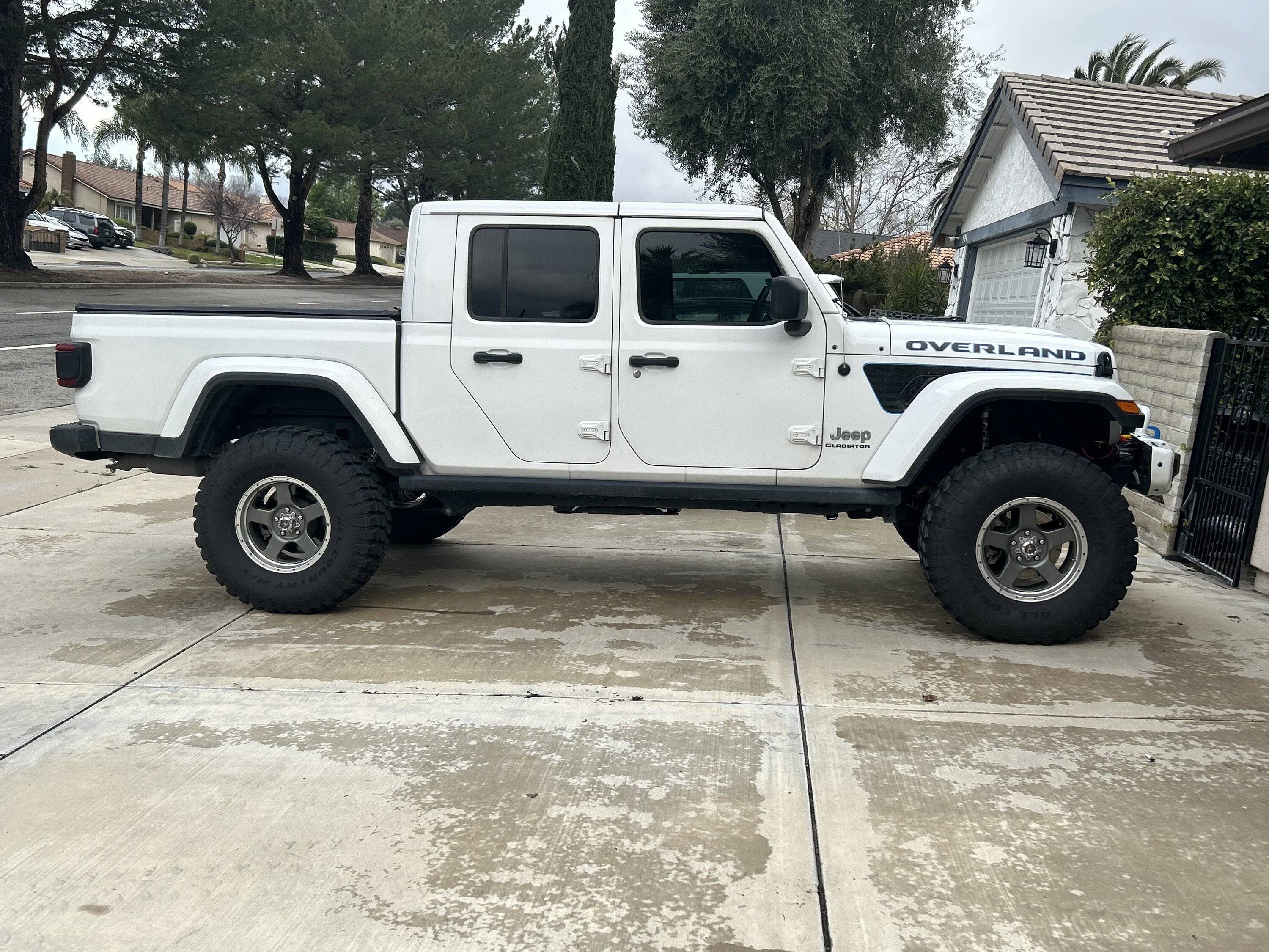

Ok she’s done. I got through the point where I hated life and kept pushing. Steering wheel is still off by a bunch and it’s turning my stability control light on but that’s an easy fix.
Front: Rusty’s diesel specific 4” springs
Teraflex 1/2” spacers
ReadyLIFT end links
ReadyLIFT lower control arms
ReadyLIFT track bar
Falcon SP2.1 shocks
Rear: ReadyLIFT 3” spacers
ReadyLIFT end links
Falcon SP2.1 shocks
Clayton rear track bar
The end result is a perfectly leveled truck, 8 3/4” from tire to fender front to back. Did it by myself in my driveway in roughly 10 hours in the rain.

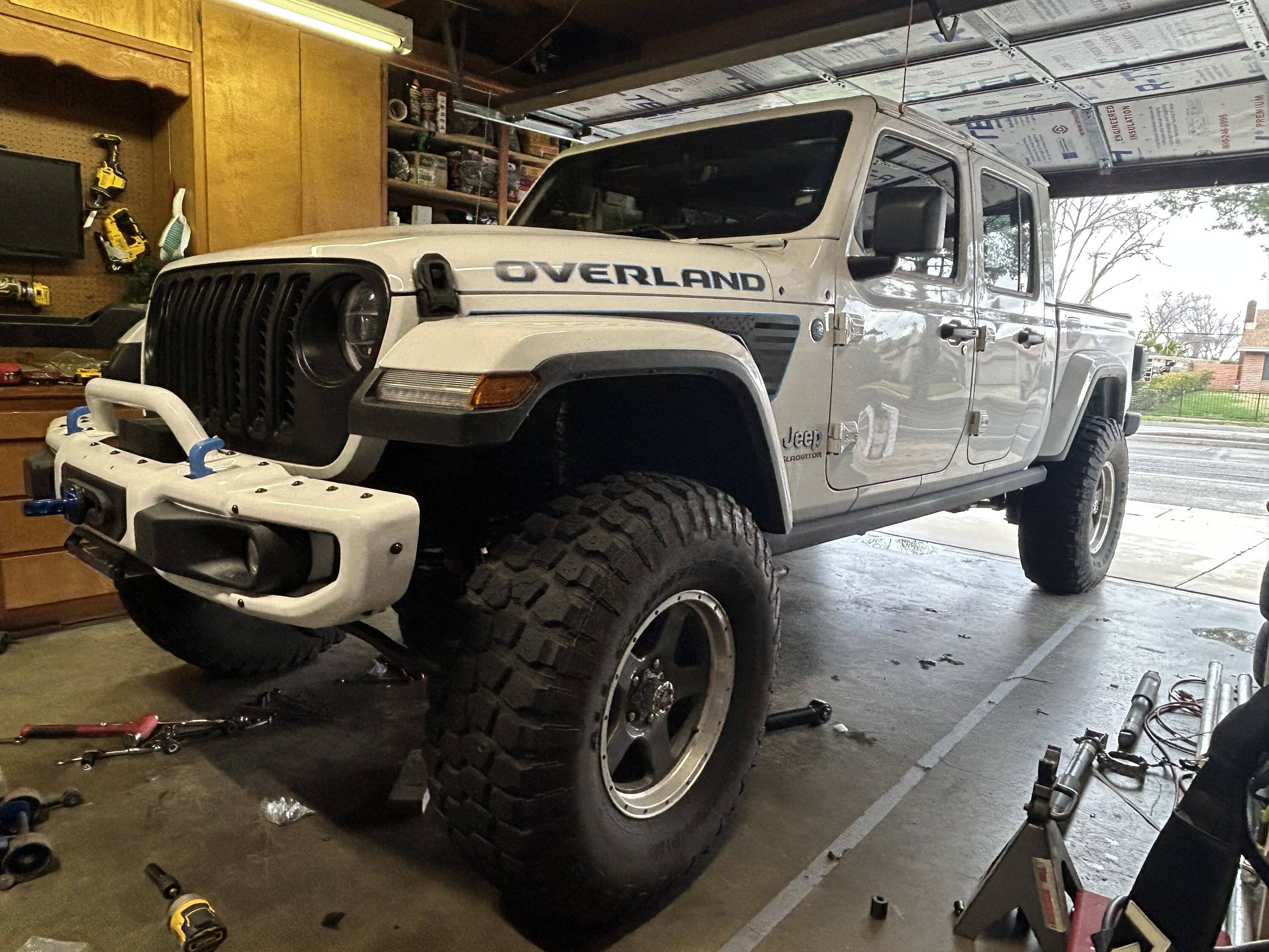

Finally mounted my Smittybilt x20 gen 2 winch with a Factor55 ultrahook. Had to get some longer bolts though with the RockHard 4x4 aluminum bumper and steel spacers.

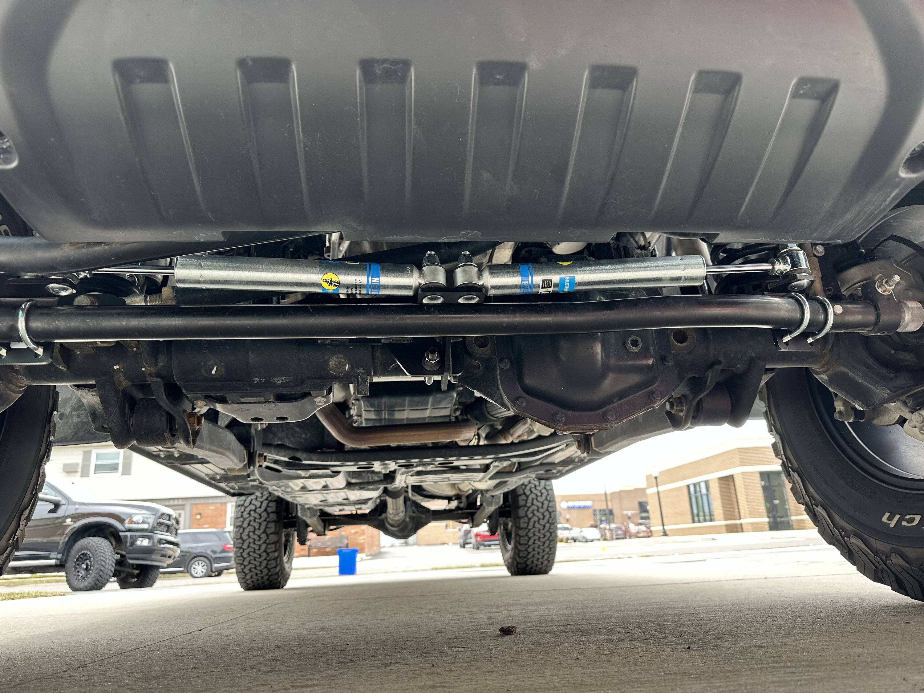

I decided to install a dual steering stabilizer, hoping to eliminate some bump steer/wandering that I had. Took the risk, since I wasn’t sure if it was just a gimmick. Definitely a noticeable difference in how handles. I’m pleased.
