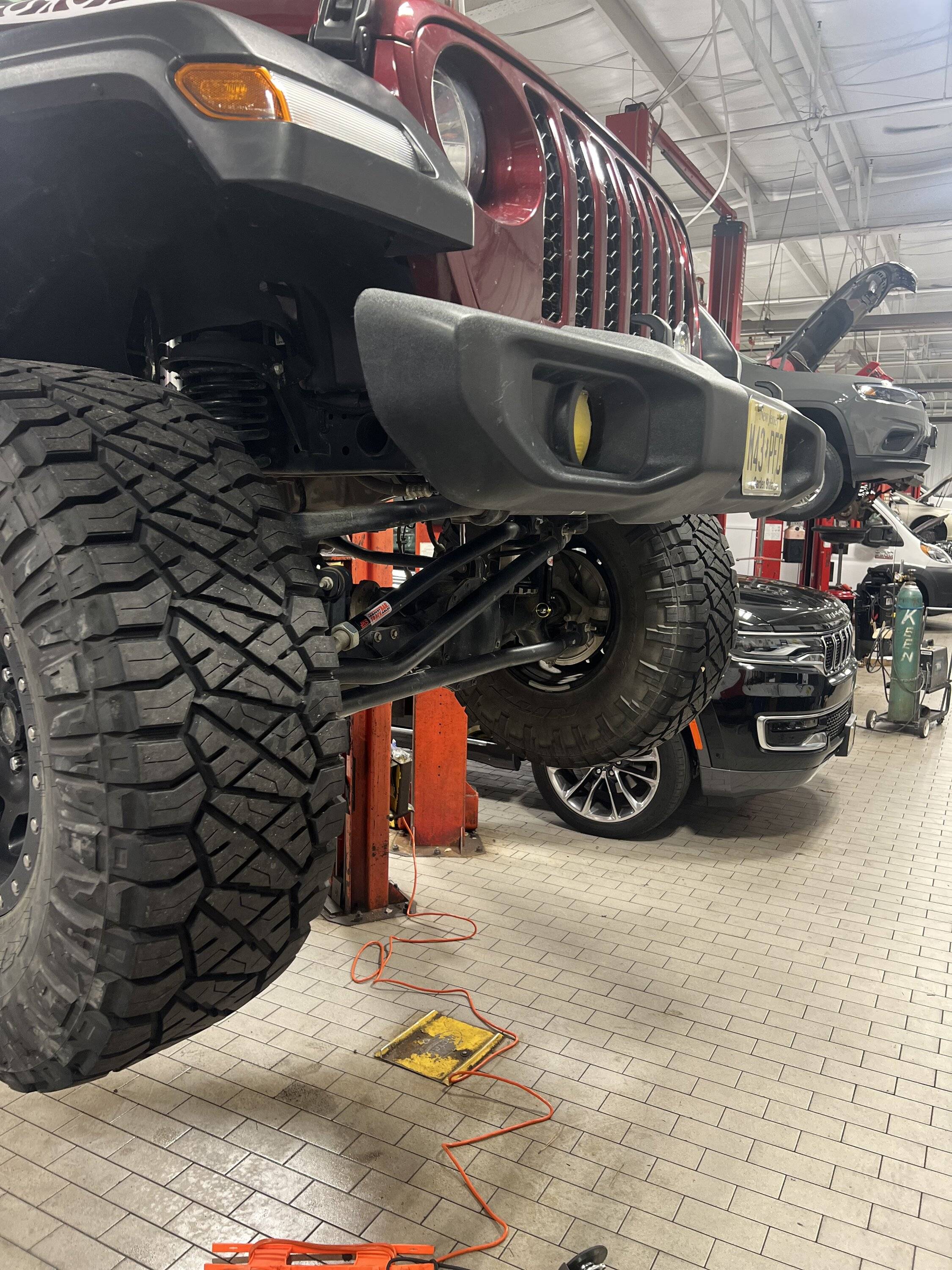

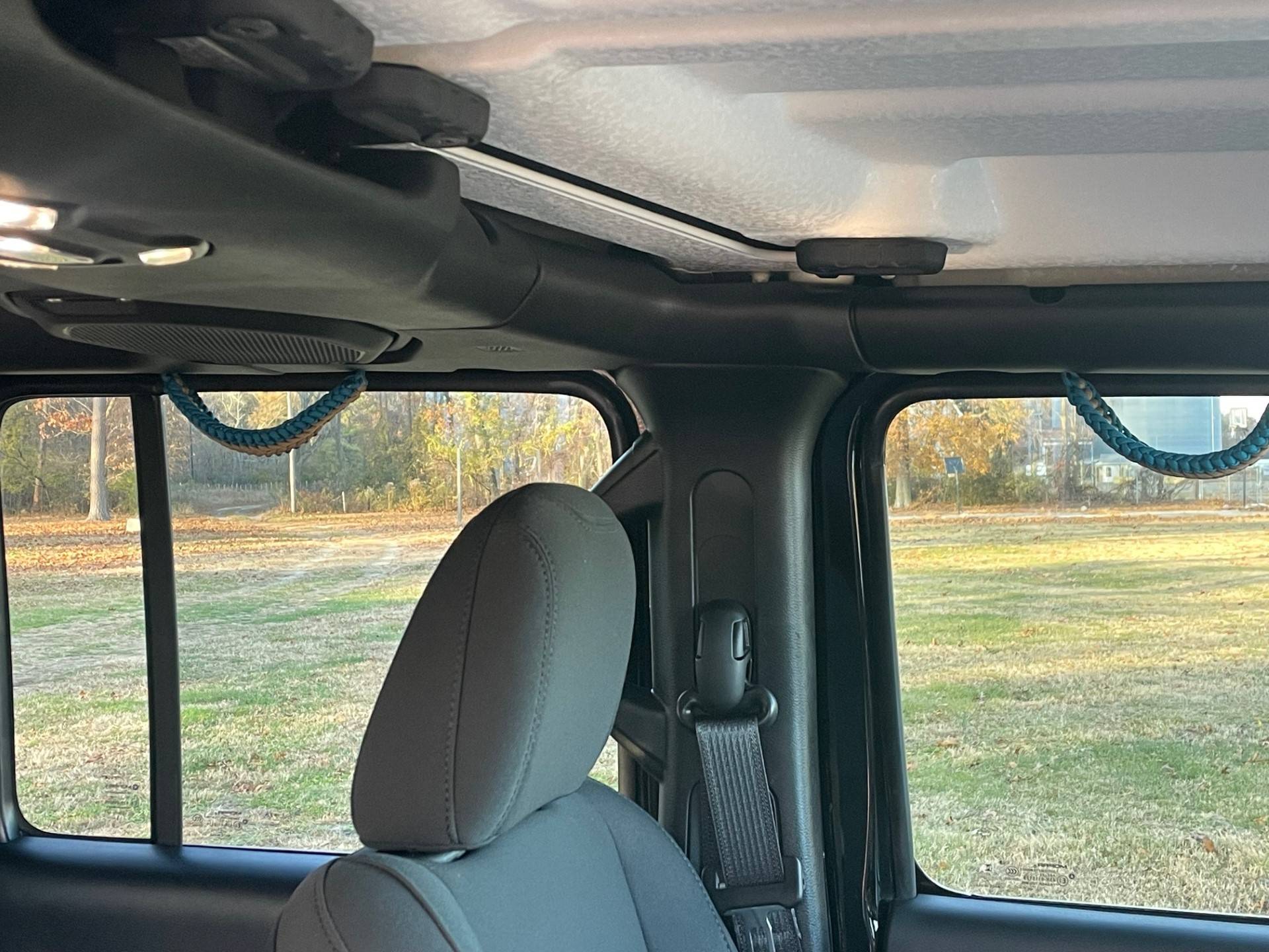

Finally ditched the tusks

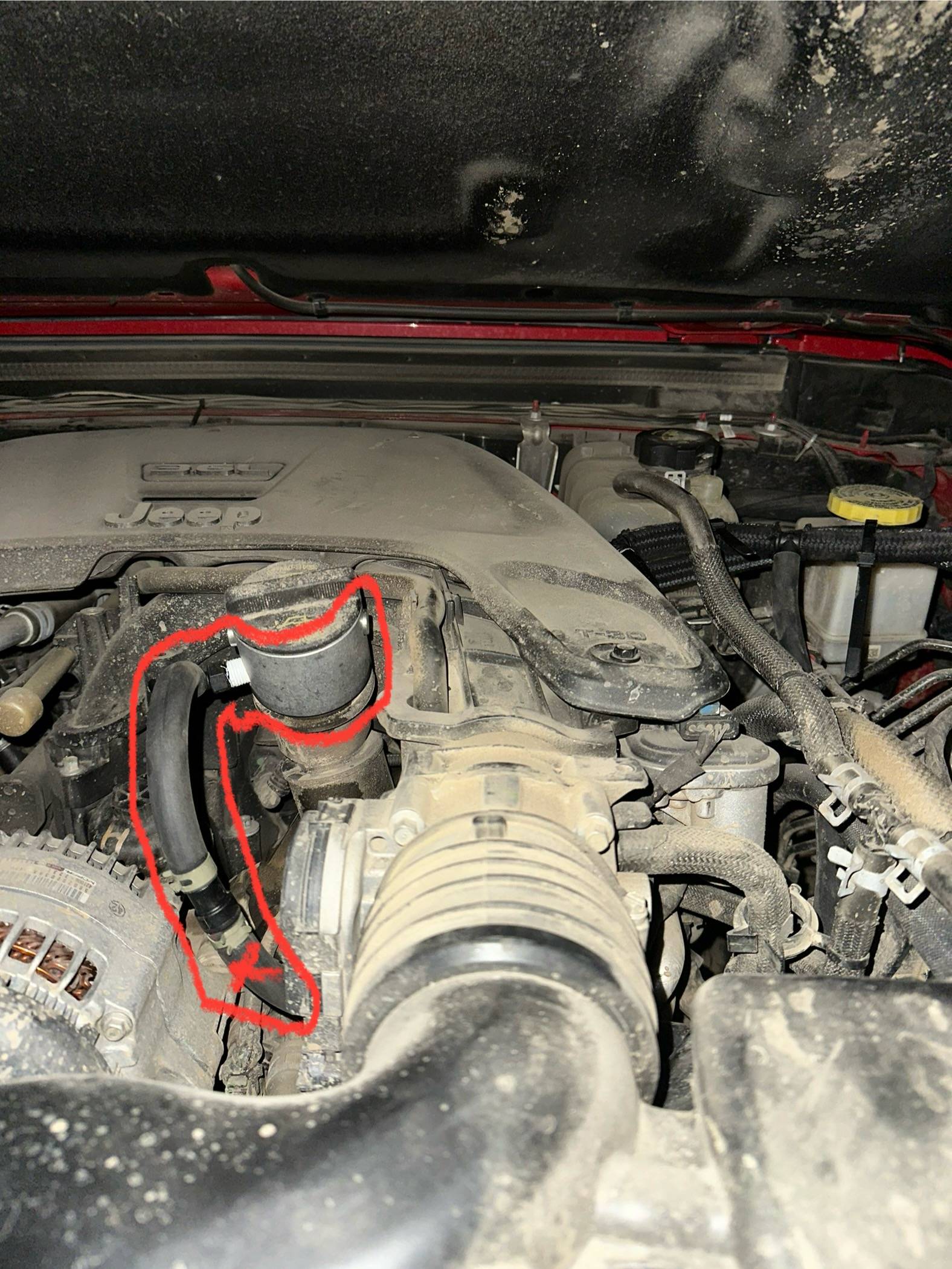

I installed the Teraflex Crankcase Vent System which adds a second PCV valve.
I had the dreaded white cloud of smoke when trying to climb at Rowher, and this is supposed to fix that. hopefully it didn’t set me up for early engine troubles?‍?.
Jeep Gladiator What did you do TO your Gladiator today? [ADMIN WARNING: NO POLITICS, NO GUN TALK] IMG_5306
You can see the extension off the oil fill cap, and hose extending down underneath the air intake. The kit was pretty easy to throw together.
The only thing I’m a little worried about is that the barb fitting marked X does not seem very tight and has loosened a little, despite having a spring clamp on there. I might have to put a screw clamp on or something instead?‍♂

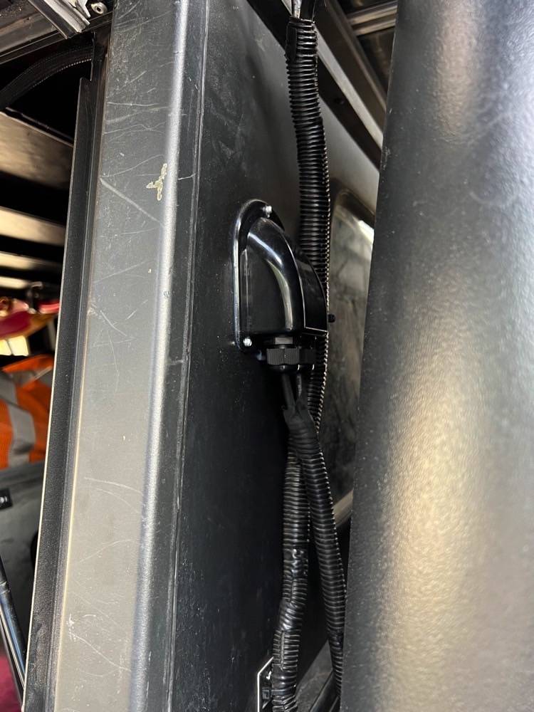

First off I installed a proper cable gland for the solar wire penetration into my Alu-Cab Canopy. This was scary as it's the first hole(s) I've put in it in 3 years of ownership

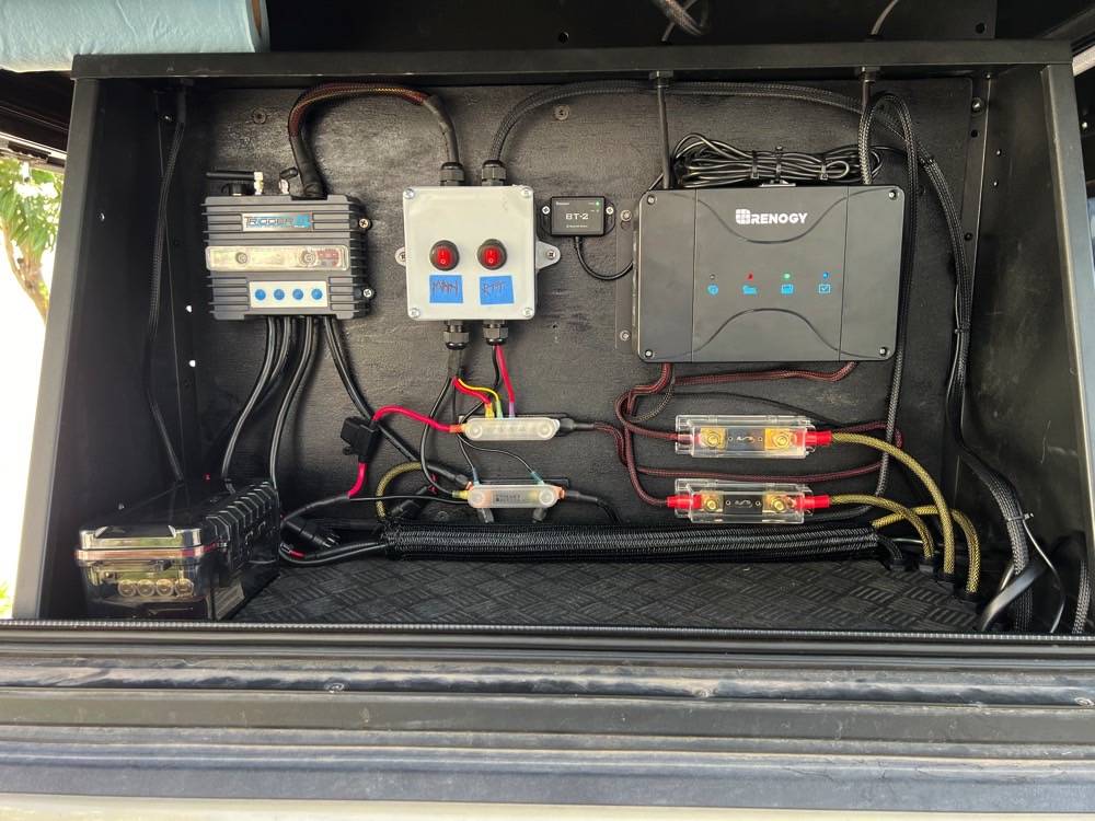

Then I converted my Alu-Cab Canopy cupboard into an electrical panel and consolidated all of my electrical controls: 30A MPPT w/DC-DC Charger, Trigger Controller for house loads, main power switch (forgive the blue tape temp labeling) and even a little mounted box for fuses, batteries, etc.

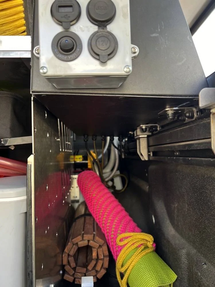

Here's a shot underneath of the electrical cabinet. Looking forward you can see all the cable glands/strain relief running out of the front of the cabinet and off to either the House Battery, House Loads, or the engine compartment.

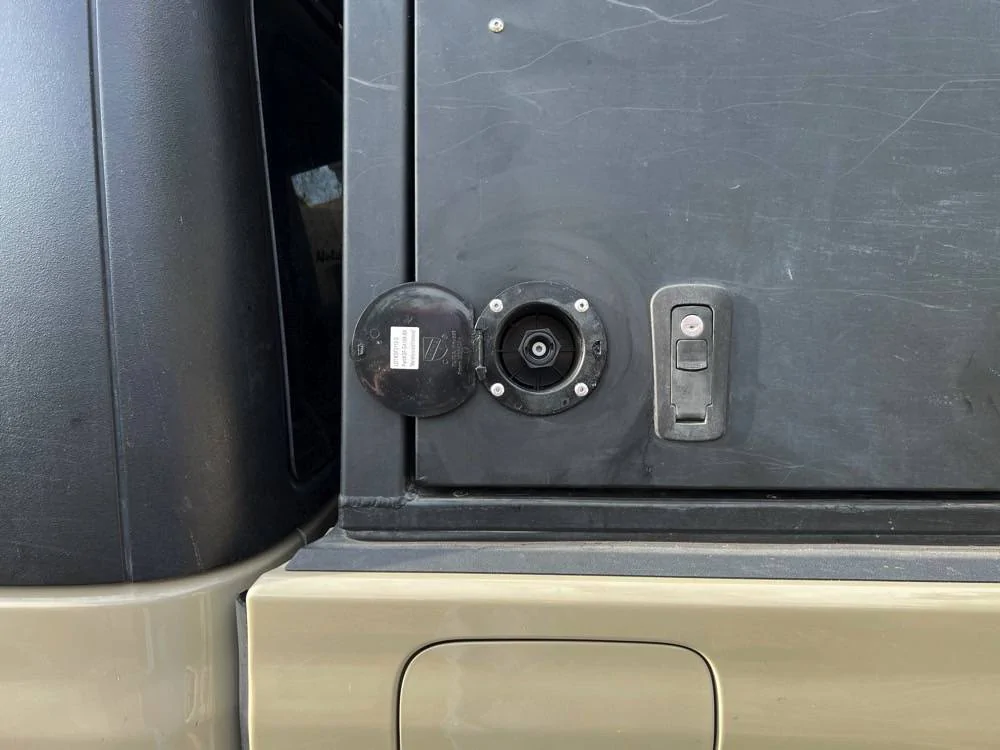

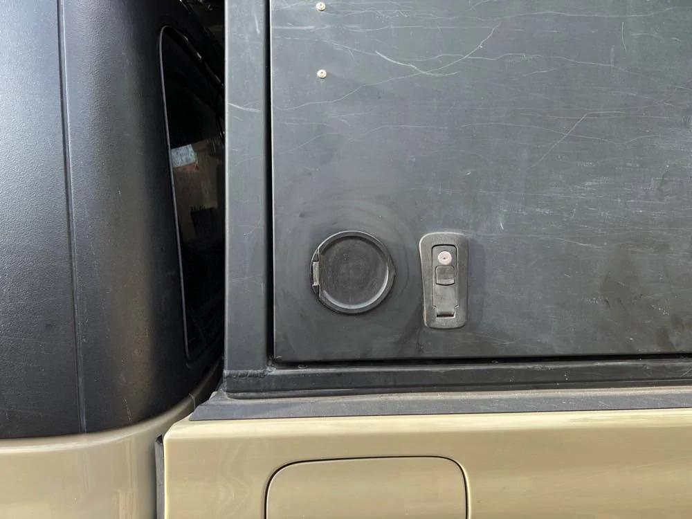

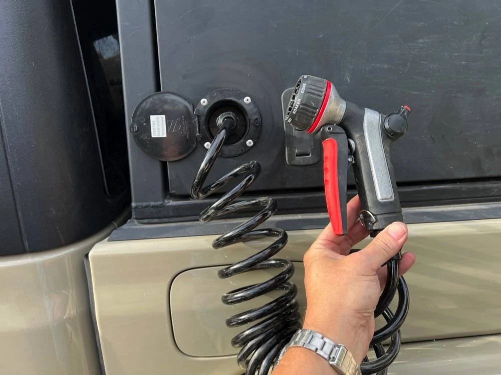

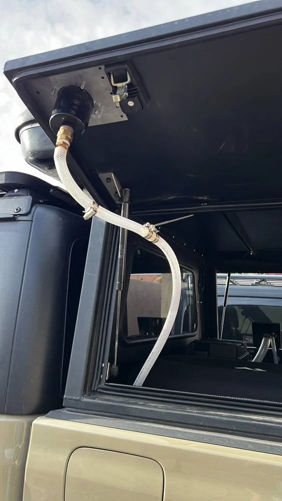

2) Now what did I do today? Feeling gutsy about putting the first hole in the canopy for the solar cables, I decided to make my exterior shower actually have exterior access:
Jeep Gladiator What did you do TO your Gladiator today? [ADMIN WARNING: NO POLITICS, NO GUN TALK] 25_ExteriorShower_1
Jeep Gladiator What did you do TO your Gladiator today? [ADMIN WARNING: NO POLITICS, NO GUN TALK] 25_ExteriorShower_2
Jeep Gladiator What did you do TO your Gladiator today? [ADMIN WARNING: NO POLITICS, NO GUN TALK] 25_ExteriorShower_3
Jeep Gladiator What did you do TO your Gladiator today? [ADMIN WARNING: NO POLITICS, NO GUN TALK] 25_ExteriorShower_4
I still have to come up with an elegant solution to retract the hose but right now this little bungee cord is functional.

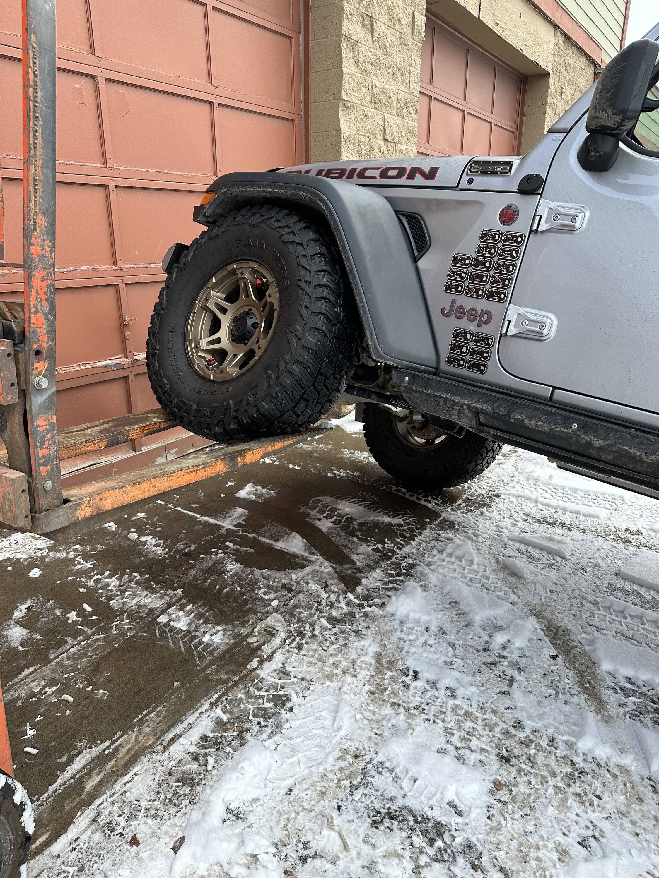

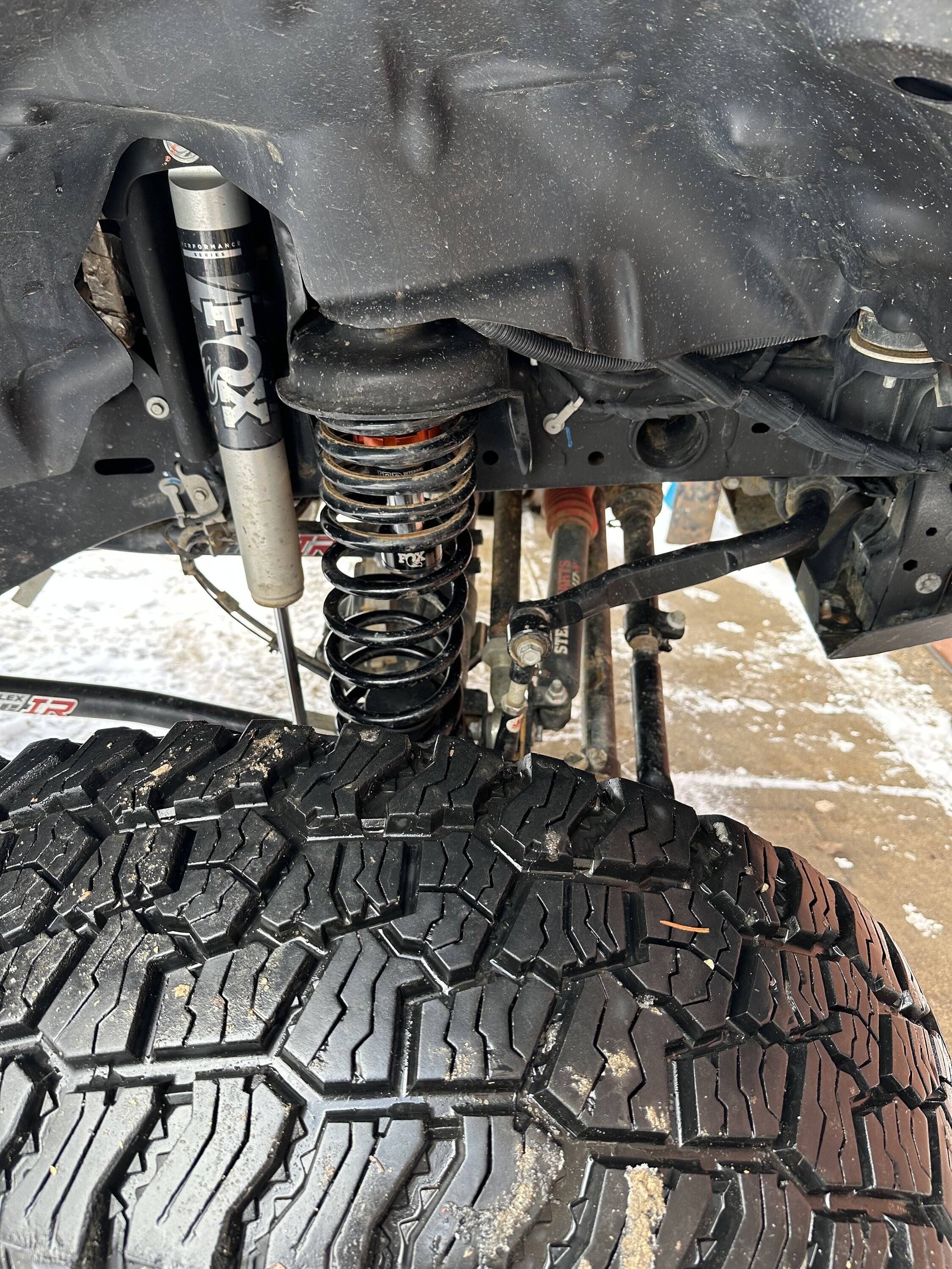

Took it to the local shop to put it on the forklift for a full suspension travel test after installing the Fox IFP hydraulic bump stops before thanksgiving. It’s perfect where the bump stop is situated in the jounce tube, and 2” of pucks. I was able to get 29” off the ground when the rear started lifting. I’m within 1/2” of the fender flare liner, but not touching. And the bump stop bottoms out just before the shock would. I did find out that my rear brake lines need a little more length, so those are ordered.
