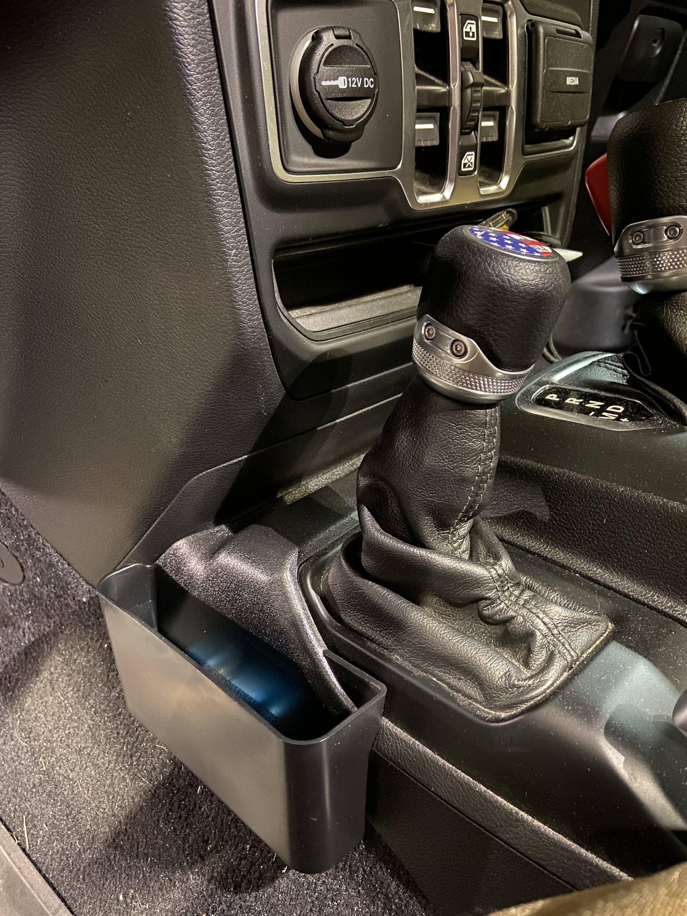

Oil change and tire rotation at the dealer yesterday. They do a good job just as long as I remind the service lady 5 not 6. That’s all I say lol. Installed one of these console things. I had an Amazon credit so I gave it a try for 25 bucks.
Well worth the money I love mine.

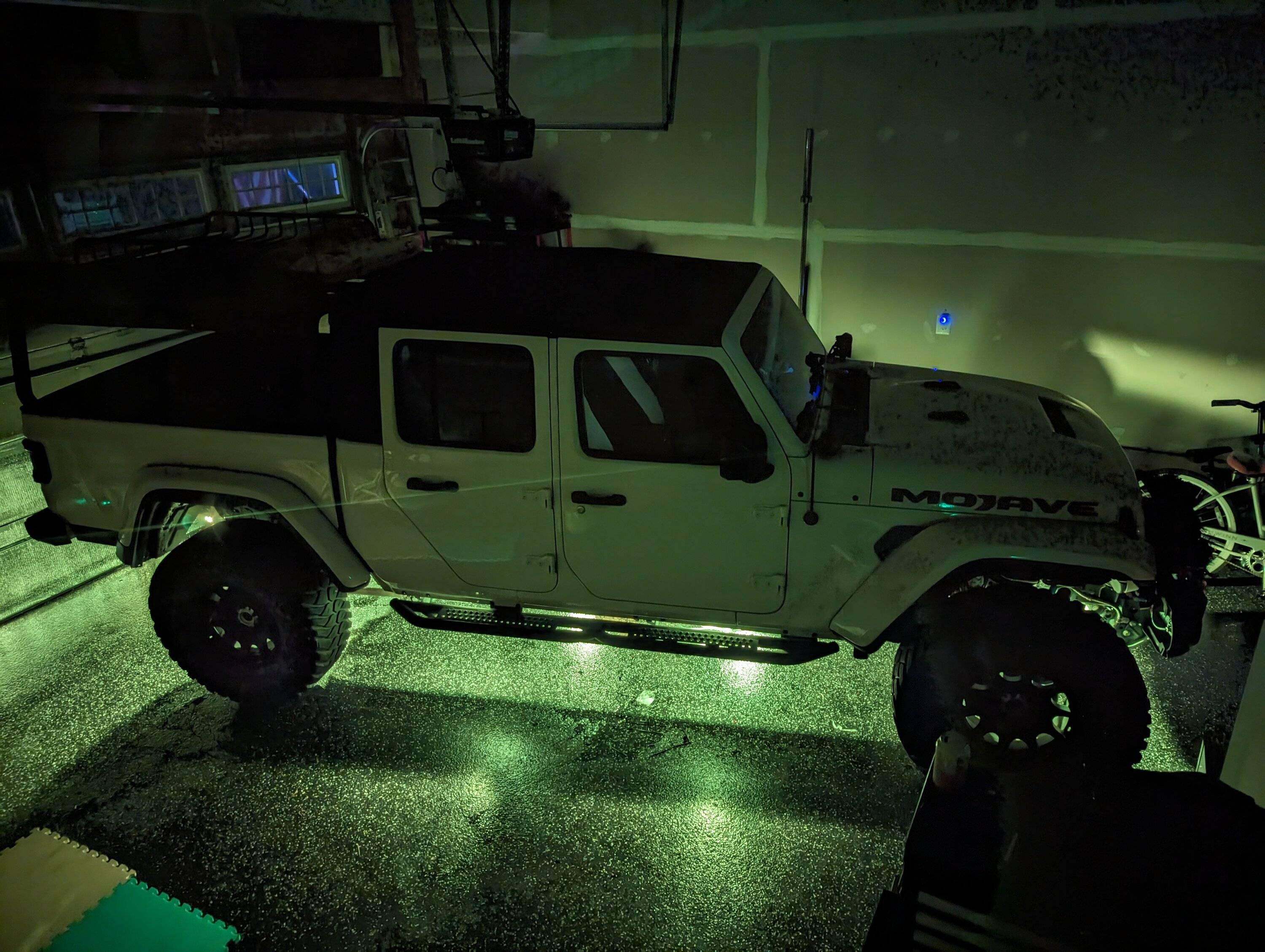

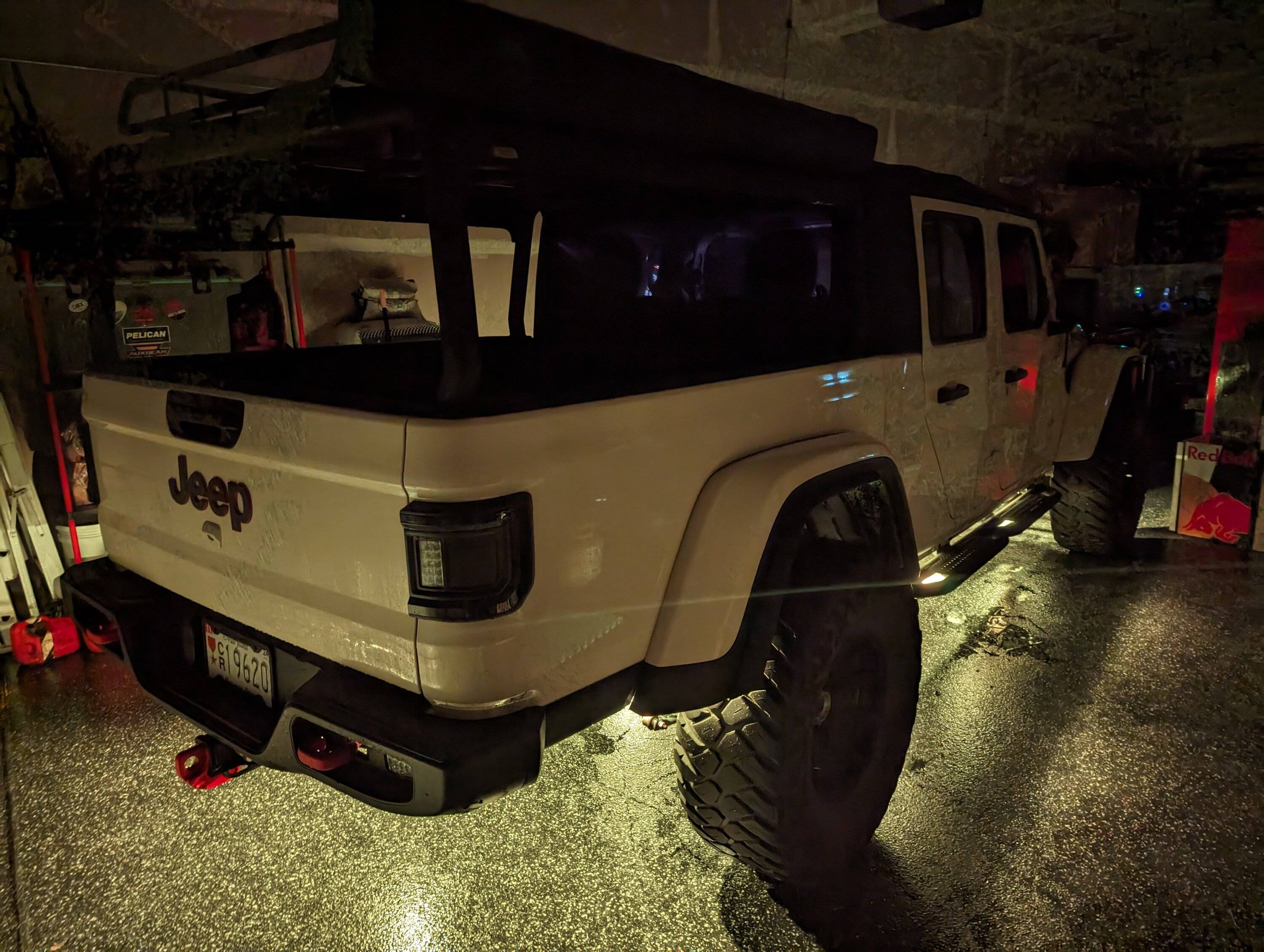

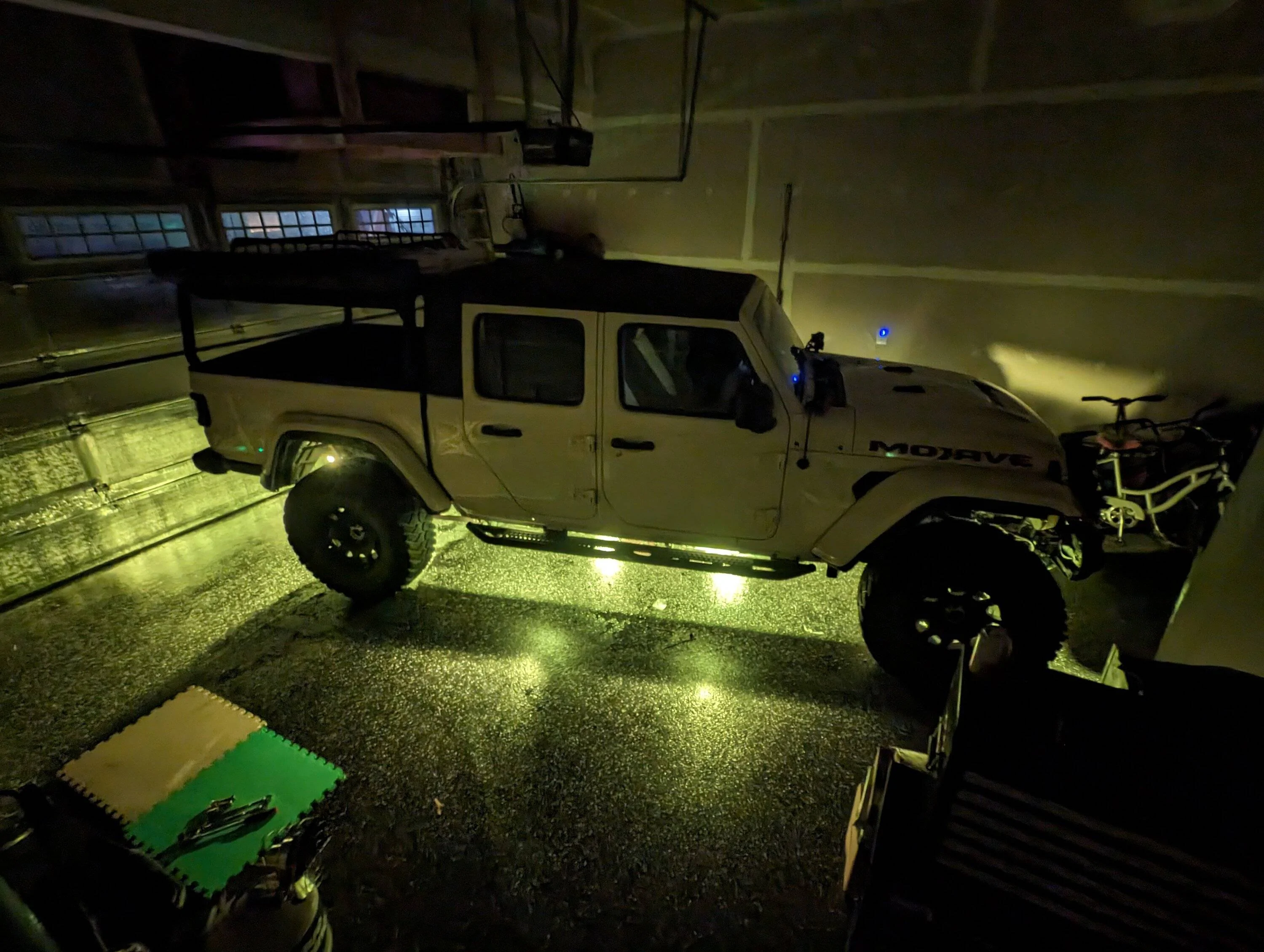

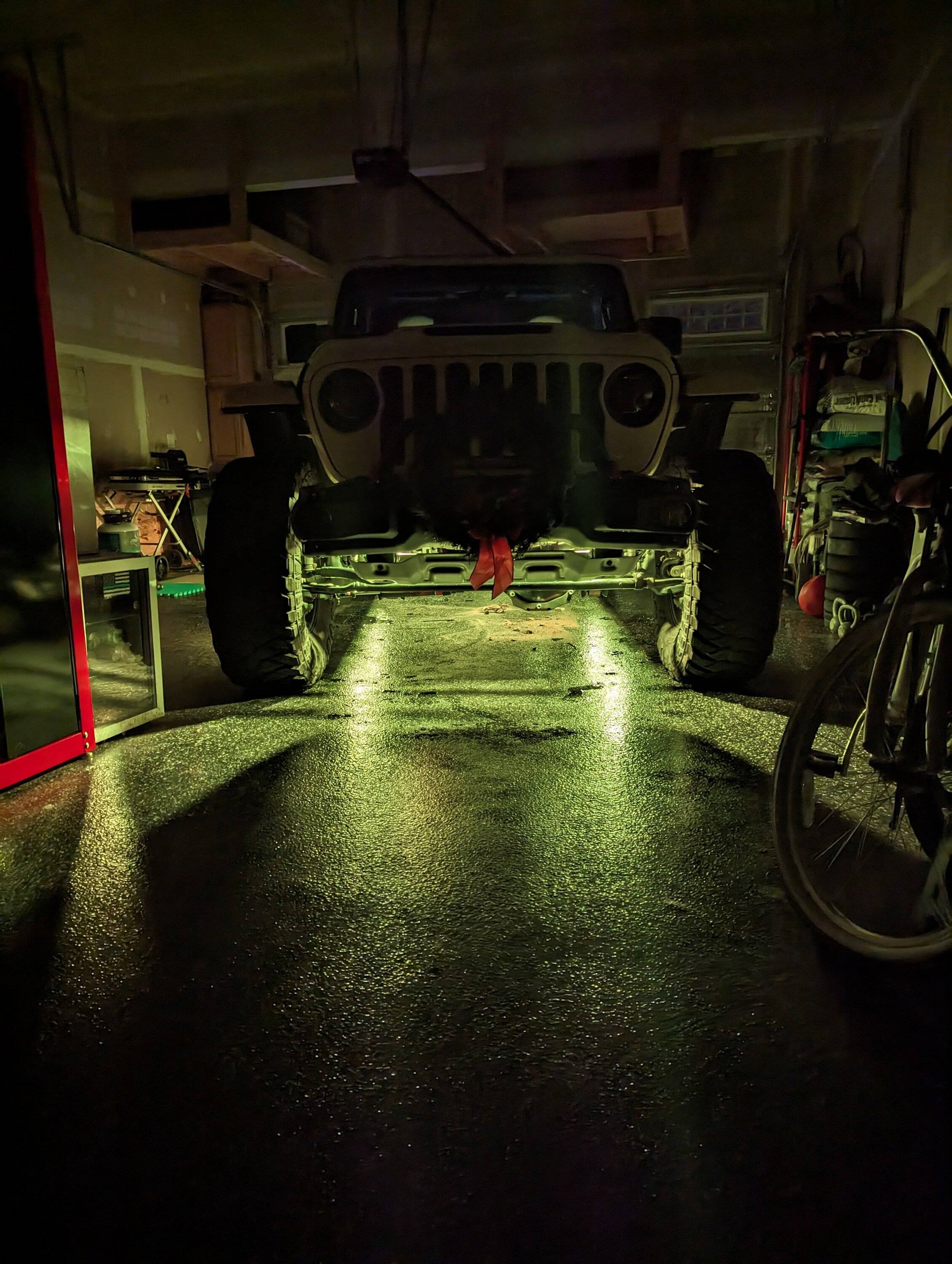

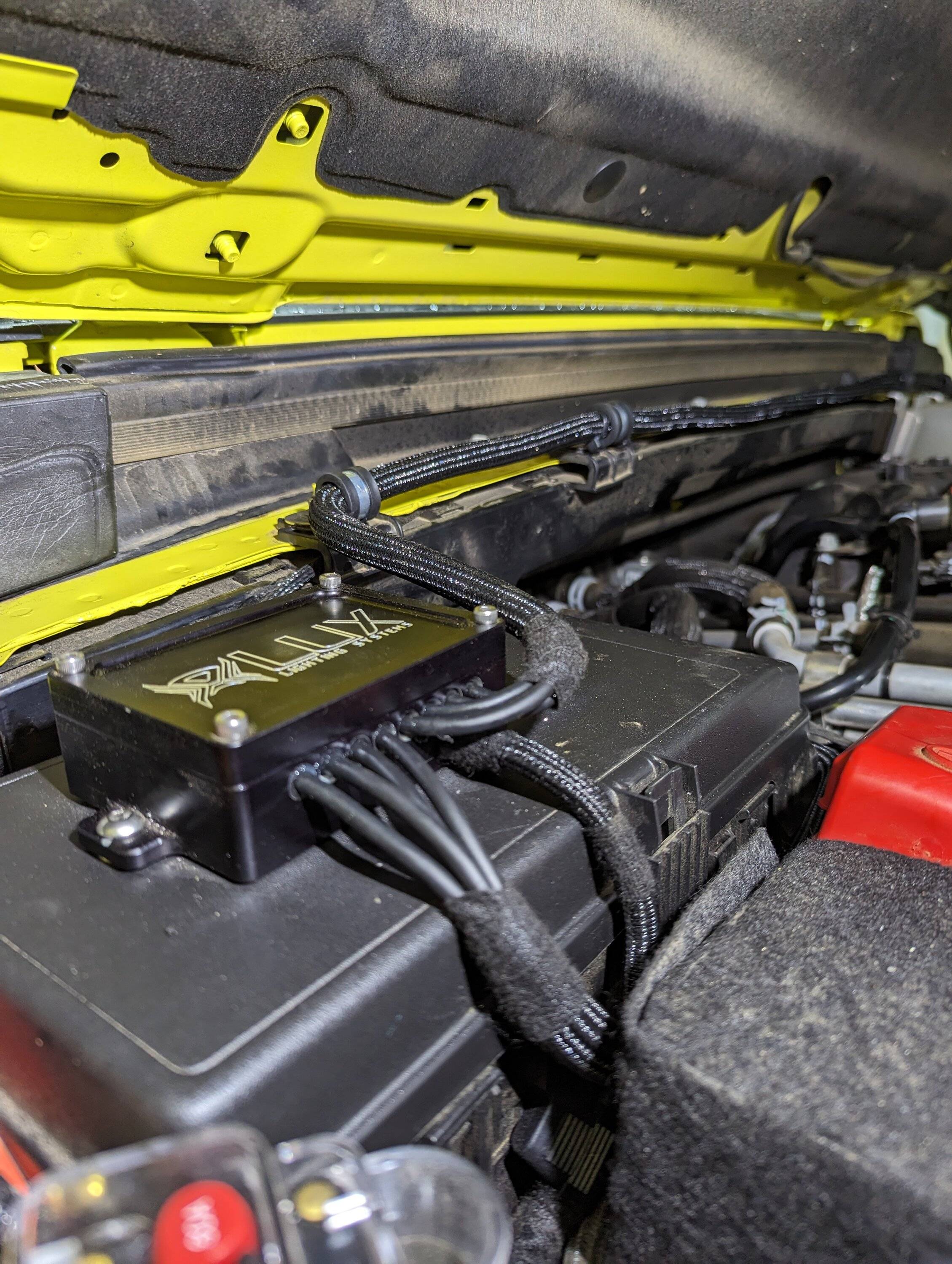

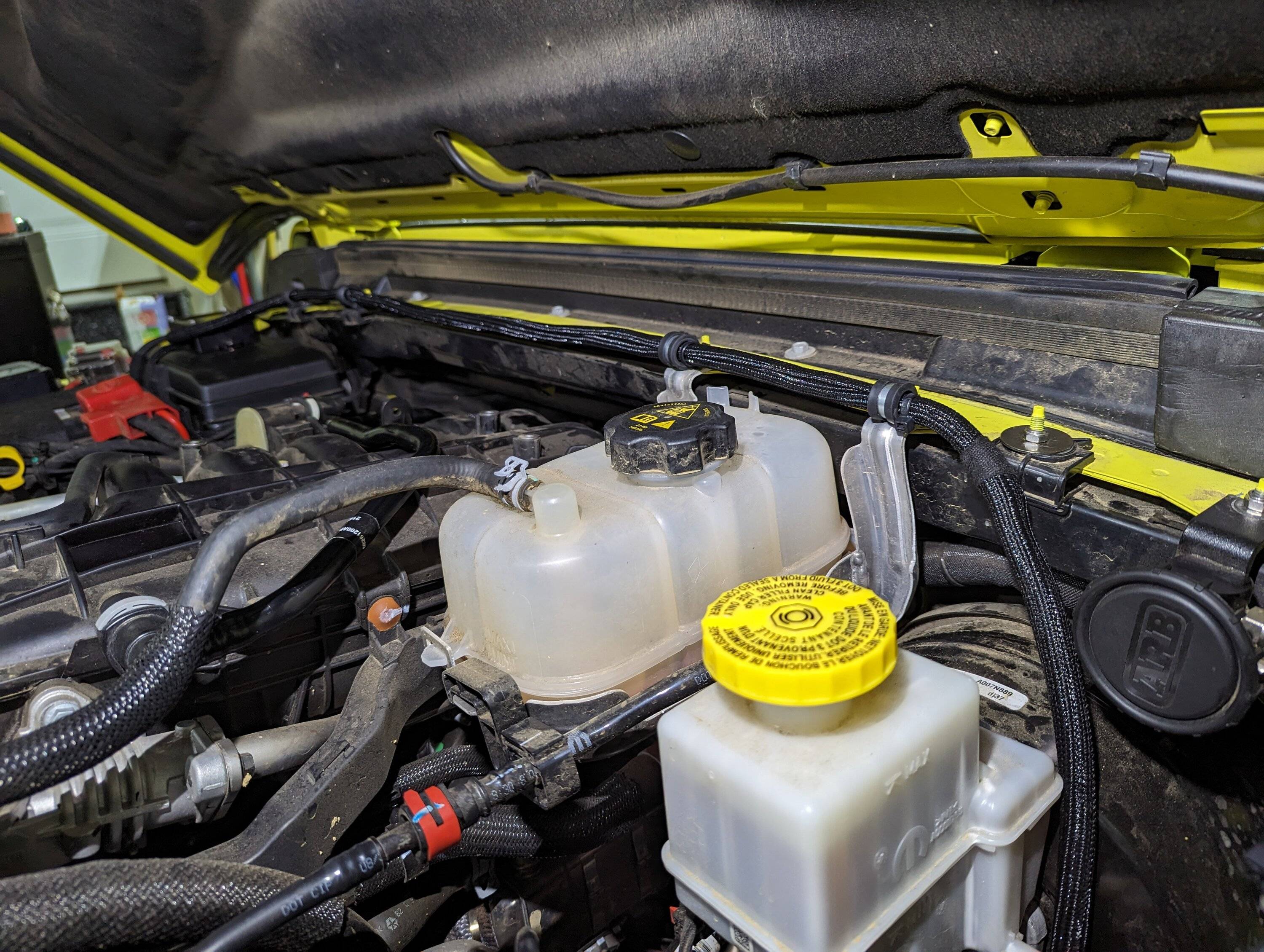

Finished my LUX lighting rock lights.
Only a PITA because I'm OCD with wiring installs

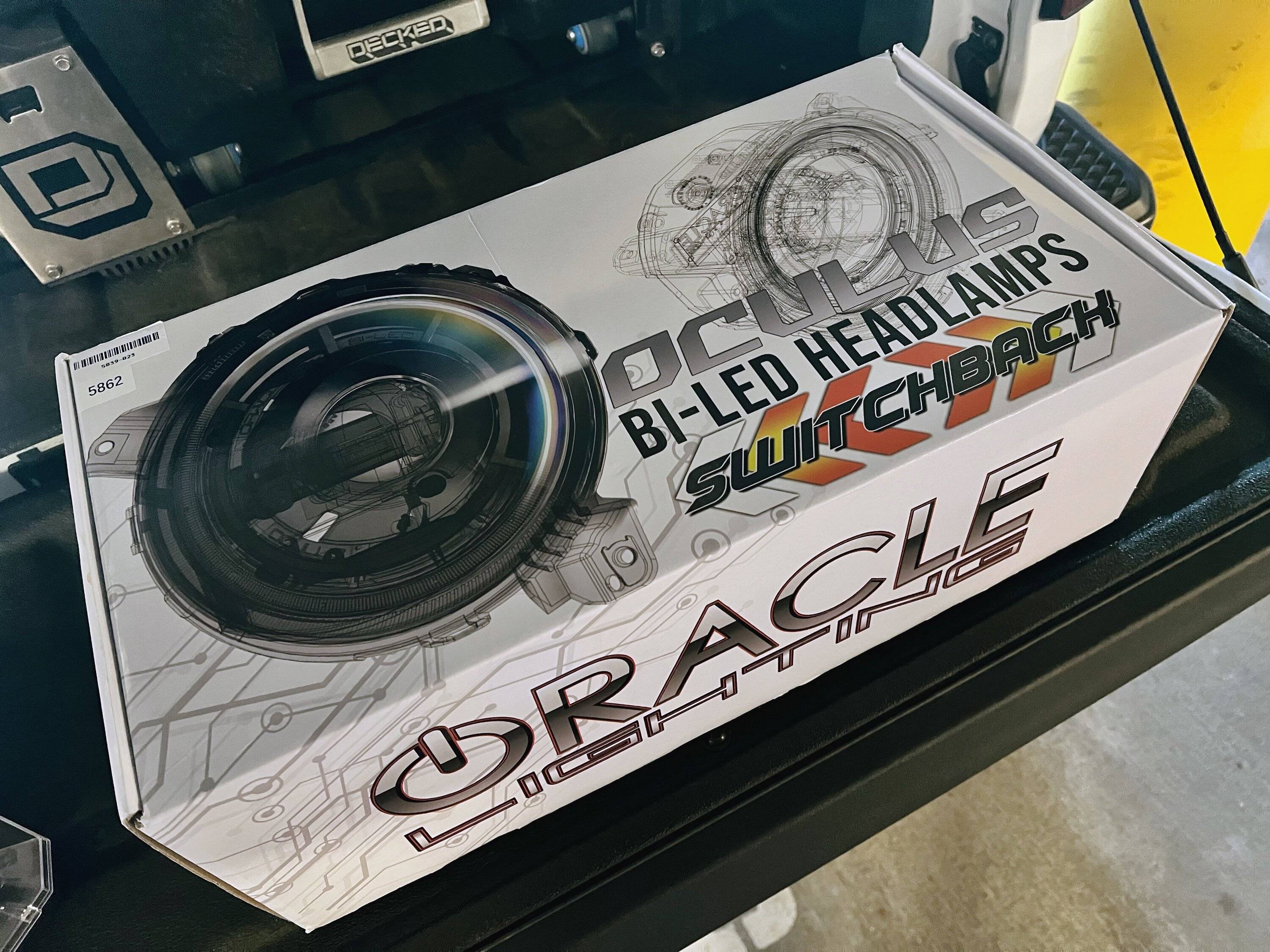

Installed Oracle Oculus Switchbacks ?
Took a little bit of trouble shooting with a Tazer but I got them to work perfectly.
Looks great!!!! I love those lights!!

I like the use of Adel Clamps on the wiring. :like:
I like the use of Adel Clamps in your post, most wouldn't know their name.

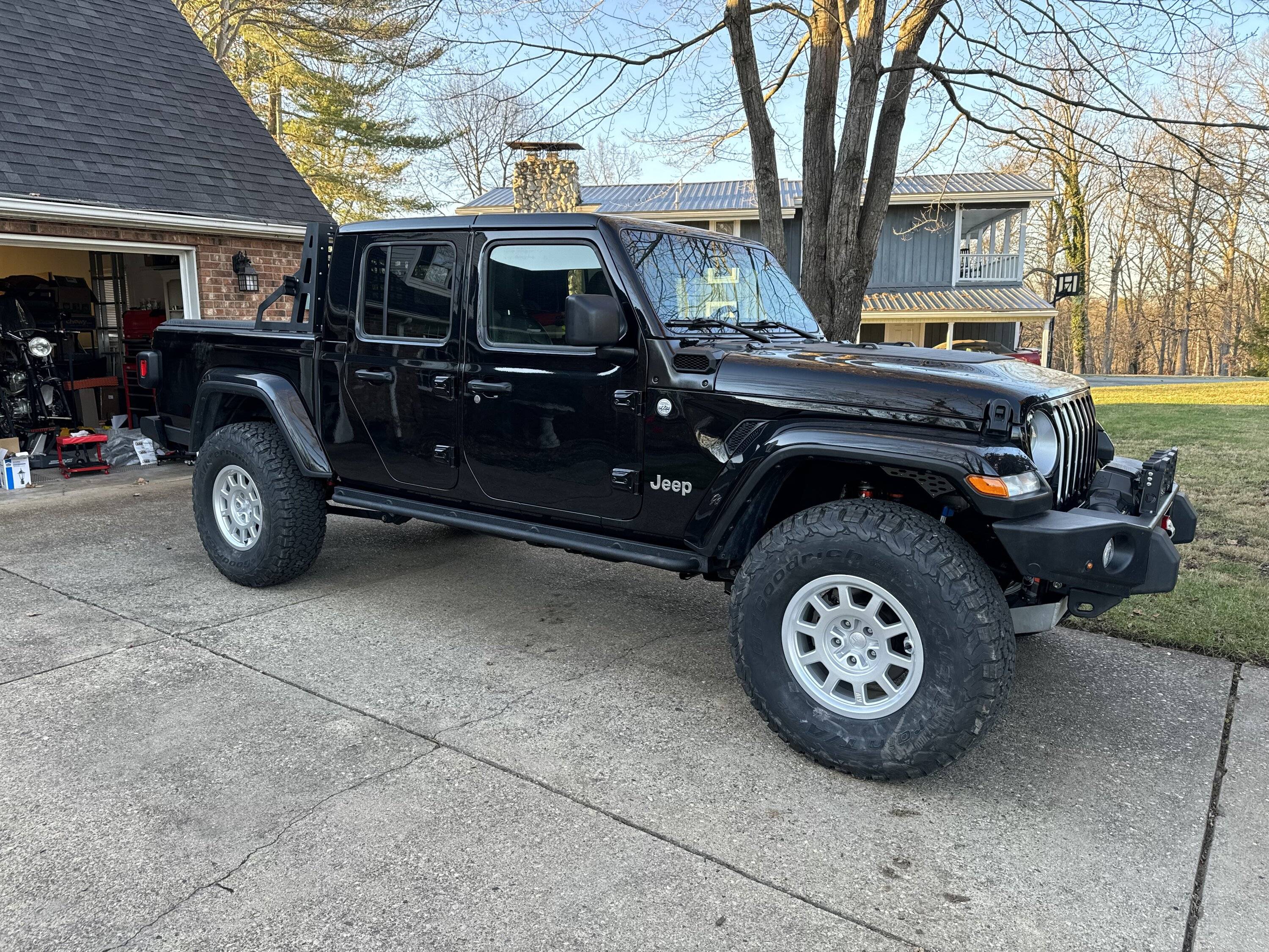

Finally got the wheels I’ve had in my garage for 3 months installed (managed to get NOS JK AEV Saltas and 37” KO2s for bargain basement prices).
Now on the hunt for some Rubicon take off fenders, or maybe the Baja fenders from Quadratec

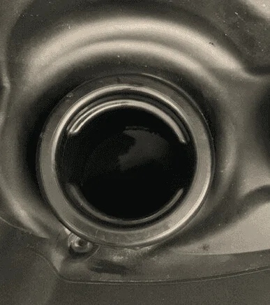

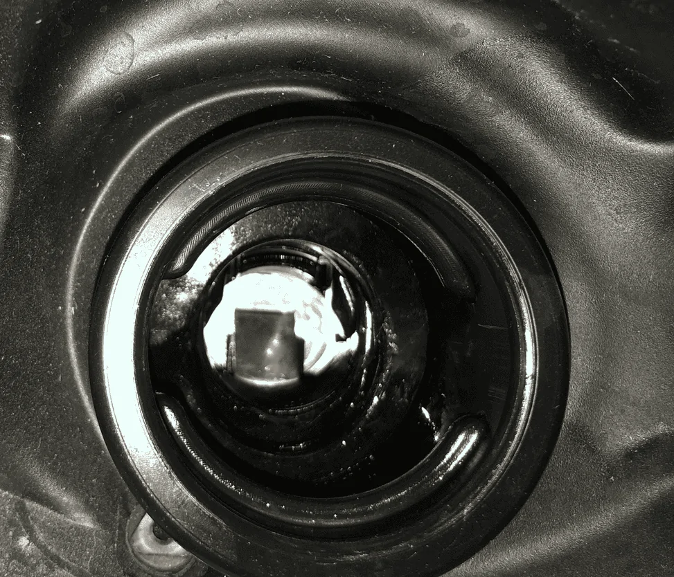

I have a diesel and the fuel filler flap has now been removed. For those that don't know, diesel pumps are supposed to have different sized fillers at the auto gas pump...this prevents users from filling up with gasoline by mistake........ I love mommy jeep protecting us but sometimes we need to make our own high risk decisions.
Some stations that service farm equipment/ 18 wheelers use different sizes that wont work with the from the factory fuel nozzle. The factory fuel flap prevents usage of these odd size fuel nozzles.
Jeep included a tiny fuel nozzle to solve this problem but using it would take 15-20 minutes to slowly fill the tank without overflowing.
Jeep Gladiator What did you do TO your Gladiator today? [ADMIN WARNING: NO POLITICS, NO GUN TALK] 1703124568022
Before:
Jeep Gladiator What did you do TO your Gladiator today? [ADMIN WARNING: NO POLITICS, NO GUN TALK] 1703124246249
now I have removed the flap assembly so i can use any diesel nozzle the station has.
So I finally finished this today....apparently I was grabbing too much of the tube and insert with the large channel locks and broke the lip on the one from the factory 2 weeks ago. I am pretty much all thumbs at times and am a little rough on getting things apart ( I was a Soldier for 30+ years....guaranteed that if someone says it is unbreakable...we can break it).
Ordered the wrangler one listed in here from BAM...got here yesterday. since it is like half the JT price.... used dremel to make the plastic tabs lower thru the slots before removing from tube.

I pried old one out and put new insert in and it looks good. Plus when i went to fuel up the tank the EDT fuel additive went into the tank vs down the side of the discriminator and just sat there and dripped over the edge around the filler like the last few tanks.
