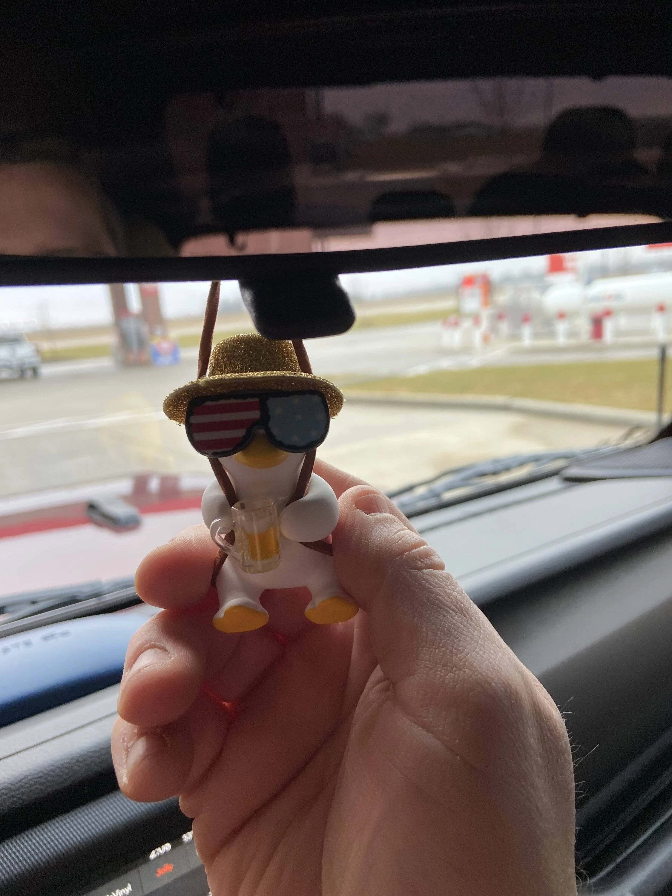

Installed this duck my in-laws got me lol.
my wife had one of those. it swung around wildly and would smack the window on occasion. took it off, stored and forgot about, until a few weeks ago during a clean out I found it and tossed it.

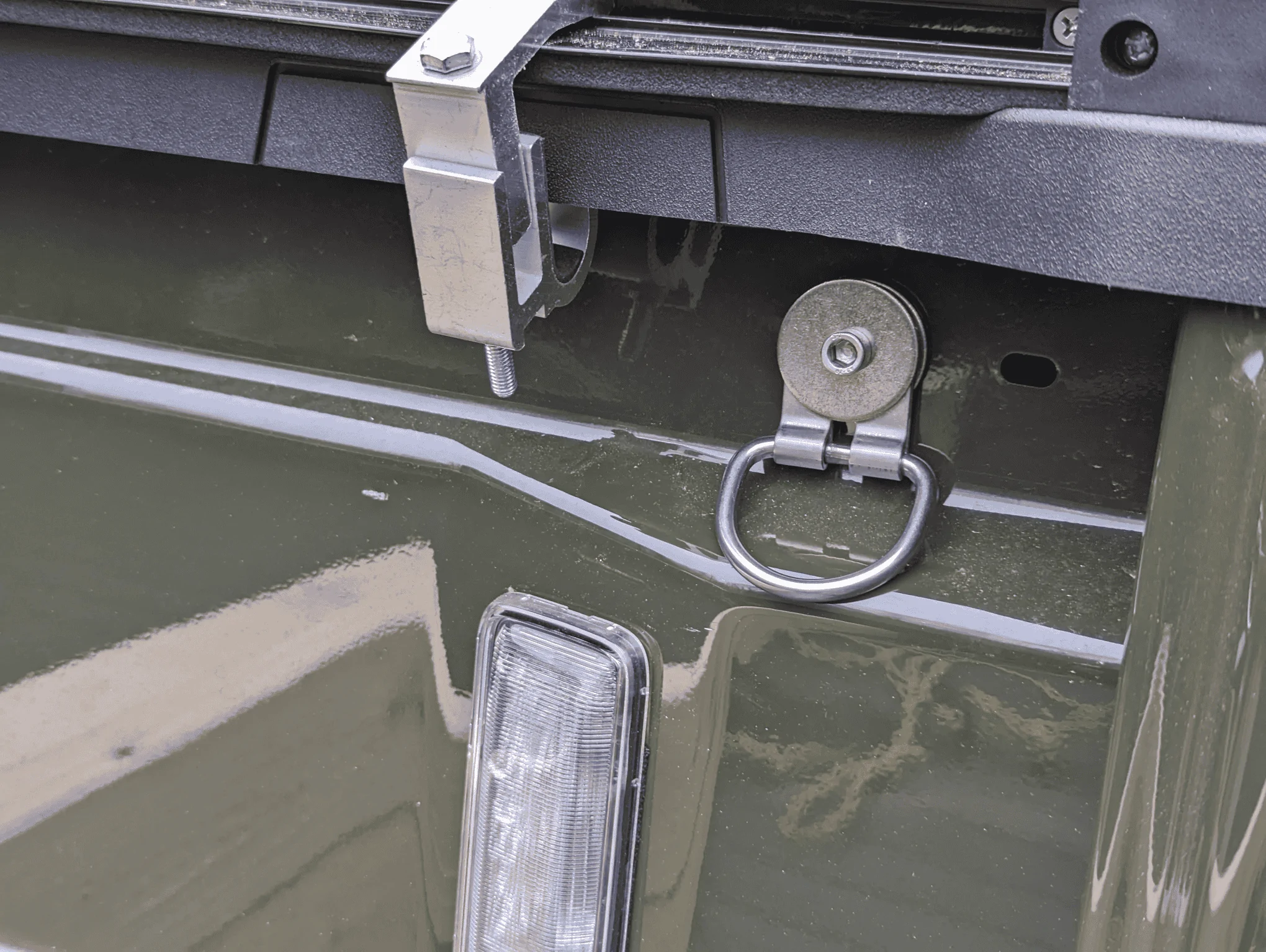

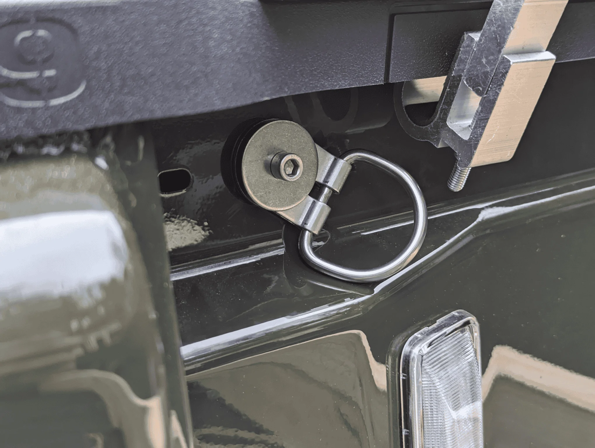

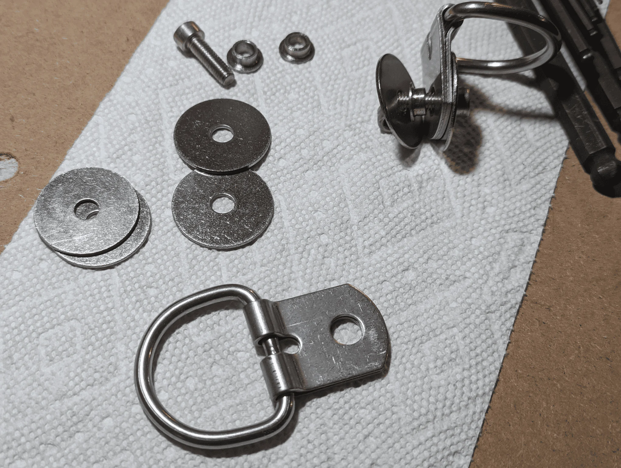

I added some additional tiedowns to the bed. I wanted anchor points higher up so I could lash things like propane bottles from falling over. I was thinking about about DIY trail rails using unistrut, but I decided to start simple with four additional tiedowns. I found some stainless tiedowns on Amazon, but I wanted them to swivel so they could pull in any direction. I couldn't find anything premade, so a turned four stepped bushings on the lathe (made from a 1/2" stainless bolt), and sandwiched the bushing and tiedown between two fender washers. The bushing is just long enough that the tiedown isn't clamped tightly when the bolt is tightened, so it can swivel freely.
Built, not bought. Nice job

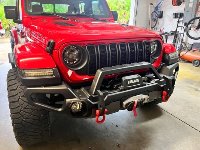

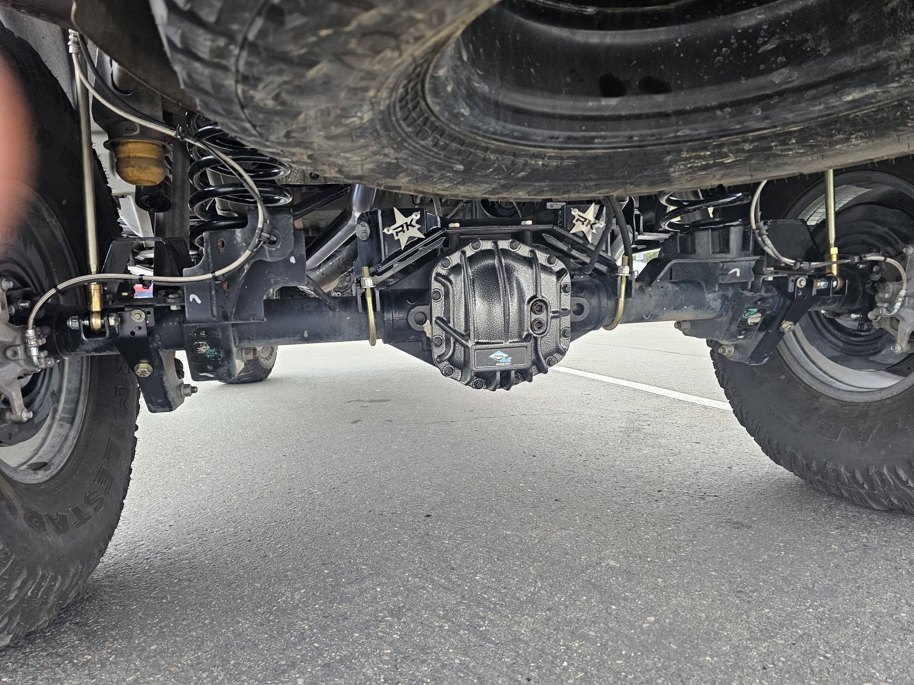

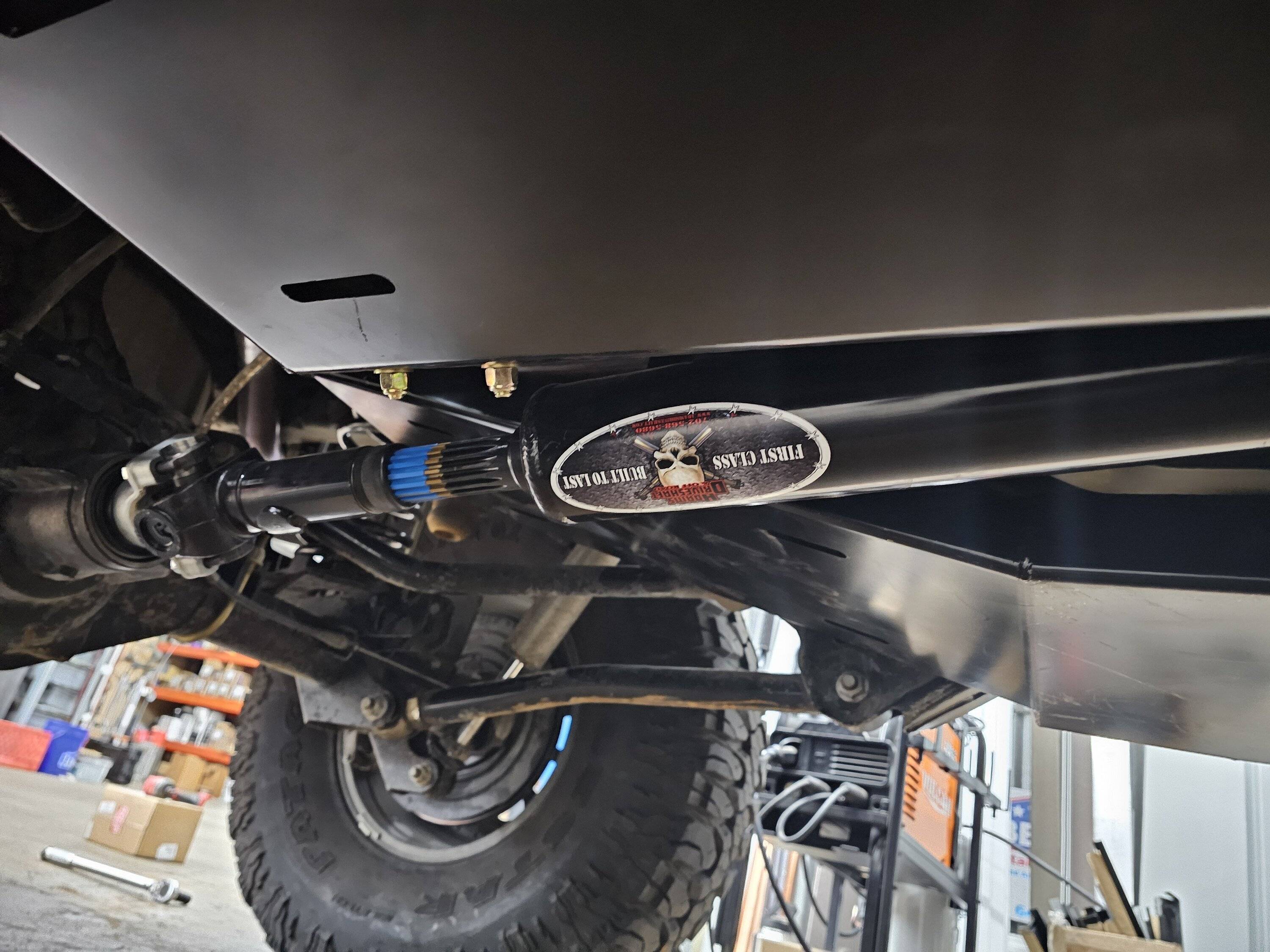

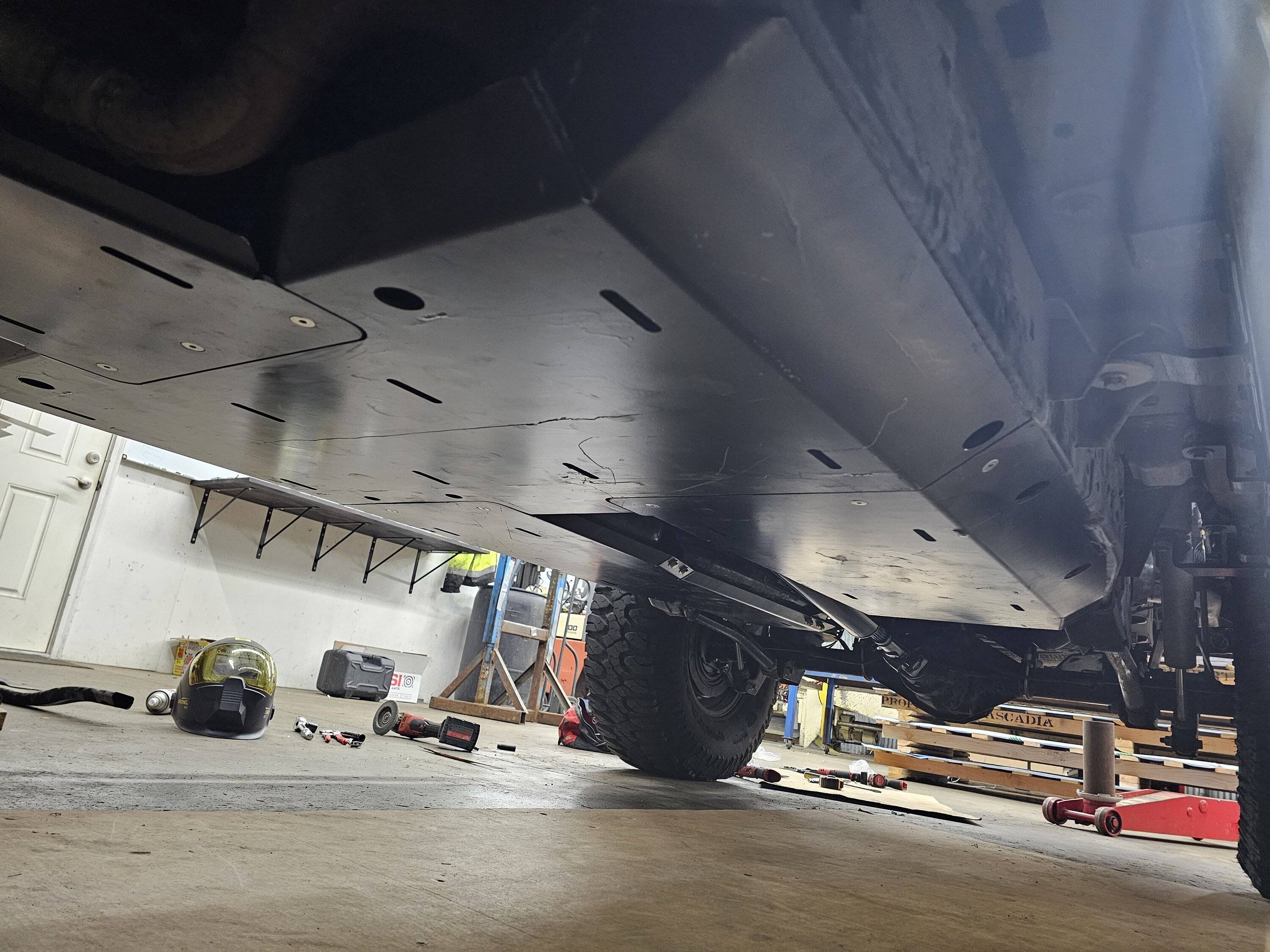

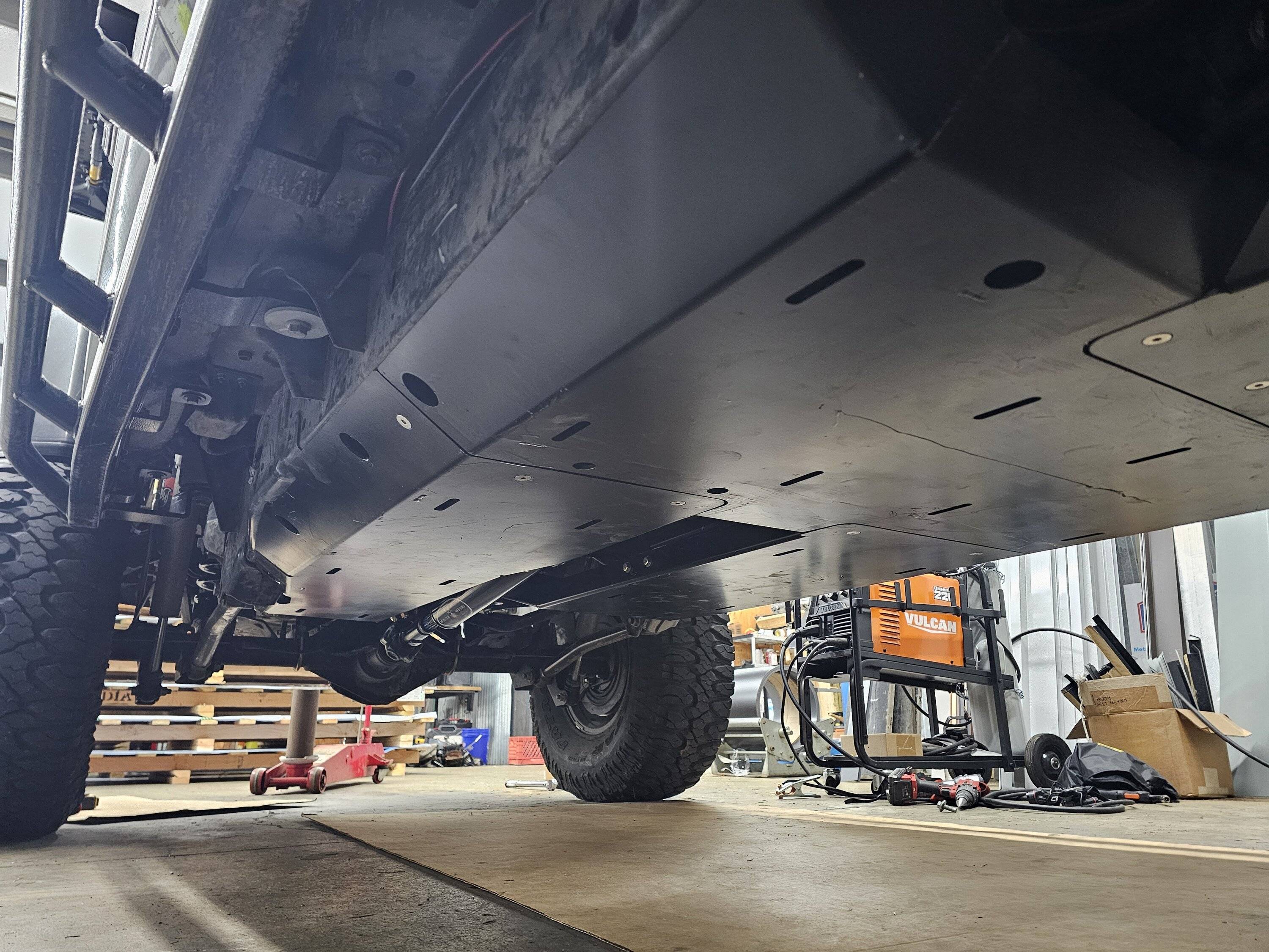

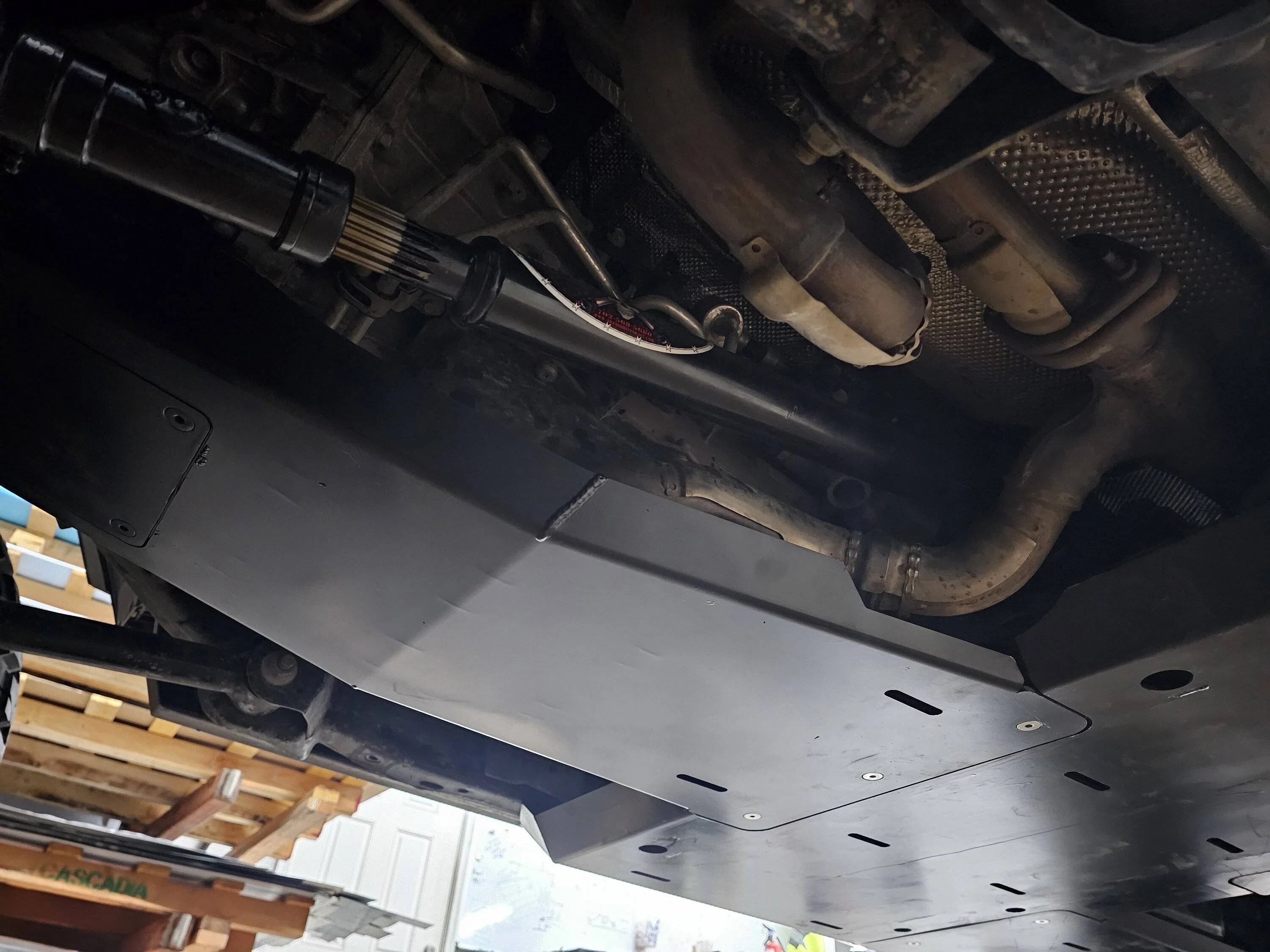

Last few days got a lot done.
5.38 gears.
New diff covers.
Rear Revolution chromoly axle shafts.
Front RCV fad delete shafts.
Adams front and rear drove shafts.
Motobilt full belly skid plates.
Badass

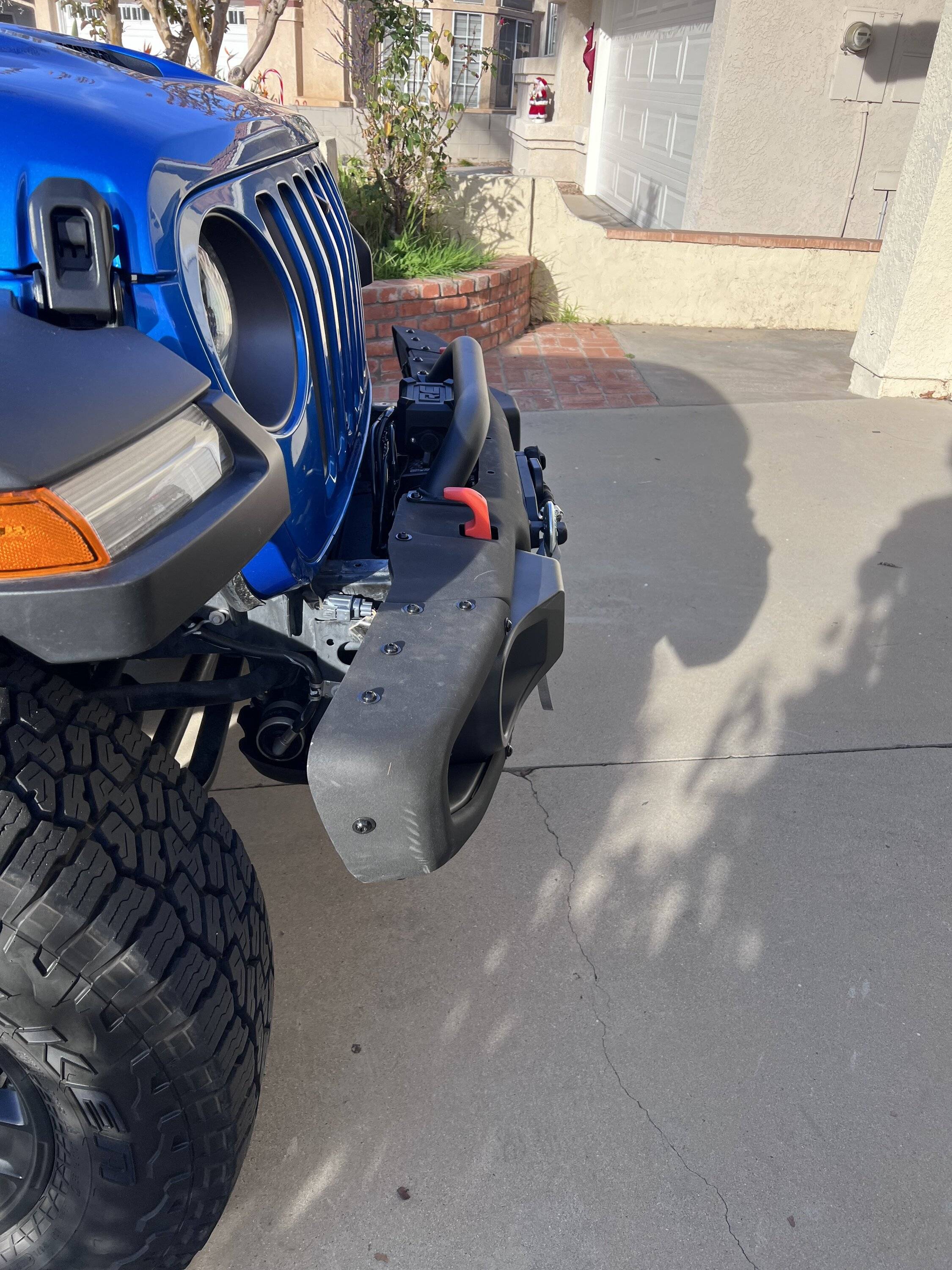

Outstanding. Have a safe trip and Merry Christmas!
Hey brother here are a few pictures. Not the best quality... you can see the marker light is very visible. The strobe function is very noticeable to trailing vehicles. The white backup light also sheds lots.of extra light although in the rain the backup camera is the limitation.
Jeep Gladiator What did you do TO your Gladiator today? [ADMIN WARNING: NO POLITICS, NO GUN TALK] 1000003695
Jeep Gladiator What did you do TO your Gladiator today? [ADMIN WARNING: NO POLITICS, NO GUN TALK] 1000003686
